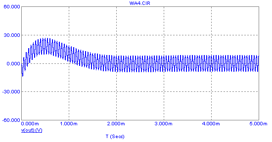

DC drift
Hi Wahab,
> Using more cycles in sims didn't change the picture.
Hmm....
In my sim it took some time before the DC level got stable, see pic.
If the DC component is still drifting, I get a totally erroneous THD figure. If taken from the 1st cycle for example, THD20k = 18%, instead of 425ppm when taken from a stable cycle.
Apparently, you have tackled this problem in a different way.
E.

May I ask you do you think this amp can be improved further with respect to its THD performance, or does the complexity increase dramatically. Not that I think the 2XAMP performance is bad its excellent for its complexity , but any improvement is of interest.
Regards
Arthur
Clamp
Hi Arthur,
What about calling it the 'Phoenix'. 😉
Indeed, the waveform looks very neat. Nevertheless I would recommend also to investigate the clipping behavior under lots of other conditions: different loads, voltages, frequencies, even 100kHz.
Furthermore, I also would sim the loop response of the clamp and check the phase margin. You never know, the devil is in the detail.
Thank you!
For such a relative simple amp the performance is already amazingly good. Probably not much 'room' for further improvements, that is, without adding complexity. But a few details might need a bit more attention: PSU filtering of the front-end for better PSRR. Also bootstrapping the diodes D1 and D2, as shown in my example. Did you check THD figures with and without these diodes? BTW, what is that 1pF cap doing there?
E.
Hello Edmond
Here is the 2XAMP(new name) following your comments,
Hi Arthur,
attached is also the clipping performance into 2ohms (a real challenge in my opinion) as can be seen the recovery from a clipped 20KHz sine wave is very good. It does not look like it needs any additional lead compensation from the simulation.
The active clamp you designed is excellent and it makes me want to use it everywhere , not all clamps are created equal and congratulations again.
Thank you!
May I ask you do you think this amp can be improved further with respect to its THD performance, or does the complexity increase dramatically. Not that I think the 2XAMP performance is bad its excellent for its complexity, but any improvement is of interest.
Regards
Arthur
E.
