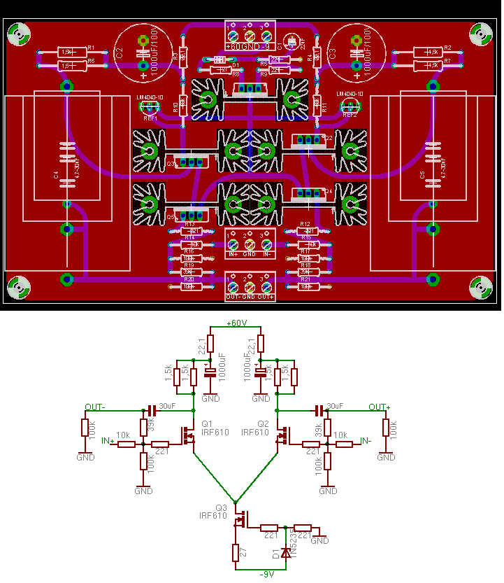

more confusion
Ok, I don't know whats going on here but everyone is contradicting each other.
For example, Post #92 shows heatsinks for 5 MOSFETs. here.
Yet post #390 shows a link to post #34 that shows a schematic that has only 3 MOSFETs that I can see.
Here.
Moreover, Post #114 says that the PS is +60 and -9 V. Yet Columb in Post #374 implies that the pos. secondary is still 60V which would be an 80V supply. Then post #380 says -9 and +60 again.
I guess I can accept that the supplies are now confirmed at +60 and -9, but what about the MOSFETs? The schematic from #34 does not appear to match the board layout in #92.
Basically we have a free-for-all where people are trying to order parts and no well defined schematic or layout.

Well I ordered the GB parts from Kari's BOM that he posted and I spent a good deal of time clarifing Form, Fit and Function with him.
As for as the POST regulator rails, they have always been -9/+60, the AC Primary has always been 60VAC and 12 to 18VAC. I am not sure why anyone would be confused about this.

illusionxx said:
igreen,
2 of the TO220 packages are voltage references.
But i would also like to see a schematic for the actual version of the preamp including the voltage references and the difference between the cascoded and uncascoded setup.
illusionxx
The voltage references are to-92 packages and do-35(ish) packages. The "extra" pair of TO-220 devices are the cascode mosfets.
I believe the final version of the board was around post 134 - http://www.diyaudio.com/forums/attachment.php?s=&postid=638685&stamp=1115671858 It is a simple circuit, and you can almost see the schematic looking at the board, it is easy to trace out. The top FET and parts around it is the current source, the bottom pair the gain devices and the upper pair are the cascodes. Keep a copy of the original BOSOZ handy to help understand it. Kari's BOM states what you delete to eliminate the cascode.
I agree with a comment above. Could someone please post the "final" version of the schematic as committed on the GB board w/parts from that GB as well? High lighting the cascoded and non-cascoded option would be great!
It would really help settle some confusion, it's better than having everyone reverse engineer the schematic from the GB boards they ordered.
The lastest available schematic does not match the GB boards.
Kari we might need your help here.
Thanks,
-David

igreen,
Huh??? I see the board has labels Q1-Q5, looking like MOSFETs in TO-220 packages that are heatsunk, and REF1 and REF2 looking like voltage references that are not heatsunk. I see a schematic that lacks labels corresponding to the layout and lacks voltage references of any kind, and has only 3 MOSFETs.
I don't mean to be a pain I'm sure somthing accurate will be coming at some point, or I'll just have to get the boards and reverse engineer the schematic.
