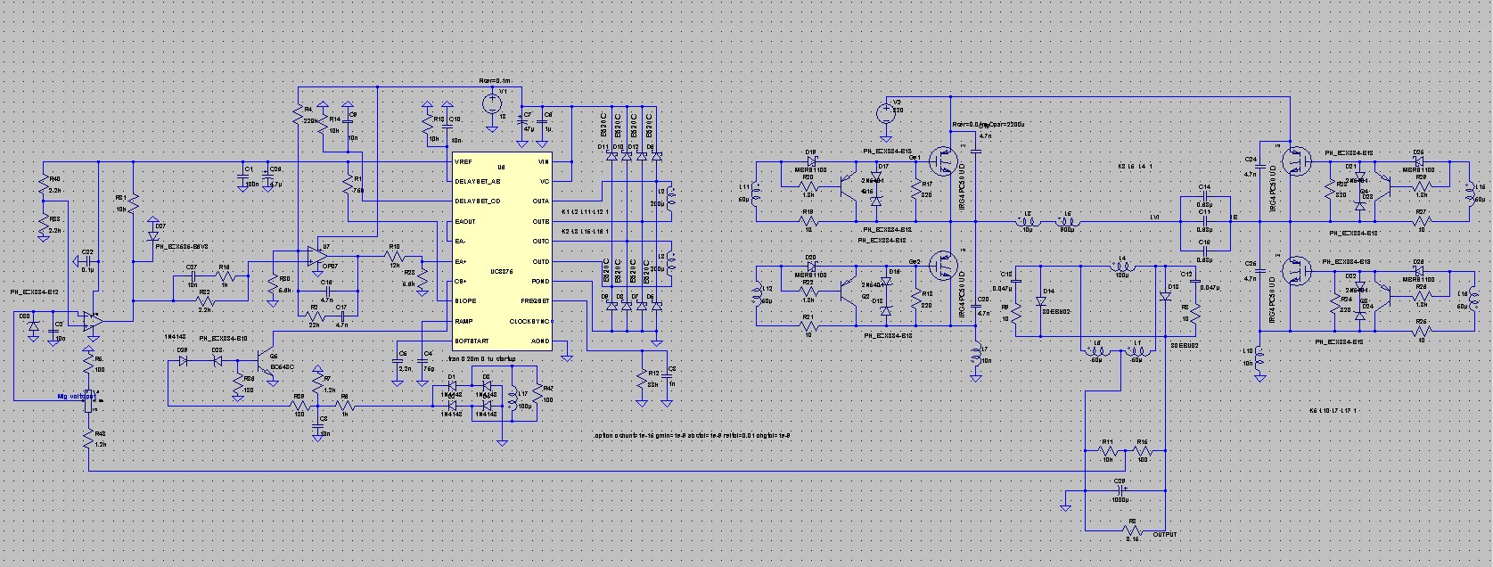

I have a project on the board of a smps for a hybrid amp output 2 x 120 volts 300 mA, 1 x 15 volts 5 amps, 2 x 65 volts 15 amps. I use a program for the calculations.
here some more doc,s,
(PDF) Optimal design methodology for LLC resonant converter

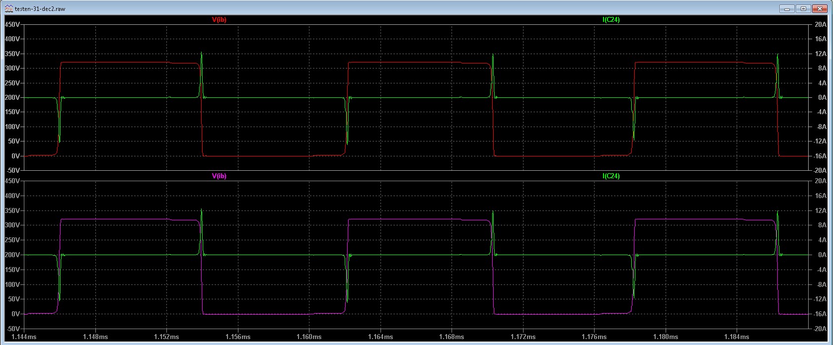

Here you can see what happens with a threelevel class d switcher, see that the deadtime is to low and partly hits crosssections. example is somewhat extreme.

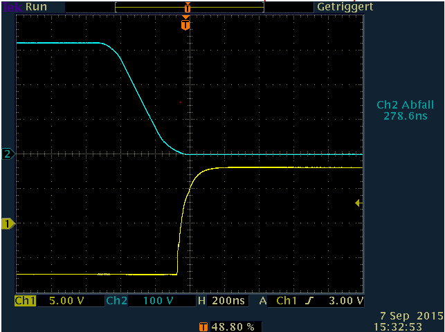

I thought that a small dip in gate voltage before turnon was the sure sign of ZVS?The gate signals exhibit small miller steps, so I assume there is no ZVS actually. .
No, ZVS means turn-on without any miller effect.I thought that a small dip in gate voltage before turnon was the sure sign of ZVS?

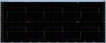

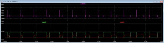

I have here a sim of a fase shifted inverter for welding 160 amps. here you can see clearly the pulses where the gate switch transitions happens, these caps get charged by circulating current and discharge, however a LLC is better for ZVS on all times the fase shift is only from a sudden power output.
This inverter is a own design making use of information from internet.
regards
regards

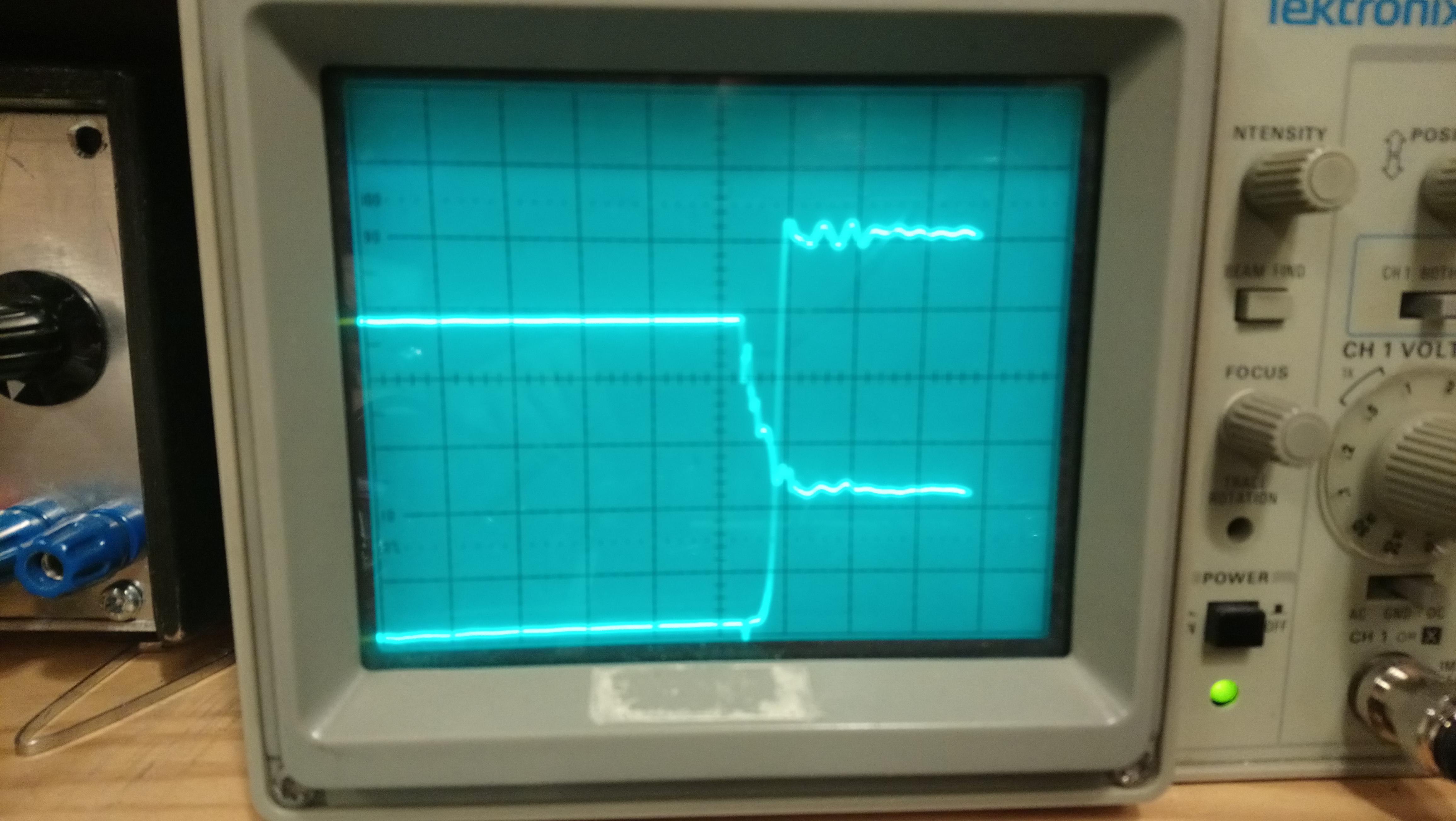

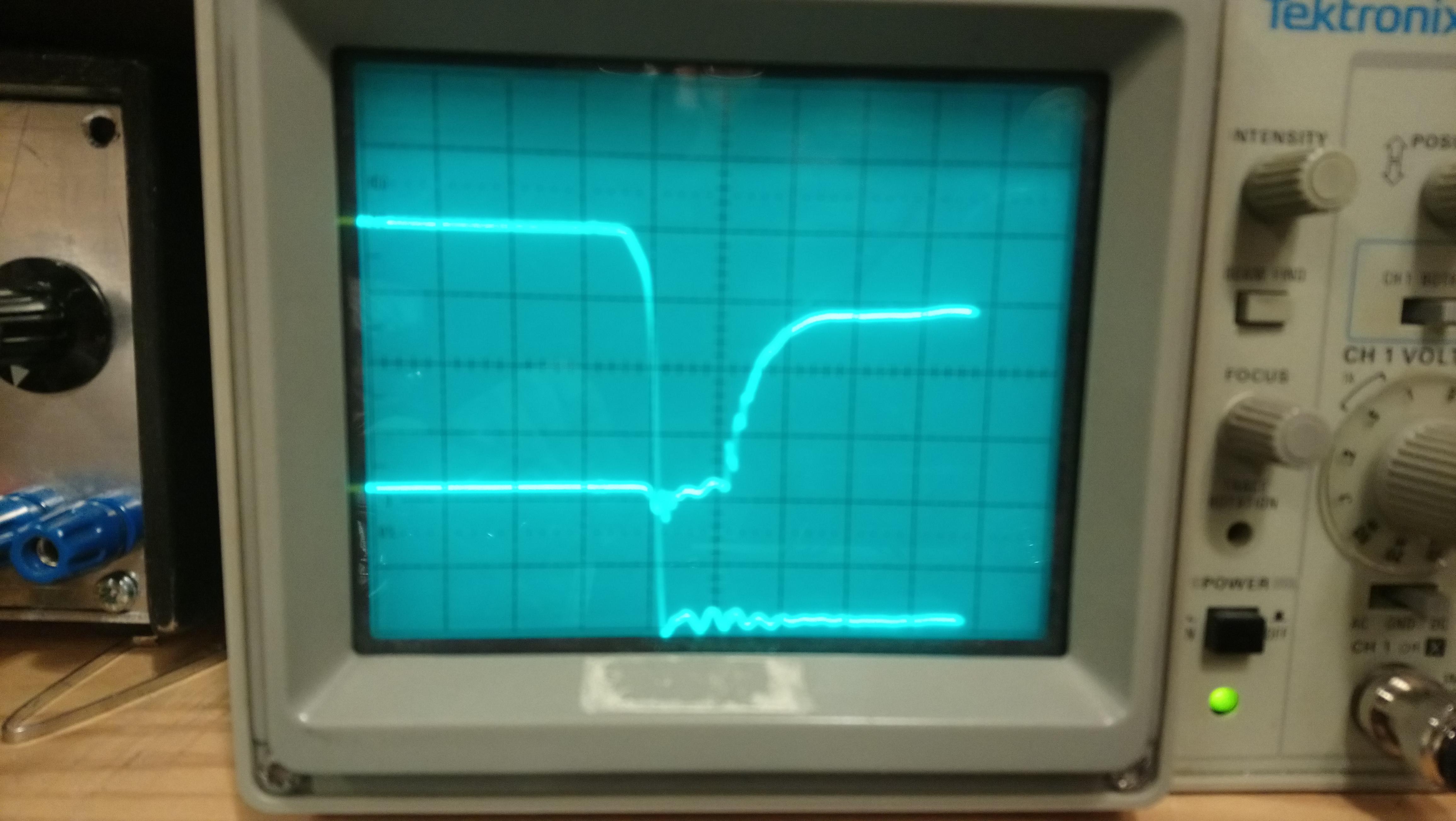

Before turnon gate voltage is about -8V, rising to +9V. My LLC operates with fixed frequency (=primary series resonant fq) and fixed duty cycle close to 50%. Considering these prerequisites the gate is driven ac-coupled using a coupling capacitor resulting in an ac gate signal.I understand the timing, but why dont the gate-voltage dip below zero before turnon?
HB switchnode and lowside gate with llc connected. Vcc 70Vdc. Gate is 5V/div. Switchnode is 10v/div. 200nS/div (good old tektronix 2225, 50Mhz.
ZVS yes?
Kind regards TroelsM
Looks like true ZVS during turn-on, maybe there is another problem
