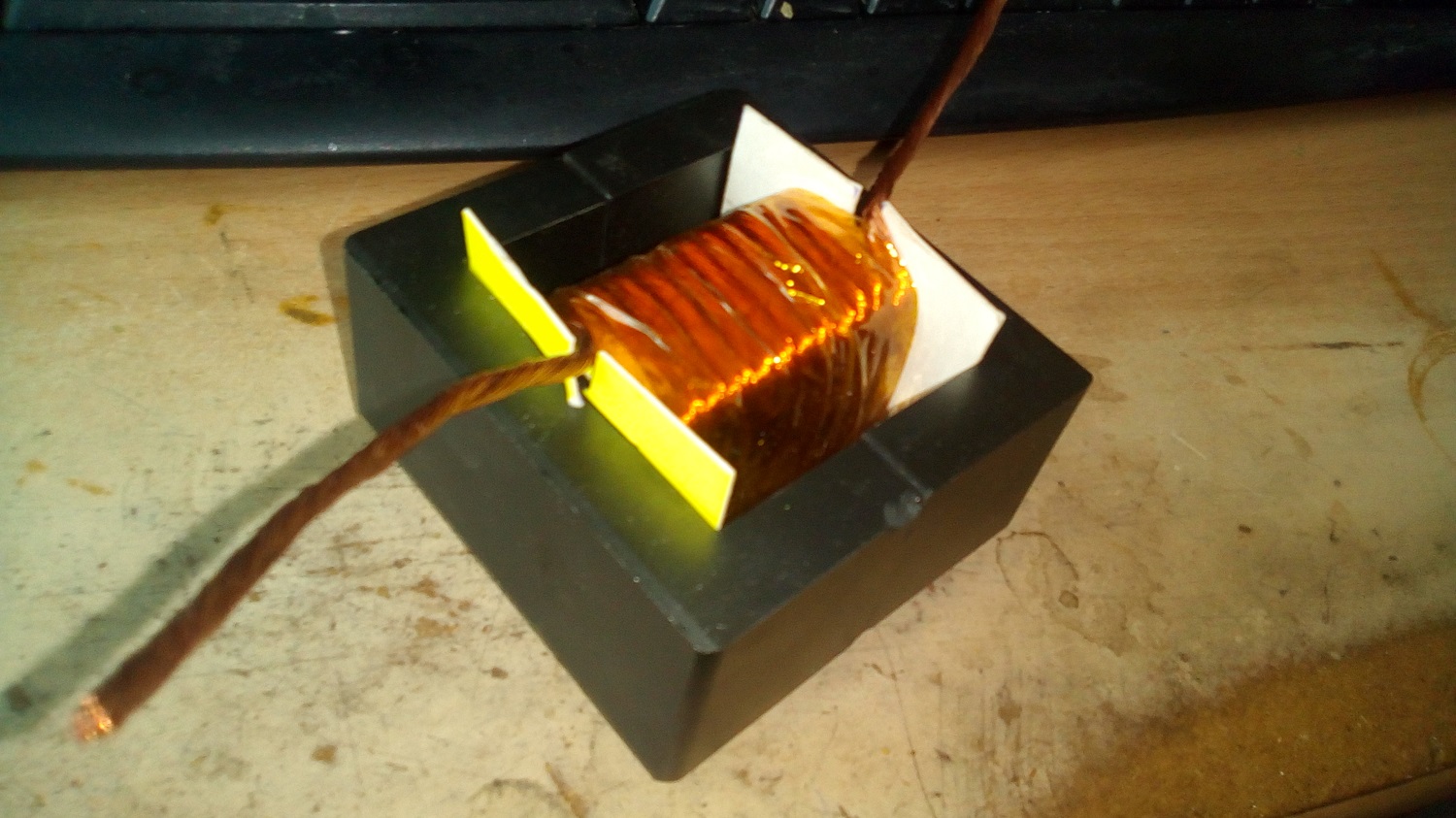

Just remeasured the inductances in xformer and the external coil. 17+75uH in total. Its low, but the peak output is 120v@8A so peak currents Will be high.
Xformer is approx 1cm2 cross with 0.8mm gap and 27turns primary.
Capacitance is 44+44nF

The cross-section of 1cm2 and 1kWac power are at the bleeding edge imho. I use a ETD39 to produce 400W at a resonance below 100kHz.Just remeasured the inductances in xformer and the external coil. 17+75uH in total. Its low, but the peak output is 120v@8A so peak currents Will be high.
I know that the peak-power is way higher than normally for this size core. I'm not sure how to design LLC's for audio where peak power is allways much higher than average power?

I tried the same setup with a smaller gap in the xformer. Like 0.5mm and before it was maybe 1.1mm. Can't remember the exact number, but it made a huge difference.
Mosfets are cold at No load and 10degC above ambient at 100w load. Not sure if the prototype can deliver the same voltage under load, and Im still dont fully understand why the gap made that difference.
Imductance changed from around 75uH to 110uH. Will re-measure.

Your test indicates that magnetizing current was way too high, so the MOSFETs heated up according to conduction loss Rdson*Irms².
You should learn to measure primary current and simulate the primary tank with LTspice.

A short test tonight, - and Im even more confused. Started with the smallest gap in the xformer and inductance was 400uH +20uH external. It works and regulates ok, but does not look like, ZVS. Mosfets cool under load.
Adjusted the gap to get the design-goal of 120uH +20uH external. It still works an we have ZVS, but Mosfets heat up?
My Best guess is that the lower inductances raise the ciculating current enough to tigger Cdv/dt false-gate-trig.
Kind regards TroelsM
