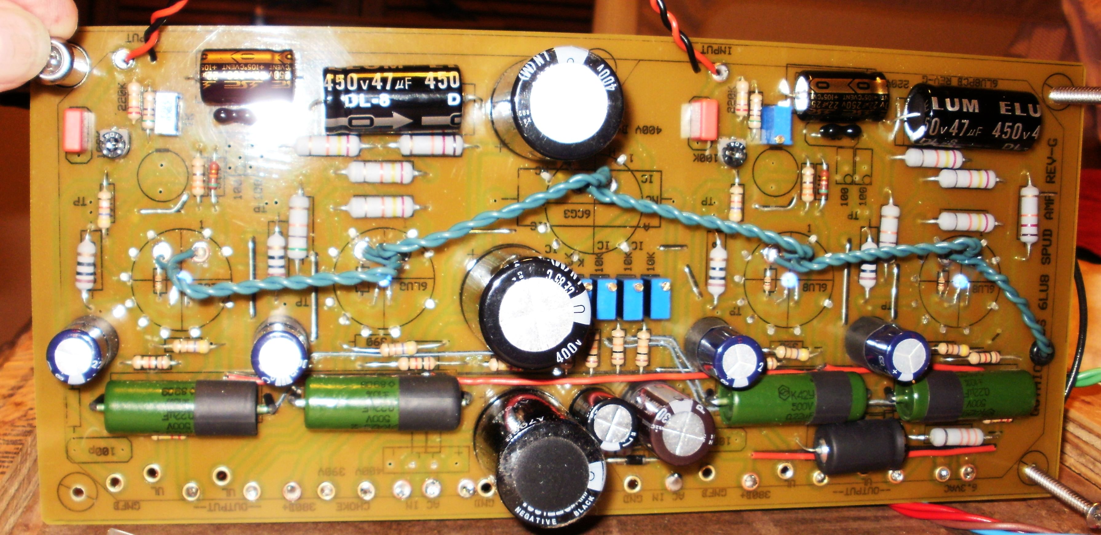

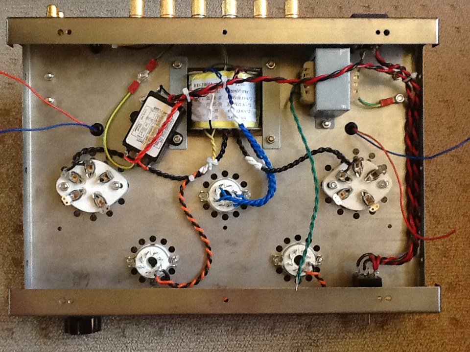

Solid cores are better for heaters as the wires stay where you put them. Screened twisted pair cables almost certainly don't have a tight enough twist to deal with the magnetic field. Stick to the tried and tested method: solid core, tightly twisted, no need for a screen if done properly.

The shield will suppress the electric field but not stop the magnetic field. A heater winding CT or humdinger pot will also deal with the electric field. Tight twisting reduces both fields for anything which is further away than the twist length, hence a tight twist is needed.

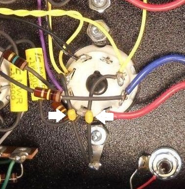

That won't work. Most B9A valves have the heater on pins 4 and 5, but some double triodes have a different arrangement involving pin 9 too. For these, such as 12AX7, you connect 4 and 5 together, then wire the heater supply to 4/5 and 9. Or you can use 12.6V on 4 and 5, ignoring pin 9.gkenne said:connecting pins 4 & 5 of the EL84 to pins 4 & 5 of the 12AX7s,

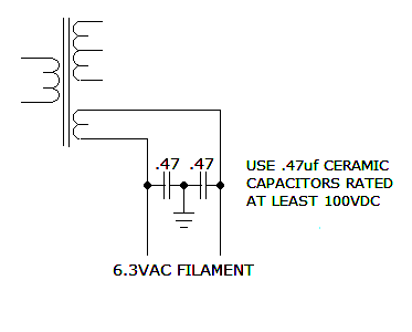

I've found that on filament windings with no center tap bypassing both sides of the filament line with caps works better to eliminate hum than a balance pot. I used .47uf @ 100V ceramic caps.

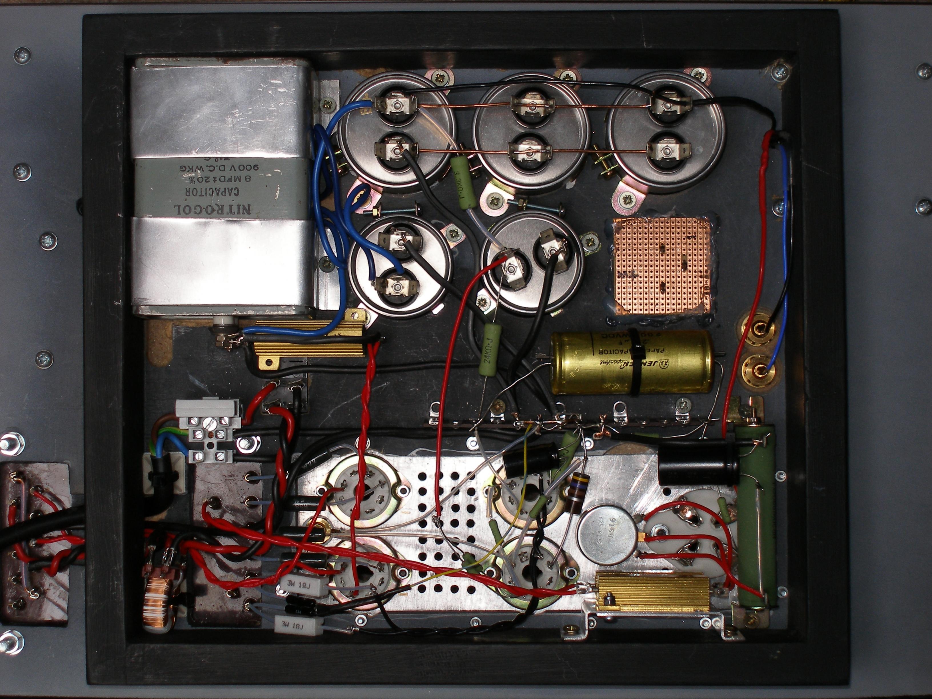

I'm getting 3.9mv and 2.9mv 100hz respectively at the terminals of my AC supplied JELabs 300B monoblocks. Nothing fancy here, just AC straight to a wirewound dropping resistor, routed around the outside and with a hum pot. I haven't tweaked it for optimum performance, just made sure the wires were twisted and placed to the outer edge of the chassis. Would be interesting to see what other folks are achieving and what measurement would be considered "No noise". (Now I've measured it I'm going to have to find out why I've got 1 mv difference. Damn!!)

If you wanted to use cathode bias on a DHT, but still use those .47uF bypassing caps for the filaments, where would you put the cathode bias resistor?
I should think you would just connect the resistor from filament to ground. But then the .47 caps would act like a bypass and boost at very high frequencies. I'm only familiar with DHT power output tubes and on a power tube you would want a decent value bypass cap. Might be best to use a separate filament transformer in such a case.
