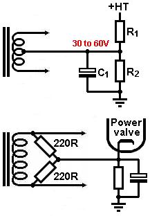

Just wondering about the lower picture from the Valvewizard site, if I only have one heater winding and I'm powering two or more heaters, is the artificial center tap referenced to only one of the cathodes or what? So would the best implementation be that I run the twisted pair from the transformer to one of the tube bases, put the center tap resistors between heater pins and the cathode, and then run another twisted pair to the other tube bases in a daisy chain fashion?
A heater circuit can only have one voltage reference. It doesn't matter too much what it is. If ground gives hum, try the cathode of an output stage.

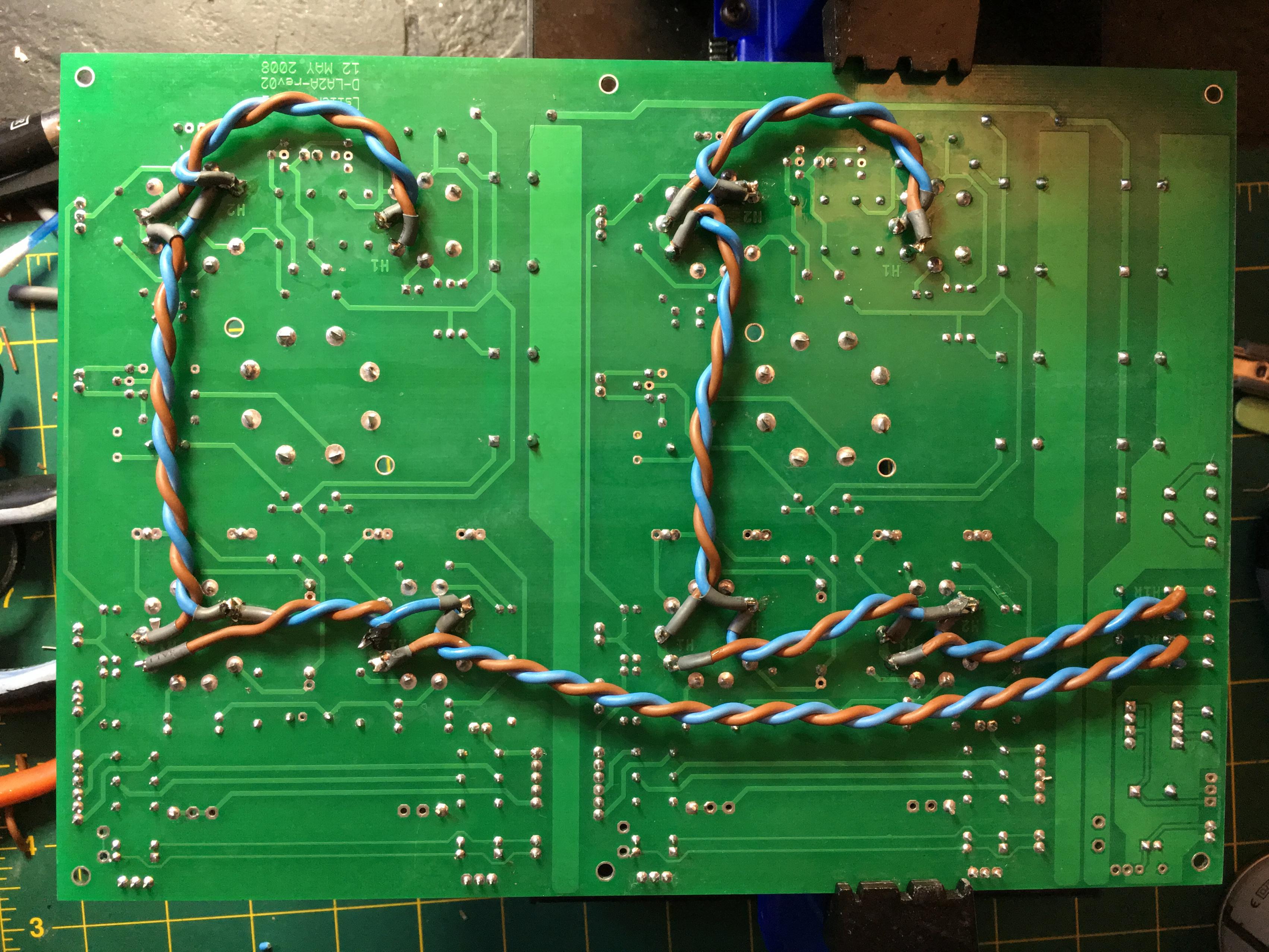

I would like to present my first attempt at heater wiring. I have tried to implement all I have learned from this thread. It is for the silent arts D-LA2A. I found that adding a little heat shrink was great at preventing the insulation from melting everywhere. Any tips on how to improve would be very welcome.
I would make the wires longer so that they can be placed parallel to the PCB at about an inch or so. That way you can avoid any accidental close coupling from a single wire a PCB trace where they cross. The wires then come away from the valve bases vertically. I use the technique in amplifier and it is completely silent at mains frequency. My photo shows the wires above the components on the other side of the PCB, but the principle is the same.
I was hoping to squeeze it into a 2U case. If I can't and it has to go into a 3U case I might redo as you suggest. I guess I should test it first and see how it performs like it is. However I still have the transformers to up save for, which might take a couple of months.
