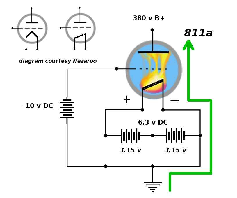

I've made a chart to help understand the Direct Heated Triode problem:
The 811a is a good example, because the heater-voltage is significant, and the bias might reasonably be set quite low, even zero volts, or a +ve value for class A2 operation.
Click to Enlarge:
The very nature of a tube is such that the grid, with very little voltage, can control large current and voltage swings through the plate.
In part the reason why this works is that the grid is much closer to the cathode than the plate, which carries the High Voltage attractive force. The greater distance of the plate in turn lessens its influence.
It follows that small changes in distance between cathode and grid have the same effect as small changes in voltage on the grid. Although distances can't be changed, the effects can be understood by the analogy of distance.
For this purpose, I've redesigned the diagram for the triode,
in order to simulate the effect of the difference in voltage at each end of the cathode,
and its influence on cathode current flow through the screen,
when D.C. voltage is used instead of A.C. .

Rongon had asked:
"Could one heat the filament with
a well-filtered or regulated +3.15V and -3.15V supply?"
The answer is that using a split-supply would make no real difference,
because the effect here takes place INSIDE the tube.
Secondly, looking at the diagram, one could in theory ground the cathode in three places, at either end of the D.C. supply, or in the middle (of a split supply).
But grounding in the middle would be disastrous, for another reason:
Instead of flowing directly to ground from cathode,
a center-connection would cause the plate current to flow through
the INTERNAL RESISTANCE of the power-supply!
This internal resistance will be unknown, and unpredictable.
For one thing, this resistance is likely to vary with current, heat-effects, and frequency-sensitive factors.
Thus,
(1) There is no advantage in relation to the cathode emission in using a split-supply (i.e., +/- center-tap).
(2) There could be a serious negative effect on the quality of the plate-current through the cathode to ground.​
Lets look again:
Click to Enlarge:
While a center-tap connection is not beneficial,
it indeed DOES make a difference which end of the D.C. supply is grounded!
If one grounds the +ve side, one can force the current
to flow all the way along the cathode. This will equalize both current loads and temperature across the cathode.
In the diagram above, the -ve side is grounded, exasperating the imbalance.
Could one not simply switch heater connections every few hours of listening by means of a toggle switch?
After all, a situation 1.4 x more severe than this (as far as voltage differential) is concerned arises 120 times every second under AC heater operation?

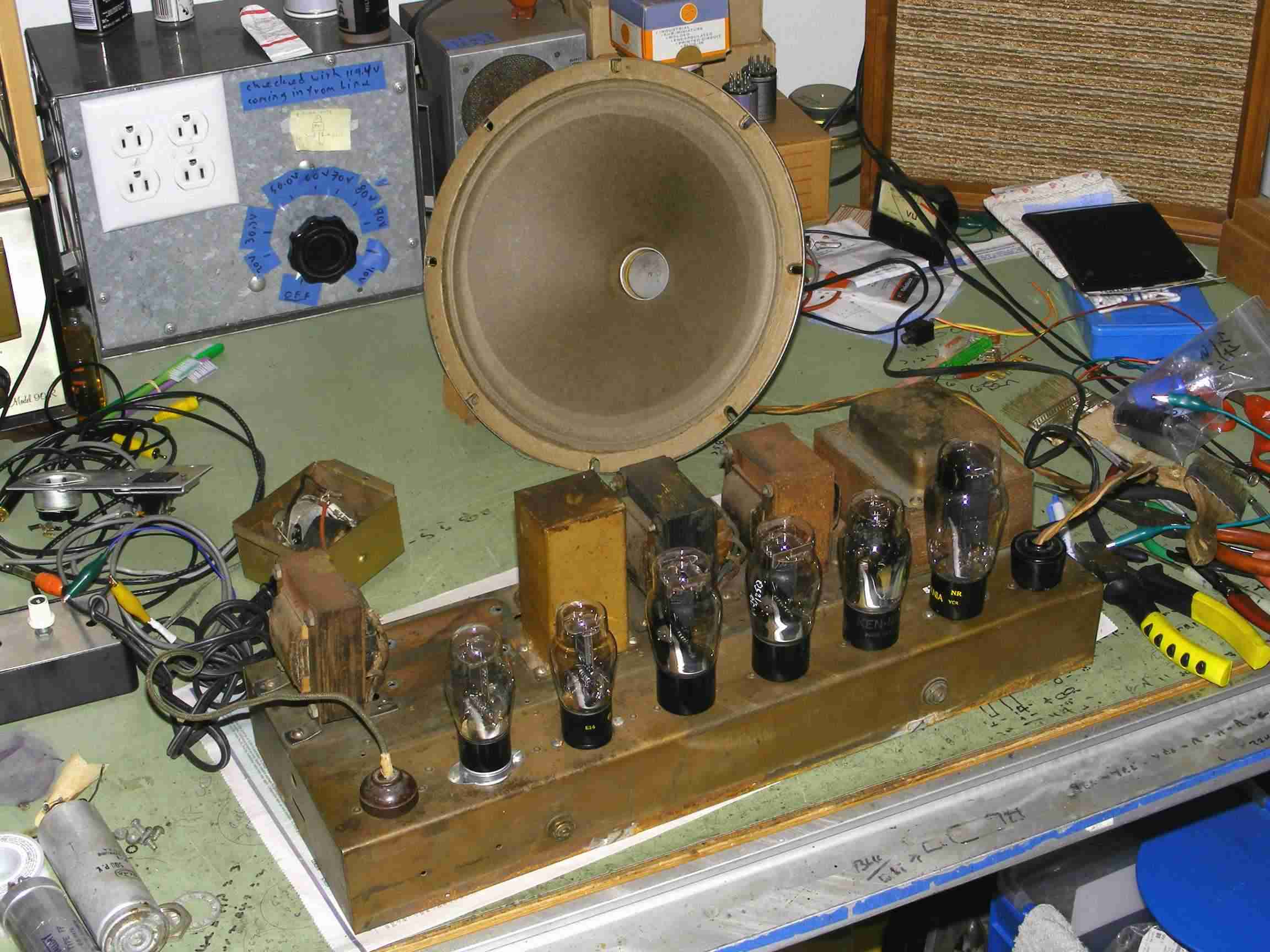

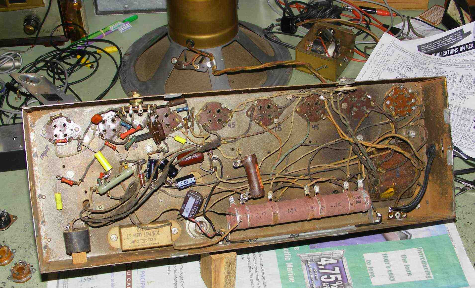

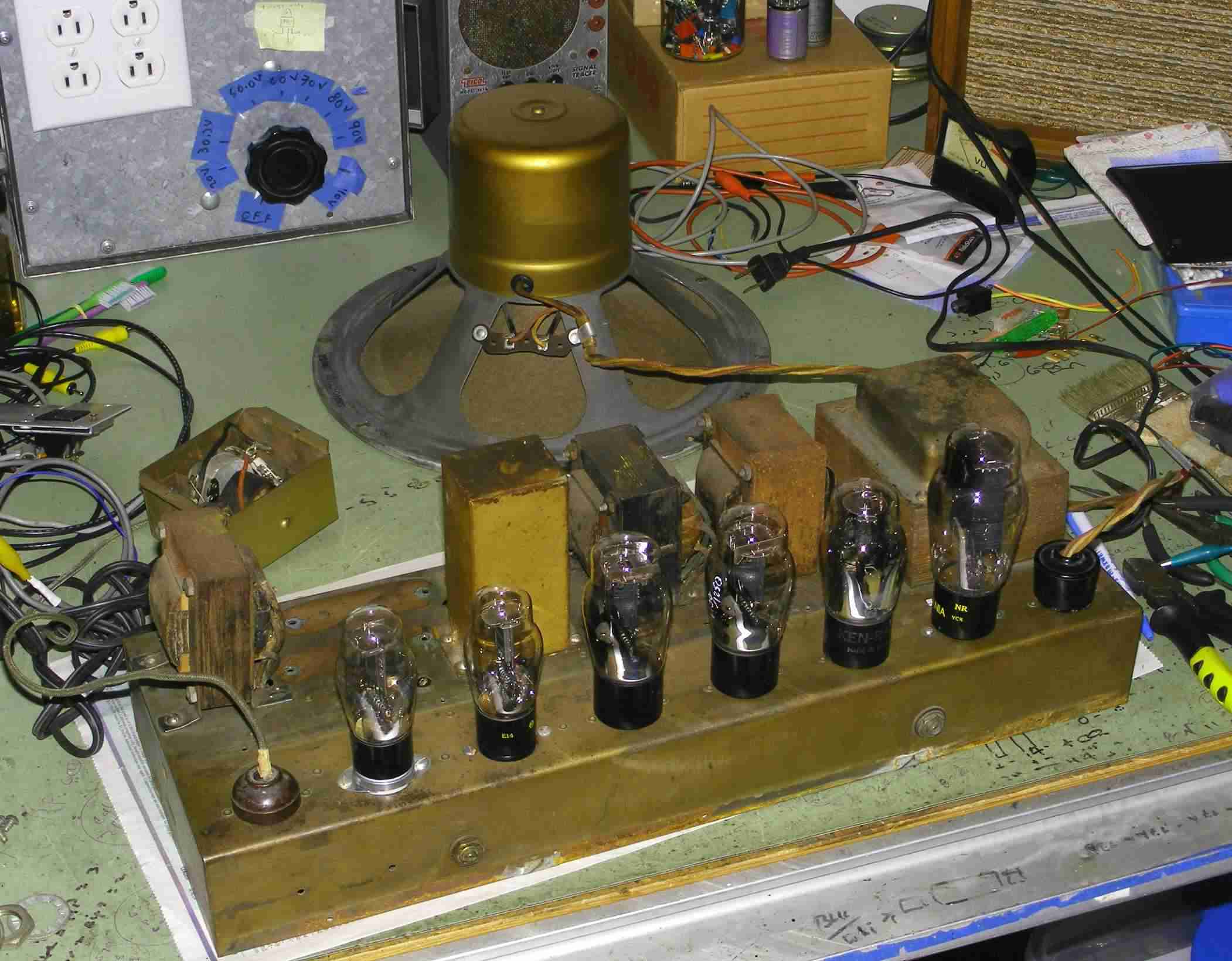

While all you are saying is basic and true, you do not know enough about tube amps to really write a tech article covering a lot of time span where various tecniques were used for circuit design.
A. The amp in the picture is a 1935 Seebburg jukebox amp, has a nice sweet tone, very good sonics, good frequency response and dead quiet.
There is a hum balancing pot on the front between the #80 rectifier and one of the #45 tubes. I found this pot had a spot where the hum just vanished, and I mean audiophile quiet!
This amp uses one #45 backwards to provide negative bias for a fixed bias, class-A output, and a very tricky circuit.
This amp is similar to a SE amp, driver transformer with one #45 driver, two #45s out, one #45 bias rectifier
Early amps and Radio transmitters were designed by radio men that knew tubes, and early gear had no hum, a complete myth, as they used good wiring, grounding and tube design to make it work.
This amp, with it's looney wiring, you would think would hum and be unstable, but it is quiet as a mouse, and rock stable.
This amp, is, compared to some of the early amps I have re-stored, actually pretty nice inside, Silvertone small guitar head amps a total mess inside, and others, but all the high-gain guitar amps I have worked on have almost zero hum, AC filaments.

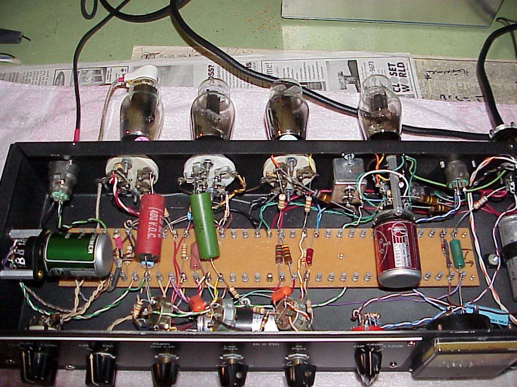

Part of this is the tubes themselves. The mike preamp with the four tubes is one of a group of early style preamps I built, all out in studios, all used every week, and no re repairs, blown tubes or any problems in seven years!
These us a 39/44 very early pentode a #37 buffer, and two #76 triodes in parallel to drive the out transformer so they can run up to +12DB out/600 ohms.
These five-pin tubes were the first group with cathodes, and cathodes were designed to combat the AC hum problems and mostly disconnect the audio or RF signal from the filament.

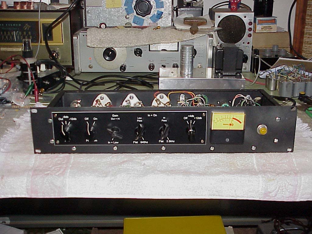

These preamps use DC for the filaments, and all my gear uses a transformer, bridge, three stage filtering, then a TIP31C transistor as a "choke" filter, for noisless DC to the tubes
I would always use DC, but I am saying that if you had the adventures of being old enough like me to have been inside so many old radios, amps, transmitters, you would know that tubes have a sneaky way of not doing what all your CAD design programs say!
