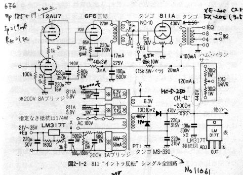

In japan , Shishido amp exists.
Dear Guys, My name is jun.
In japan , Shishido amp exixts, it has + grid single amp,and DC heater power supply.and low bias.
But , in japan , these amps are working very well for these past dozens of years. In Japan, is anything different?

Dear Kay Prinha san
I found below doc.
http://www.tentlabs.com/Products/Tu...Filament_supply_Application_Note_V01_AN02.pdf
They(tentlabs) said that "The + side of the filament goes to groud".
It is opposite of your figure. European people have different thinking.

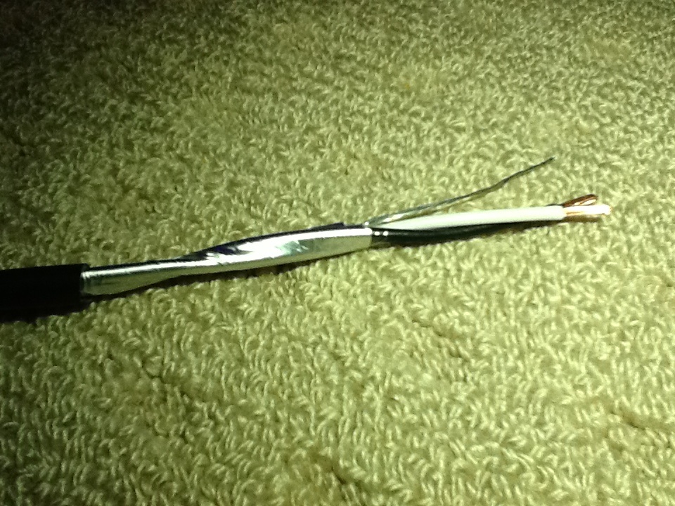

Shielded cable for heater wiring
Any thoughts on this cable to connect tube heaters the cores are stranded but they are twisted and more importantly foil wrapped with a drain wire Whitchurch can be grounded to keep the ac signal in
