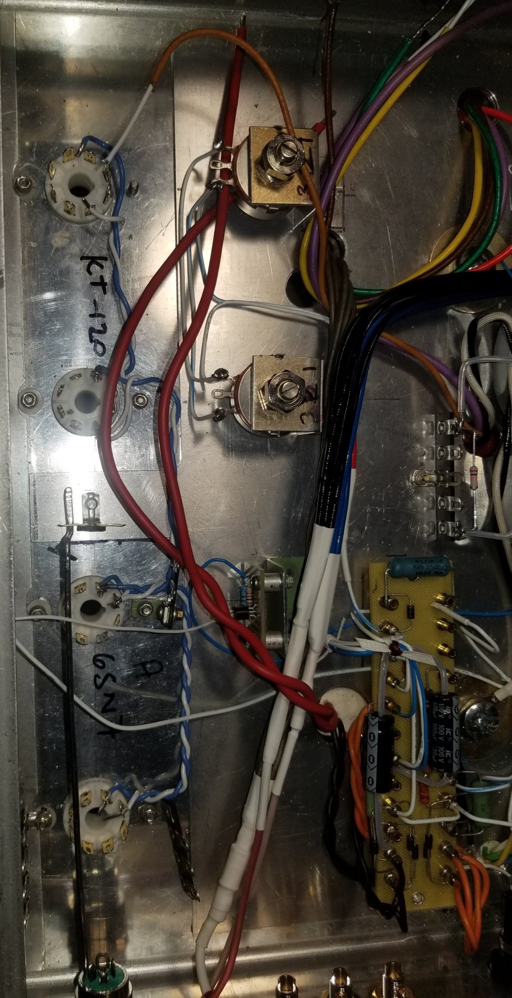

A suggestion on how best to connect the heater wires (thick red wires) coming from the transformer and going to the tube socket. I was thinking to keep the run short and connect the the first stage tube 6sn7 on the bottom. Another option would be to run to the last power tube (top
So basically I'm asking if it's best to hook up the red heater wires to the first tube 6sn7 and keep the run short or hook them up to the last tube (kt-120) and have the run long. Because of the thickness of the wires and the size of the holes in the pins i can't fit more than 2 wires in any one hole.

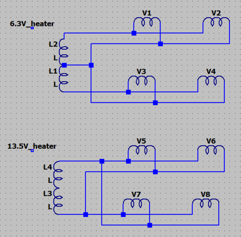

I am building an amp that uses 4 x 6.3v heater tubes that also have 13.5v heater equivalents (E/PCL86), and I'd like to make it possible to reconfigure it for the cheaper tubes. I have tried to solve this by having 2 * 6.3v heaters in two parallel tracks, ending in two pairs of 2 * screw connectors. My transformer is 8-0-8 3.2A, so I have to add a bit of resistance to support both types. Either one half of the heater supply supply one parallel pair, or the whole heater winding supplies two parallel pairs in parallel (should be clearer in the diagram).
If this is not a testbed, then I think it is prudent not to defer some of the more fundamental decisions. The heater wiring does make a difference, and once it is done, it is hard to get at it again and change it if you are working point-to-point.
