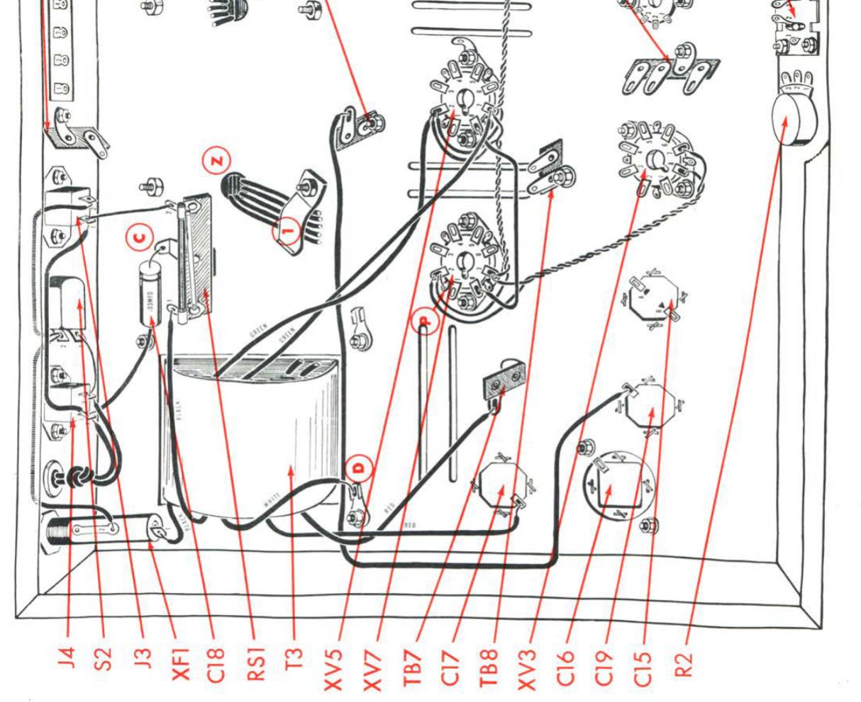

There probably isn't a great reason but then I'm not knowledgeable about that HF87, usually wiring is a kind of compromise between several things such as shortest path, mid point, ohms law, noise pickup, tidy thinking and obsessive behaviour.
A first consideration is always safety, safety, safety.
This is probably because if you wired XV7 first, you'd then have to go back on yourself or run a spur. Not familiar with the valves in question, but another reason might be because they've wired the wiring to the highest current heaters first, followed the next lowest in current draw.
Andy.
Andy.
Looking at it again, maybe they did that to keep the wiring symmetric with the other half of the stereo setup. If they wire XV7 first, then the wire length to the other channel is longer.
