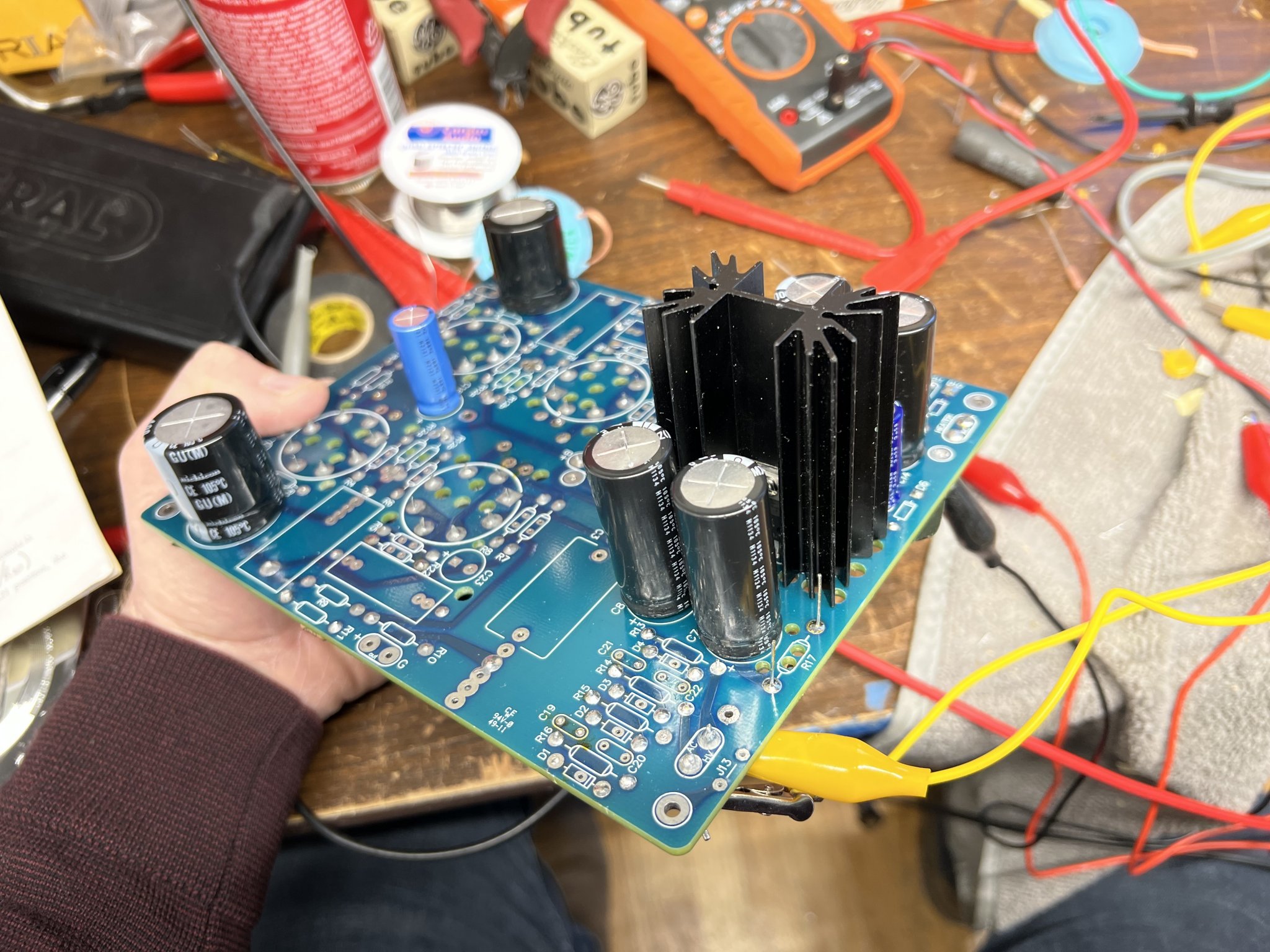

What regulator and heatsink are you running? My kit came with an LD1085 and this massive heatsink. It's the single largest component on the board after the tubes, and is the limiting factor on case height. I'd like to fit something shorter if I can, but I don't want to under-size it.
Same LD1085. I think he said either 2" or 2.5". I bought 2.5" when I was thinking 3" case. So with 1/4" spacing on top, my heatsink ends up right at the cover.

Ok, I have the 2.5” one. I mounted the tubes on top and the caps and heatsink on the bottom, so I can mount board to the underside of the top panel and let the tubes poke up through the top. That’s adds a bit of necessary case space… I’ll have to see what I can do, it’ll probably just end up being kinda tall. Maybe I can dismount the regulator and hook it up with some wire and mount the heatsink horizontally. I did that on my power amp build.

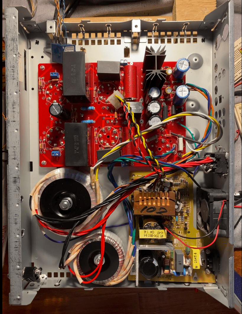

I took old cable box for the chassis but turned out the steel chassis gave a loud hum with PT. The only way to get away the hum was I had to raise the PT 5" high with wood and 4" away from the tube. So I save this case for E/L core PT for another project. Currently working on aluminum chassis for this where aluminum doesn't have hum problem with Toroidal Core
Very nice, thanks for the pictures! My plan is to build a case with wood and brass plates. The kit I got was filled-out by a member on here with the toroids. I'll see how they work. I have pots for them coming from China, so I'll see if that makes a difference. If not, I've been looking at some Hammond E/L core, and they aren't expensive.
I'm setting it up in a temporary case for now, so I can play with it while I build the chassis. I'll send you pictures later once it's done. I think you'll enjoy 😉
Put the toroids 2" from the pcb behind the PS, then you're fine. That's where it doesn't encounter the hum. No on right/left side of the tubes. So you're looking like 6x12. I am going for 8x12 wood, and aluminum on top for pcb. I think toroid has magnetic all around so it causes hum with steel chassis.

What do you think about putting the toroids on top of the case in pots, like traditional tube amps? I plan to experiment a bunch anyway.
I definitely plan to bump up the amps, either if I need to switch to e/l core, or if I measure >2A current draw on the heater circuit. Interesting idea to go high voltage on B+. Is the idea that the bigger R12, the lower the ripple, more or less, period?
I've got shielded microphone wire I plan to use for the final I/O setup. I figure that should work pretty well.
I did try on top too. Testing with steel chassis so i don't know about aluminum yet. However, I put PT on top of 2x4 then no hum. The best location is in the back. Shouldn't be problem with e/l core, I tried Edcor without problem. Big R12 will lower the ripple, 3k up is good.
