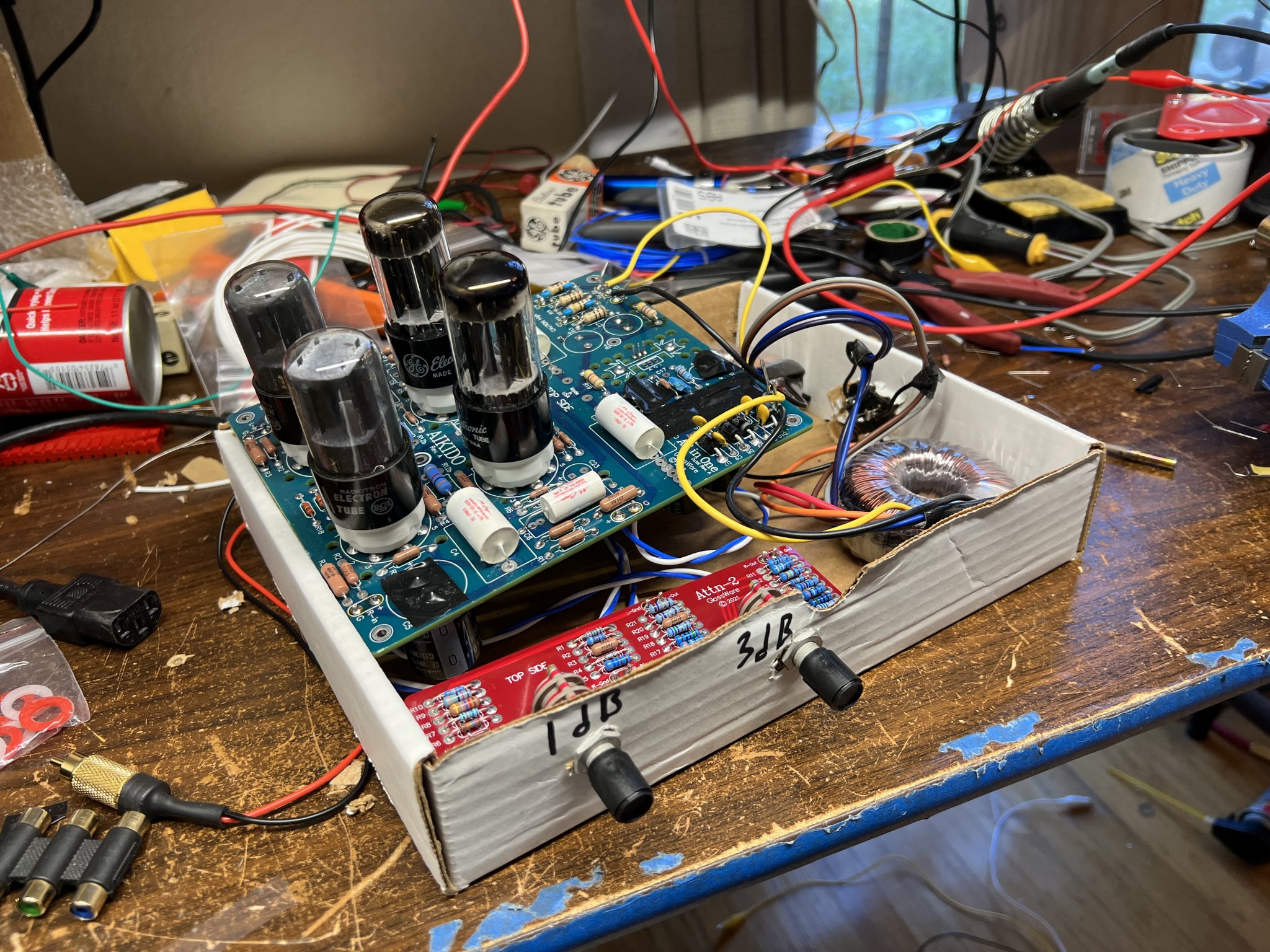

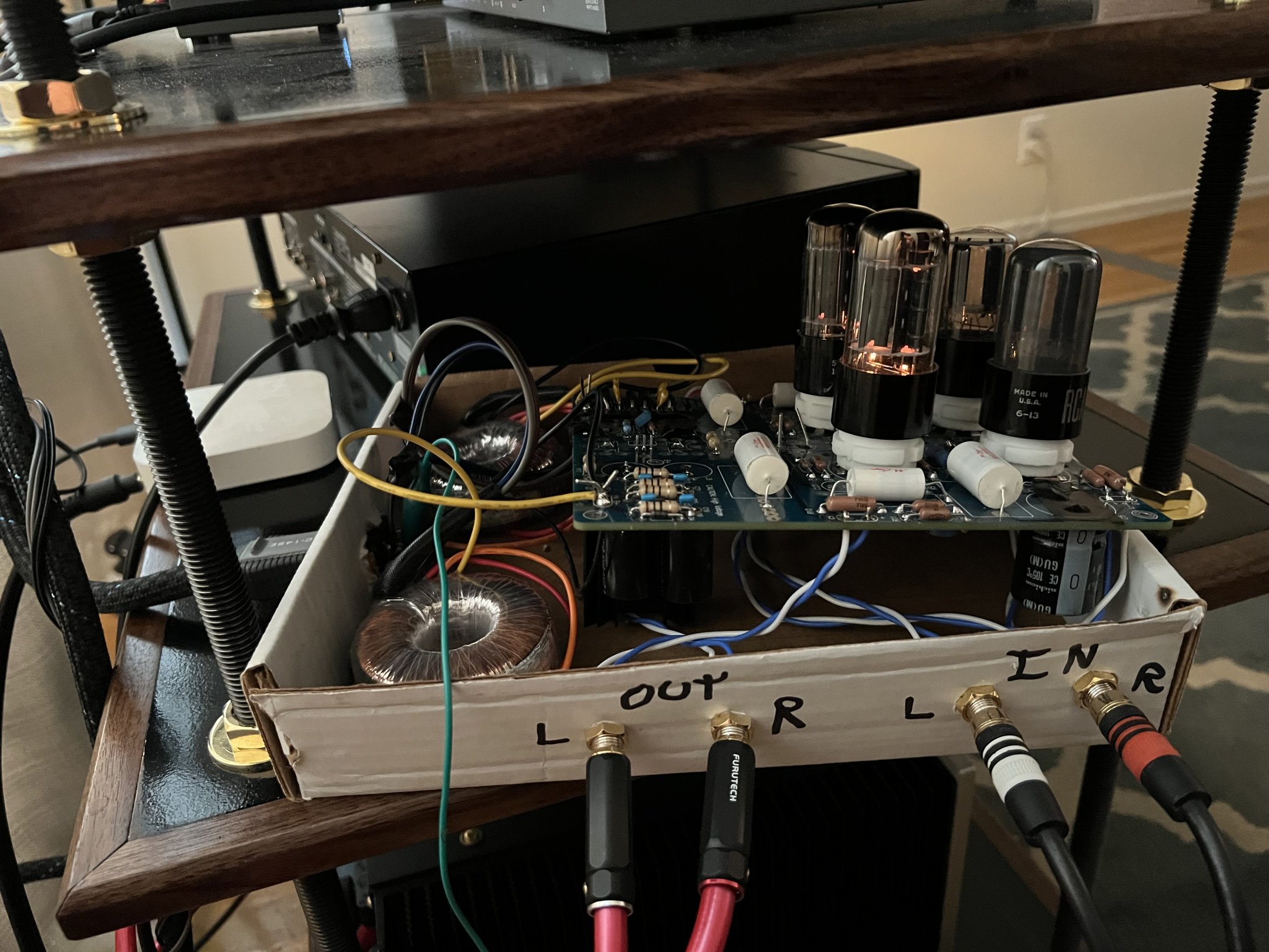

Alright, installed in a case! It works! Room EQ Wizard reports 0.05% THD, but it's ugly as hell, and there's a 60 Hz component up to +60 dB, which somehow didn't show up on my listening tests. One of the 6BL7's lights up a lot brighter than the other, but it follows the tube, not the socket. I'm gong to continue experimenting with ripple, try some new caps, and see if I can observe ripple on any of my instruments. I'll also switch my focus to building the case, so I can have something proper to work in to isolate noise and grounding issues.

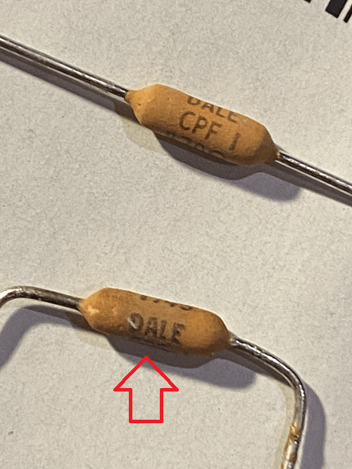

My hum problem was 2 parts: the PT location, then a bad resistor on one channel. Took a while to figure out the resistor. Then dead silent after that., no more hum. I haven't put on the scope yet so I don't what it would show.

How did you track down the resistor? Did it fail open or short or something?
It was hard. At first I thought ground loop or the input with the pot. then compared every single point on both side to find out 1 voltage lower. The burn resistor dropped to 100R from 300R but still work though.
You can see the light burn in the middle compare with a good one on top
