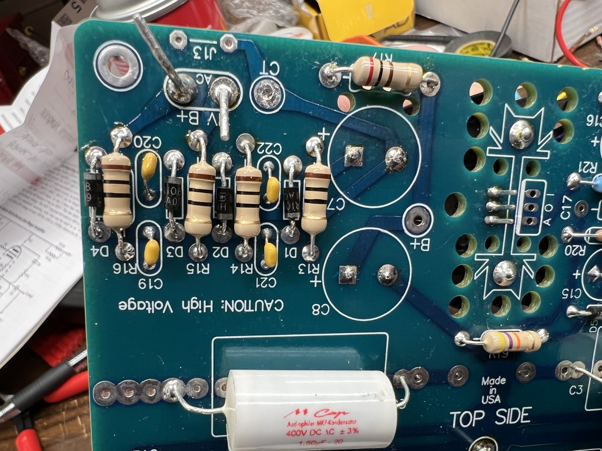

OH fickig sh!t, your'e right that 2 D would create C.T....lol.....Actually, I show what the option 2 look like
If your PT has C.T., you only need 2 diodes on top.

Yeah, some of the diodes are mislabeled on the A and B sides of the board, too. Not really a “beginner” kit. Oh well, I’m sure I’ll figure it out eventually.

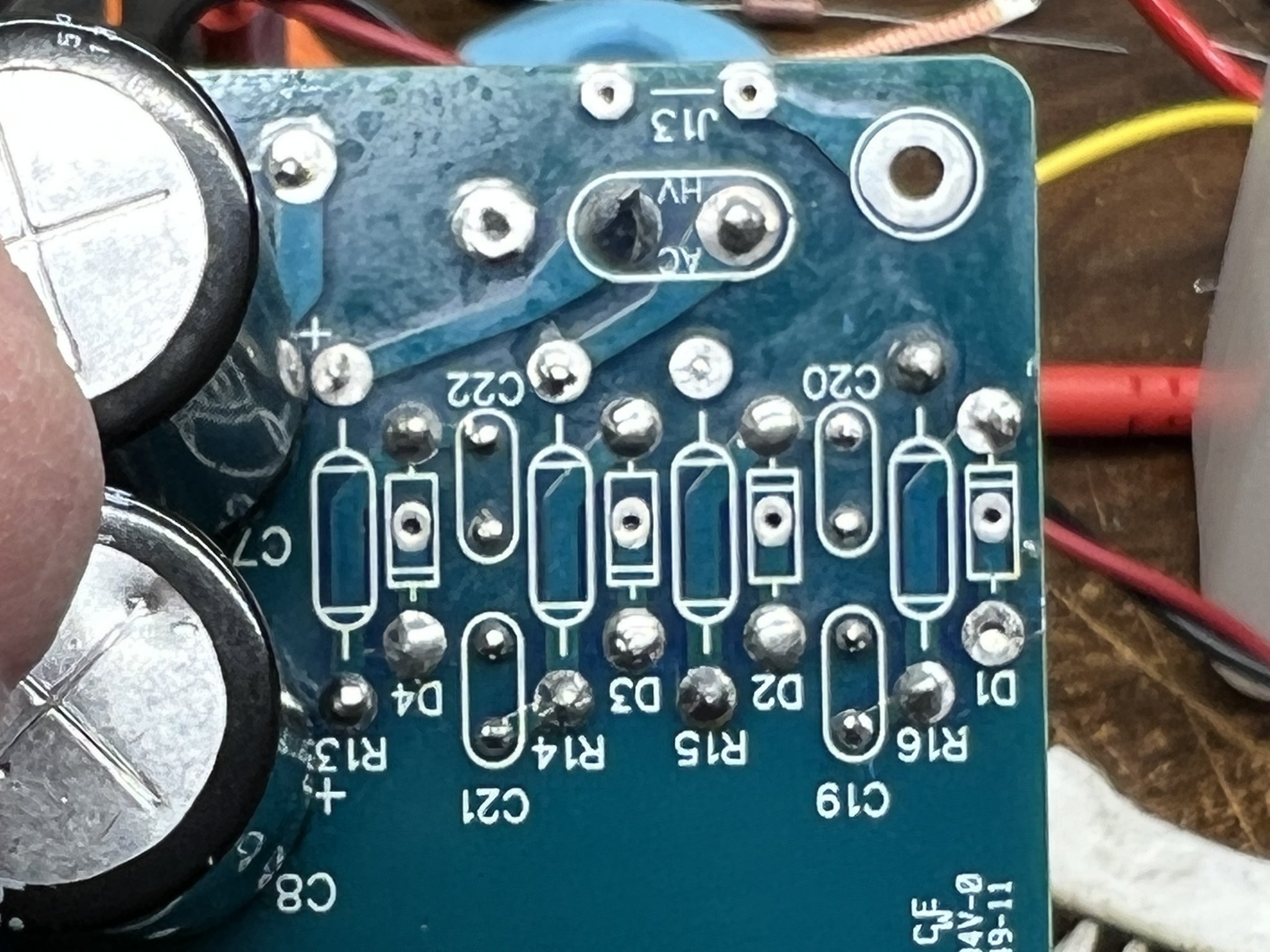

Can you take pictures both top and bottom, I can take a look at the traces. And keep the PT away from any metal when testing.

All yours Ds are correct

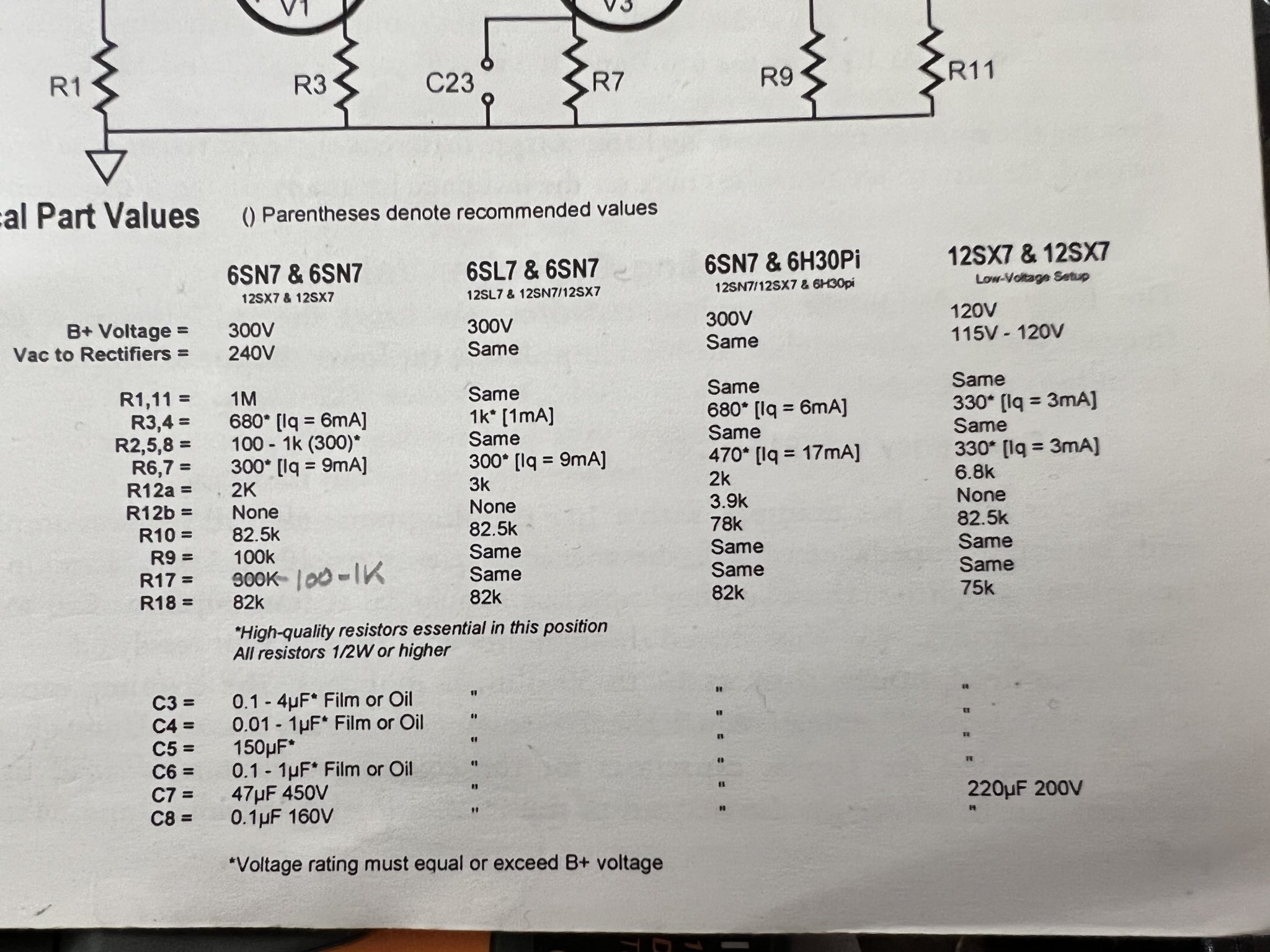

The manual suggests a value of 47uF to 300uF for C7 and C8, with suggested values or 47uF for 450V or 220uF for 20V.
For C6 I followed the suggested range of 0.1uF to 1uF. Why do you suggest higher? How did you select a value or 10uF?
I think I found the cause of the hum. I think it was one of the filter capacitors in the bridge network (C19-C22). See my other thread for more details.

I took my values from the attached table, considering I’ll be using 12sl7’s as my driver tubes.

The C6 statement was from John and he told me use 10uF
47uf is the max for the tube rectifier.
No benefit to more than 220v. Most use 100uf or 150uF for preamp with diodes. And 220uf and up are big that won't fit on your pcb.

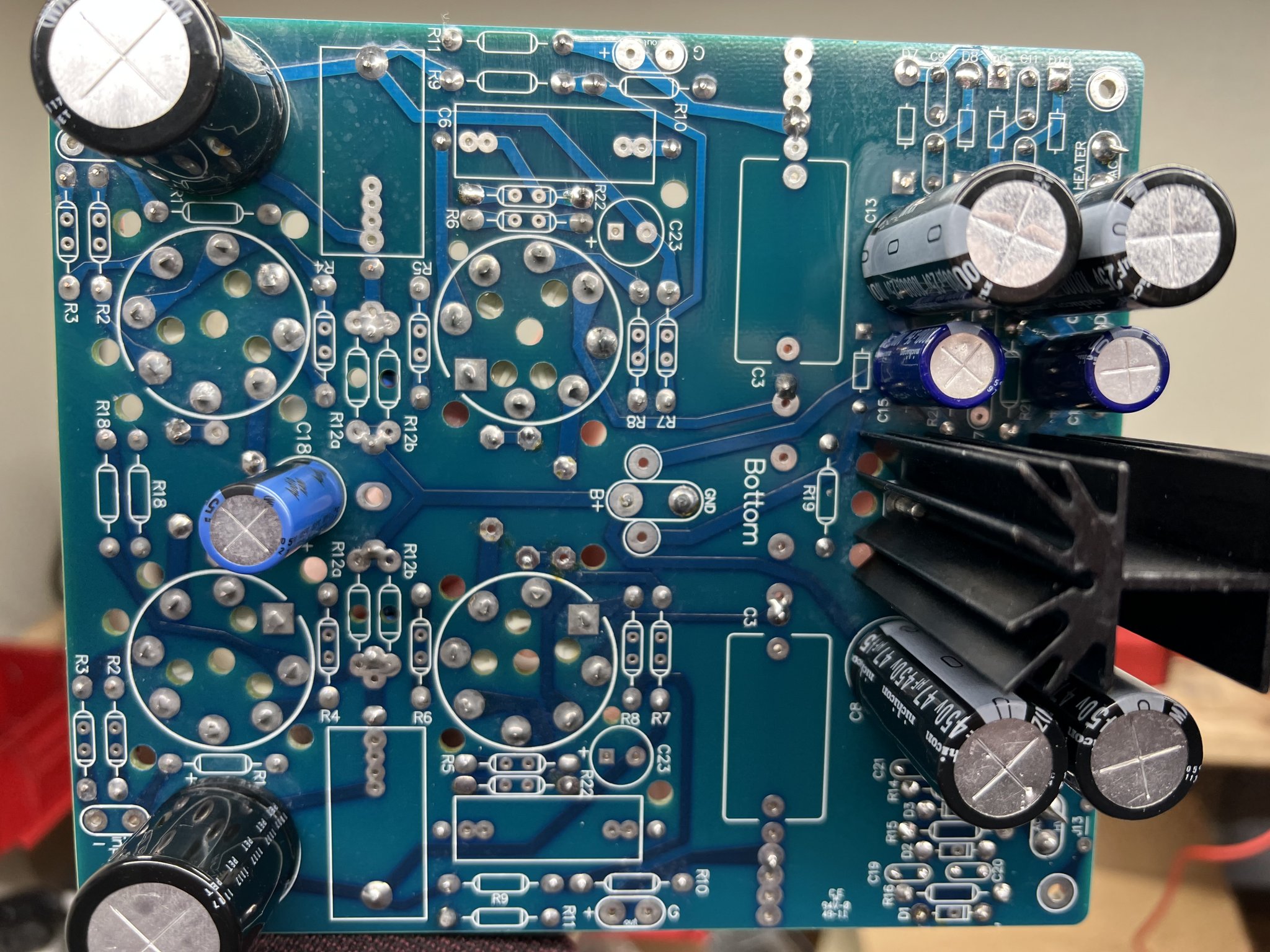

Check both C5 caps again, the top one in the image, look like pop out.

For C6, the math is 159155/C6/R10, right? That gives me a -3dB point of ~9 Hz for my R10 of 82.5k, and ~0.2 Hz if I switched to 10uF. Seems good. Not sure how I chose 0.22uF.

Rechecked both C5’s, they seem good.
I’m running 12SL7, not SX. Happy to boost R17 though, I have a 470R part on hand I could drop in. For R12, I was just following the guidance in the manual.

I followed the voltage guidelines on that attached scan. I believe I have configured the jumpers correctly for the 6BL7's to get 6.3v as the (top) output tubes and the 12SL7's to get 12.6v as the bottom driver tubes. J4 and J6 are disconnected.
