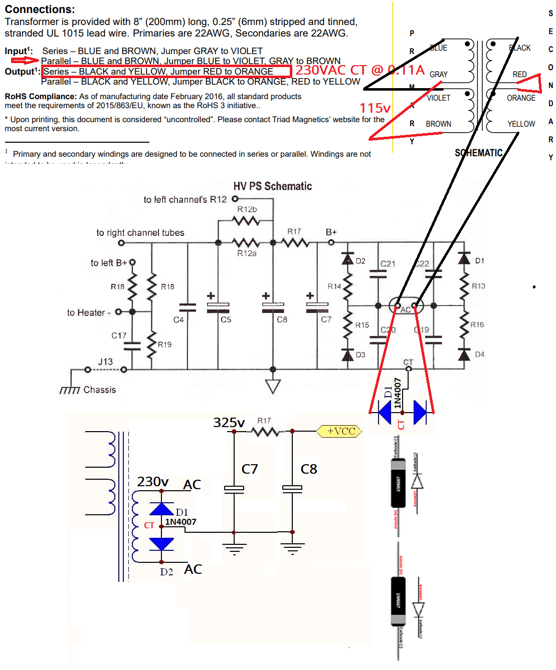

I powered up just the heater supply for this board with no tubes as my initial test. I'm getting ~7.6VDC from H+ to G, and 0V from H- to G. The transformer is a Triad VPT12-2080: https://www.mouser.com/datasheet/2/410/VPT12_2080-781423.pdf. I've wired the inputs in parallel as per the data sheet as I have 115VAC power. I've wired the output in series for 12VACT CT, as per the data sheet. I'm getting 6.8VAC between the Black or Yellow secondary wires at the Red/Orange pair, and 13.6VAC across the Black and Yellow wires. Input power is set to 115VAC with a variac.
I configured the power supply in the Full-Wave Center-Tap configuration in the attached scan. Black and Yellow transformer secondary wires go to the A C connections, and the Orange/Red wires go to the CT position. I omitted D10, D9, C11, and C12, as per the diagram for the Full-Wave Center-Tap configuration.
The fact that I am getting a stable voltage that is approximately 1/2 of what I am expecting makes me think I have misunderstood some aspect of the power supply / transformer configuration. Either wiring the transformer incorrectly, or configuring the power supply incorrectly. But, I'm not sure what exactly I've done wrong.

Should measure H+ to H- . I think you would get 12v-12.6v,. Even set at 115v but the outlet 120v, you may get a little bit more at secondary.as 13.6vAC

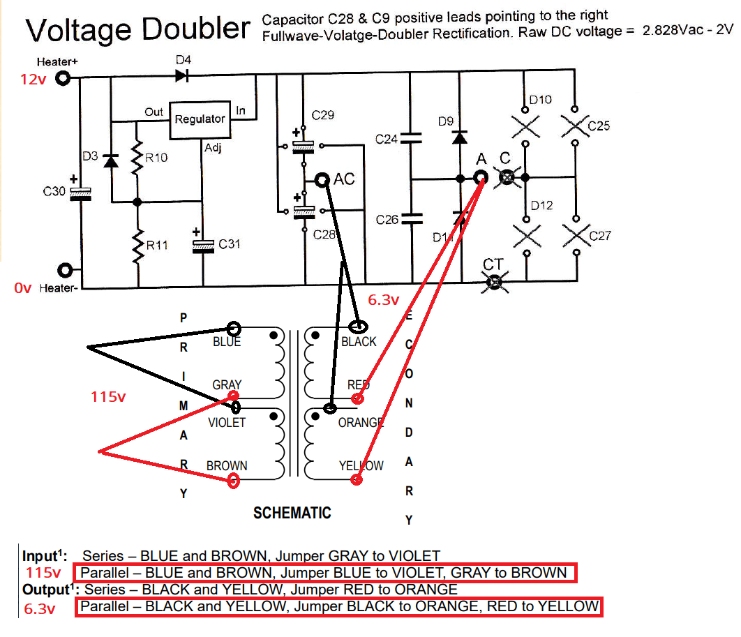

You must run Voltage Double because the PT doesn't have center tap
Reactions: SoaDMTGguy
H+ to H- reads the same as H+ to G. H- to G reads 0.
The data sheet says "Output Voltage: Series: 12VAC CT @ 2.08A". Does that not mean that if I connect Black and Yellow to the A/C inputs and connect Red and Orange to the CT input, I should have center-tap? Or do the primaries and secondaries have to be run in the same configuration?
I rewired in voltage doubler configuration, and I'm getting 12.56VDC across H+/H- now. Makes sense that if I was getting half the expected voltage running "voltage doubler" would fix it. I still don't understand the transformer nomenclature, but that can be for another day.
Thanks a lot!

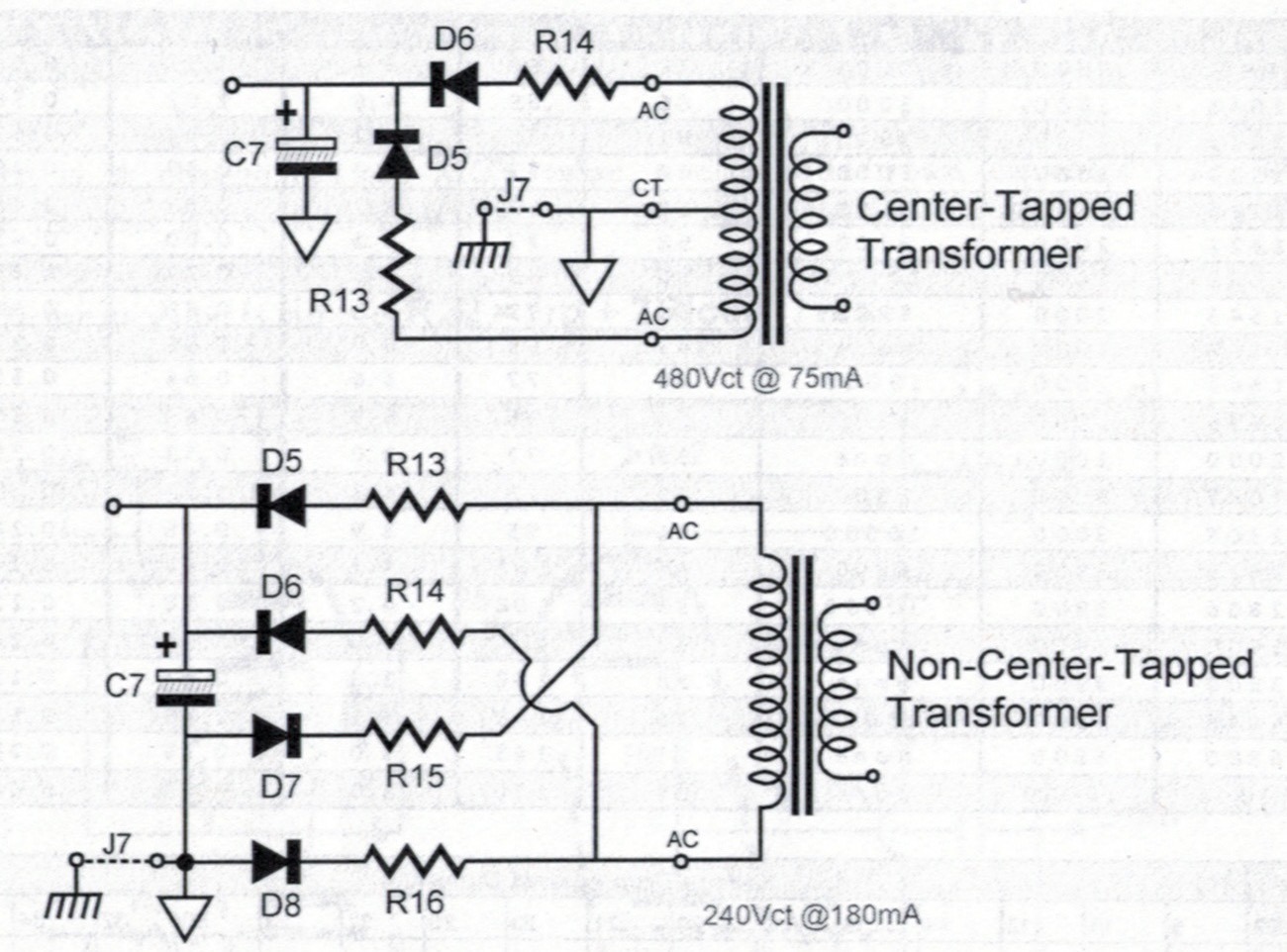

This is the transformer for the B+ supply: https://www.mouser.com/datasheet/2/410/VPT230_110-781486.pdf
I'm not an idiot, but I'm also at the point where what I understood to be the correct way to setup the power supply/transformer connection isn't producing the expected results, and I've tried all the troubleshooting steps I can think of. I would rather seek help sooner rather than later, considering this is a 300V circuit.
I've looked at various Triad transformers before and always thought the same way you did OP. The datasheet says CT after the voltages. But looking again at the wiring for series, I think they mean, "Connect to black & yellow" meaning AC is applied to these two wires and then "Jumper red & orange" meaning connect these to each other and insulate them. That being said, I don't think you need a voltage doubler for the heaters or a CT B+. It looks like the board is set up for full wave bridges
Yooo! This was exactly the advice I needed! I tried it that way and got both power supplies running as full wave bridges. Thank you so much! I felt like I must be missing something, but I didn't know enough to know what I was missing. Thank you very much! I'm up and running now!

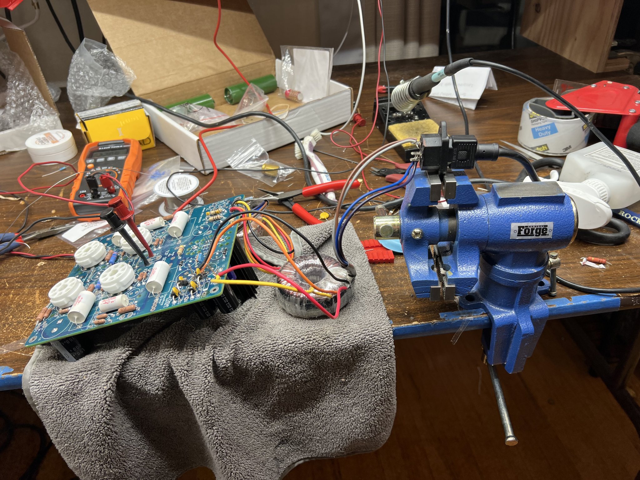

It'll be some time yet before I have finished unit pictures, as I have to fabricate a case for it still. But here's a test bench pic from today (dents from where I was banging my head on the table are out of frame).
