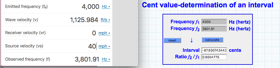

Fusor,
The Doppler pitch shift of moving the receiver (your ear) away from the source would raise the pitch slightly, while also decreasing the level at the ear due to increased distance. Rotating your ears left and right in front of a fixed source would raise pitch in one and lower it in the other, perhaps the binaural beat produced elicits a temporary response.
That said, both the binaural beat and slight pitch change from moving your head seem far less likely to explain your perception than the one posited in Post # 62.

The Doppler pitch shift of moving the receiver (your ear) away from the source would raise the pitch slightly.
Could you be mistaken? As the source and observer move closer, the sound waves may be thought of as being compressed together, and therefore, because the wavelength decreases, the apparent pitch rises. The rise in pitch as an ambulance siren rushes towards us. As I am already at the limit of my hearing the rise in pitch would be inaudible.
The ear that moves away from the source, like the ambulance siren that has passed and is moving away drops in pitch and now becomes audible.
My mistake, the sentence should have read:
"The Doppler pitch shift of moving the receiver (your ear) away from the source would lower the pitch slightly, while also decreasing the level at the ear due to increased distance."
In addition, the "lower pitch" ear would also be then be "shadowed" from the source by your head, further reducing level, as high frequencies travel like a beam of light.
An ambulance siren speeding towards or away from you at 40 miles per hour creates a pitch change of only 88 cents, less than the difference between any two adjacent piano keys (100 cents, one semi-tone). The small pitch change from rotating your head at reasonably achievable speed (less than 5 cents) would not likely even be detected by most trained musicians.
But as you said "with one’s own hearing all observations are subjective", just noticed at 8.8kHz, the shape of my pinna allows hearing the tone from a constant directivity horn with my left ear at certain angles, while the right ear requires an additional 3dB at any angle to be heard.
The test also increased my tinnitus level, even though TTS did not kick in :(
Pretty sure if you try your test again, you will find directivity of your ears due to pinna shape at different angles, rather than "Doppler Pitch Shift" responsible for the change in perception.
Art
