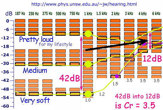

Typical (who is typical??) age-related loss is level dependent. My HF threshold is way up above 50dB SPL, showing a steep slope. However if I play above 80dB SPL my hearing is more like flat.
It is the flip-side of the over-debated Fletcher/Munson bass loss. You can't hear small bass but raise the level a bit it is audible.
With a variable-level frequency generator you can plot "equal loudness" for soft medium and loud levels. Below 1kHz I am exceptionally flat, with barely a hint of bass loss at very low level (estimated 35dB SPL). But over the decades I've lost my hiss-zone, over 30dB loss. However as the level comes up the nerves perk-up. The nerve-stubs start to sway. At "pretty loud" my plot is a lot like a young person.

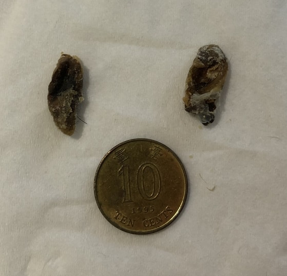

This is the pair of ear wax that I have just removed. They came out in one piece and the texture is like rubber. The down side is, now I hear my wife yelling much louder.
