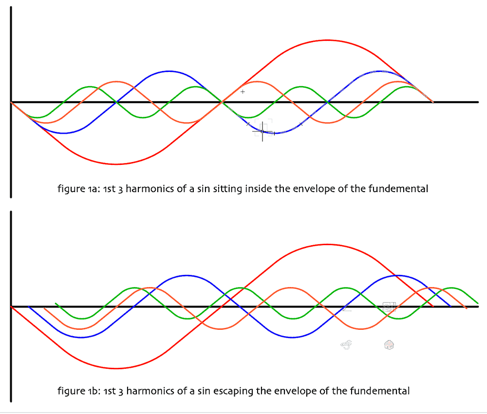

It is possible, with training, to detect when the harmonics escape the envelope of the fundemental. A timing thing, not a frequency thing.

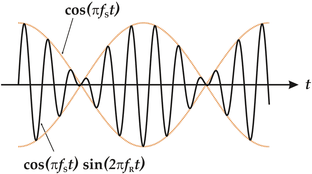

I still don't understand what you mean by "when the harmonics escape the envelope of the fundamental". Can you show on the diagram you posted where that is happening?

The envelope isn't created by the fundamental. I think you are confusing what an envelope is. The harmonics shown in the first graph combine to form the waveform in the second, no envelope was harmed in the making of the waveform. 😉

From back in my synth-interest days, an envelope described the time - amplitude modulation of a generated signal. "Attack - Sustain - Decay - Release" terms were used to describe the various timing portions of the envelope. Certain attributes of these, such as "slow" Attack, further described how a musical note sounded, usually in the context of trying to reproduce the sound of a real instrument.
So when Dave said "escape the envelope", I started imagining each harmonic - the 2X, 3X, 4X, 5X stuff each having their own time - amplitude envelopes. Since they were all shown to be lower in amplitude than the fundamental (to make, say, a sawtooth waveshape) this "escape" I imagined to be some point in time where any one of the harmonics was higher in amplitude than the fundamental.
This could be because the fundamental's time envelope was decaying at a faster rate than that of said harmonic. Or perhaps due to some resonance one of the harmonics excited, where it - in the process of reproduction - became higher than - escaped - the envelope of the fundamental. originally recorded as following this envelope profile, ended up with a very different profile on reproduction. (Sounded like sh*t as a result...)
Did this earthling come even close to understanding what was being described? I think the classic single note electric guitar feedback sound is an example - where it starts off at a fundamental, then the 2nd takes over as the fundamental drops away.

I imagine an artificially created signal could have amplitude escape (are there any acoustic instruments with that kind of harmonic progression?).
I was meaning escaping in time… like when the tweeter signal eminates from behind the midBass. I think there are some instruments where that does happen naturally.
If the timing of the harmonics changes so does the waveform that is their sum.

Yes, there's no reason different harmonics couldn't have different envelopes. An extreme example would be a cymbal crash with frequencies and transients all over the place. The question is what is our temporal aural acuity? As I posted earlier the threshold appears to be 1ms, it degrades with age, but all the same doesn't equate to particularly high frequencies, and the system needs the bandwidth to render them anyway.

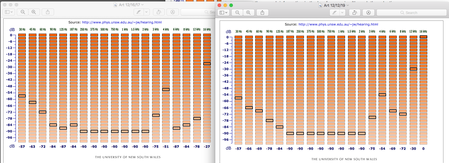

The harmonic arrival time changes the sum of the waveforms, but has no effect at all on the ability for one to hear them if the harmonic (or fundamental) is below the SPL required for hearing.
For instance, I can hear 2000 Hz at "normal" level, but due to NIHL (noise induced hearing loss) the second harmonic of 4kHz must be 36dB louder than the fundamental for me to detect it.
Presbycusis (age-related hearing loss) and NIHL requires the third harmonic (8kHz), 18dB louder, and the fourth, (16kHz) forget about it- tweeters (and the 63 year old "girlfriend") couldn't handle a 90dB boost..
Those results are with headphones, but to give you an idea of what hearing loss is like, a few days ago while testing my hearing using loudspeakers 2 feet (60cm) from my ears, Bonnie, in another room, around a corner, at least 20 feet (6 meters) away, yelled "Oww, turn that down!" before I could even hear 4kHz.
I have been very careful to not expose my hearing to loud noise (or music) for the last decade, yet presbycusis has reduced my high frequency hearing a lot just over the last 3 years.
I have been researching hearing aids again for the last several days, advances in frequency lowering, AKA "frequency compression" may be able to restore the lost harmonics and fricatives for me, will be auditioning some soon.

...4kHz must be 36dB louder ...
That is a seriously odd curve. And confirmed by Bonnie's complaint. You have NO loss except in a part-octave? Have you spent years around a whistle? (My loss may track the wind-noise of my cars...) Sleigh-bells?
