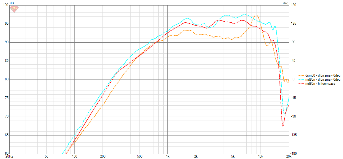

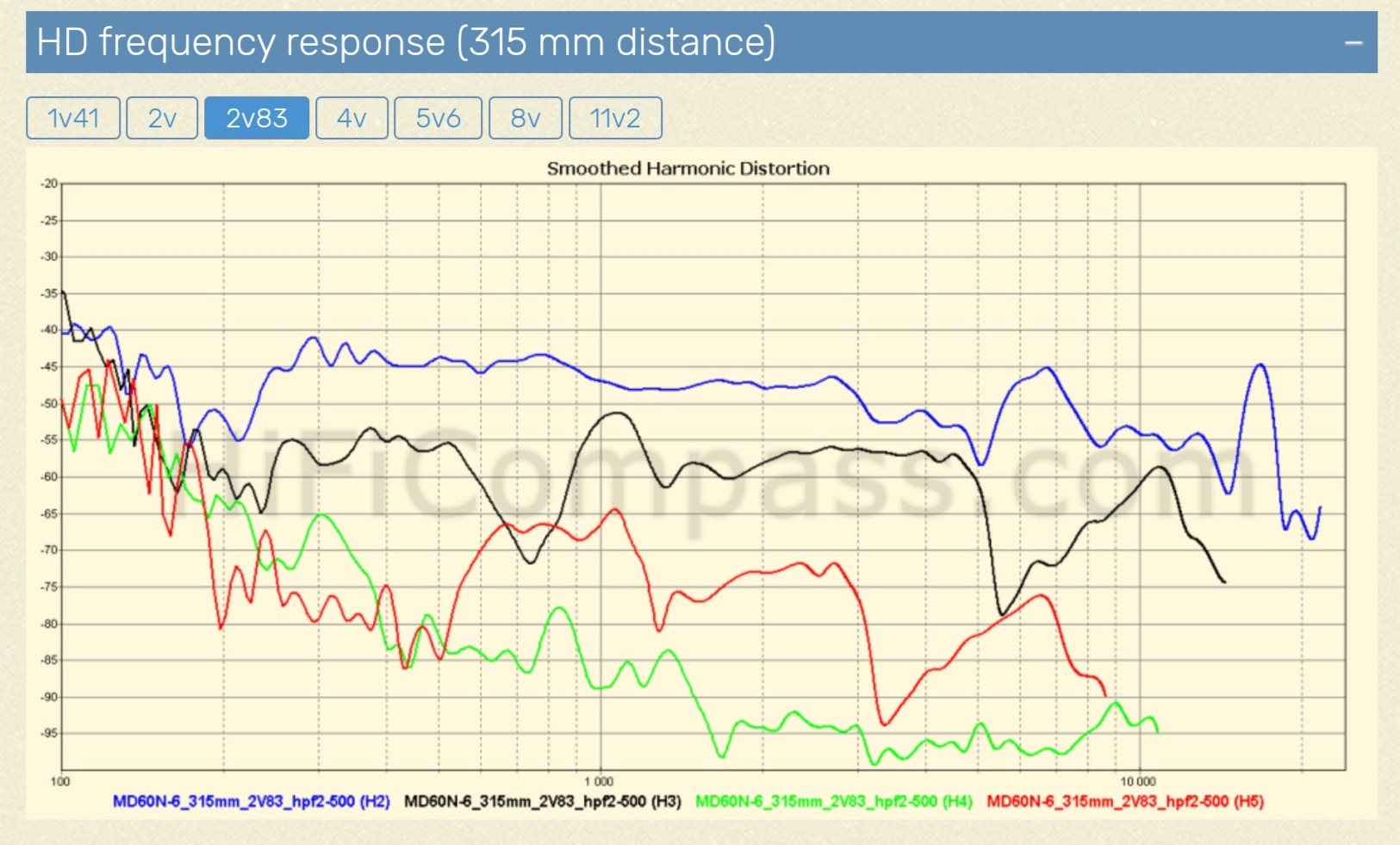

If you look at the HD measurement made by Hifi Compass, it shows a somewhat different trend in HD. Look at 3rd and 5th HD @ around 1 k.

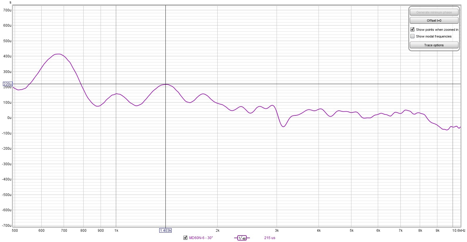

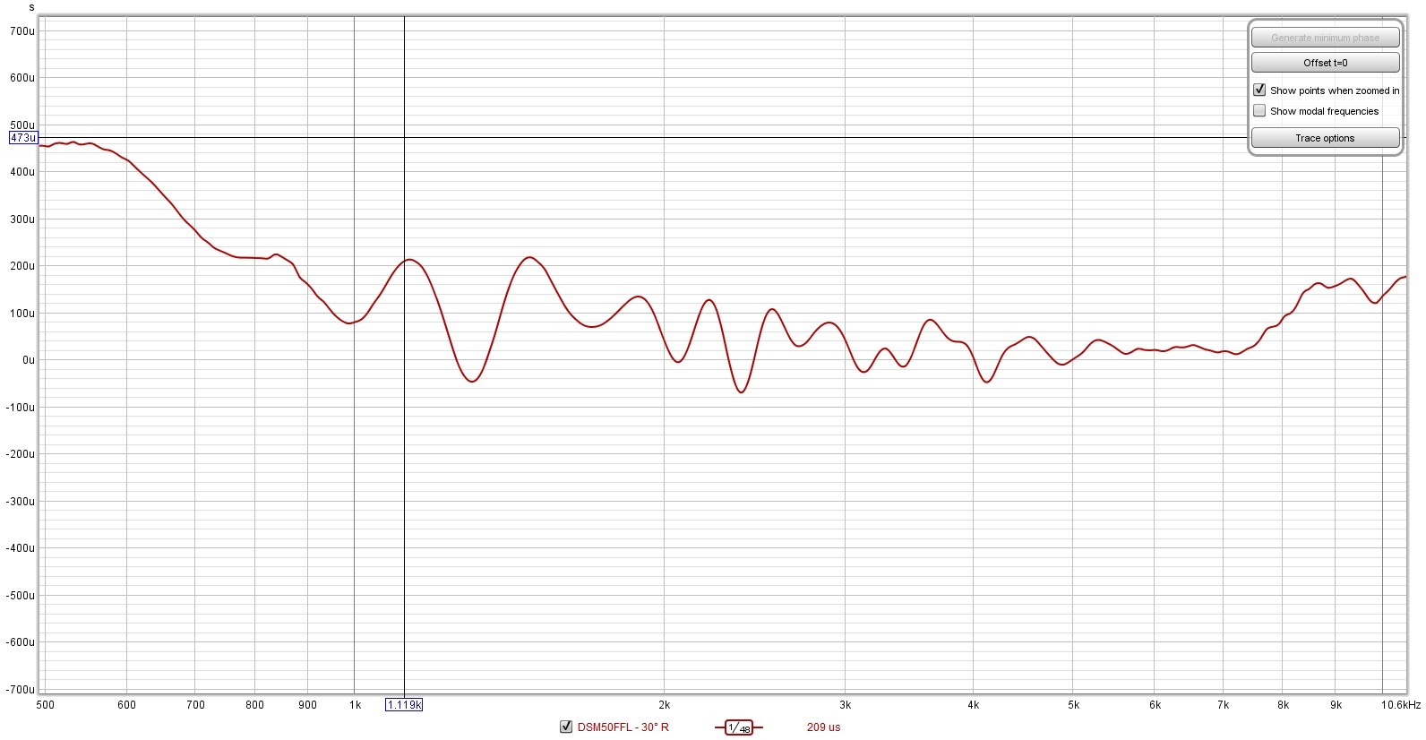

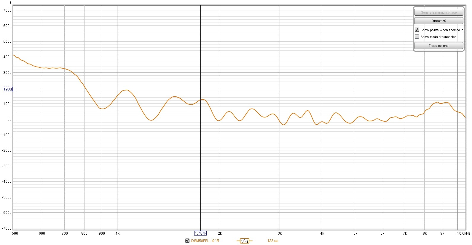

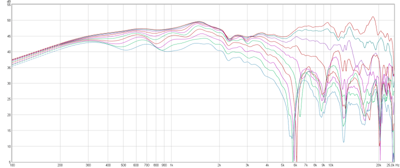

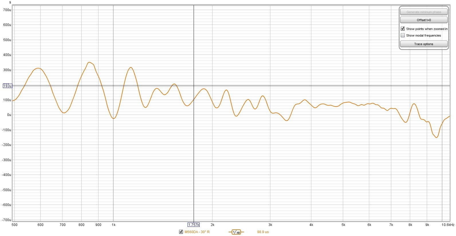

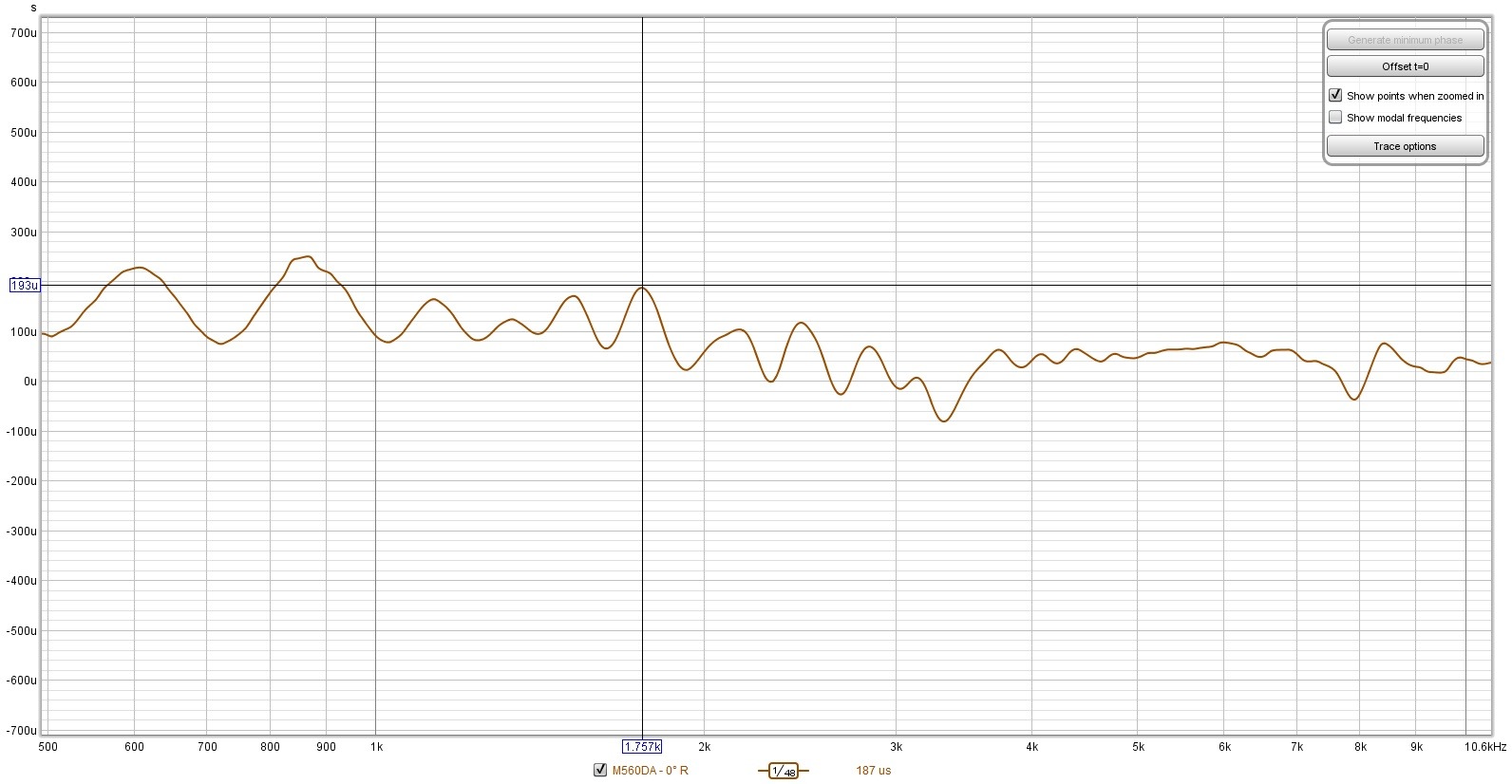

ja0801_0deg_gd.jpgDSM50FFL_0deg_gd.jpgM560DA_30deg_gd.jpgM560DA_0deg_gd.jpgmd60n_0deg_GD.jpgDSM50FFL_30deg_gd.jpgmd60n_30deg_GD.jpg

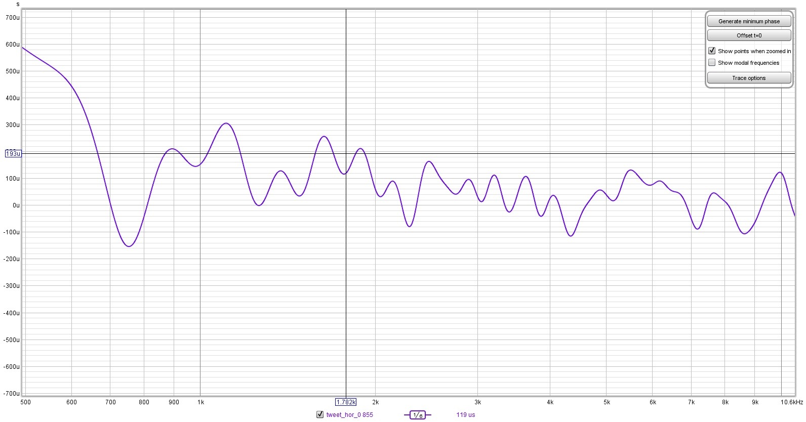

ok, last batch with some repeats and a bonus measurement. I forgot the $$$ dynaudio in the last set. As a bonus, I measured a broken yamaha ja-0801 that i tossed in.
Now all of these manufacturers can make these drivers do what they will. I wonder if both the drivers that have lags at 1.1khz off-axis is on purpose.
The Dynaudio folks can prob. make a driver do what they want too and off-axis the m560da lags as the third-worst of the bunch. Maybe to integrate to a woofer? I dunno. The 30 degree made it fall off my list.

The consistency issues with the DSM50 were not an issue in my measurements and the units i had were pretty close to each other. The driver is made in China and while that isn't necessarily a death sentence regarding quality, it has some affects in QC because the workers tend to be lower skilled, paid less and not interested the products they make. Thats not a recipe for a consistent product - note I used the word consistent and thats important in speakers.

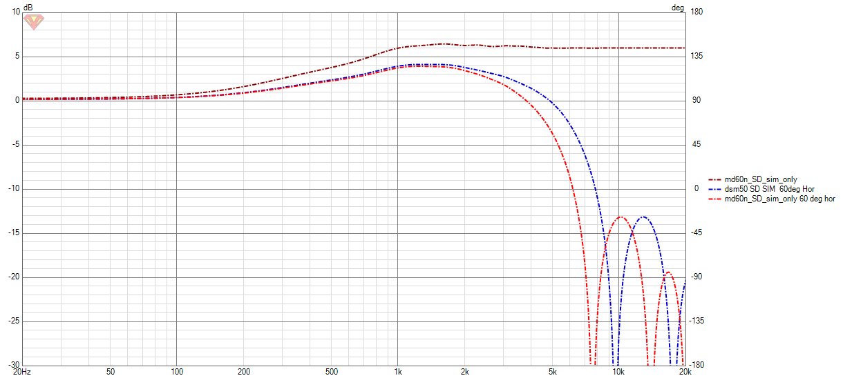

As far as a sim of the sd, the md60n and sdm50 look the same. At 60 degrees the dsm50 has a little more power.

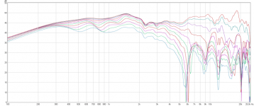

A comparison using the baffle sim with some data loaded in.

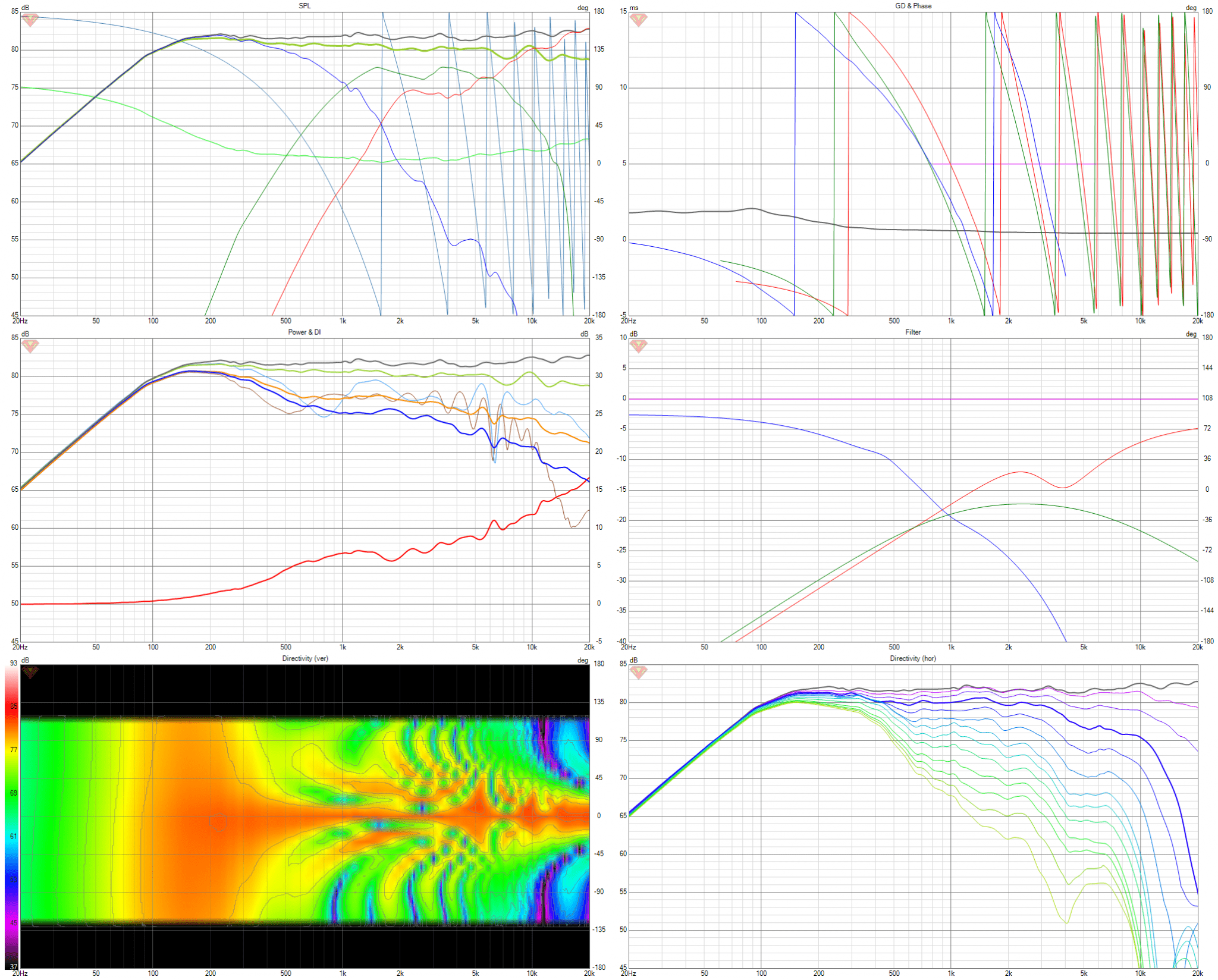

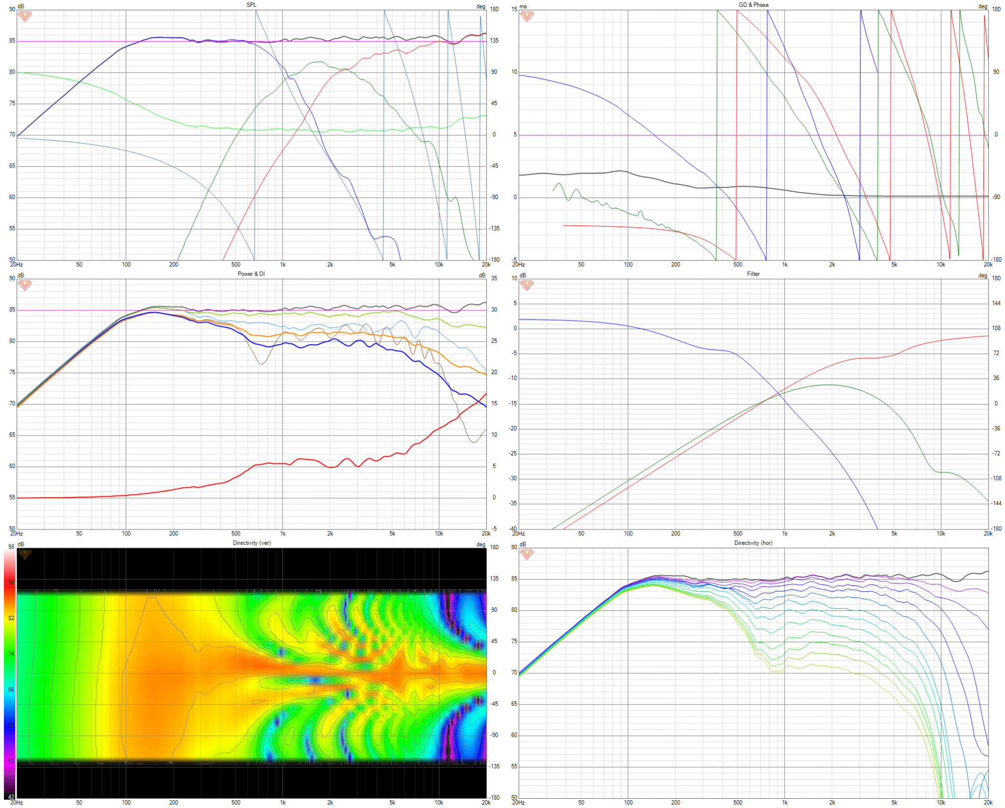

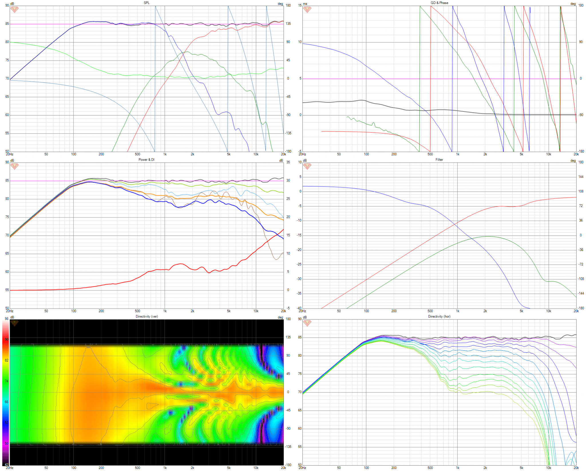

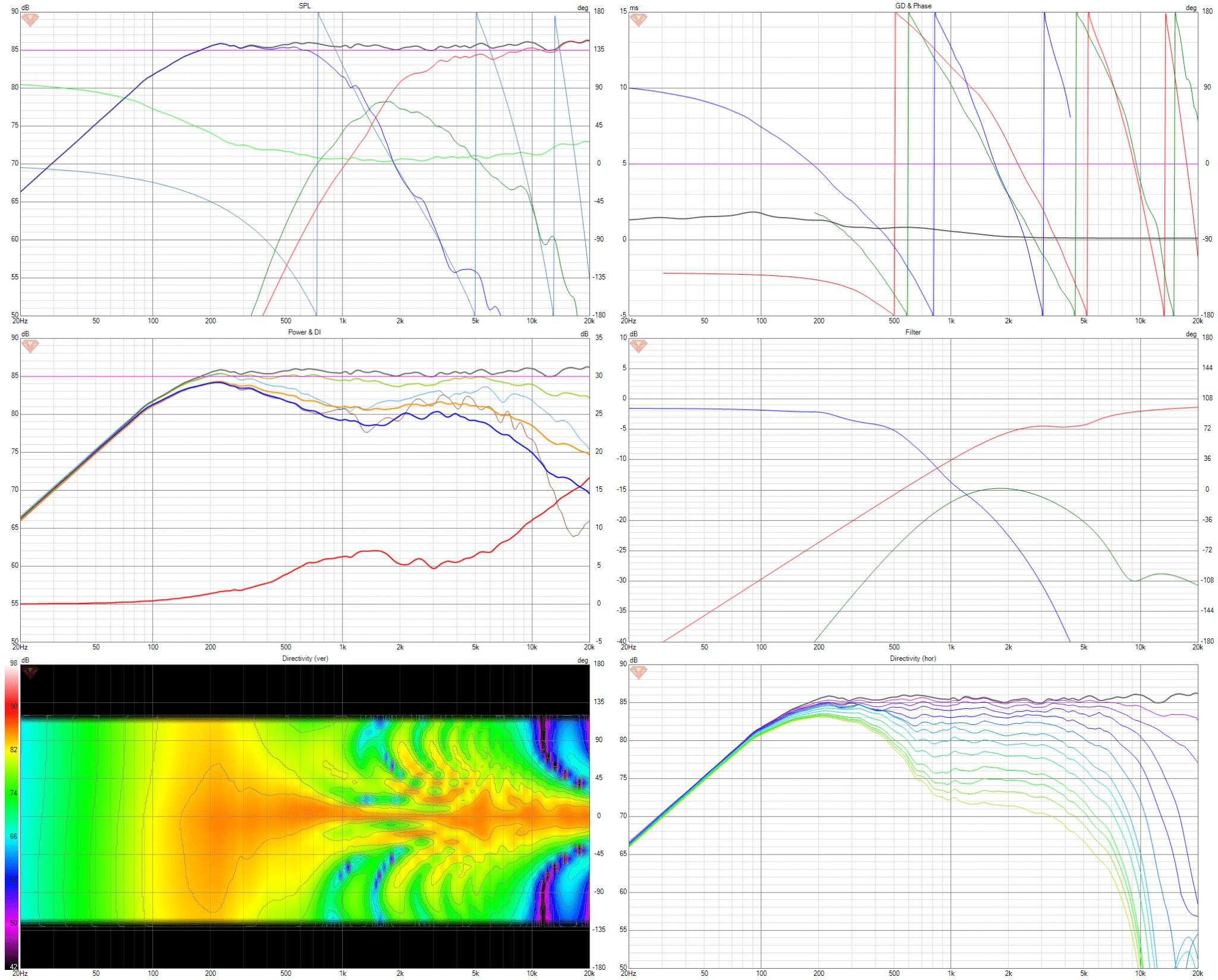

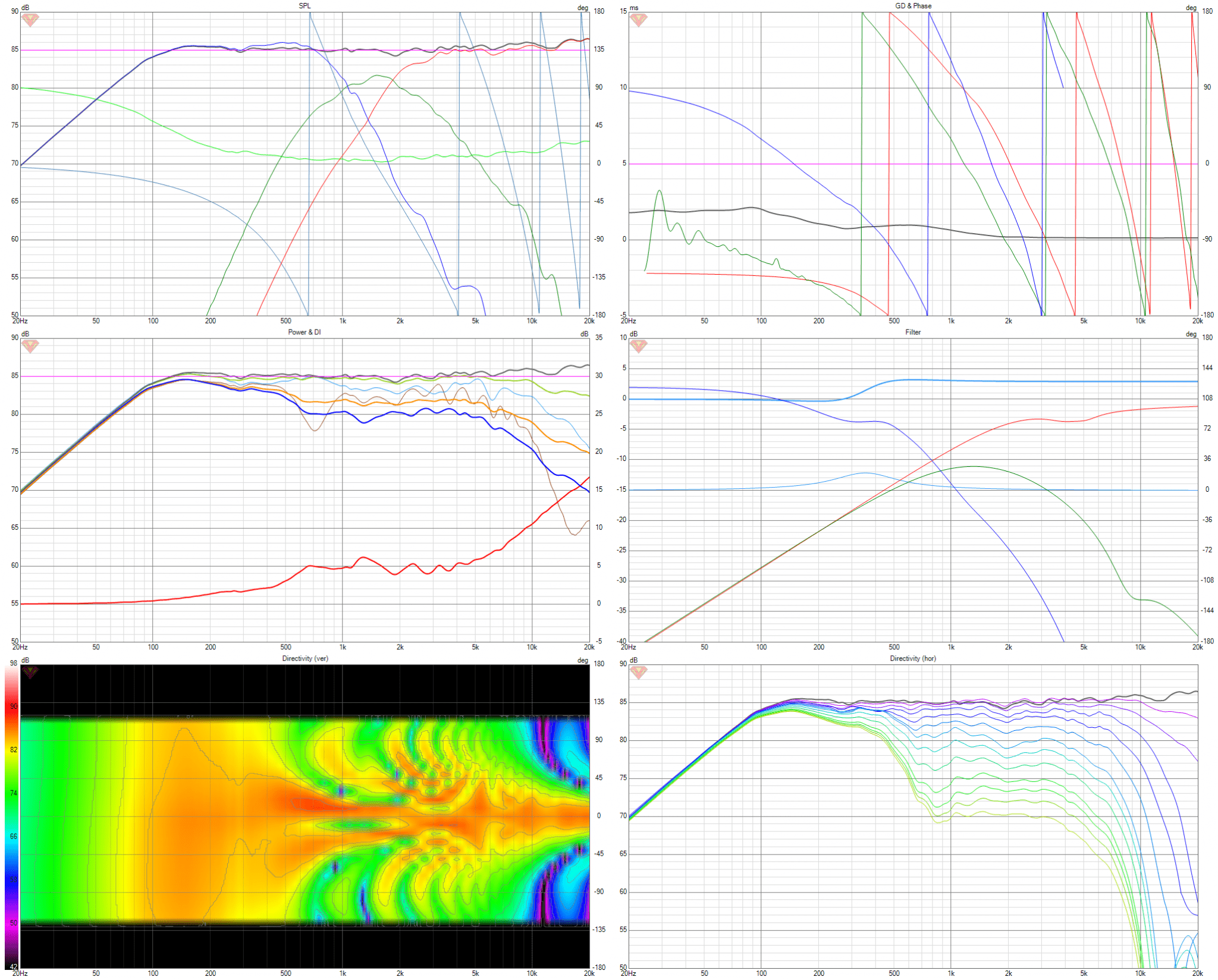

Some new XO's (mostly based on the last round) for the dsm50.
dsm50_2_t34b_textreme_R1 Six-pack.pngdsm50_2_t34b_textreme_R8 Six-pack.pngdsm50_2_t34b_textreme_R6 Six-pack.pngdsm50_2_t34b_textreme_R2 Six-pack.png
Some of these might not be possible. I think I might like how a 3" integrates more. I'd like the woofer to play less into 1khz.

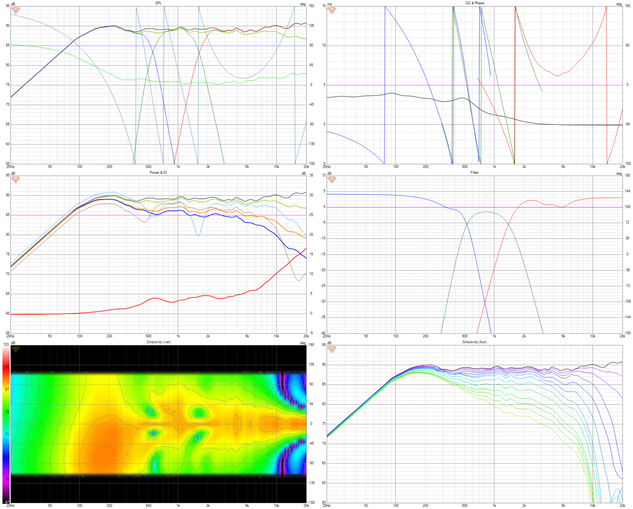

Why have I never used the optimizer in vcad before? This is what the optomizer did with my 1st order xo for the md60n; the optimizer was set to get a nice pref. score.. The TM are 385mm apart c-to-c. The woofer 114mm back. I don't know how I feel about the tweeter playing so low but I guess if you were on-axis with the tweeter you would want the mid playing slightly louder. Other than my minor gripes, I think it looks cool.

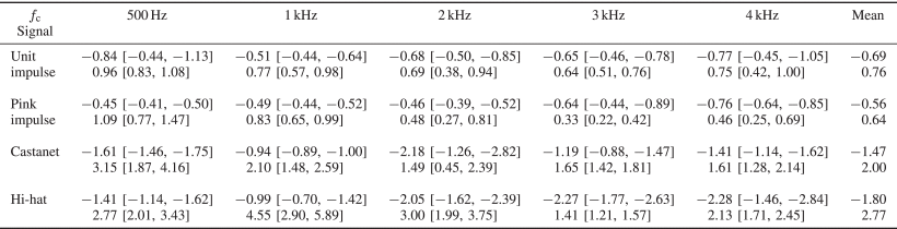

I am interested in the GD added by XO's and the drivers. That last XO is all 1st order slopes and should have the least amount of GD of any other XO I make. So it is my extreme "best case". Also, without a WG it is hard to get a nice directivity between 500hz and 2khz. But really an LR4 should not add anything audible unless the driver has issues at the same spot.
profiguy put it best: "The goal is not to have a significant and sudden phase shift in the vocal band." Ditto for me and I would define a shift as:
This table is showing the limits of GD sensitivity for different sounds at diff. frequencies (the link to the paper is a couple of posts back). The data is the showing the level of GD in ms in the positive or negative. In brackets are the min and max of the testing group.
If it is possible for this project I'd prefer to keep all of my GD shifts somewhere between the "pink impulse" AVG GD or the MIN GD for the castanet test sample. It really should not be too hard but so many drivers have 0.5ms shifts in places. Put an XO on top of that and now I just broke the GD I would like. This is a bit of overkill for musical sounds (as the table shows) but I would like to see what I can make.

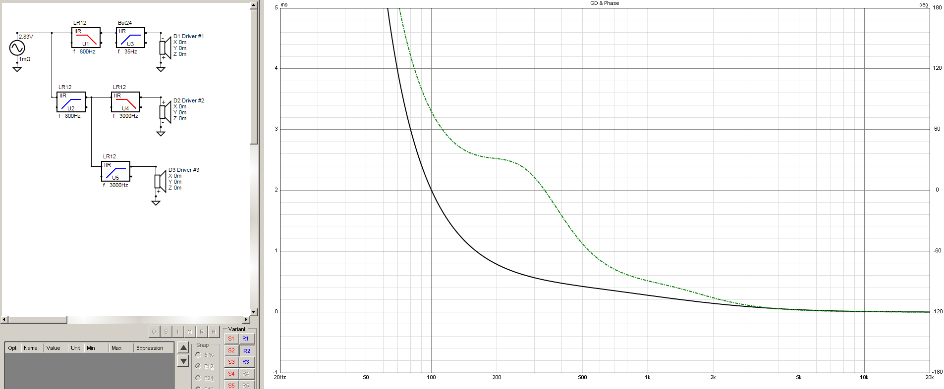

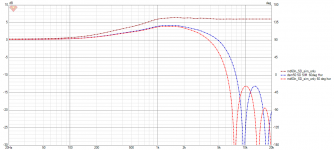

There's less overlap with LR4, I think most of the time that would be considered an advantage. LR2 has half the group delay (and inverted polarity for one band) but it's probably not workable at 1.5kHz, the tweeter wouldn't have much attenuation below 1kHz when equalized to an LR2 response. I guess more like 3kHz which would result in even lower GD (mostly because of the higher LPF of the mid driver) but I guess the issue of not quite enough attenuation below 1kHz could possibly reappear for a dome mid as well so that a cone would have to come into play maybe as high as 1kHz.
Below is a screenshot of the GD curve of 3-way configuration with LR2 crossovers (although I think 800Hz LR2 for a dome mid would be unrealistically low?) compared to a 3-way with all LR4, which is the green curve, and has different xo frequencies, 300Hz and 1.5kHz. (I think the bump in the curve at 250Hz could be ignored because the FR isn't flat there and haven't played around to flatten it.) In this example the GD of LR4 at 1kHz is 0.5ms, at 2kHz 0.2ms, and at 3kHz it's identical to LR2.
Good points.
Although both curves should not be audible if I understand things right. Do we hear GD shifts below 500hz?

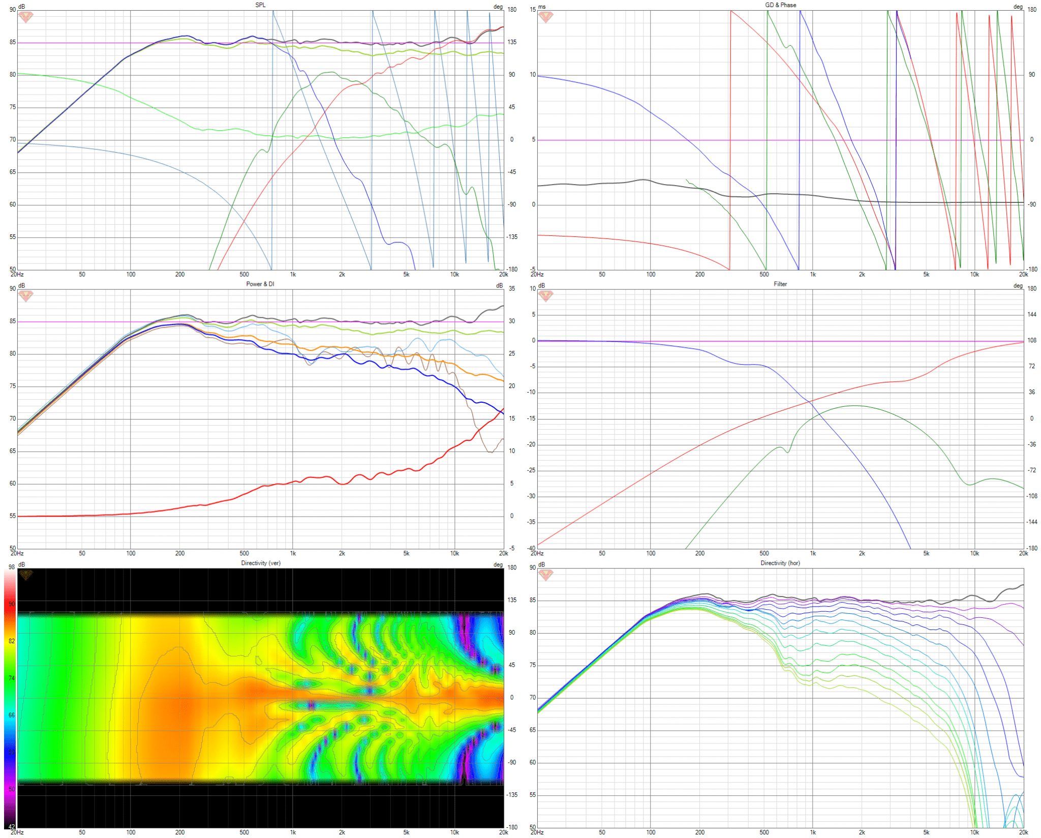

dsm50_opt__4_r5_LR_t34b_textreme_ Six-pack.pngdsm50_opt__4_t34b_textreme_ Six-pack.pngmd60n_14opt_1sto Six-pack.png
I used the vcad optimizer on the dsm50 XO and made a new one with LR slopes. I could not fit an LR4 and get things to look right so the slopes are pretty steep. This is mostly to see how bad the GD shifts can be.
I did not notice until after the fact that the SPL levels are all diff.. Either way, to date the md60n has the better pref. score and GD with the XO. Also, the DSM50 needed the woofer to be even further back to integrate than the md60n.

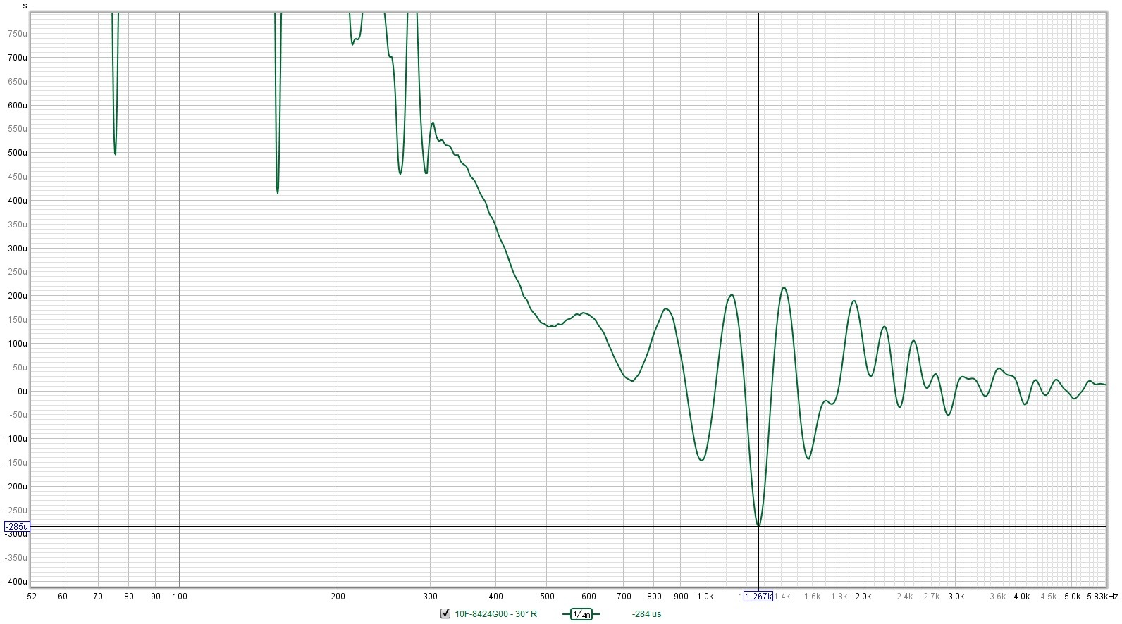

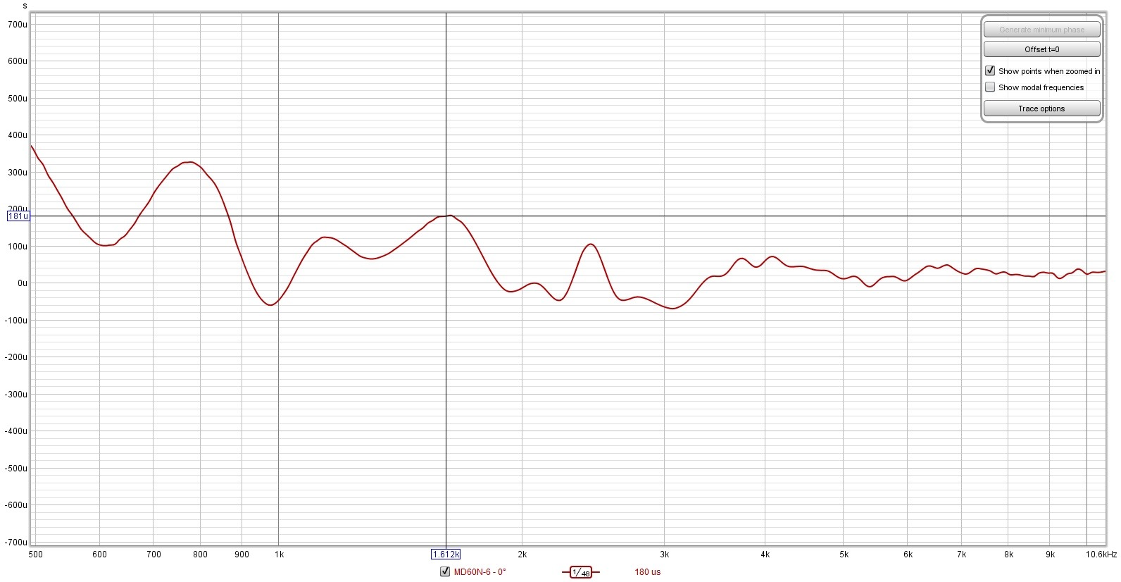

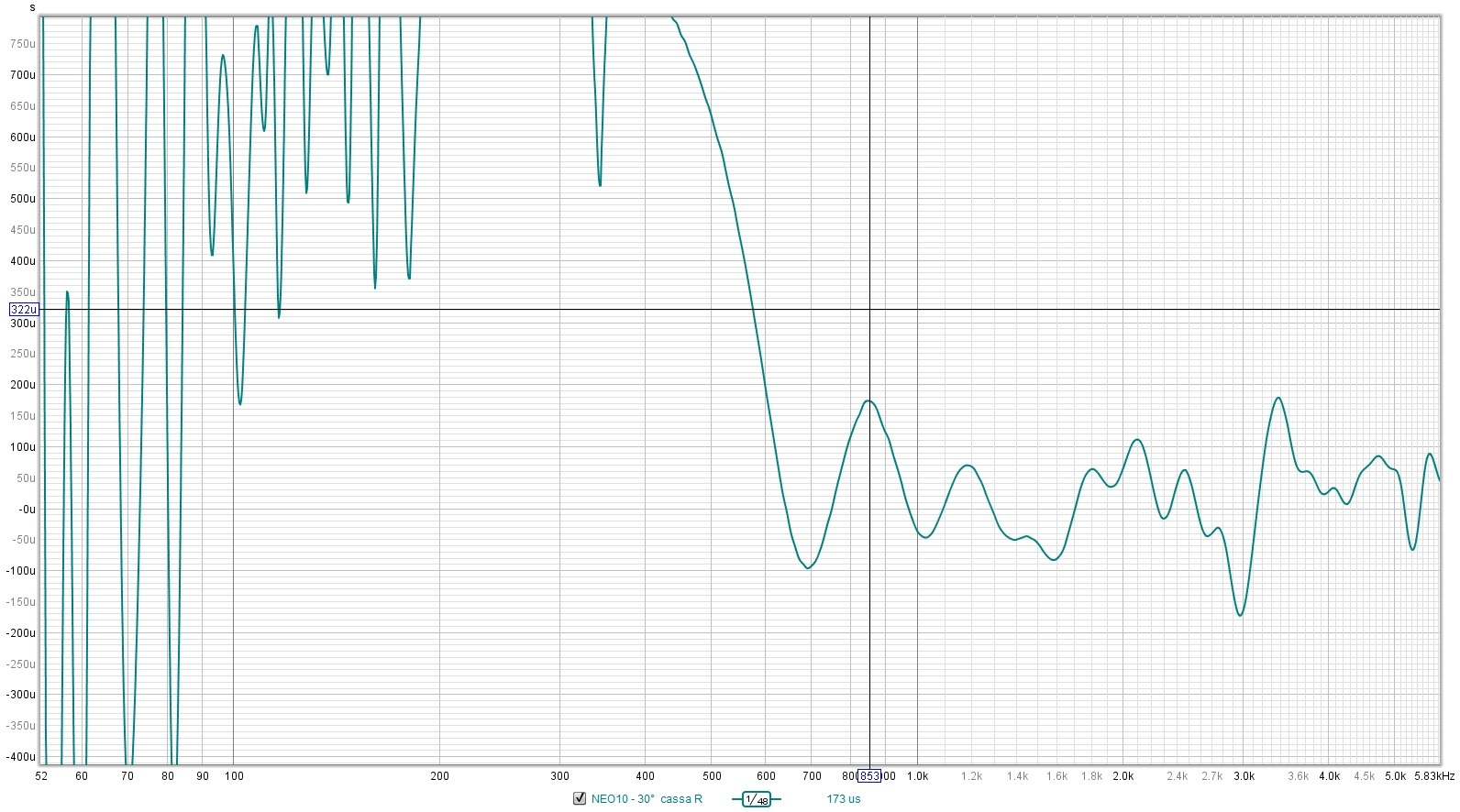

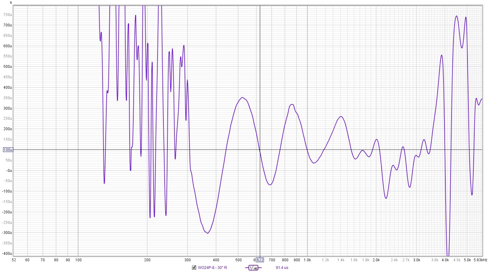

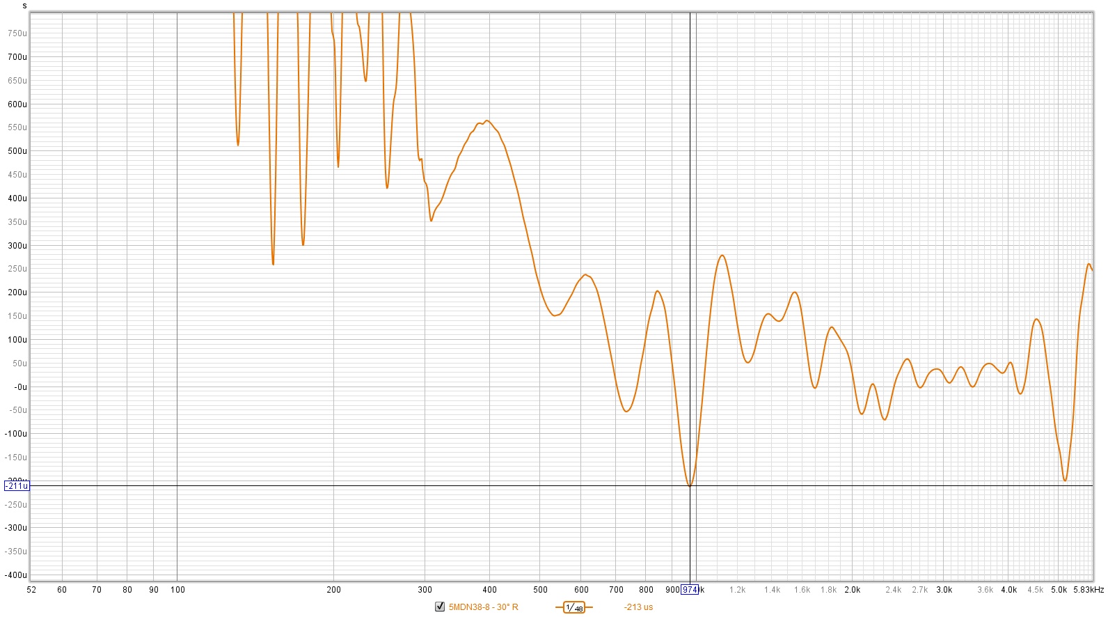

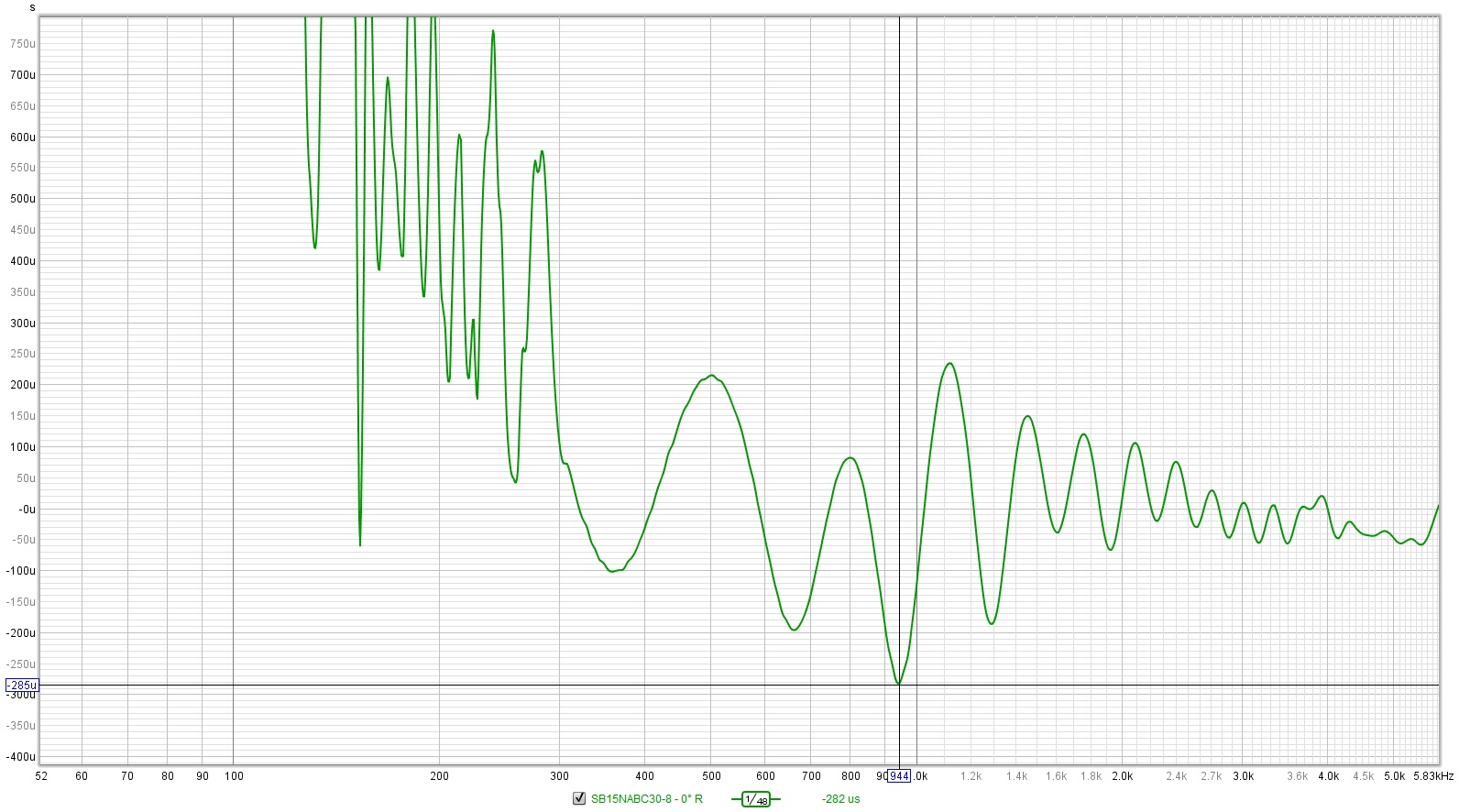

5mdn38_30deg_GD.jpg10f_30deg_GD.jpgNEO10_30deg_in_a_box_GD.jpgSB15NABC30_0deg.jpgWO24P_30deg_GD.jpg
More GD graphs from dibirama's measurements. This time just whatever axis looked worse.
The satori WO24P looks like a perfect match for the dynaudio. Hmm.
The sb15NABC might get the award for the least change between the 0 and 30 degree GD,
I do wonder about some of the large GD shifts around 1khz. Low to high some are close to 0.5ms. The paper says no big deal for music sounds so I guess they are fine. I would prefer something tame and with not too many negative GD shifts. I did a test over the summer and think I heard how it can mess up a resonance.
