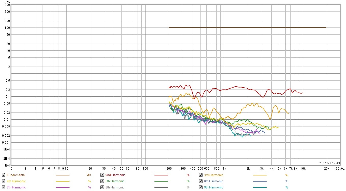

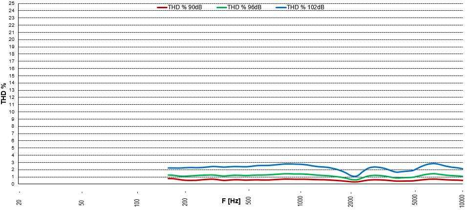

The SS 10F is an interesting animal, but THD is way up there for a higher end mid driver.
https://hificompass.com/en/speakers/measurements/scan-speak/scanspeak-10f/4424g00
Looks really quite good to me. The THD might not be the "best" but HD2 is the largest component of THD by far in practically all cases, and it's also the most benign form of non-linear distortion (in many cases inaudible up to 10% or more), so THD in itself is not a good measure for how audible the harmonic distortion is.
HD3 is also fairly benign, but likely not to the same degree that HD2.
The 10F SS is a good mid for sure and has a big following on here. It has a decent motor design and bandwidth for its size. The 2nd order HD on paper is pretty good down low comsidering its size and limited xmax, especially for lower output use. My issues with it are how it sounds when driven a bit harder. Crossed around 300-400 hz driven to mid 90s dB levels, it starts to get somewhat fuzzy, harsh and detached sounding in the upper mids. It may be the cone material and composition which gives it that character i don't prefer. To put it in simple terms, it tends to draw attention to itself under the above conditions and has that light paper cone sound. Even playing with various HP points and slopes doesn't seem to make a difference in this regard. However, of you keep the volume down in lower 90s dB it does well amd has that euphonic type of imagining associated with smaller mid drivers.

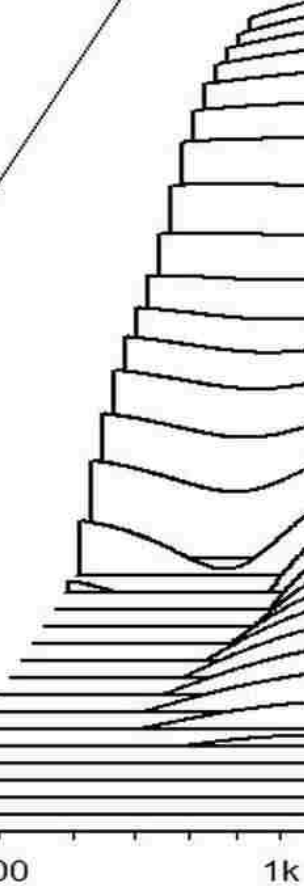

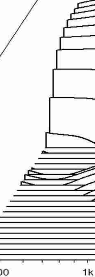

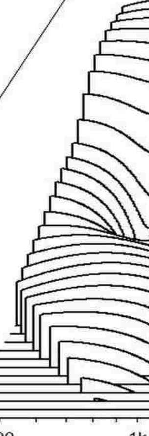

Volt Vm753 does have some energy storage

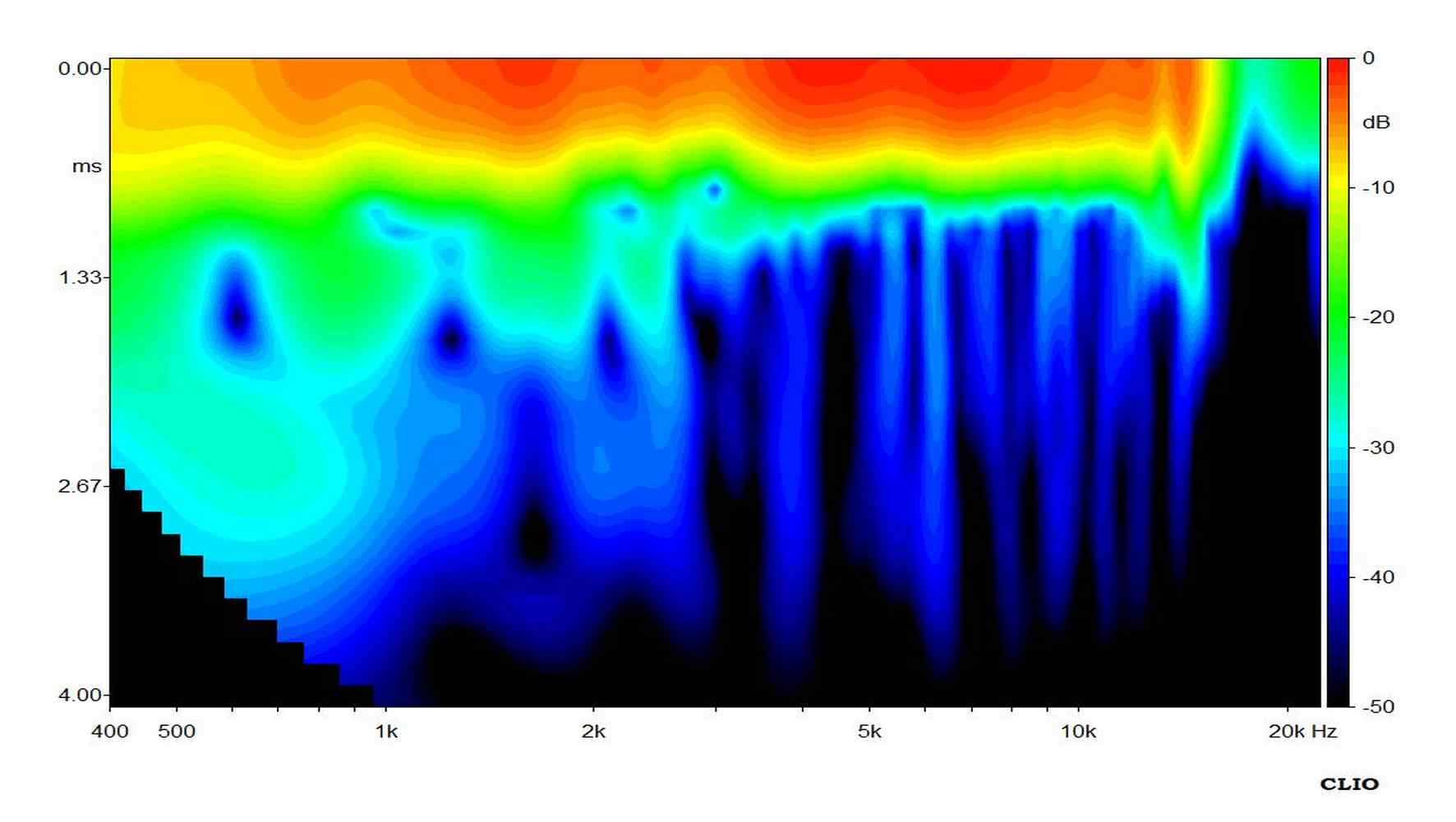

I cannot find a vm753 waterfall. The vm752 is what I thought looked slow.
Much like the yamaha ja0801:
It would be nice to improve the 800hz on up a bit with no humps or shift in decay after just a few db drop.

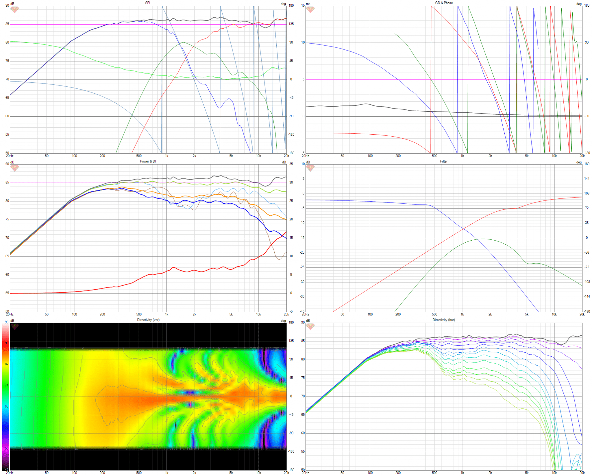

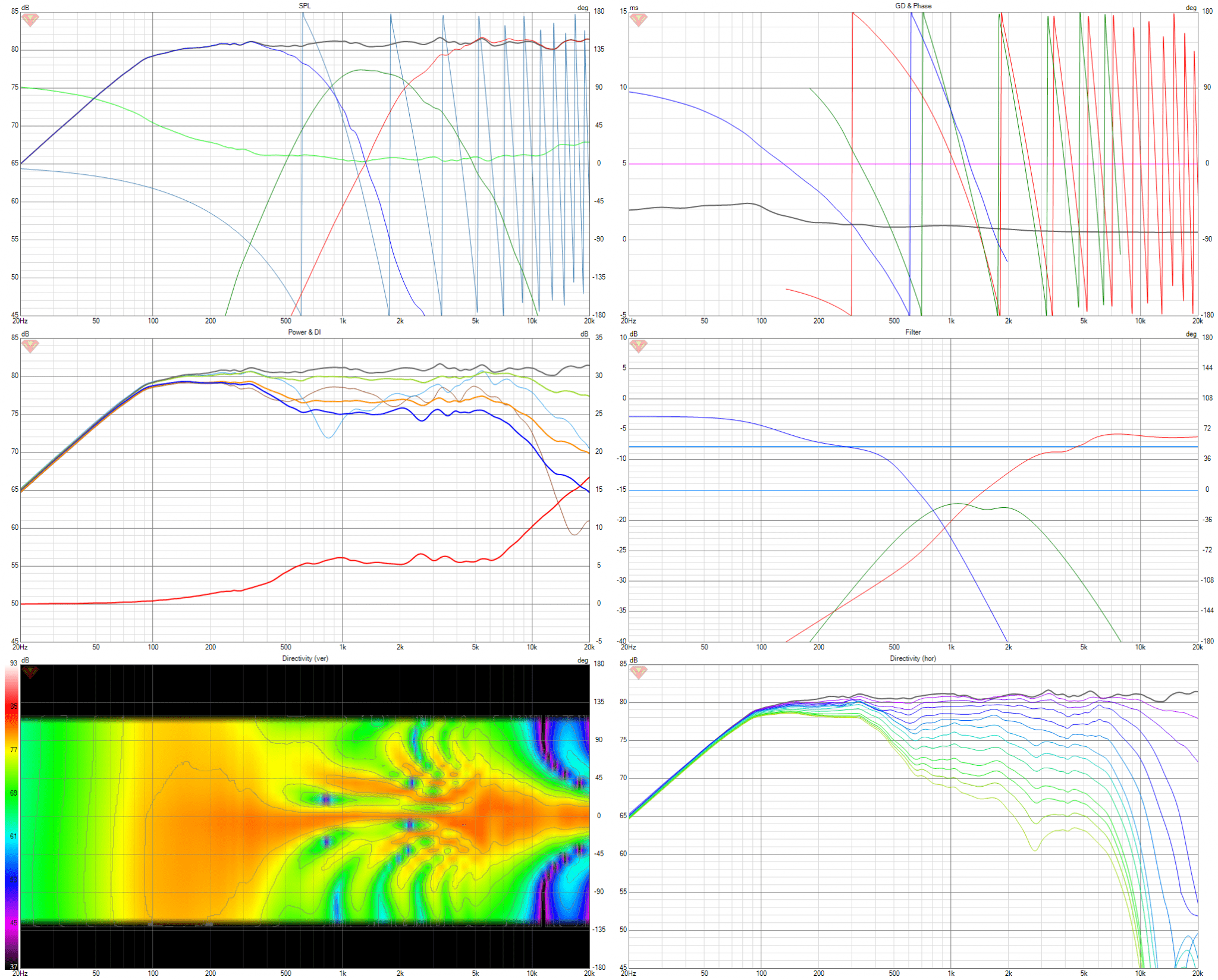

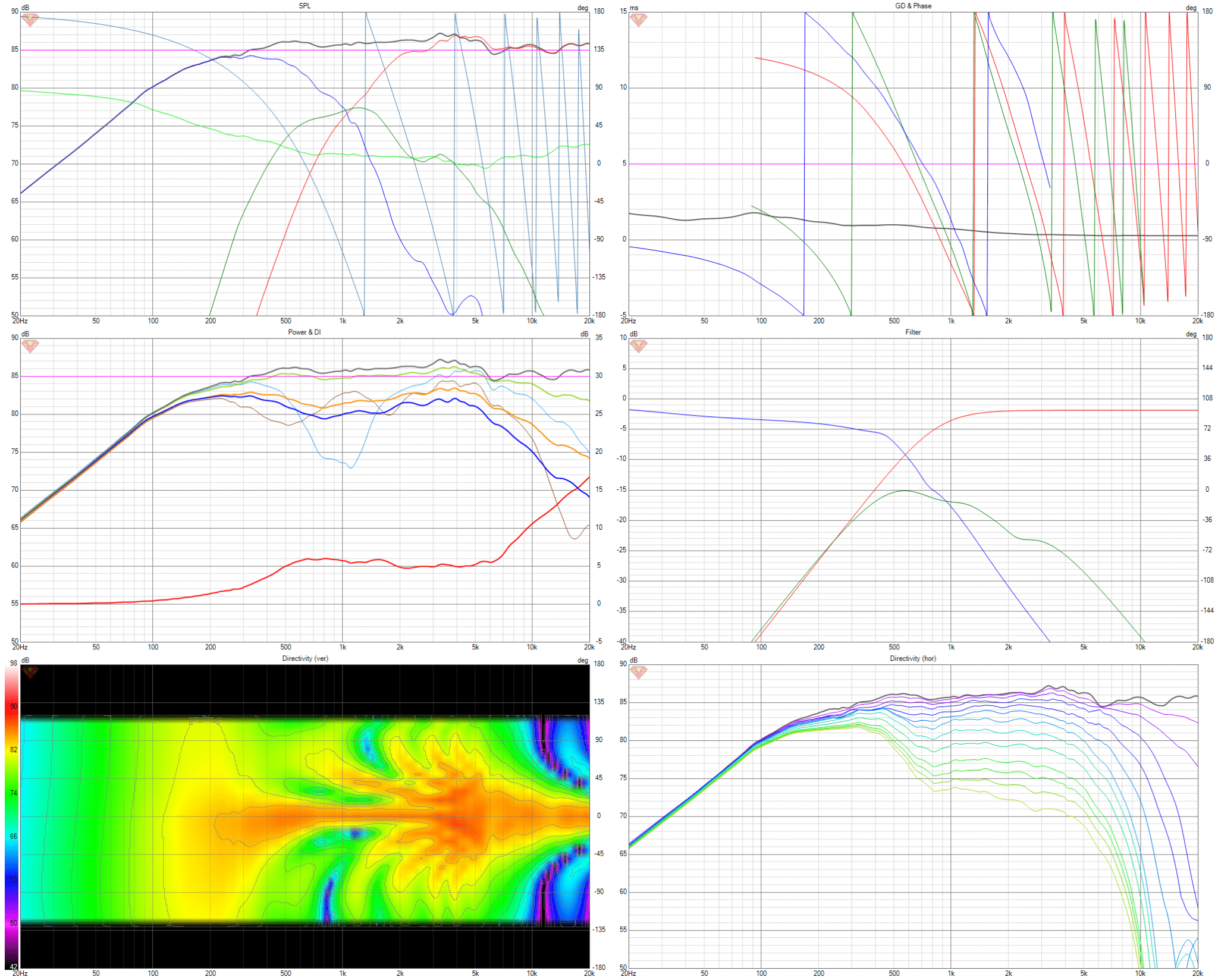

I refined the XO's a bit. Again, some of these might not be possible. Part of this for me is seeing where the tweeter and woofer fall apart.
I tried to throw a mix of solutions at it. One has a pretty good pref. score. (is pref. score all about flat power and directivity?). The one that is all 1st order XO's has the mid and tweeter playing at the same level. All of the XO's have a c-to-c of 350mm.
md60n_13_t34b_textreme_r8_2ndO.pngmd60n_13_t34b_textreme_r4_lr12.pngmd60n_13_t34b_textreme_r6.pngmd60n_13_t34b_textreme_9_5_pref_r2 Six-pack.png
" I'd like to make something with a very fast decay from 500hz-5000hz. No bumps in the GD would also be nice."
  • fast decay - driver(s) playing in linear band, no cone resonances
  • smooth GD - no xo or minimal phase shift
To me first thought to achieve this is a 3-way with a wideband midrange and shallow LR xo or other types of xo giving minimal phase shift.
Now we have sims with a filler mid and two crossovers in 500-500Hz band... How come?
Duelund crossover starts as first order, gradually gets steeper creating elliptic acoustic curves, and introduces minimal excess GD.

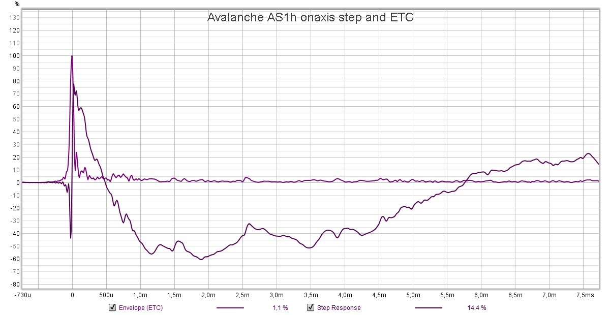

My approach here, crossovers basically LR2 but close to elliptic... Sounds nice
as1h v22 onax all ind 100ms 13.jpgas1h v22 step etc.jpgas1h v22 onaxis GD 12ms.jpg

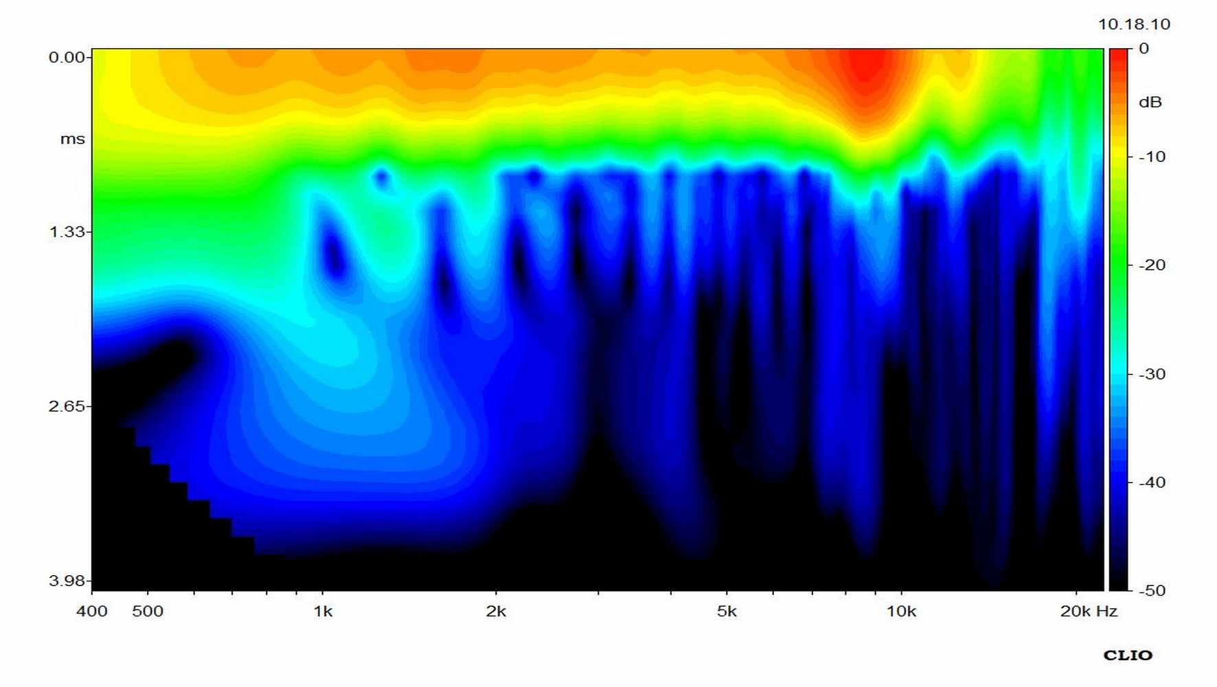

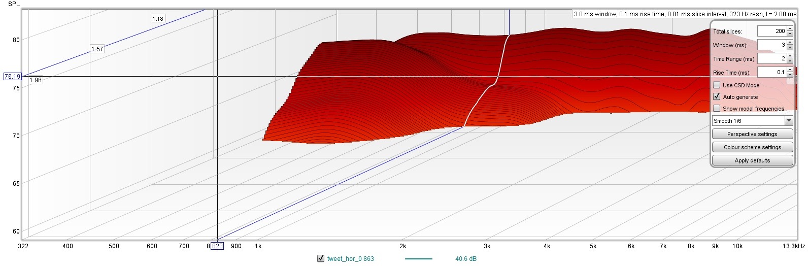

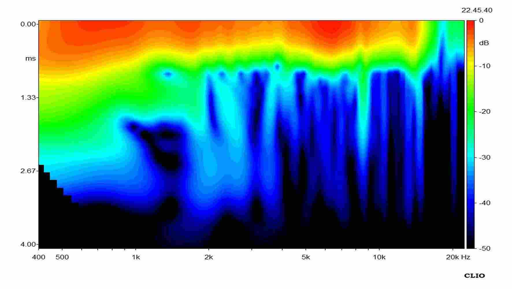

Hey! Thanks for posting the graphs and the XO. Looks cool! Do you use REW? If yes, can you post a decay graph like mine on page one of this thread?
Back to your ?... How come? These were the first drivers I was interested in. The directivity kinda forced me into those XO's. I'll look at more mids. I think I am set on a t34b though.

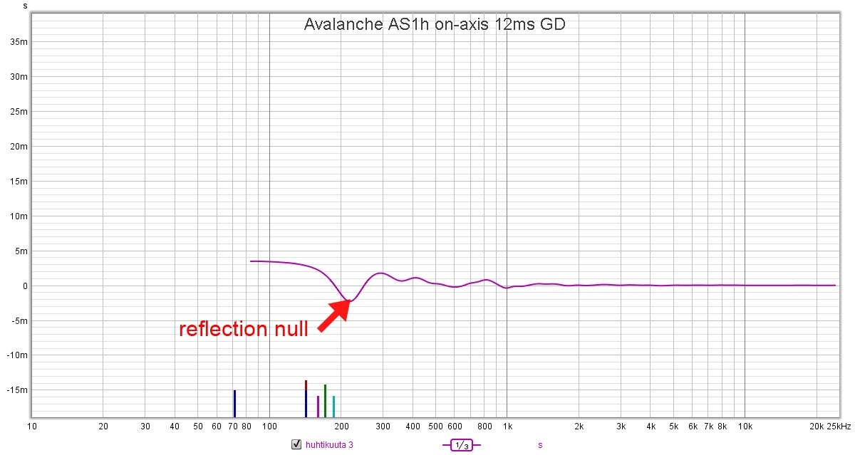

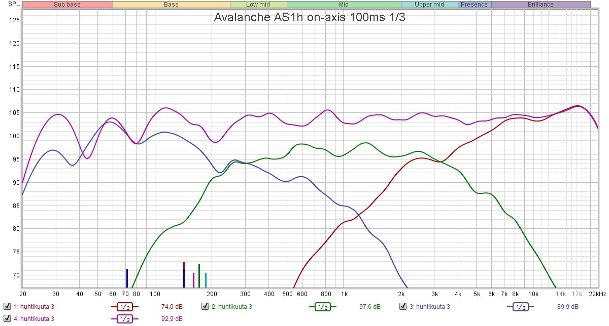

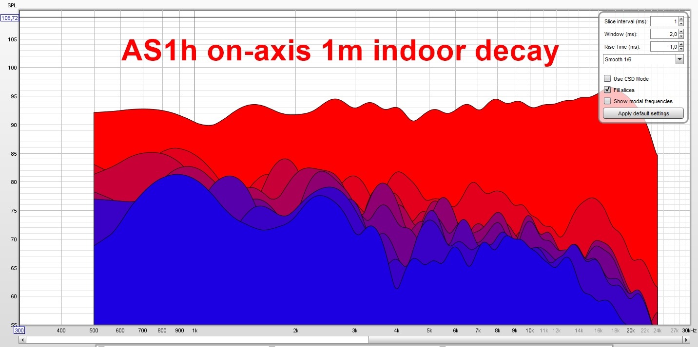

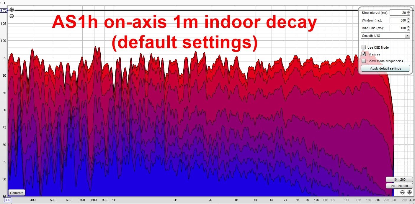

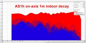

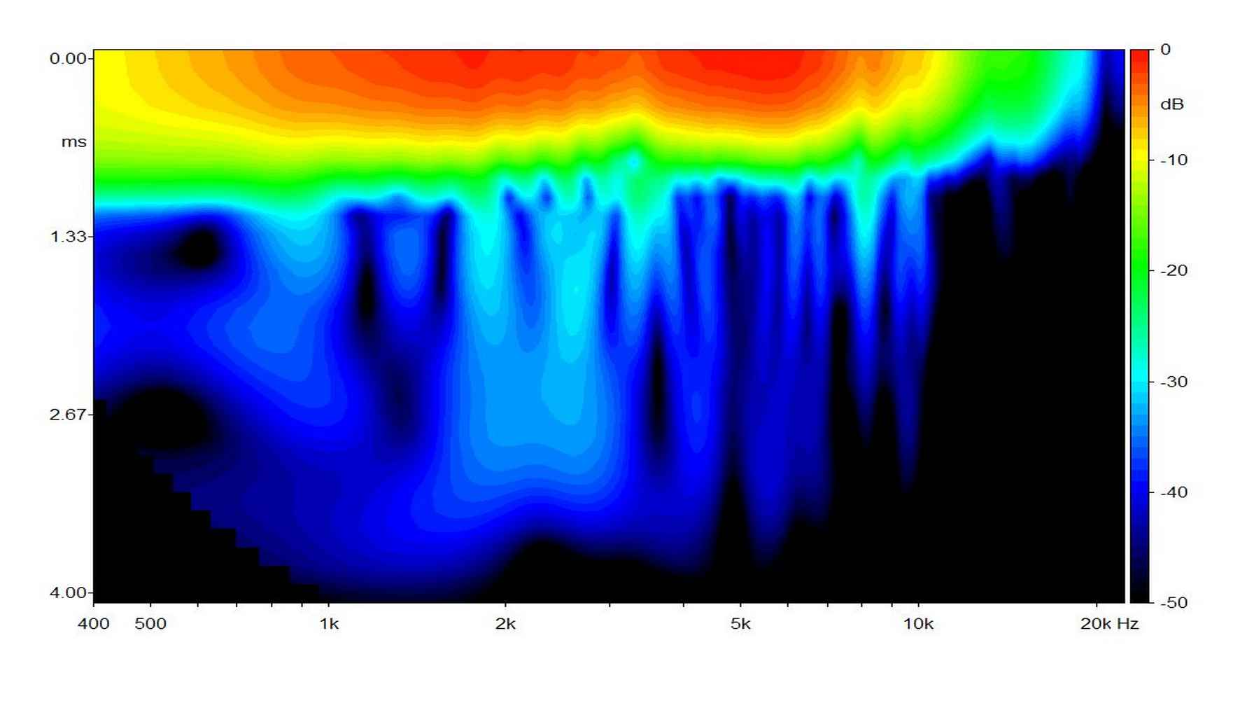

Decay - Indoor measurement at 1m of my 3-way in post #25 (noice high spl!)
  • decay of indoor measurement is not very valid, lots of problems
  • decay shows mostly interference problems and driver resonances
  • EGD is one way to show effect of a multiway speaker's xo, others are step response and ETC.
@Juhazi Thanks for posting that. Your decay is so even all the way across! My 3 way is like -3db down after 2ms whiles yours is -7db in places.

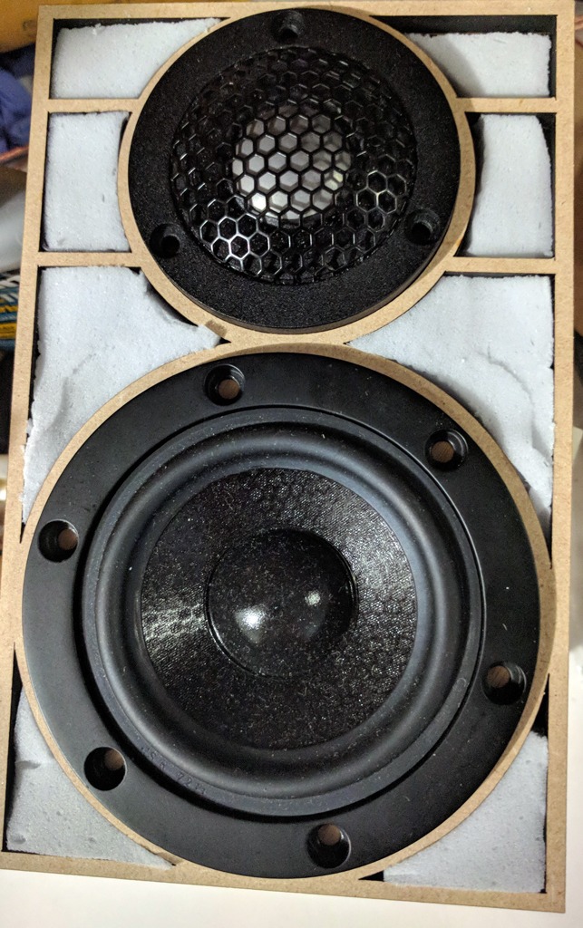

I might have a way to help zap some of those issues. This is what is behind the felt and perforated metal sheet for my 1st speaker posted on page 1. I've only made 2 test baffles so far. The early measurements do show a -6db reduction in the decay. The tricky part is getting the center frequency right. In the pic are the air chambers that are 5mm melamine + 5mm air space.
I hope to make a similar baffle for this project if I can prove it works for my 1st one. I'll know soon enough.
So this could be one way to deal with resonances but I do not know for sure. If it works out, I would make the chamber deeper for this new project. This should increase the range of frequencies that I am zapping.

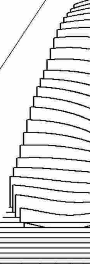

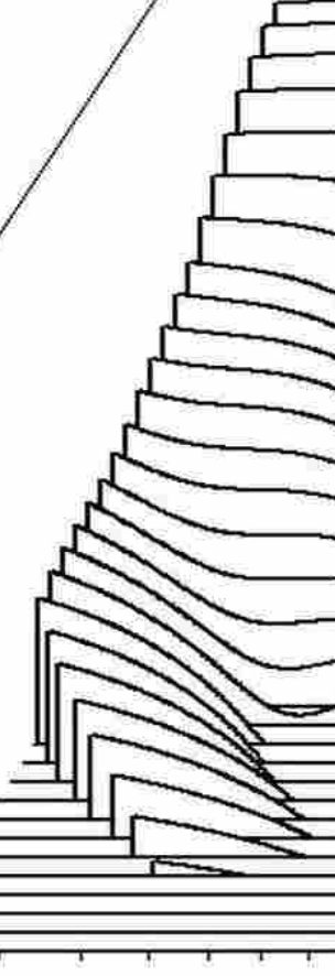

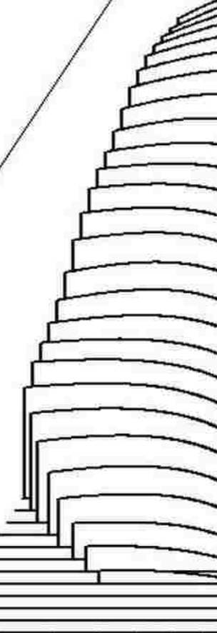

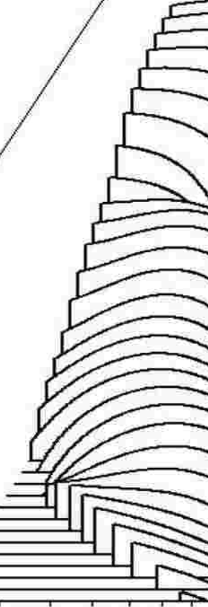

This is more data from http://www.dibirama.altervista.org/le-prove/mid-range.html .

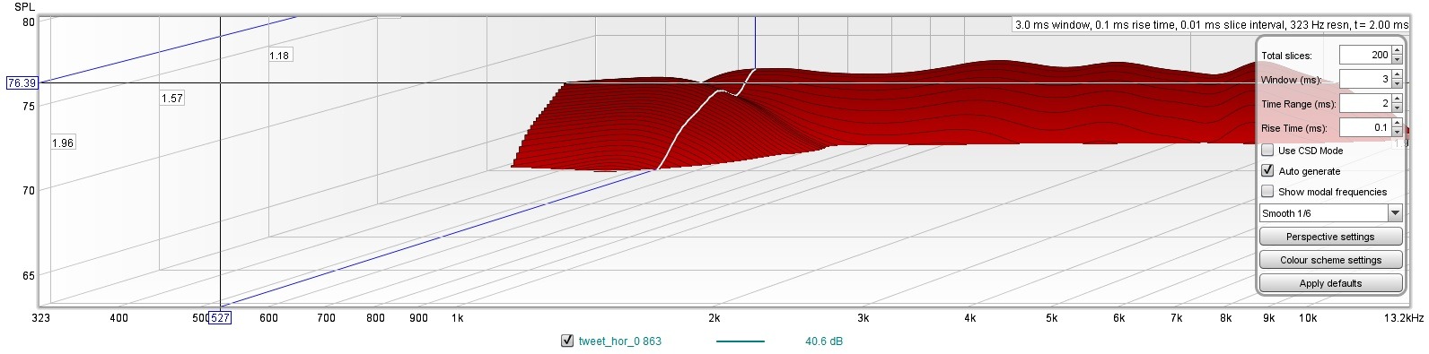

I'm a fan of flipping through images quickly for comparisons. Since the SPL of the operating range does not line up in a normal waterfall I put the top right corner on the SPL line of each driver around 1200hz. The drivers are clipped at 400hz and 500hz is in the bottom left corner.
The visaton is $100USD each and the dynaudio is $600USD each. Quite the jump.
The XOs for each will be a bit different but I think I want something that is flat most of the way down.
Thanks for posting that, @atoluma ! Can you generate a "decay" graph like the one on page one. If yes, be sure the match the settings and uncheck all but 1-4ms.

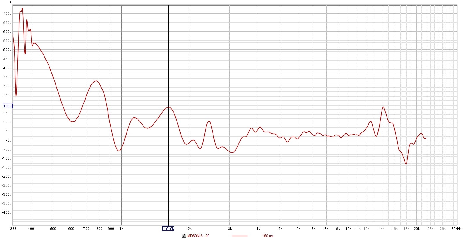

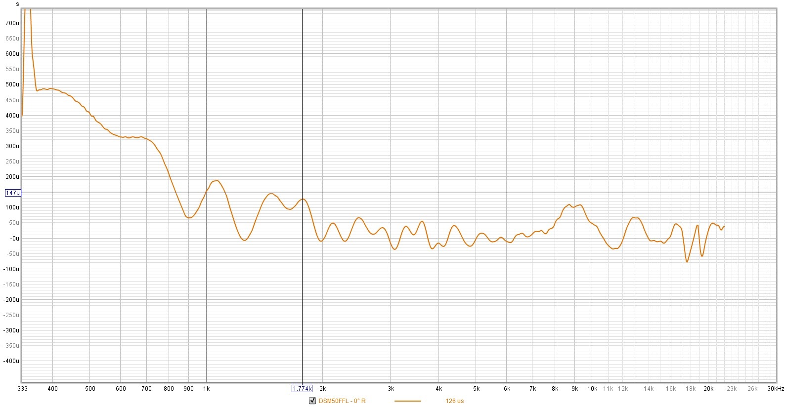

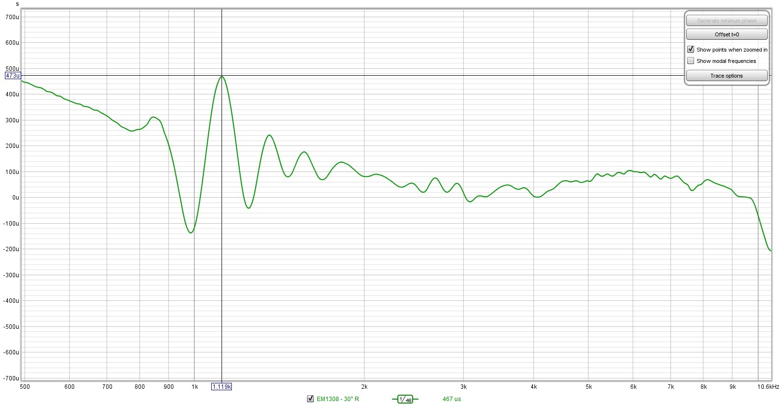

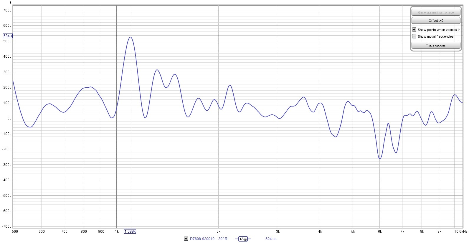

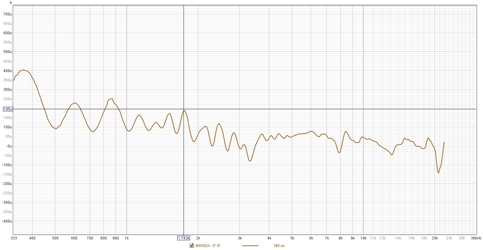

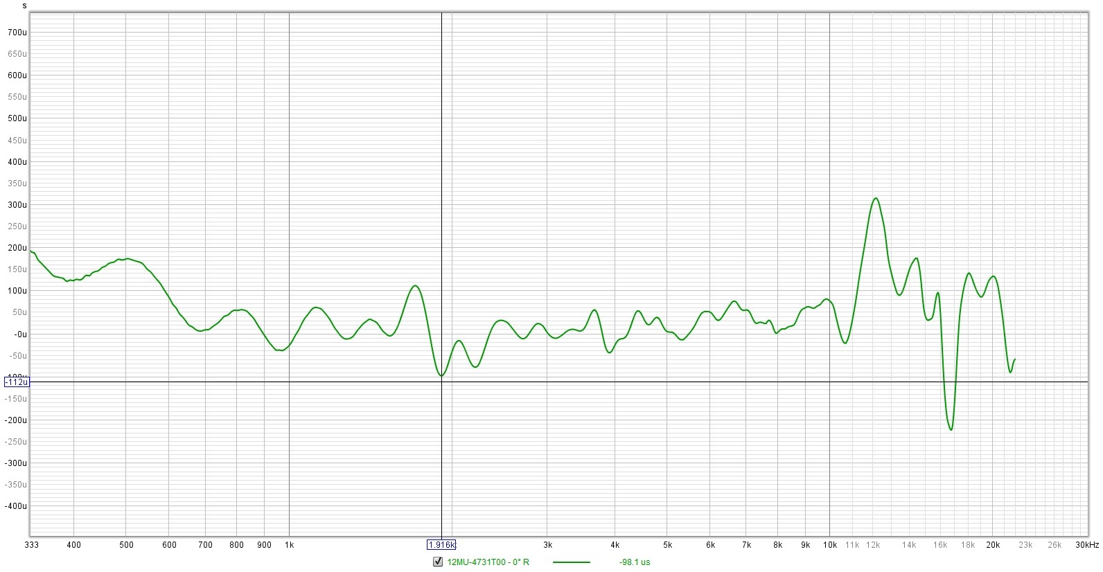

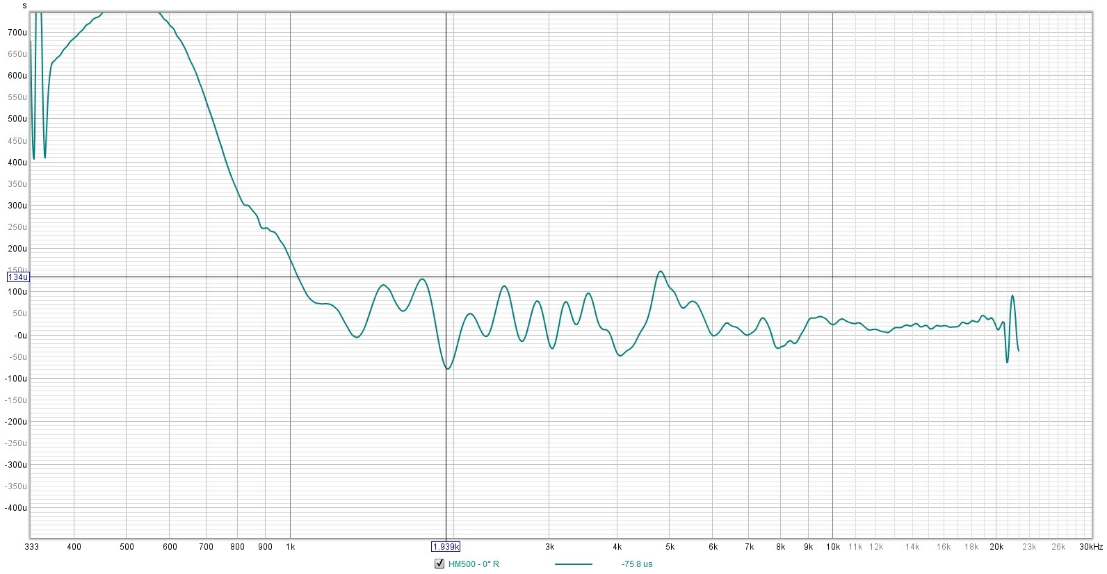

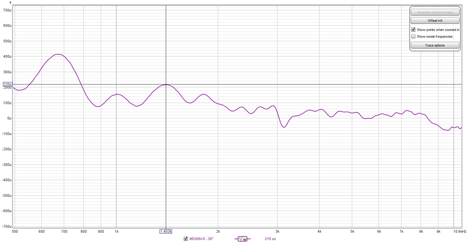

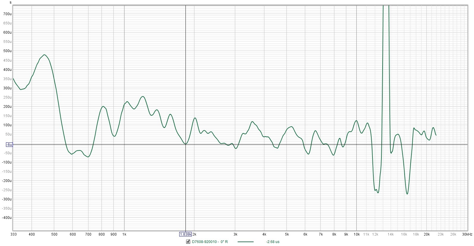

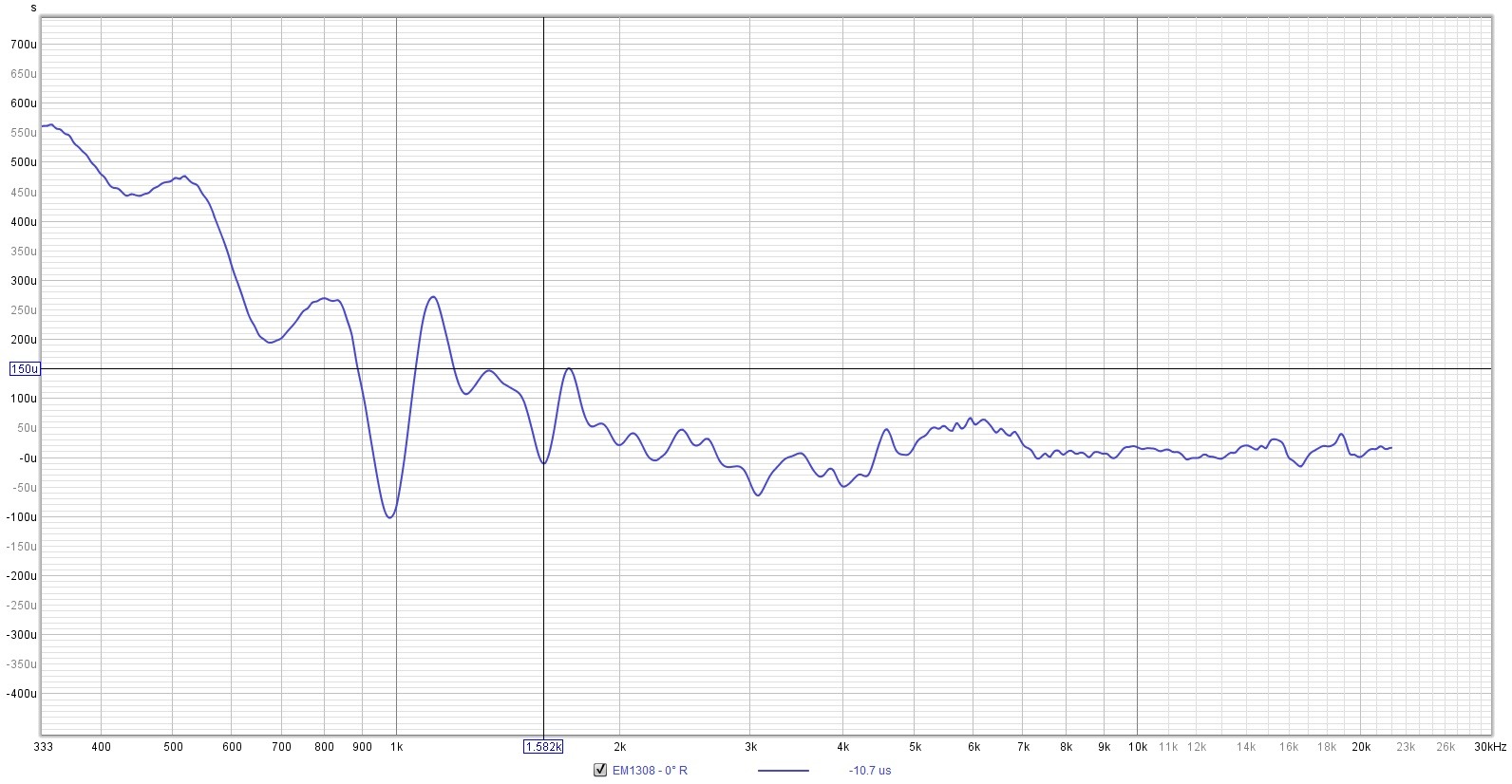

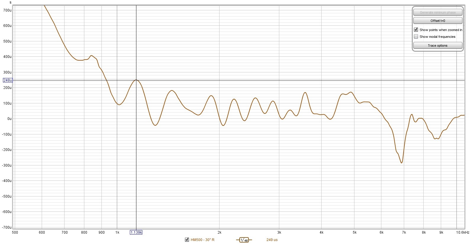

Another look at some drivers with a GD graph. This time I imported the impulse from http://www.dibirama.altervista.org/ into REW.
There is a morel driver in the mix.
hm500_gd.jpgM560DA_gd.jpg12MU-4731T00_gd.jpgDSM50FFL_gd.jpgEM1308_GD.jpgD7608-920010 _GD.jpgmd60n_GD.jpg

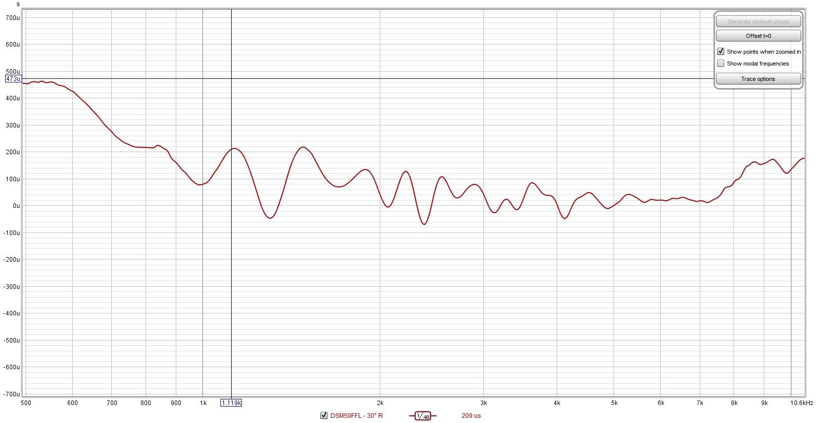

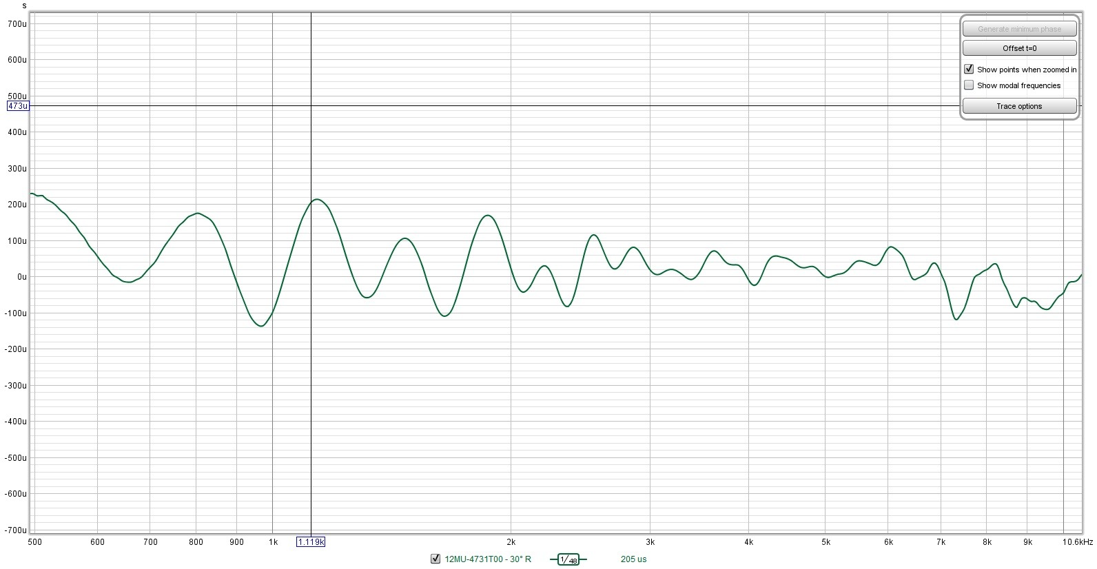

I was wondering if much changed with the 30-degree measurements so I imported those in too. The answer is a huge yes!
The satori md60n gets better at 30 degrees! Funny enough, many drivers get worse. Only a couple look better or the same going from 0 to 30 degrees.
hm500_30deg_gd.jpg12MU-4731T00_30deg_gd.jpgDSM50FFL_30deg_gd.jpgEM1308_30deg_GD.jpgD7608-920010 _30deg_GD.jpgmd60n_30deg_GD.jpg
