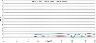

https://hificompass.com/en/speakers/measurements/scan-speak/scanspeak-10f/4424g00The SS 10F is an interesting animal, but THD is way up there for a higher end mid driver.
Looks really quite good to me. The THD might not be the "best" but HD2 is the largest component of THD by far in practically all cases, and it's also the most benign form of non-linear distortion (in many cases inaudible up to 10% or more), so THD in itself is not a good measure for how audible the harmonic distortion is.
HD3 is also fairly benign, but likely not to the same degree that HD2.
The 10F SS is a good mid for sure and has a big following on here. It has a decent motor design and bandwidth for its size. The 2nd order HD on paper is pretty good down low comsidering its size and limited xmax, especially for lower output use. My issues with it are how it sounds when driven a bit harder. Crossed around 300-400 hz driven to mid 90s dB levels, it starts to get somewhat fuzzy, harsh and detached sounding in the upper mids. It may be the cone material and composition which gives it that character i don't prefer. To put it in simple terms, it tends to draw attention to itself under the above conditions and has that light paper cone sound. Even playing with various HP points and slopes doesn't seem to make a difference in this regard. However, of you keep the volume down in lower 90s dB it does well amd has that euphonic type of imagining associated with smaller mid drivers.

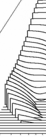

Hey! Thanks for posting the graphs and the XO. Looks cool! Do you use REW? If yes, can you post a decay graph like mine on page one of this thread?Now we have sims with a filler mid and two crossovers in 500-500Hz band... How come?
Back to your ?... How come? These were the first drivers I was interested in. The directivity kinda forced me into those XO's. I'll look at more mids. I think I am set on a t34b though.

Decay - Indoor measurement at 1m of my 3-way in post #25 (noice high spl!)
- decay of indoor measurement is not very valid, lots of problems
- decay shows mostly interference problems and driver resonances
- EGD is one way to show effect of a multiway speaker's xo, others are step response and ETC.
@Juhazi Thanks for posting that. Your decay is so even all the way across! My 3 way is like -3db down after 2ms whiles yours is -7db in places.

The main issue with the MD60-N is the distortion around 800 - 1200 Hz. It has this honk that can't be removed with EQ and it draws attention to itself at over 90dB. I don't think its a production issue and the units I tested were purchased around middle of 2021. I think its the neo motor design and the presence of a secondary cavity resonance, sort of like many chambered Hf domes have. It can be seen on the impedance plot and looks like there are two primary impedance peaks sort of melted into one. This is a result of insufficient venting between the two air cavities that make them exhibit a separate coupled resonance that causes a spike in THD.
The issues in the MD60-N may be greatly suppressed by a revised rear chamber design. It may be possible to remove the original rear chamber on this mid and use a larger and longer one. I wasn't brave enough to disassemble mine because I wouldn't have been able to return them.
The Visaton DSM50 is a nice mid dome and has a very detailed neutral sound. It shouldn't be used under 1 k with an electrical LR2 HP. Its the best metal dome mid available to this date (with possible exception to the Bliesma mid domes). I have some D52AF dynaudios that i like very much. They have that dynamic and fast sound that most large mid domes don't possess and they can play blistering loud without changing their character. The Morel dome mids are really nice too and may be an option for you as well, especially at the levels you listen. I've used all versions of their 2" soft dome and they all sound very nice with my favorite being the EM1308. The only issue it has is the large faceplate which doesn't allow for close tweeter placement without a bit of baffle modification.
I'm very sensitive to midrange distortion and response anomalies, more so than the average hifi person. The band between 700 and 5 k has to be under 0.5% THD at mid 90s dB to be considered true high end midrange reproduction and have no sudden phase shifts or decay artifacts past 3 ms at -24 dB. Thats a hard standard to achieve but its the level of fidelity you need in order to not become listening fatigued. Most compression driver setups are hard for me to listen to because of this pickiness I have, even if the HD is made up of mostly 2nd order components. The 3rd and 5th harmonics are what really kill it though.
