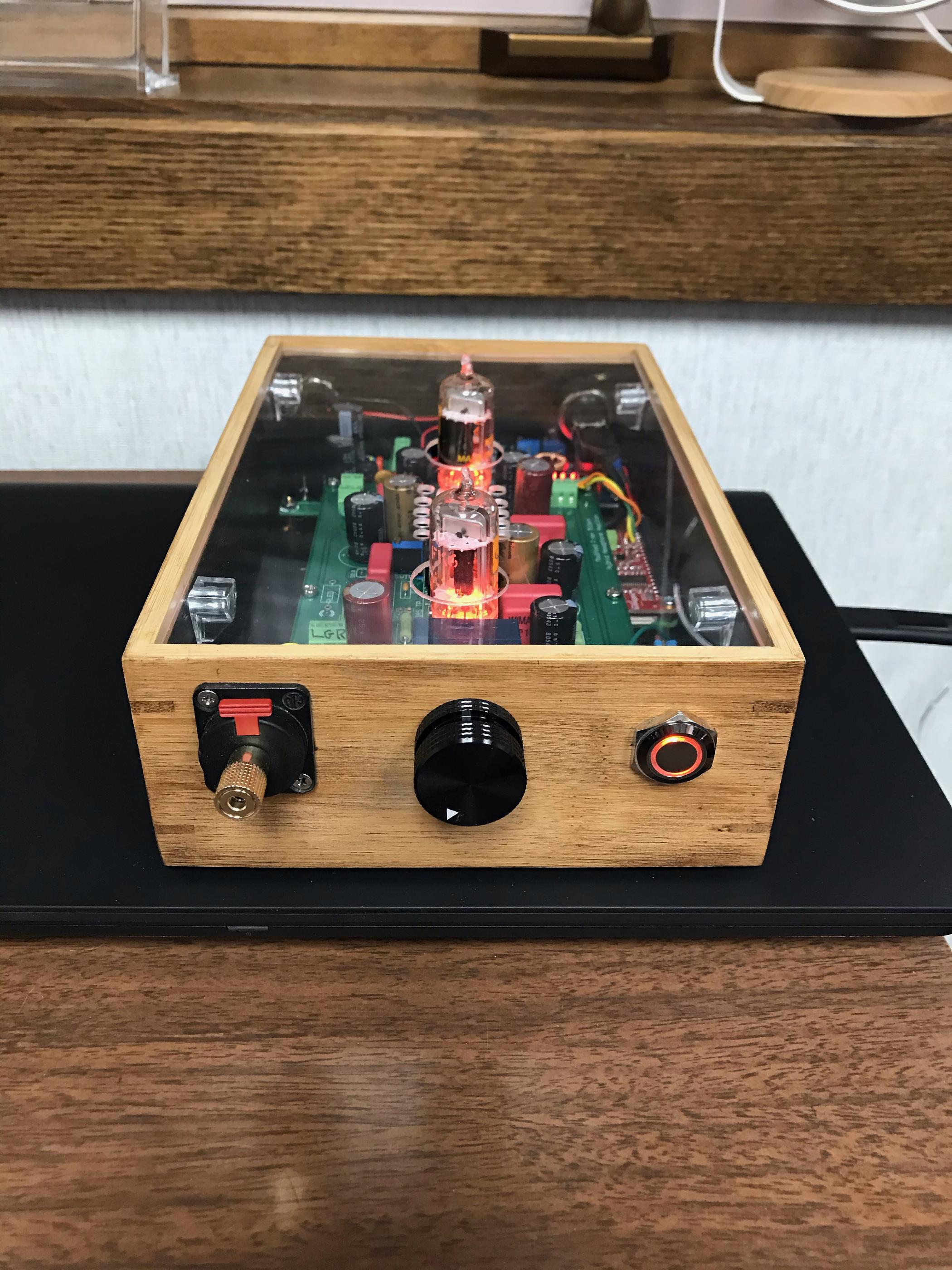

OTL tube headphone amp. Sounds more like a discrete solid state amp though 😎
Nice - a futterman?

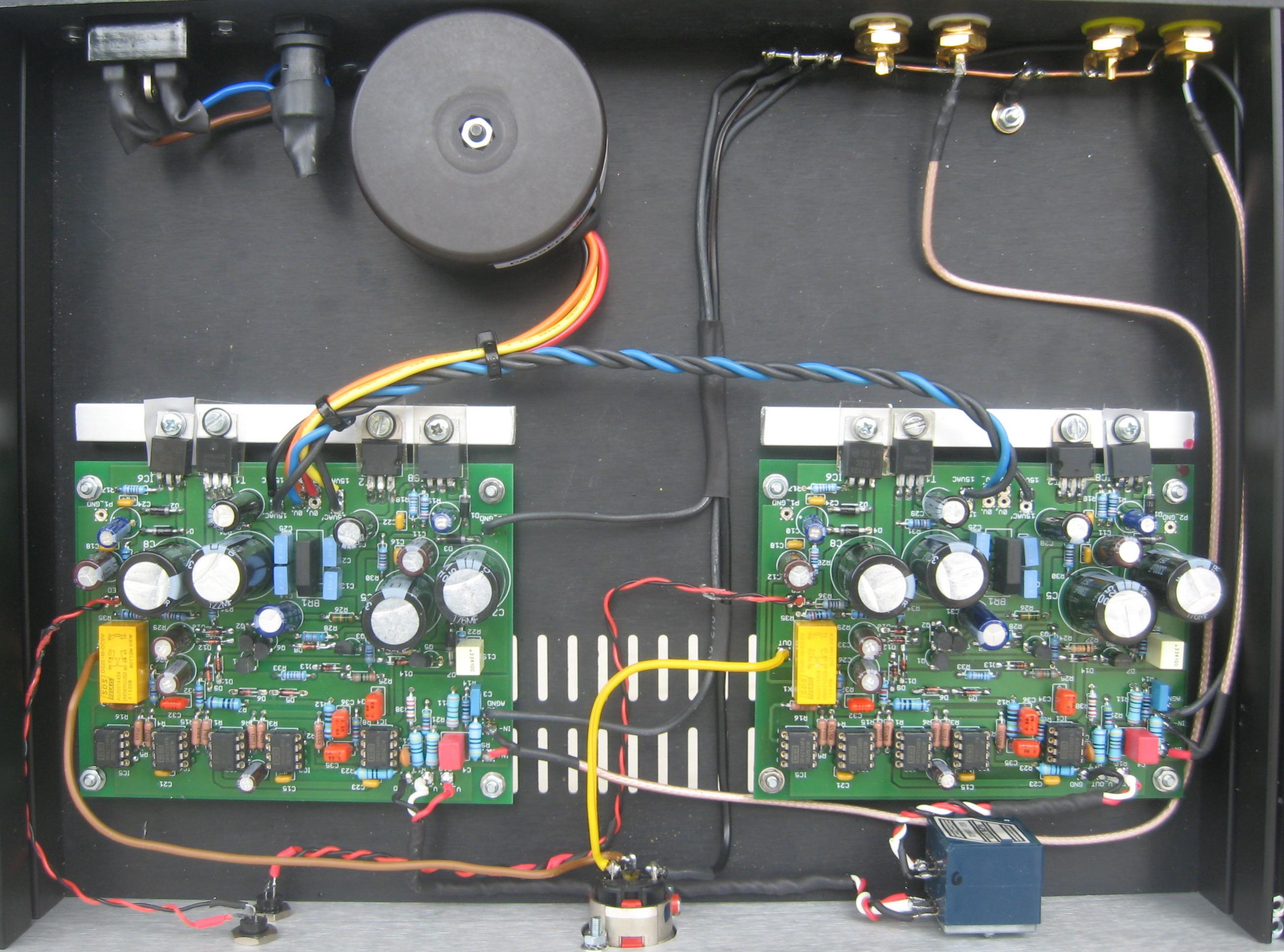

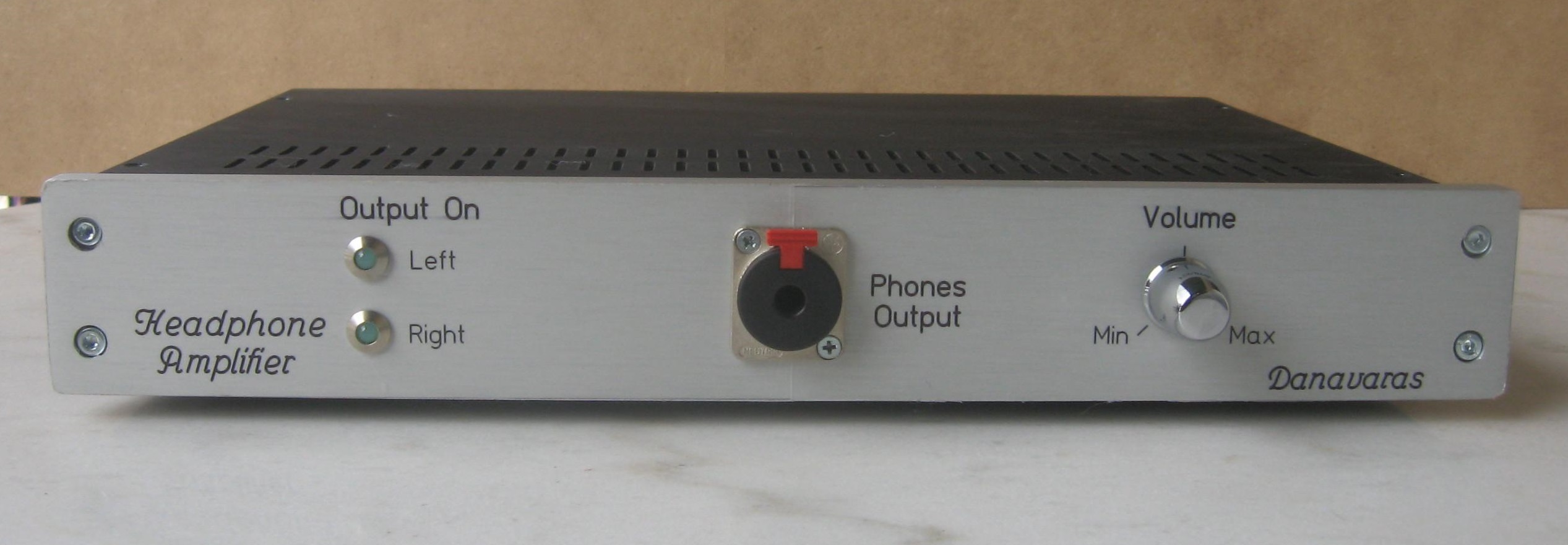

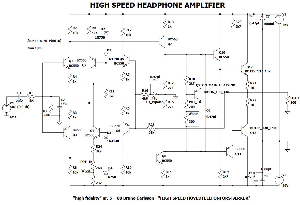

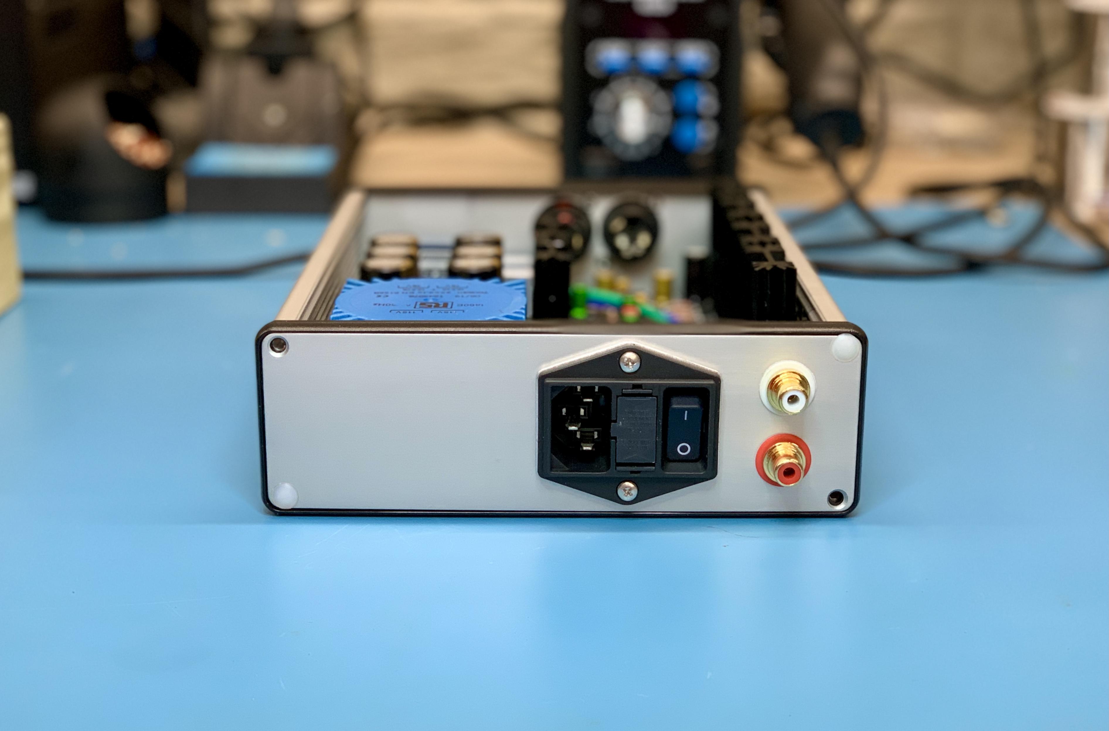

My headphone amplifier.
More information here:
PCBs for a high quality Headphone Amplifier (Audioxpress 6/2013)
I love the form factor! Very neat!
Thanks.
It sounds also very good!
Very, very quite and totally transparent!

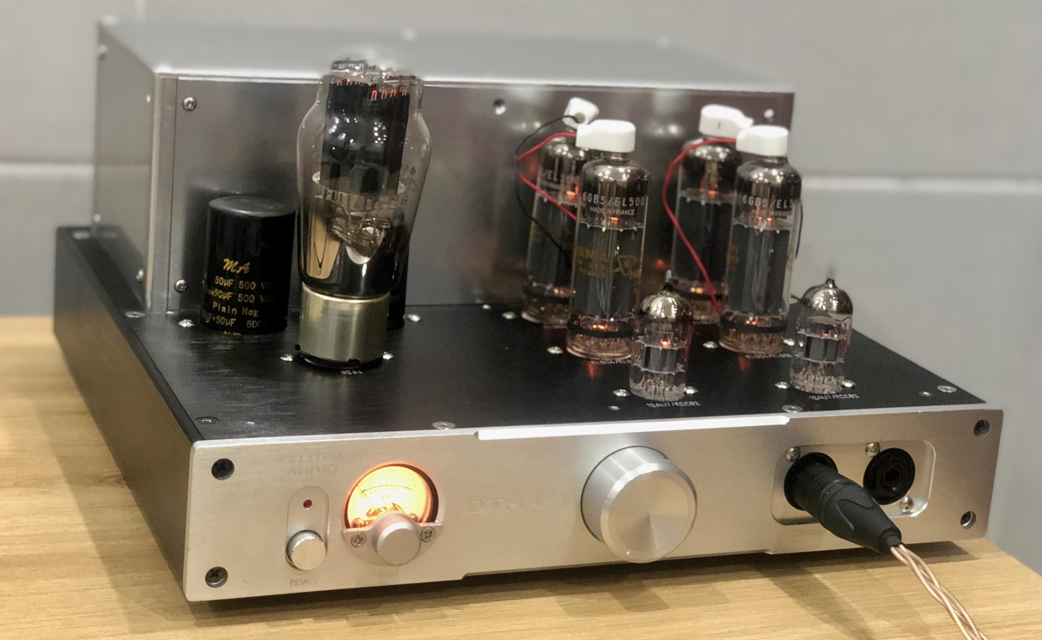

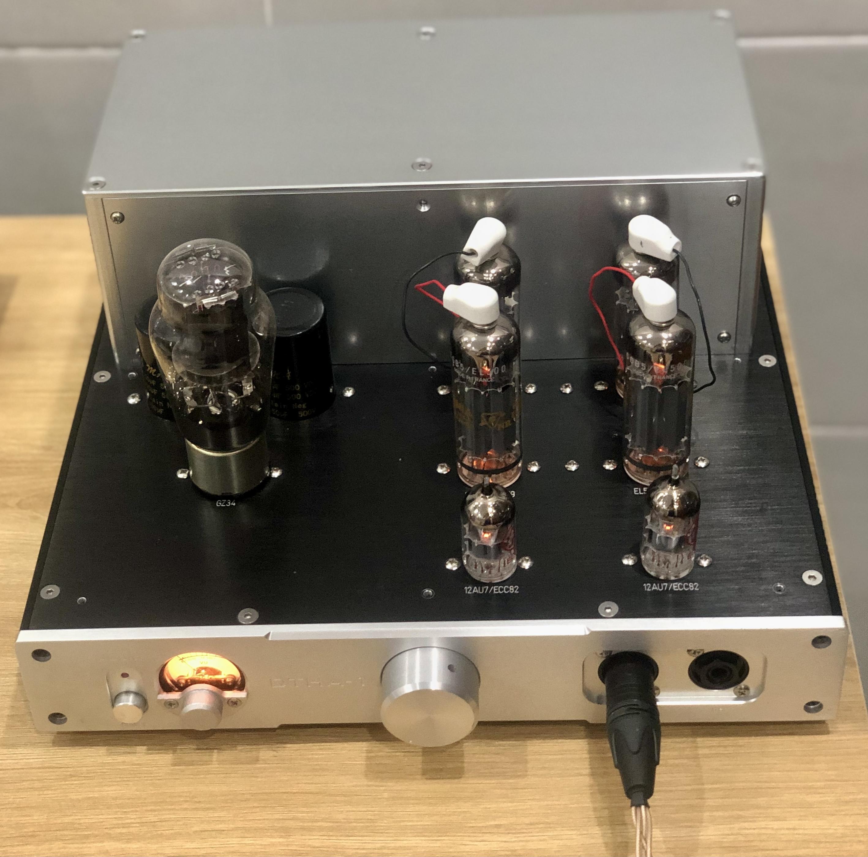

That is nice work!
Curious what makes you think that its sounds like a
discrete ss amp though.
Perhaps you are willing to publish your circuit diagram?
It sounds very clean and powerful, not as warm and sweet as my other tube amps. I compared it with my Dynalo and they both have the same sound signature.
I based on this design, didn't buy the pcb because it doesn't fit my chassis. Schematics is also in that link.
HiFi Vacuum Tube Headphone Amplifier DIY Kit Stereo Audio Amp Board | eBay

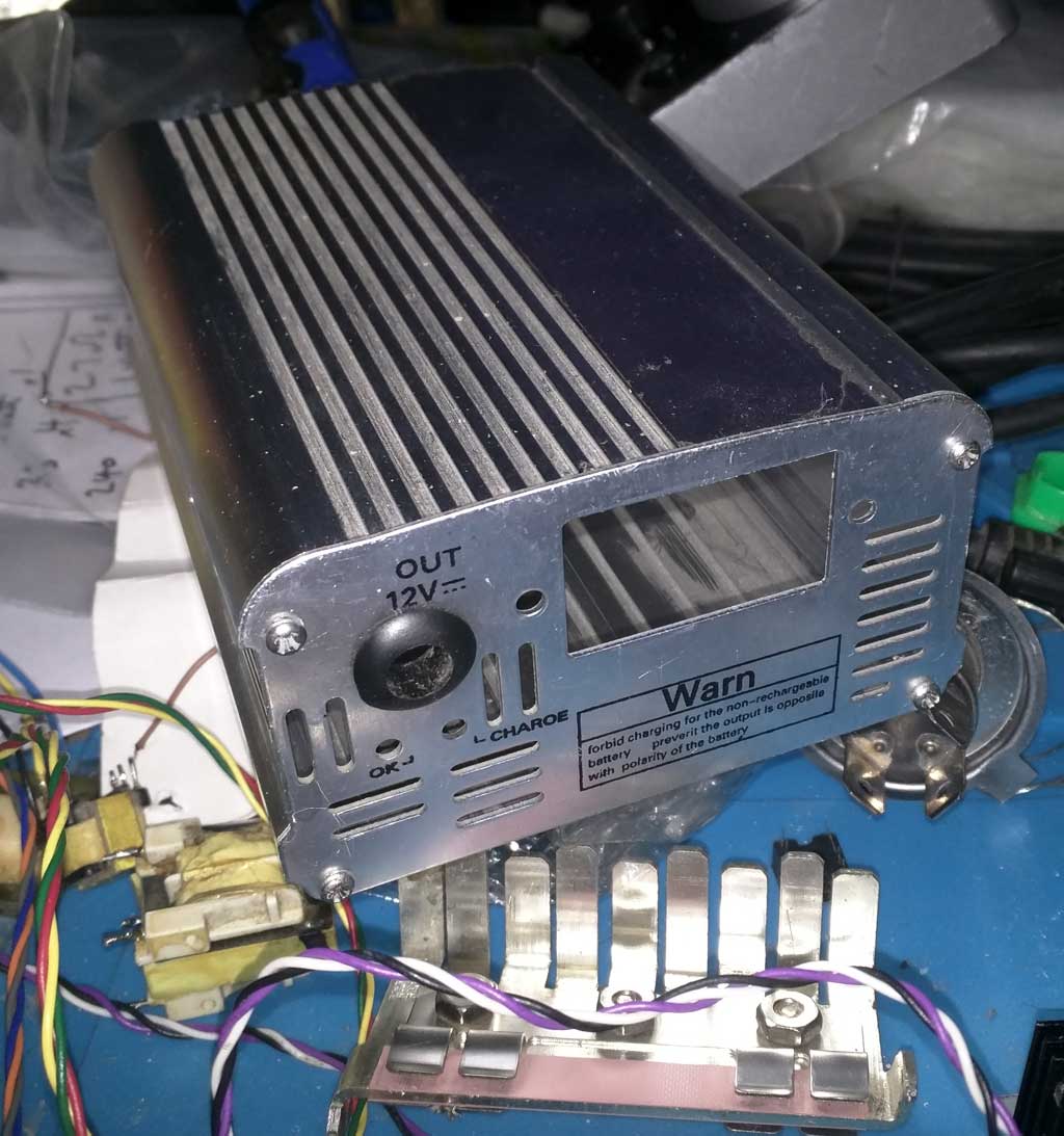

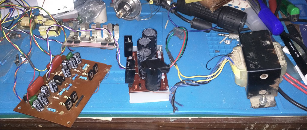

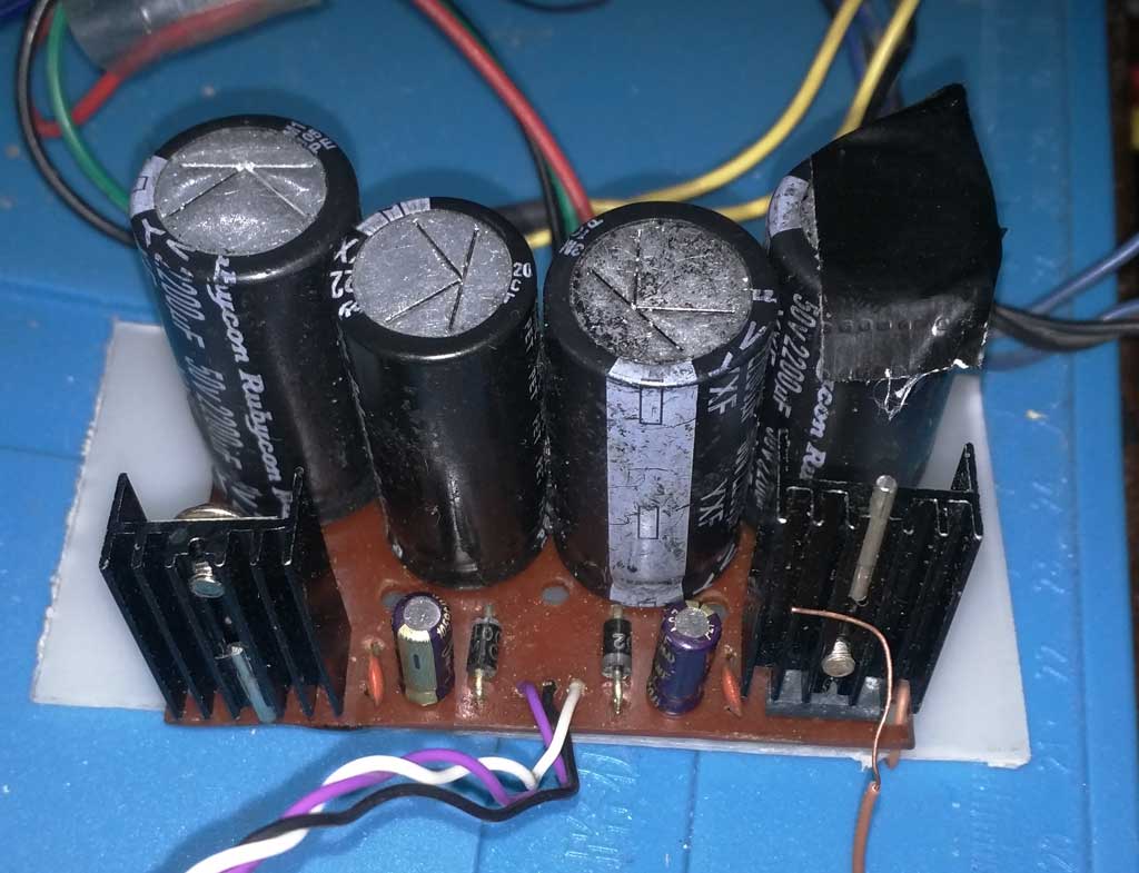

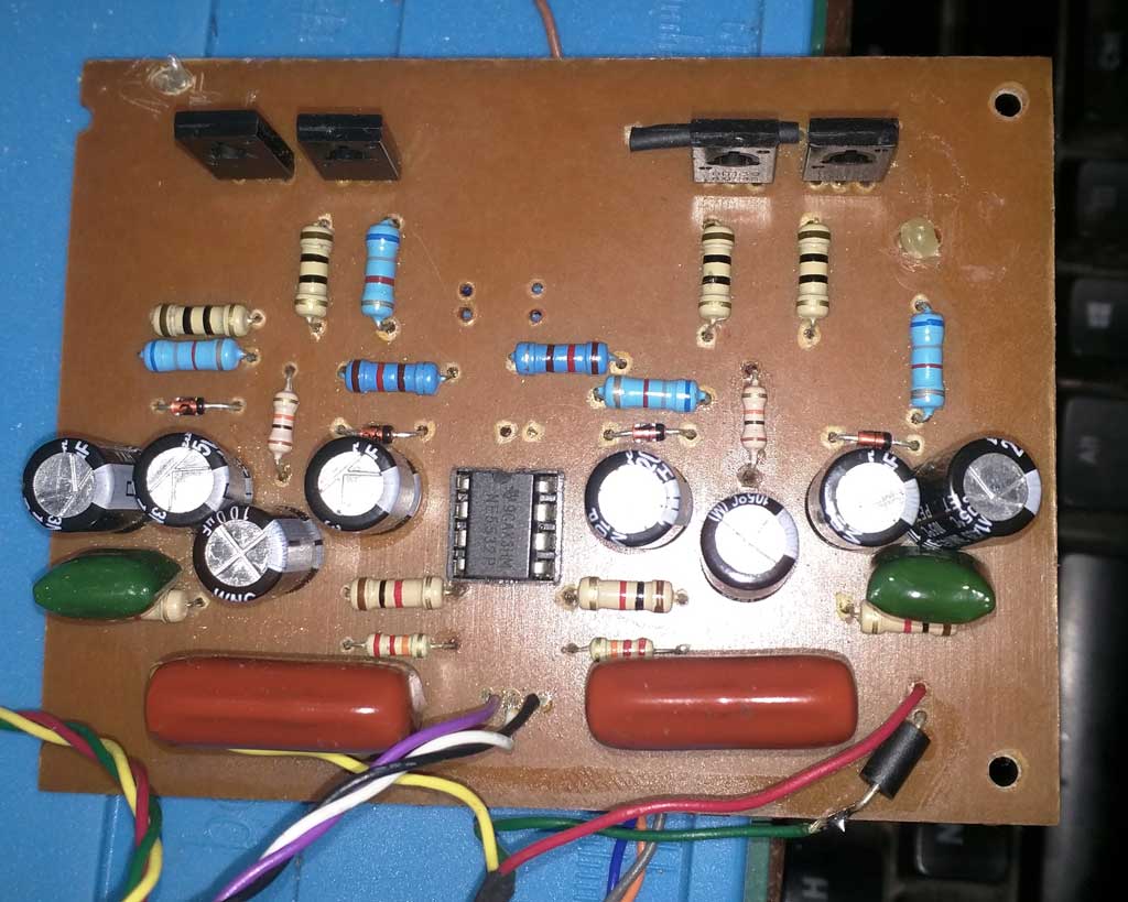

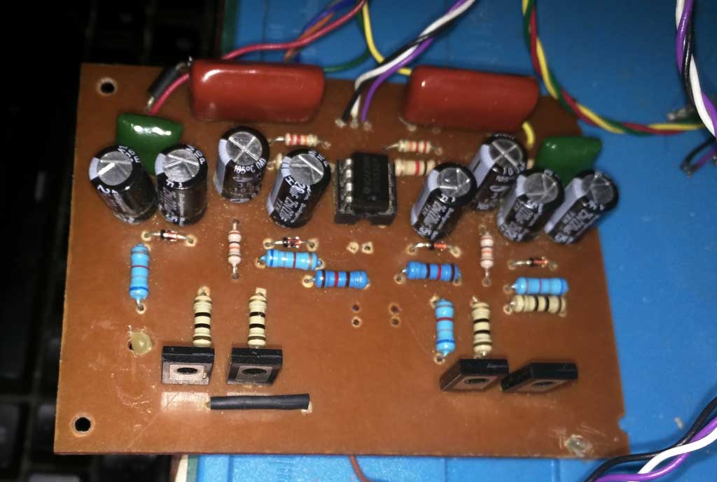

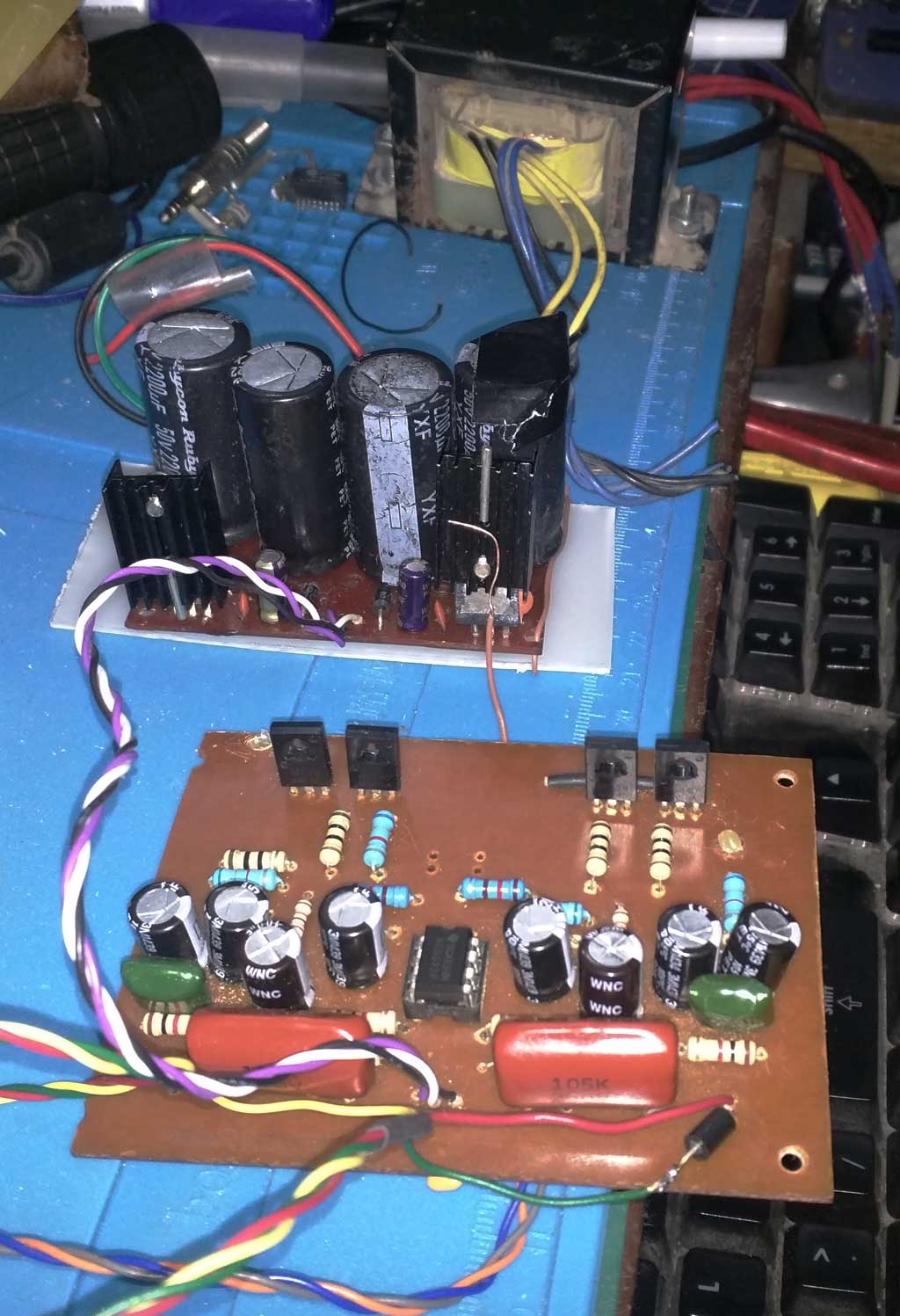

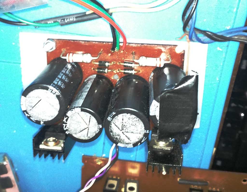

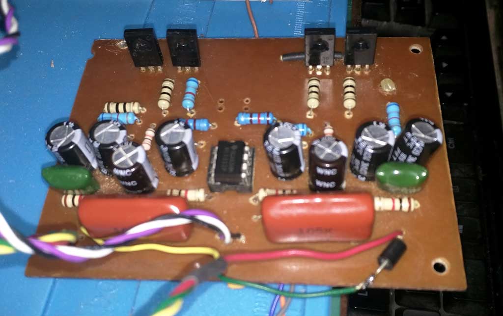

My first ever working Headphone Amplifier
Based on schematic Elliott Sound Products Project 113 also using the schematic of the mini psu from the same site.
PCB was made using toner transfer method using iron.
All the parts purchased from local shop, probably counterfeit / low quality parts. The power transformer was salvaged from an old Analog Satellite receiver. It perfectly fits inside the the shiny box except the power transformer. Need to make the front plate and then will box it.
Also waiting on 10k pot for input.

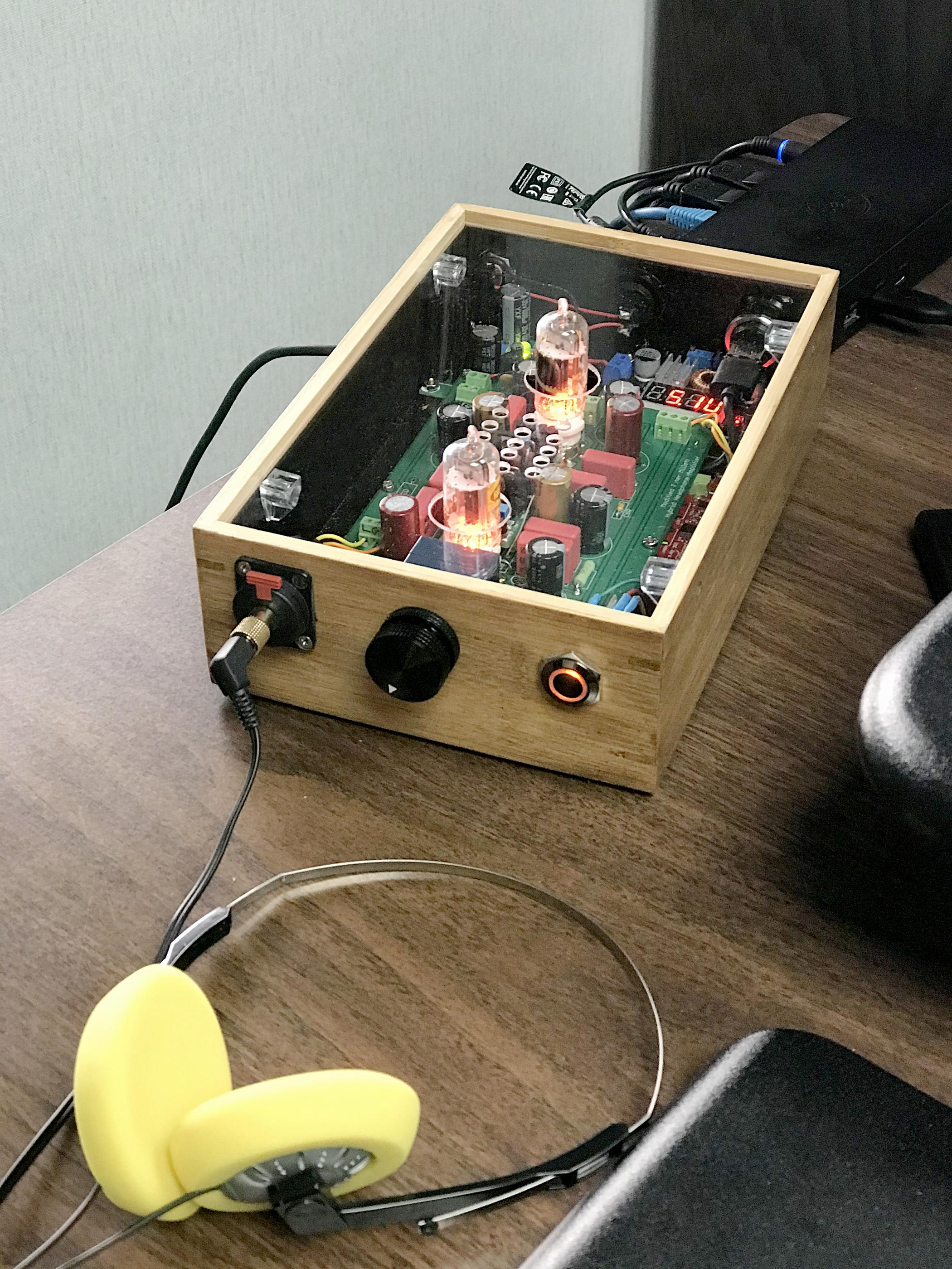

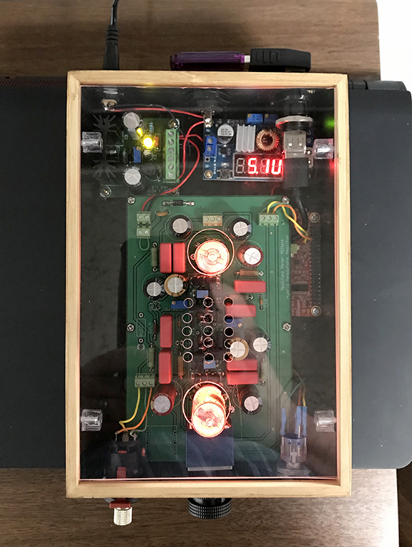

I had a drawer of old stuff, I was bored, and thought why not. It's not fancy, but it works exactly for what I need it to.
Had an OLD Millet RH PCB gathering much dust. Old red Cerafines, Muse FG, Kiwame, and Dale all around. Diamond buffer instead of opamps. Running 12FK6's. 30V wart to a LM317 regulator for the amp and a buck regulator to a ATXRaspi power controller for the raspberry pi Zero-W. Pi on/off button on the front and a main power switch on the back. Can stream via wi-fi and bluetooth, and I added a USB jack to pull flac files from a 256GB USB stick too. Using Moode Audio for the player. The Pi Zero gives some wi-fi and bluetooth noise when you're not playing a song, but when the song starts it goes away. I just hit random play and let it do it's thing all day through a pair of Koss KSC35's. Just using it in my office to drown out background noise and not annoy the boss.

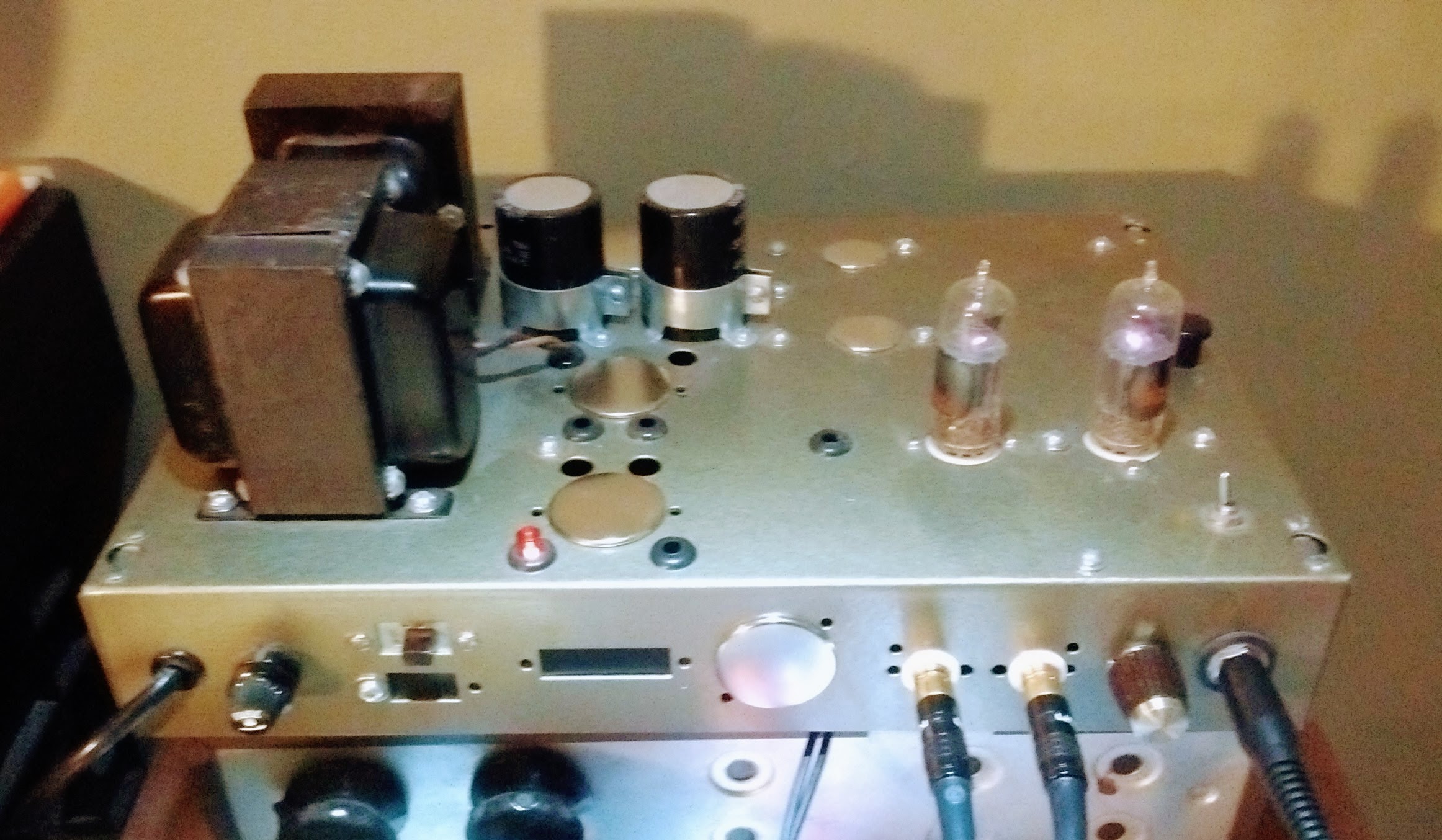

I'm gonna pollute the feed with my parts box special.
Single-ended 12HL7-triode 'spud' into Edcor XSE10-50-8K output transformers.
Choke-input power supply (12H 140 ohms), using solid-state rectifiers, passive filtering (no regulators). The heaters run on 12V AC and there's no hum at all.
Each 12HL7-triode draws 40mA plate current, running at about 6W plate dissipation.
It drives my Sennheiser HD650s to plenty-loud-for-me levels. I can switch in a Zobel network especially for those cans, but I swear I can't hear any difference between it in or out of circuit.
The amp also manages to drive a pair of Fostex T50RP to good enough levels, and cleanly. It has no problems at all driving a pair of Audio Technica ATH-30 cans to deafness-inducing levels.
The Heath W5M chassis was given to me after it was stripped of its valuable parts.
It's ugly, but I like it. It compares well to my Objective2 amp.
It lives in the bedroom, for late night listening while reading in bed.
Sorry for the ugly photo. It's a gray rainy day today and I don't have bright lighting where it lives.

I dig it!
