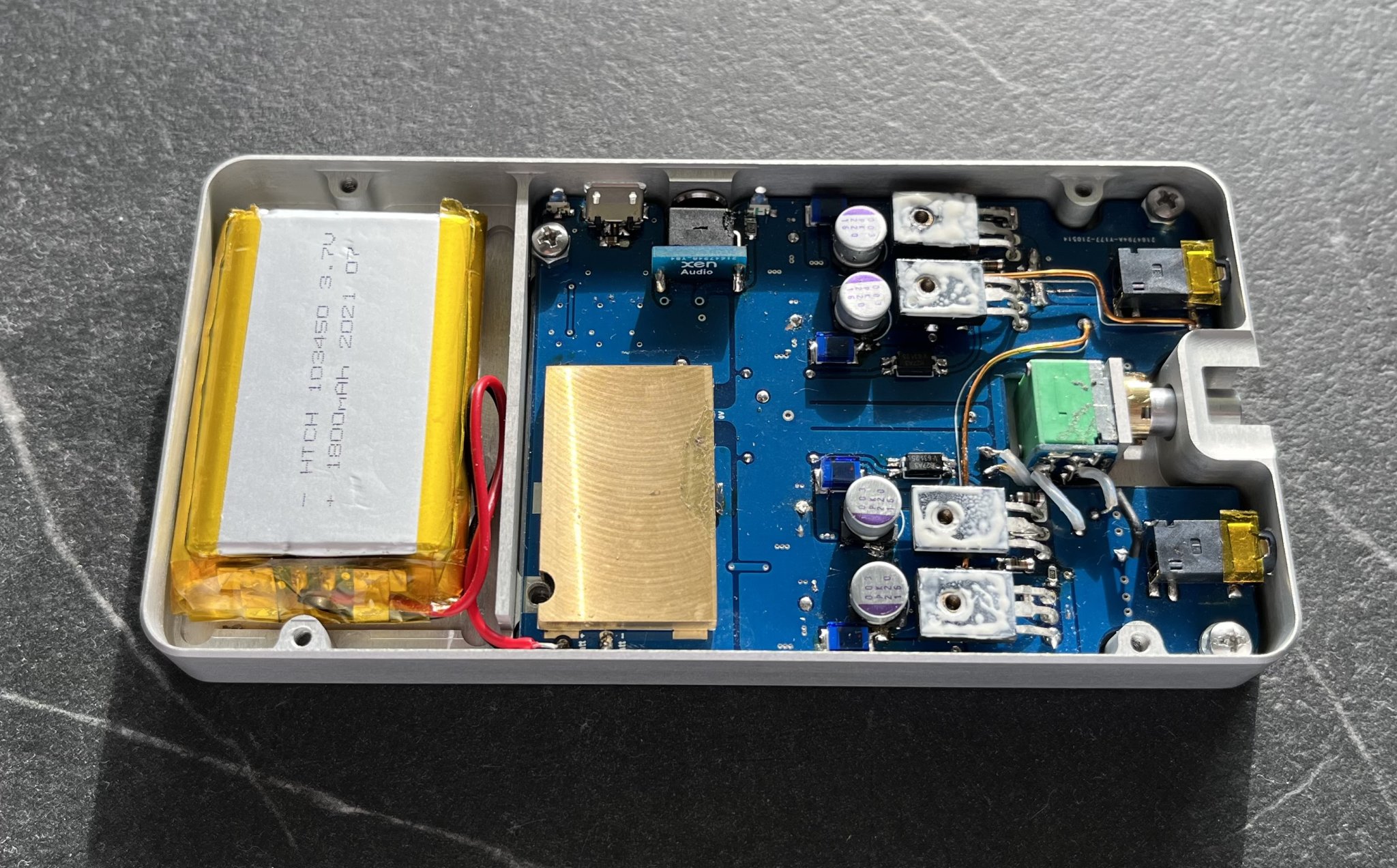

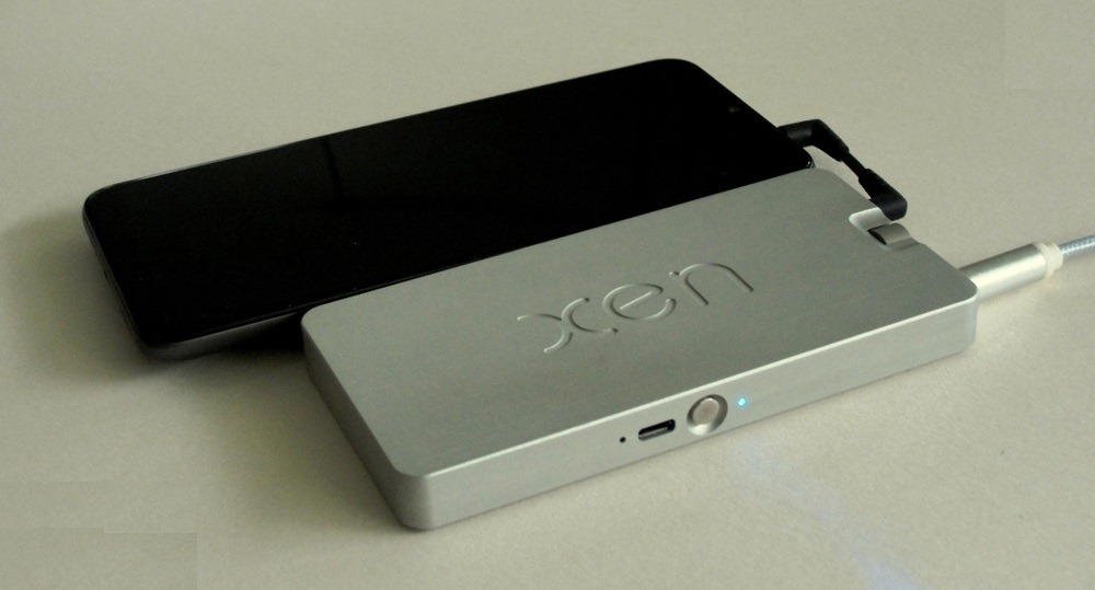

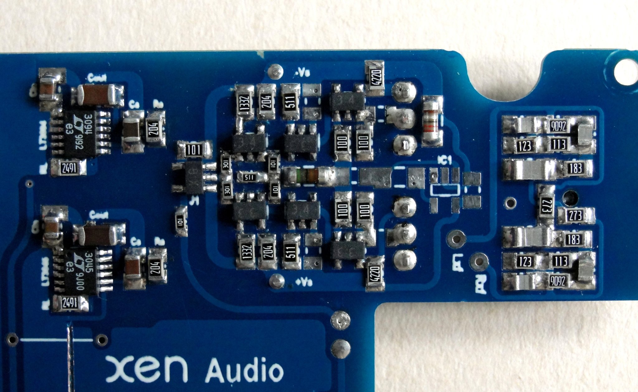

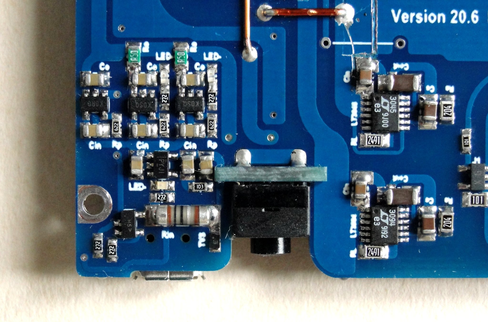

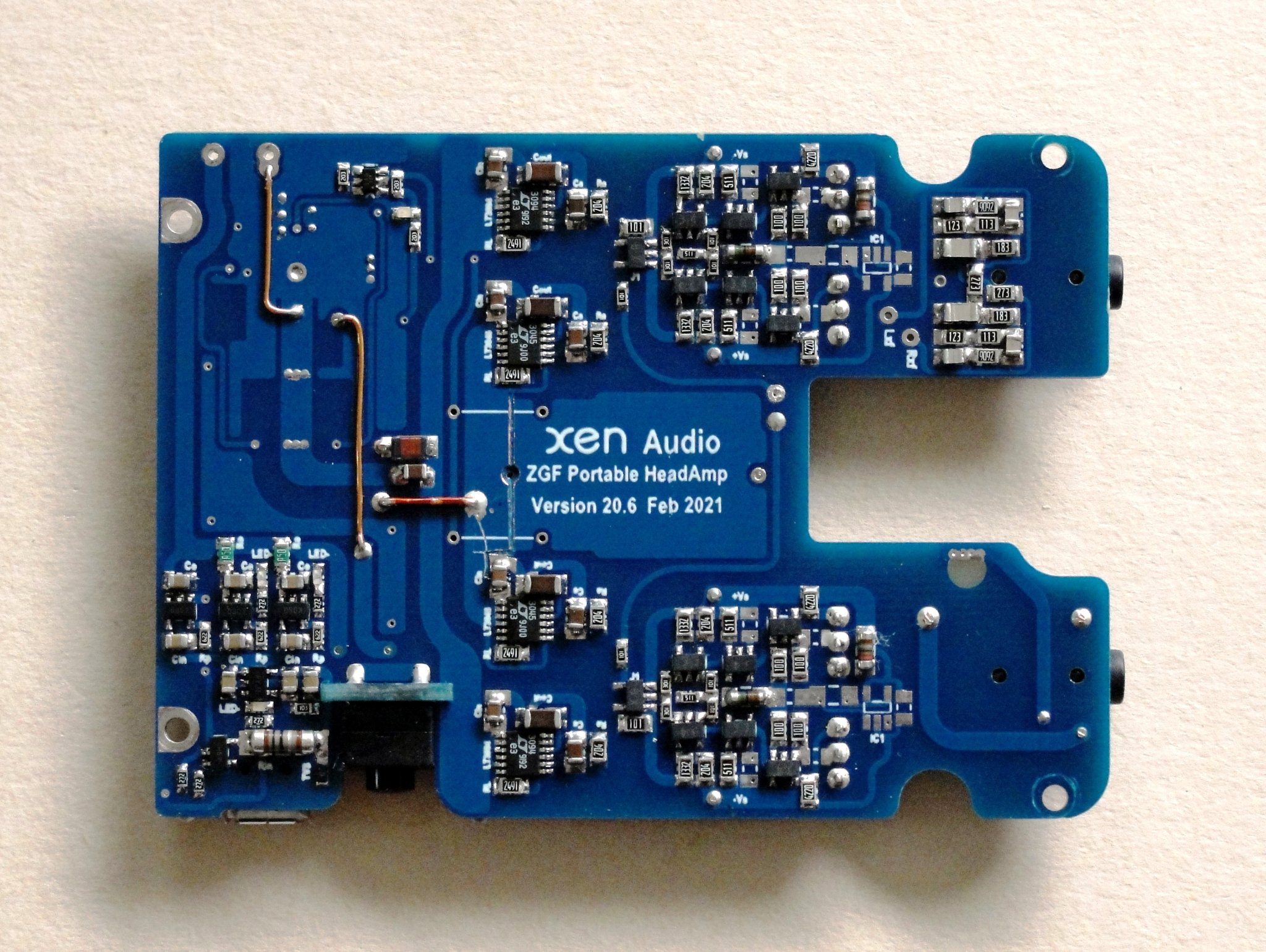

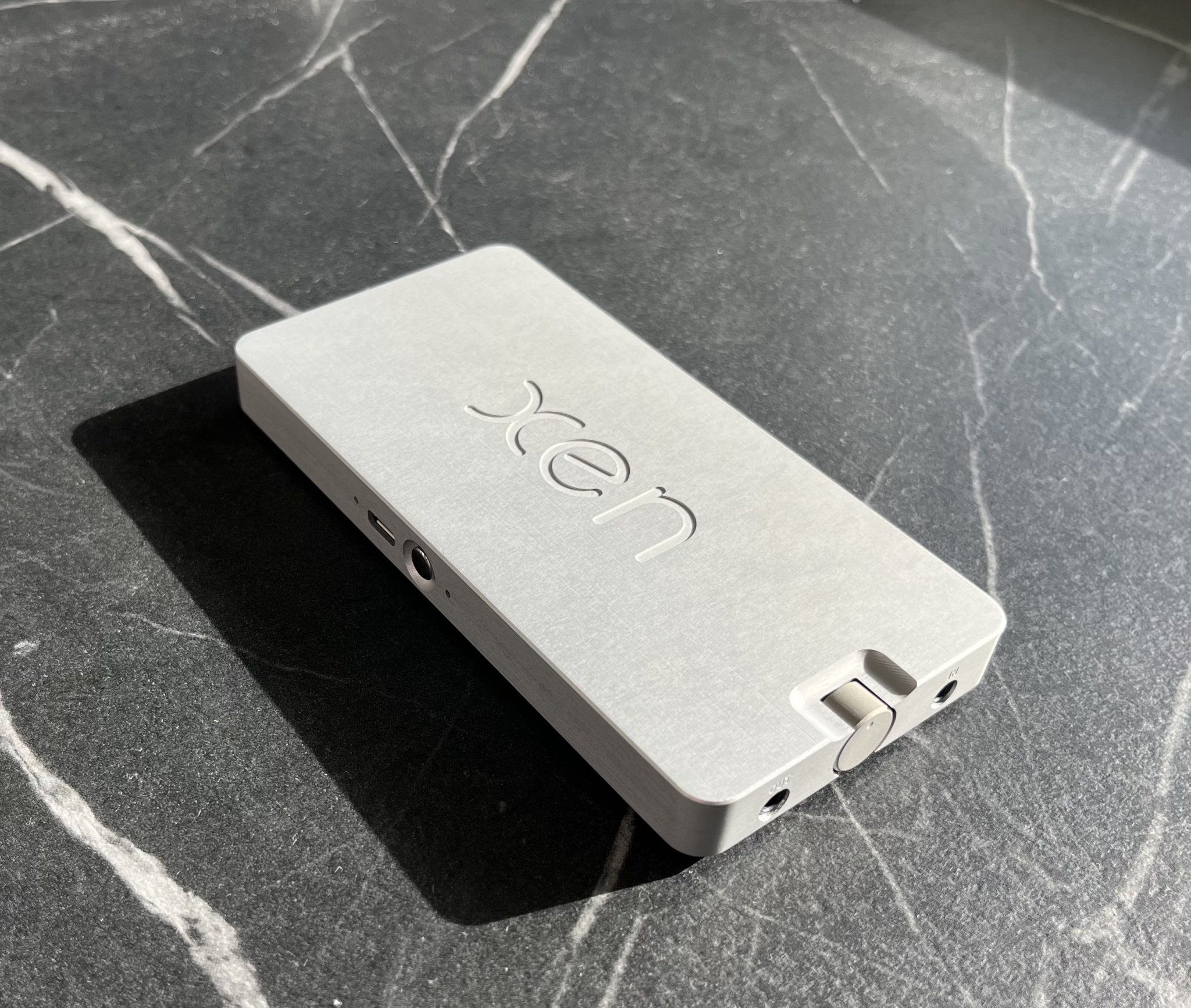

Happy to share with anyone who cares to build it, was quite a job, this is Rev 11. Al revision was bult tested and updated. 🤣
125x65mm, 160g.
JFET input, current conveyor gain stage (no global negative feedback), Class A BJT follower output.
All Toshiba active devices. Built-in passive modified Danyuk crossfeed.

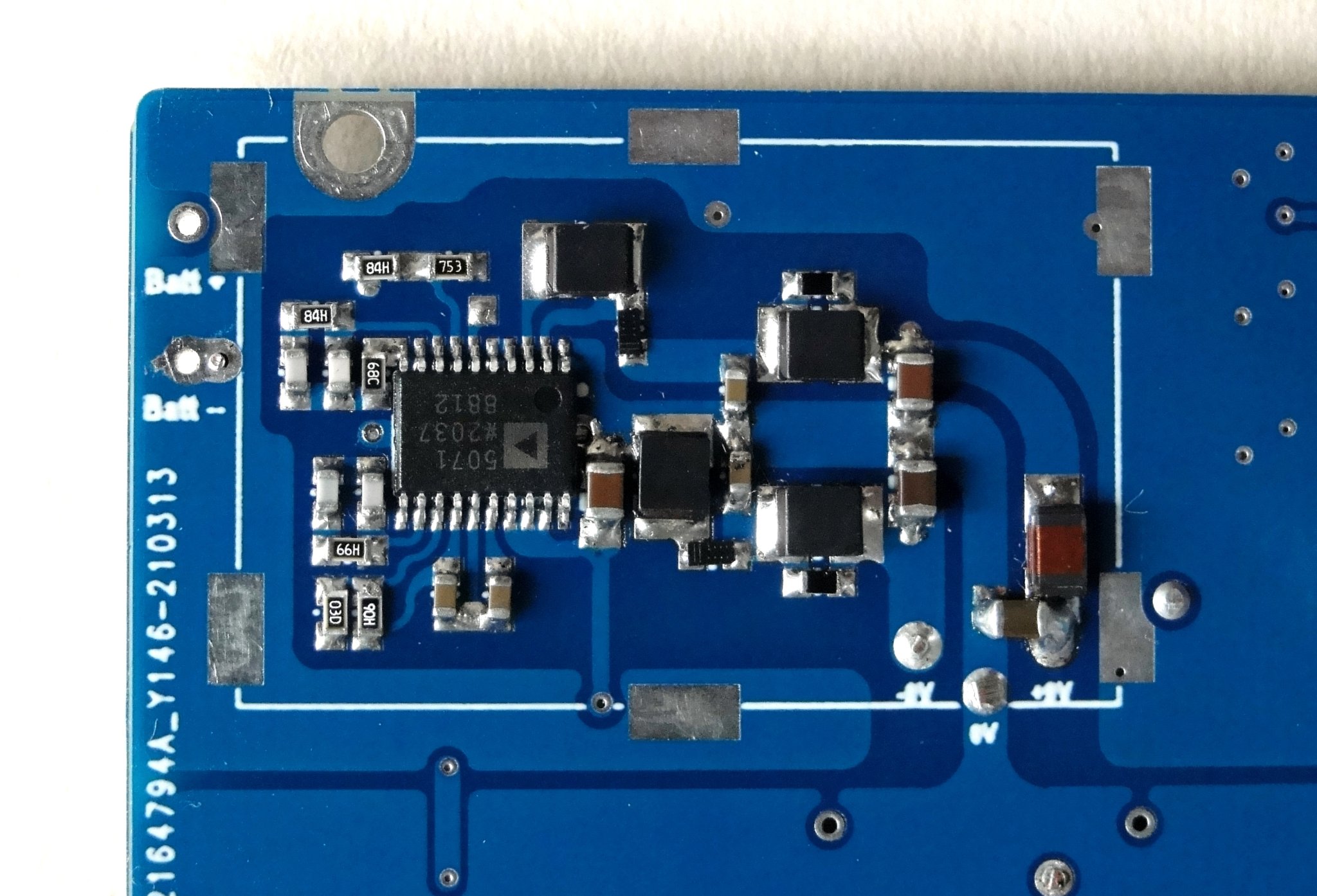

Li battery powers an AD SMPS to generate +/-9.3V.
LT3045/3094 local regulators per channel +/-7.9V.
Built-in USB charger.
Patrick

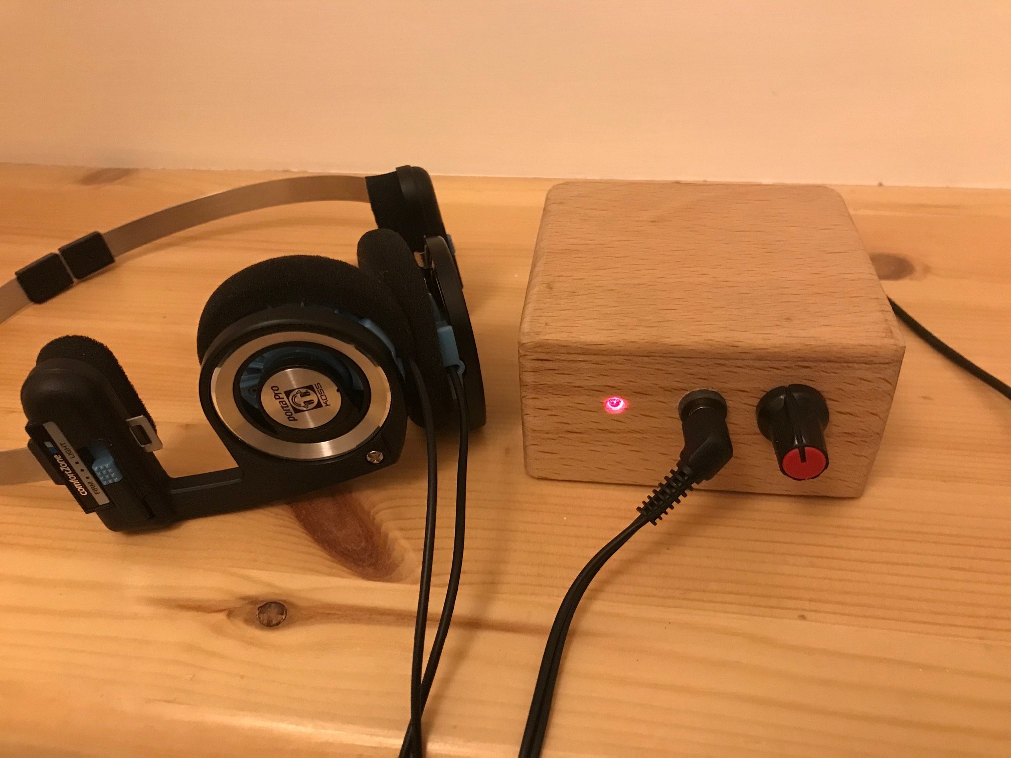

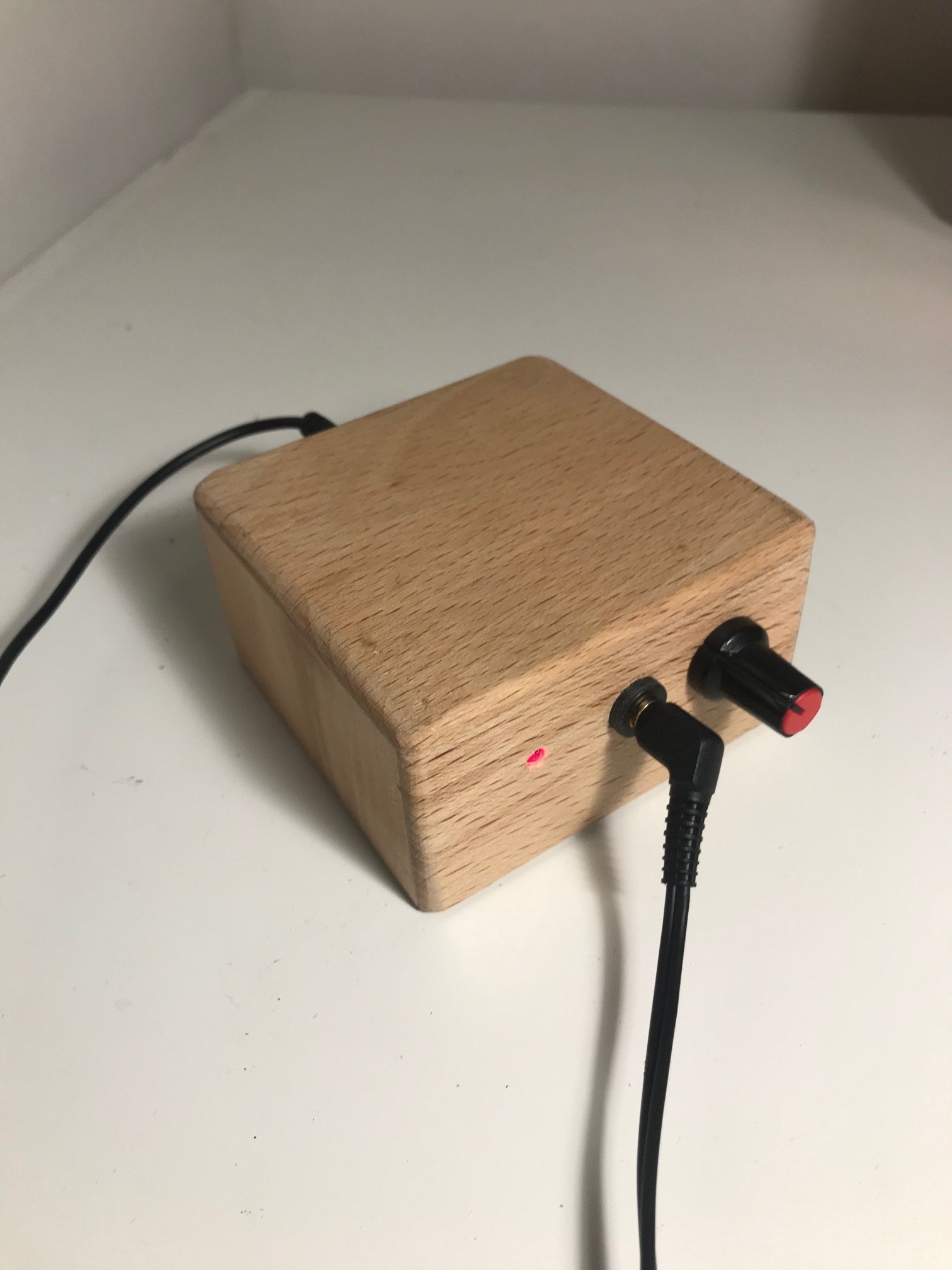

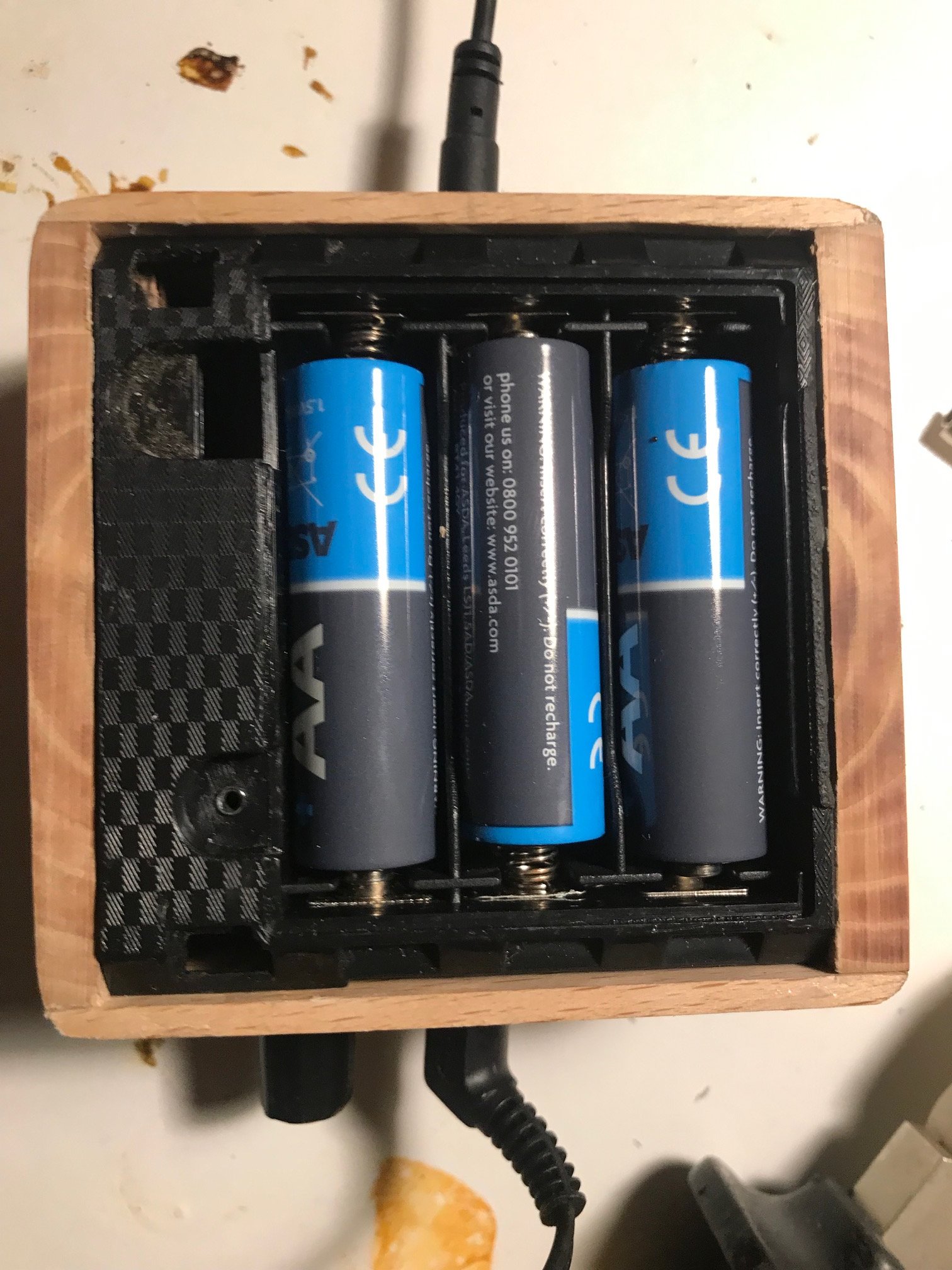

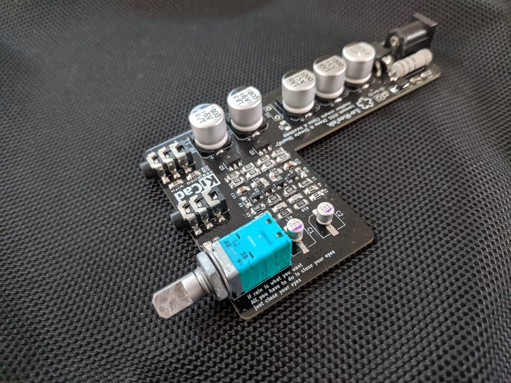

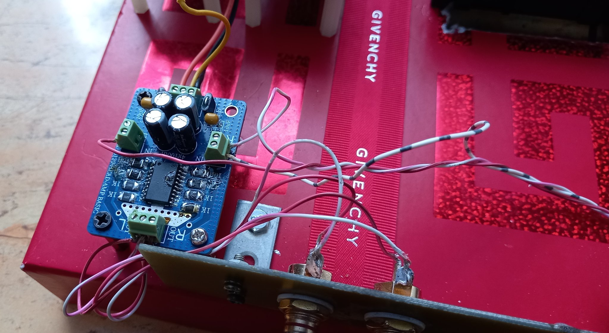

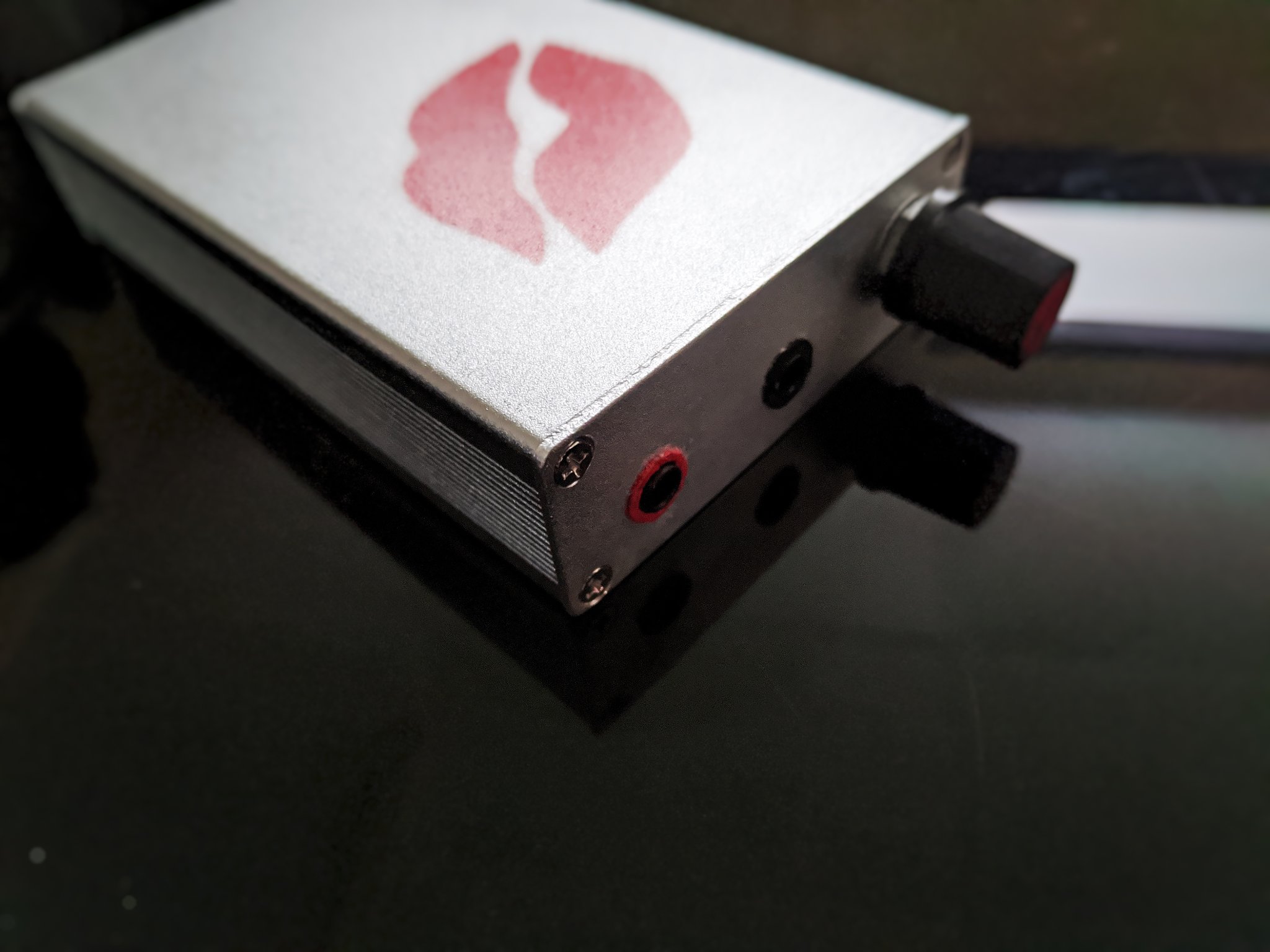

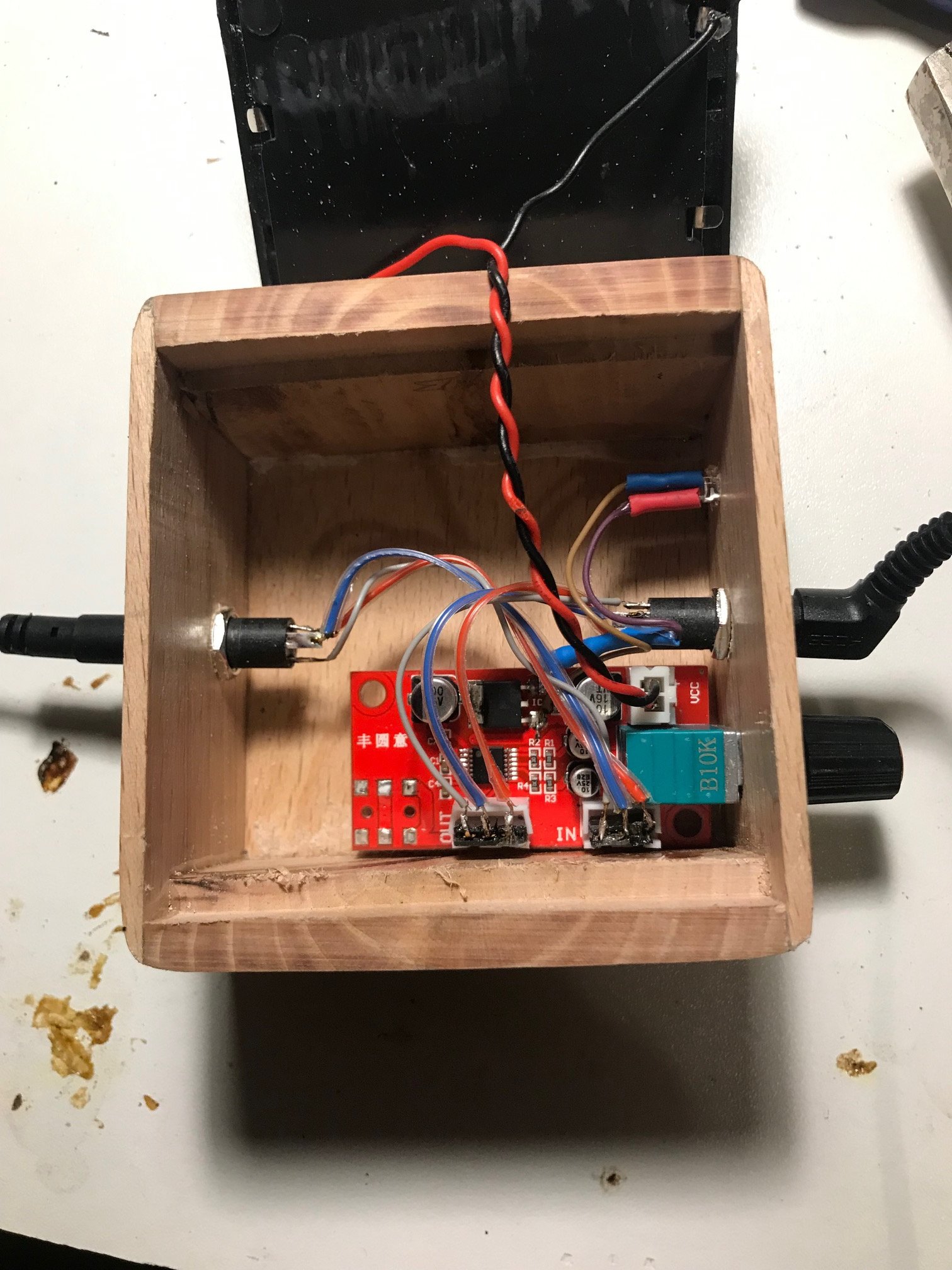

This one I've made for my father in law (who has poor hearing and uses headphones to watch news on TV). It can be used with his IPad as well.
I wanted to keep it as small as possible. My first thought was a CMoy but then I realised that the world has moved on.
This is MAX4410 from Ali. It is not half bad in fact.

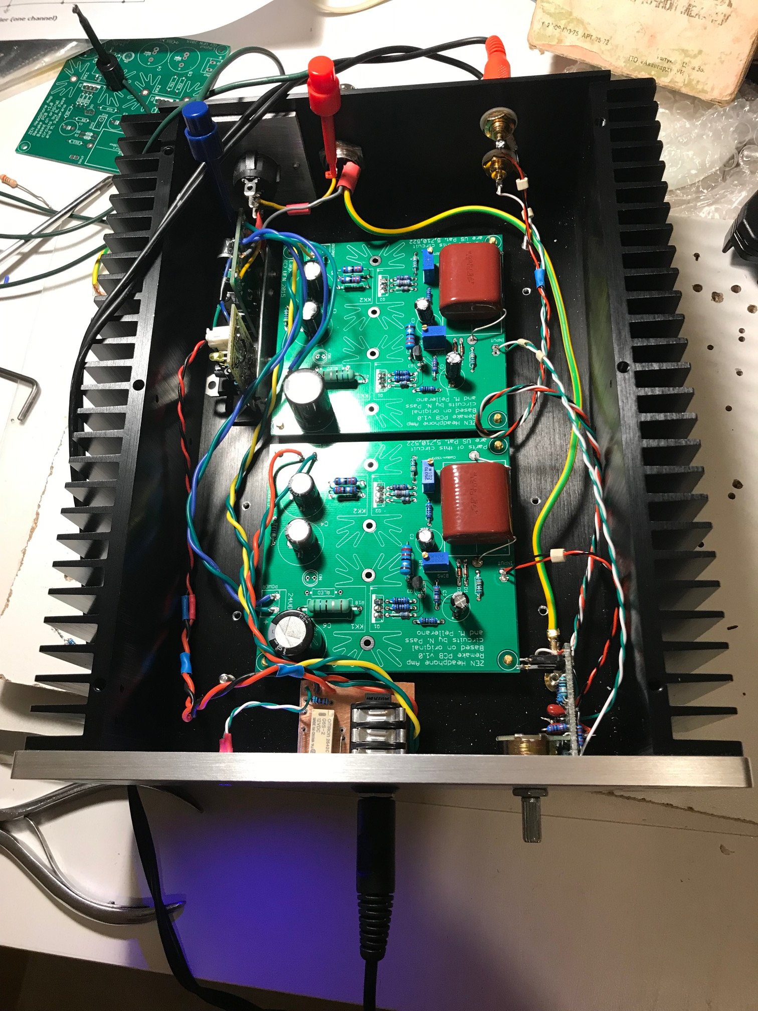

Yup! Great PCBs. Thanks for sharing! I ended up though adding a 1nF capacitor between base and collector of Q3 (soldered to the leads of R3 and R5) to tame oscillations - in fact the same happens in my other ZEN headamp which uses PCBs as published by Pellerano.
