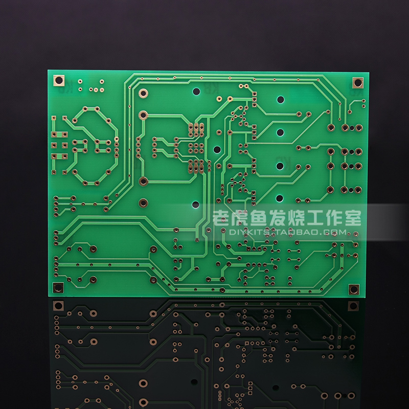

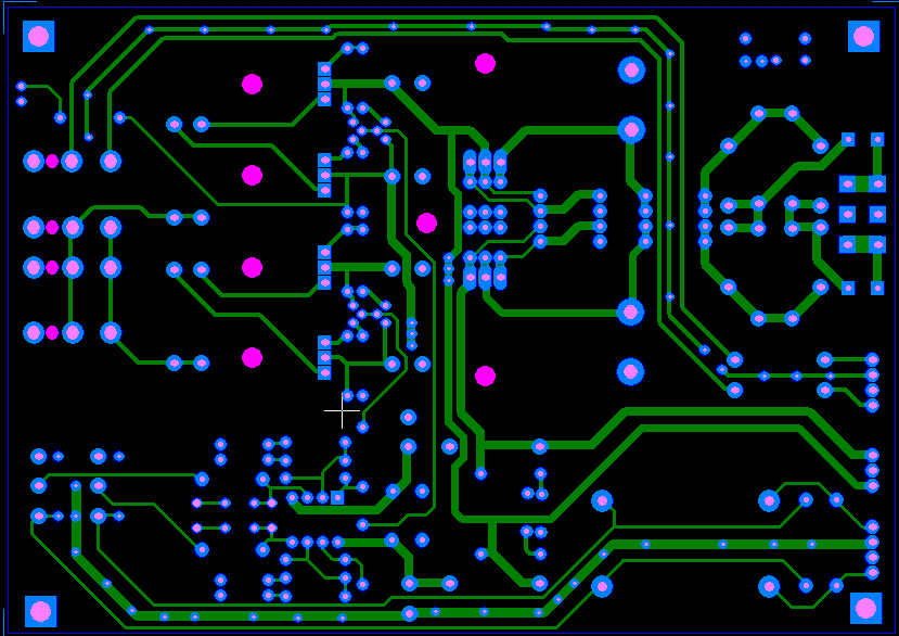

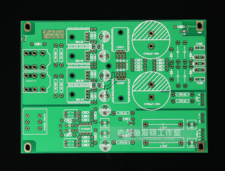

Populating a new PCB this week.

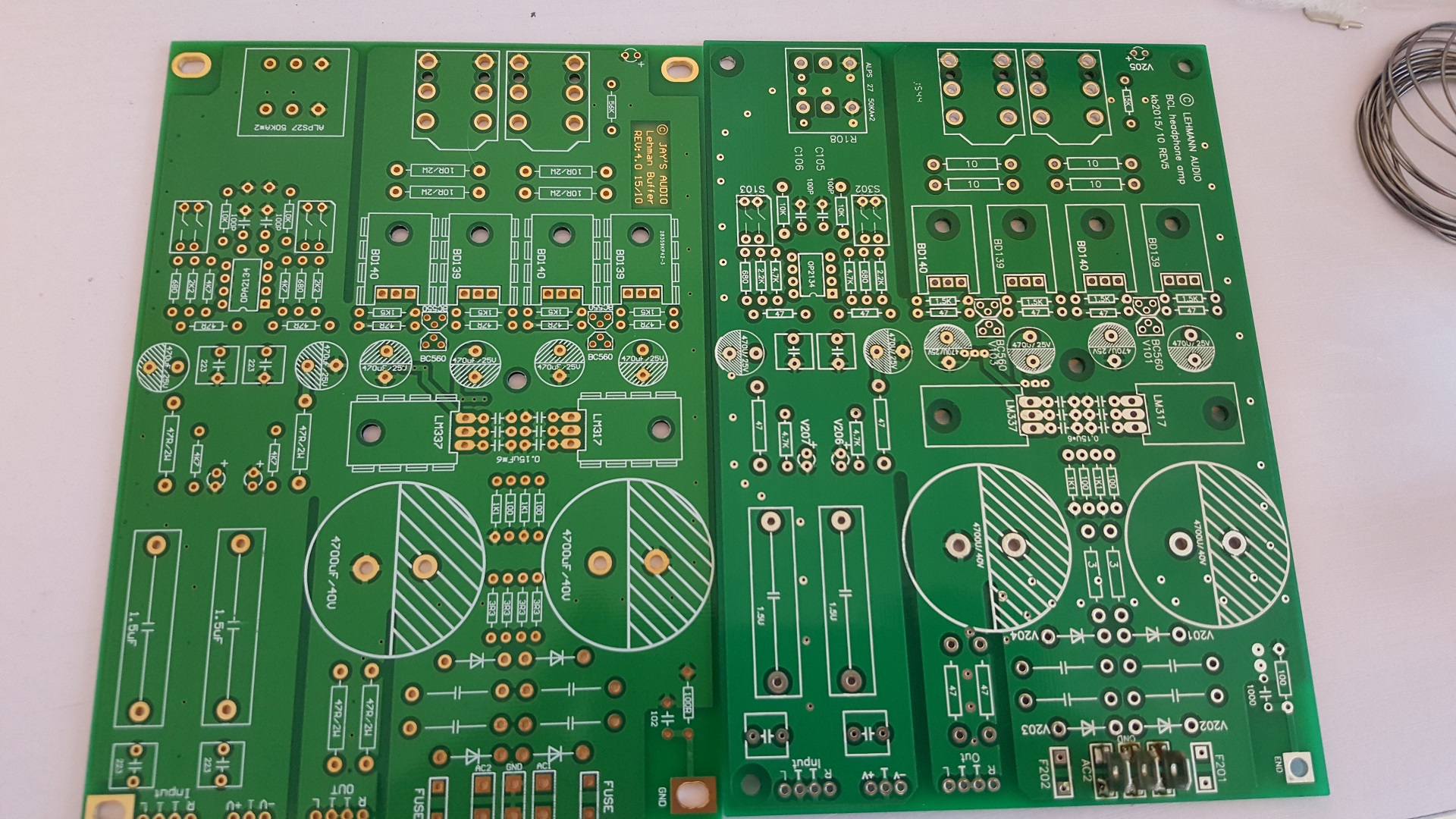

Got 2 pcb's. The rev7 I posted earlier was not in stock so I will build that later.
For now I am deciding which PCB to pick.
Silver colored contacts.. I assume tinned. Even though it was a little bit more expensive than the other I don't think the contacts are silver plated for roughly $5. 2 OZ PCB.
I marked the most notable (but still insignificant) difference between the two PCB's for as far I could find. The four smaller resistors made place for two big ones like in the original Lehmann BCL design. What resistors should I use for this position? 3R 1W? and what type will be good for the power supply?
This is the PCB revision I already populated. It's near 1:1 with the Lehmann BCL too. Can mount polystyrene caps here next to the opamp but I will go for Amtrans AMCH anyway. Also 2 OZ.

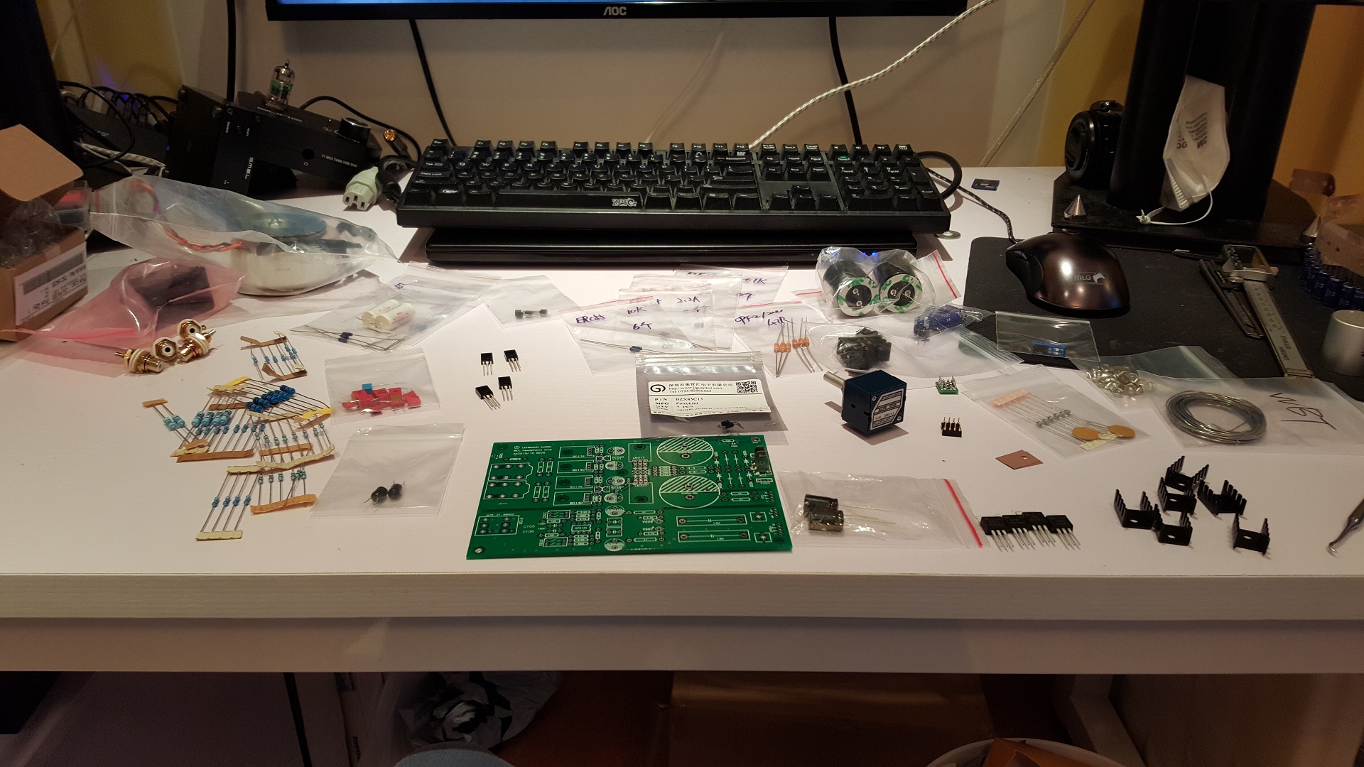

When I gathered all my parts I will make a list and a few pictures of all the parts before I start soldering.
Will go with the first pcb. Even ordered a new case for it.. it is actually saying lehmann bcl including logo on the front.. CHEEKY! The pcb also says Lehmann.. this is China haha. Ah well I am not buying it to make a profit out of the device or selling it as an original.. just personal use, so my conscious is clear for now 😛.

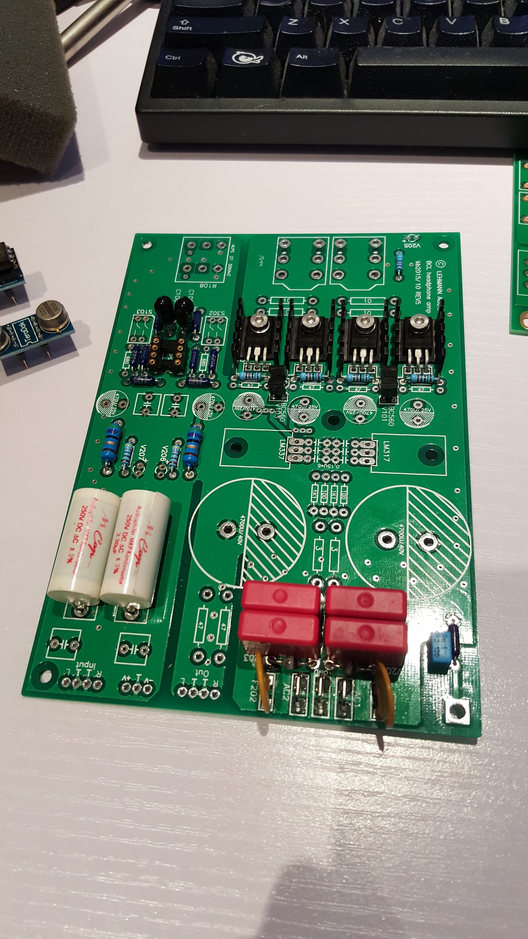

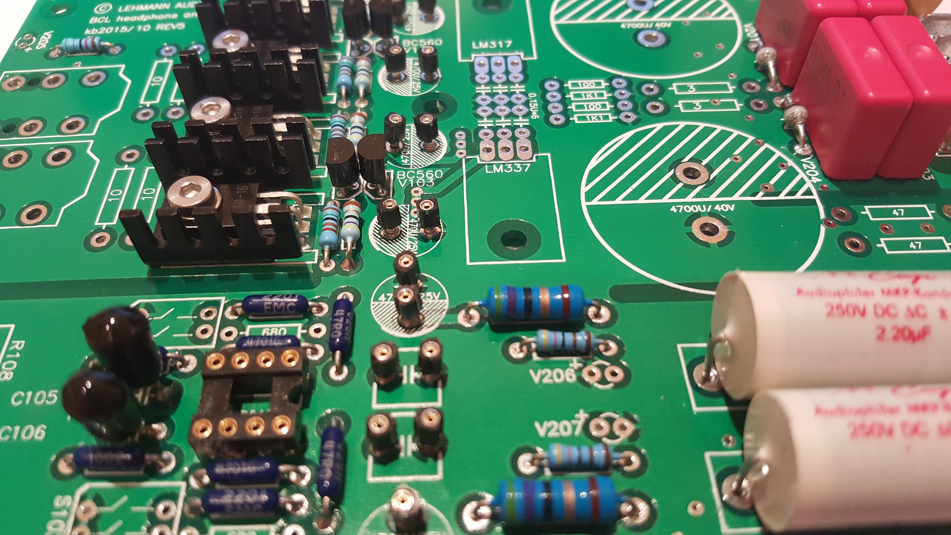

Also the progress:
Chosing. picked the silver looking one. I think the contacts are nickelplated, which is harder than gold. A lot of contacts on the other PCB went bad with some soldering. Really thin material. So witch a little bit of care and the harder nickel this choice will probably pay of in better connections. I also liked the layout of the input bypass caps a bit better. Now I can use larger caps there.
Gathering parts. Paired everything I could pair. Parts are still coming in.
Soldered some basics on there. WIMA MKP10 0.1uf 400V. Mundorf MCap MKP input caps, Amtrans AMCH 100pf caps, Vishay ERC/RNC55 resistors for signal path. Vishay MSR125 for power path. They send me some YEAGO 1% resistors for next to the LEDs.. Never heard of them.. put them in there.. They measured quite accurate so I guess they will do fine there.. If people doubt then please tell me what to use instead.

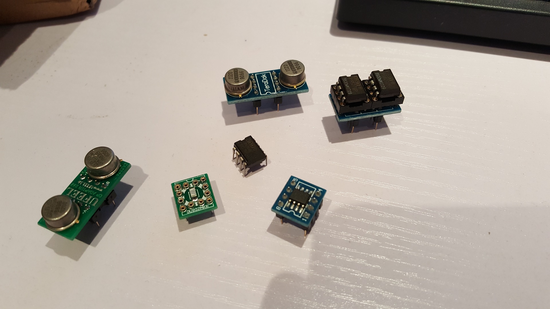

My opamps and the adapter. Got some OPA111AM, OPA111VM, OPA627BP, OPA2604(AP I think) and an AD8620AR. Seems like I can do some rolling opamps.

Also the progress:

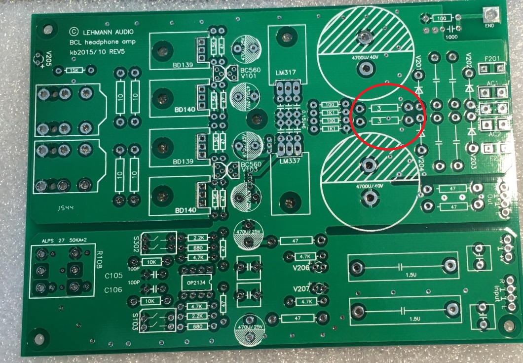

I really have a hard time finding proper resistors for the 3R 2W positions on the board.. the board seller says they need to be 2W.. I somehow doubt it.. but maybe he's right.. don't really know.. the thing is that I can only find the black Dales in 2W or chinese crap
Can also get the Red RA resistors for the output positions. I think I will try them. And keep looking for some 3R 2W metal film resistors in between the big power caps.

I am not using opa2134 anymore. Inferior opamp. And I have panasonic pureism 220uf or Elna Silmic II 100uf for this position. Also I ordered a shitload of mkp and polystyrene caps to try in between the radial opamp caps ranging from 0.022uf to 0.1uf. Soldered some sockets into place to do quick solder free comparisons.
Got some 3.01R Vishay Dale 2W resistors. For the positions in between the big power caps.
Got RA resistors for the output positions.

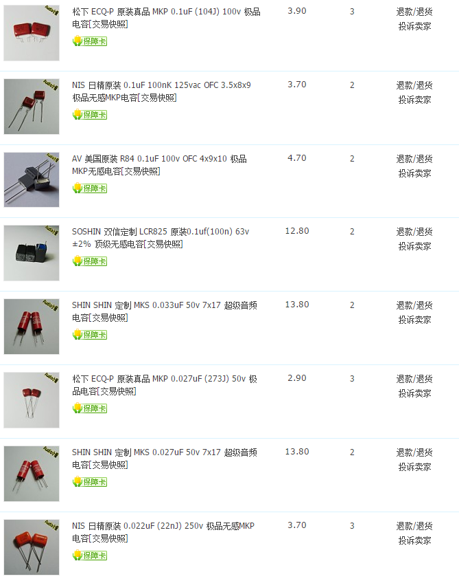

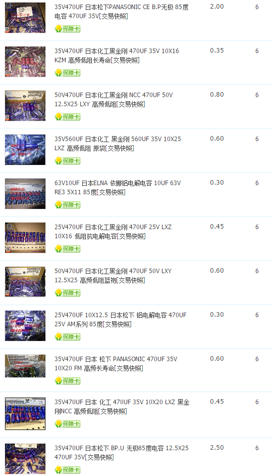

Prices in yuan. As you can see they are not THAT expensive. so I just ordered some. Have sockets soldered at these positions so I will clean the pins and try them in the positions of the input bypass caps and the opamp bypass caps.
Very curious what they can do vs the standard Wima caps.
The Shin Shins and Soshins look promissing also in size.. Japanese stuff..
Also got some panasonics and other brands I've never heard about. Can't harm trying them.
