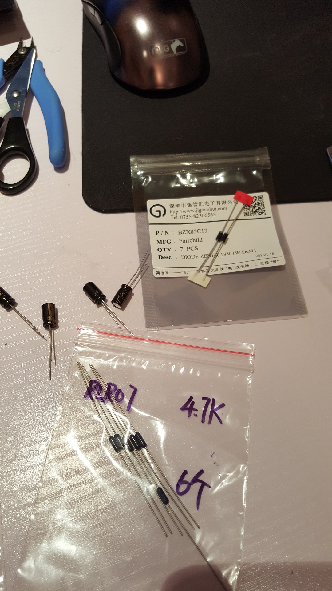

I replaced the red wima caps at the LM317 position with the small elna's.. Seemed together with 2 Zener diodes..
Seemed to have introduced a lot of hissing in every song.. the background is now full of hissing. Is this the elna caps that need to run in?
Really strange the zeners mod it's an easy and effective one done by a lot of people on another forum...

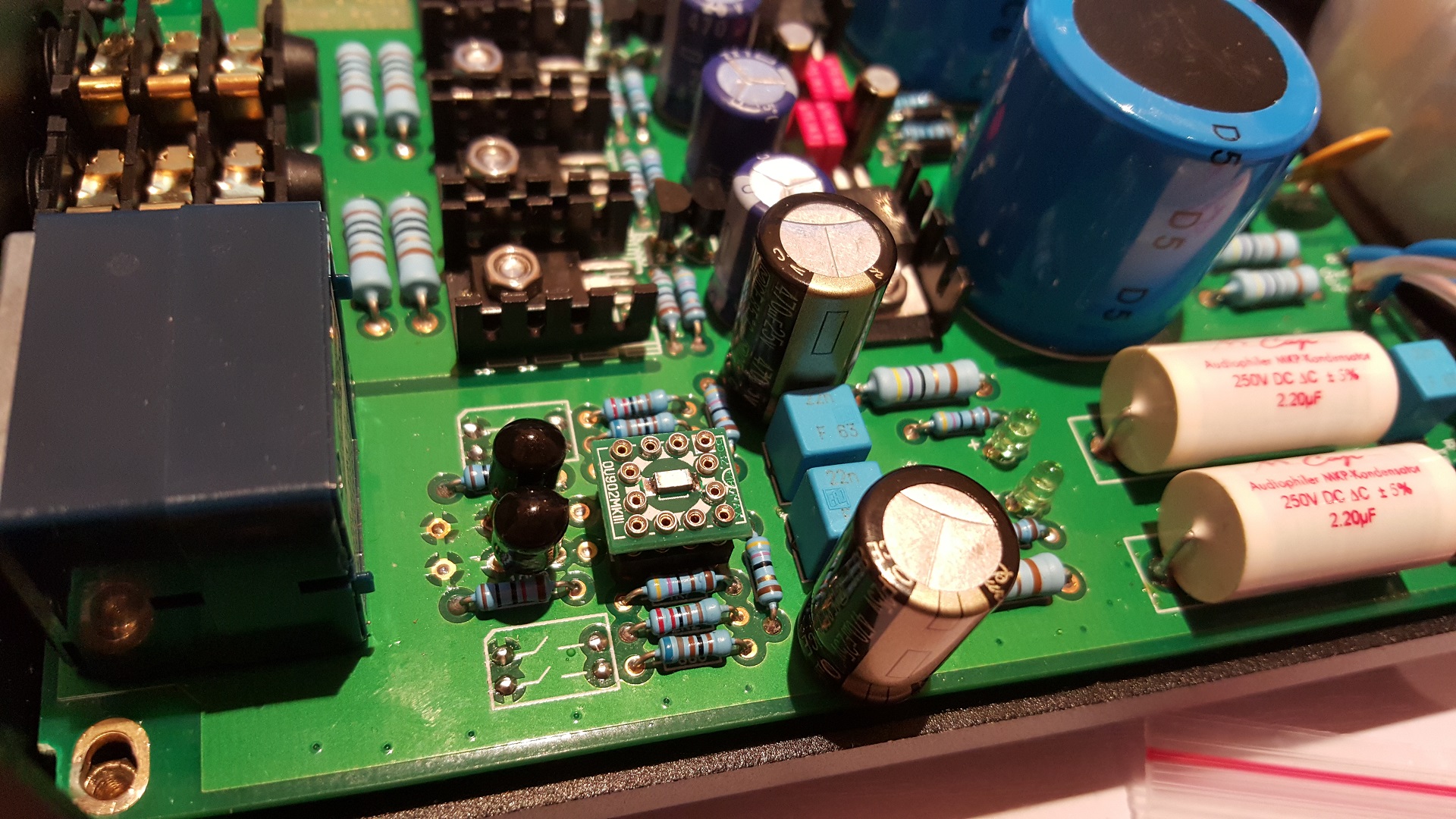

Can you post a pic?
Sometimes you can isolate the problem by poking around with a plastic probe and try and find a change that would be telling.
I chose an all discrete JC2 clone, used Mundorf AG 4,700uf X 4, and Elna ARS within the circuits.
I see I have destroyed one of the solder holes.. ****!

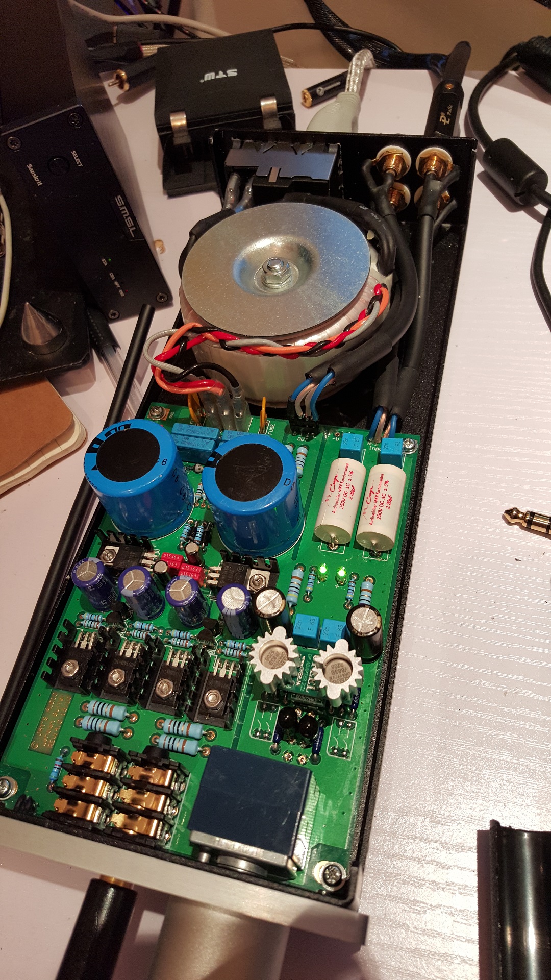

OK, got it all together again. Just flushed the diode hole with some tin. Guess the inner tube was still intact. Working like a charm.

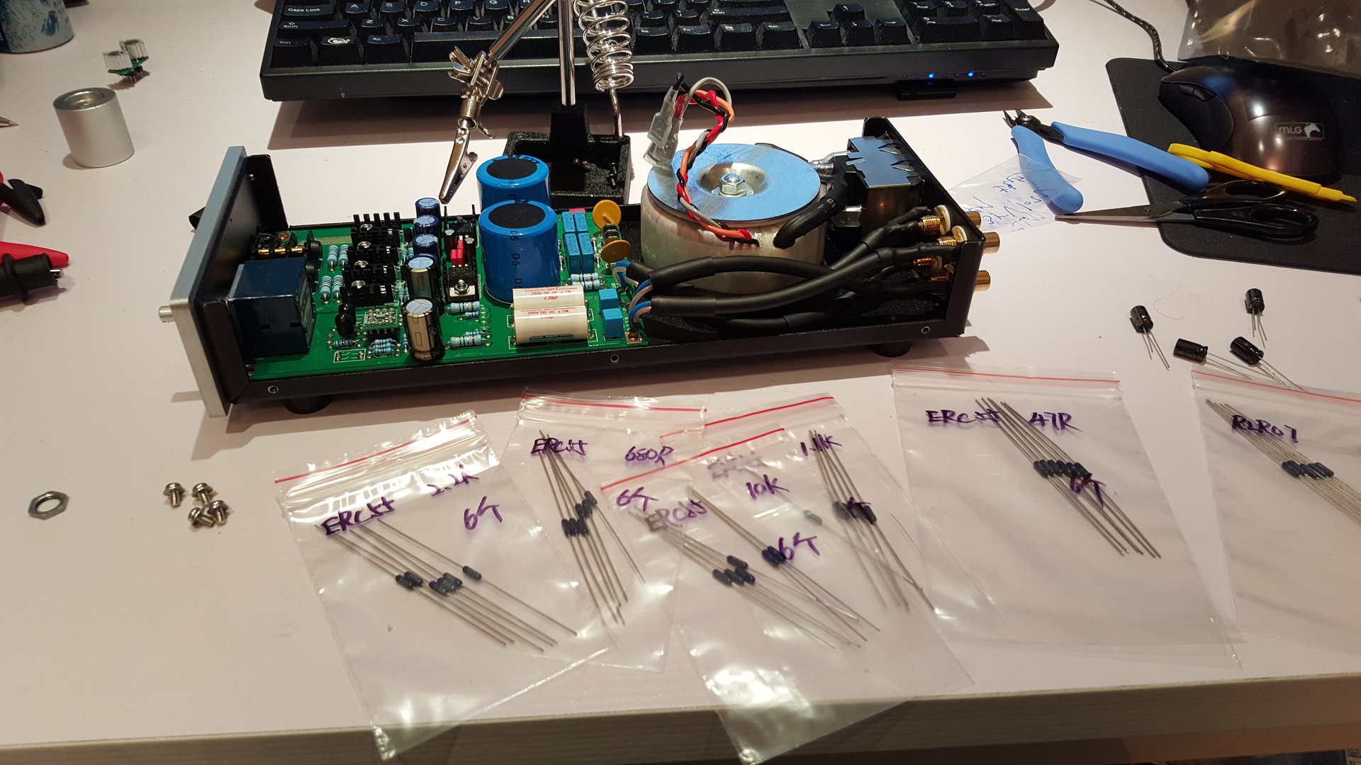

Also replaced all the resistors with Vishay Dale RCN55 (military grade). Cannot judge the sound yet. But they don't harm. The DC offset was 4mv and 9mv. Now it's just 2mv on both channels. Matching the resistors was childs play.. they were all the same on a few exceptions.. that's what military grade stands for I guess.. HEHE!

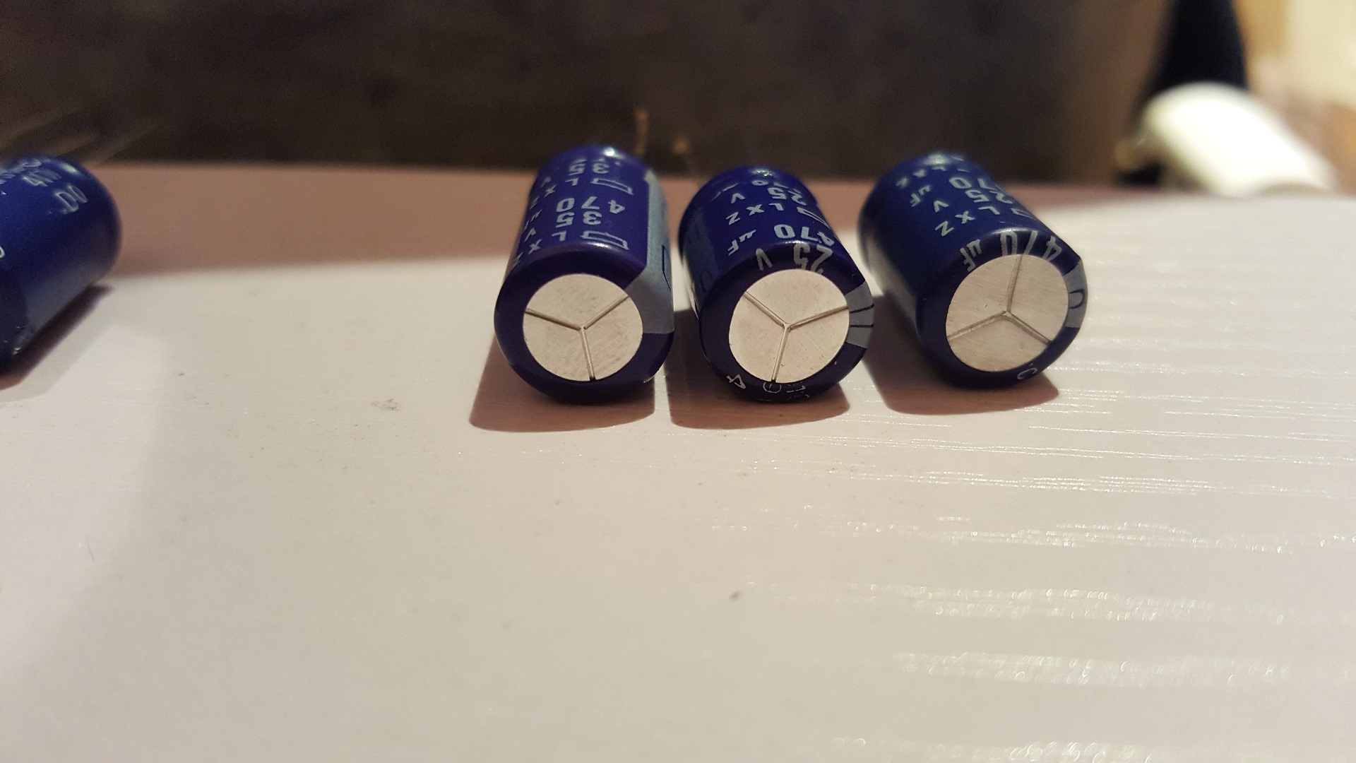

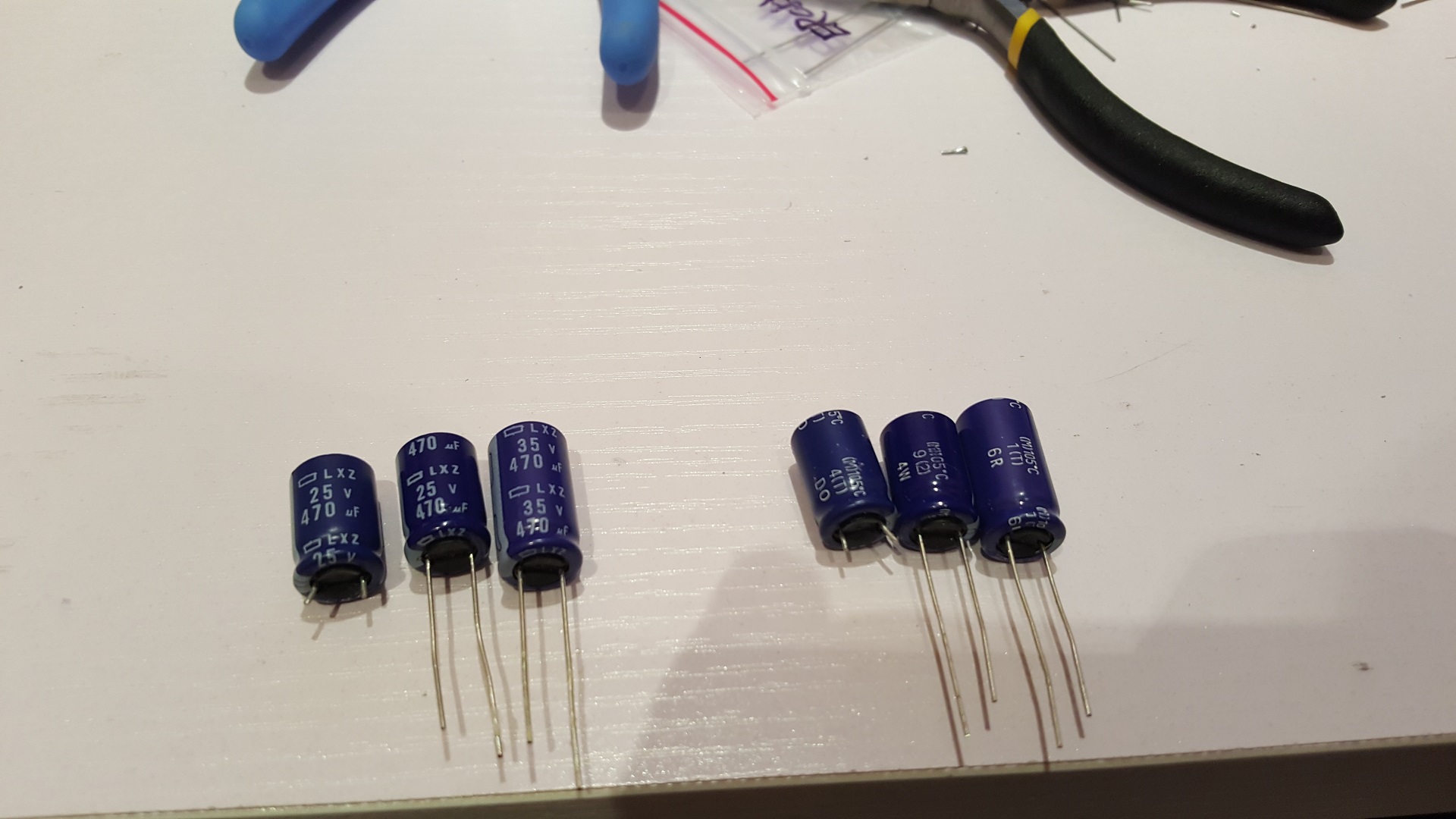

Also replaced the LXZs that came with the machine for other LXZs that I ordered (470uf 35V) I have ordered them from 3 different sources. Got two in already.
attachment.php
attachment.php
Left is the non-glossy kind that came with the machine that didn't sound good to me. Then I ordered some new 470uf 25V to compare with the left ones.. They are glossy but the letters are of poor quality and the little logo next to LXZ is way thicker than on every LXZ I have seen before. To the right is the 35V variant that I ordered. The photo doesn't really show it but the blue color is really faded. I gues they must be really old or also counterfeit.. I placed the 35V variant, but I cannot say anything because I also changed the Panasonic Pureisms for Elna Silmic II 100uf 35V like suggested above. So this wasn't really a smooth move to compare. I think the Elna's are a bit to smooth combined with the Aune T1. But first everything needs a burn in before I make any other changes.
Changing to fast confuses everything. So I need to take a step back and compare more.

End result for today.
attachment.php
I am probably going to change back the LCR polystyrenes because the Amtrans made the sound REALLY harsh in the top end it hurts my ears and doesn't seem to smoothen out..

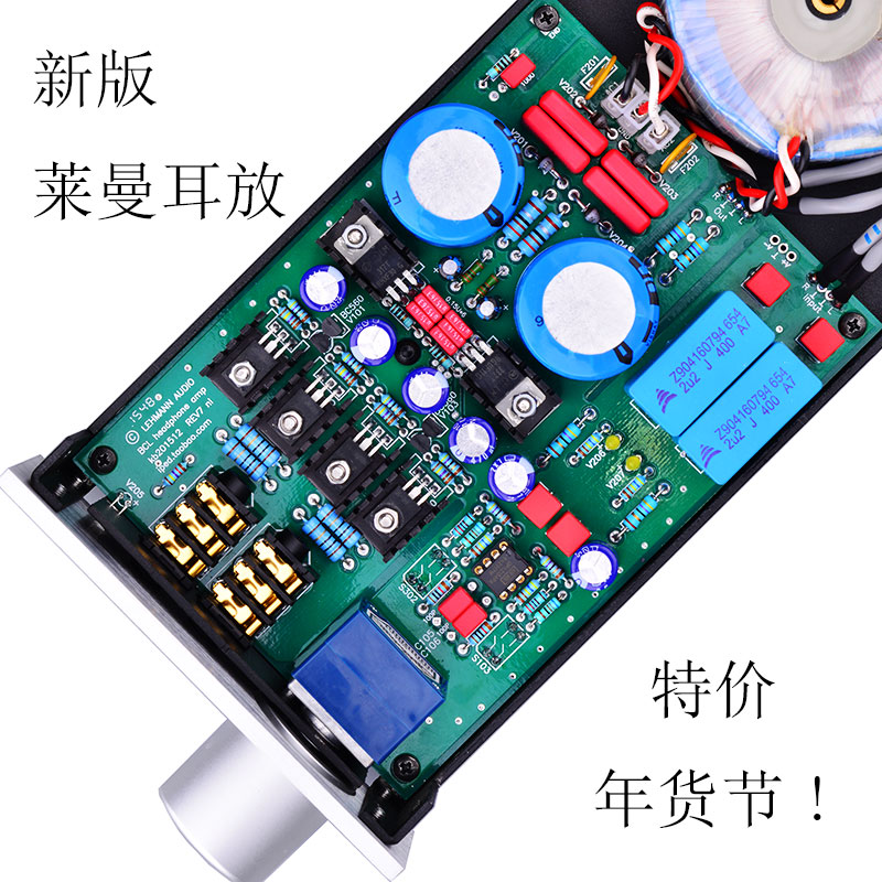

Ok I ordered a new PCB from a Chinese tech guy.
The PCB looks quite interesting and has already implemented some of the improvements going around on the forums I think. Don't have the full schematics rigth now but here is a picture:
