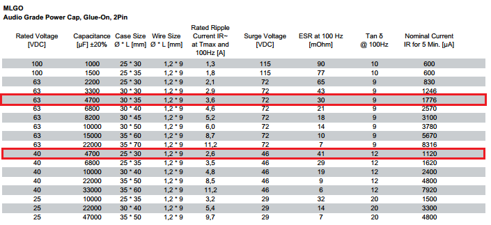

I am also trying to find me a pair of Mundorf Mlytics 4700uf. The shop that has them normally is out of stock on the 40V but he does have the 63V version in stock. They are 5mm higher and will maybe just fit. I will have to see if I can fit them in.
attachment.php
Next to that, when I look to the specs I see they differ. The 63V has the better specs so far I can understand the datasheet. But someone told me that bigger capacitors can make a powersupply slow sometimes. I am not sure if he meant capacity big or also the physical size within a product line. Others told me that the voltage is just an indicator how much the capacitor can take before it starts malfunctioning, and that you can always upgrade caps with the same capacity to a higher voltage spec if it fits. That size and price was the only factor to choose caps as small as possible..
Can someone enlighten me?

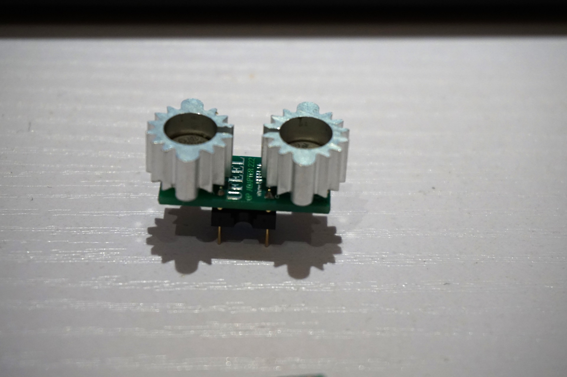

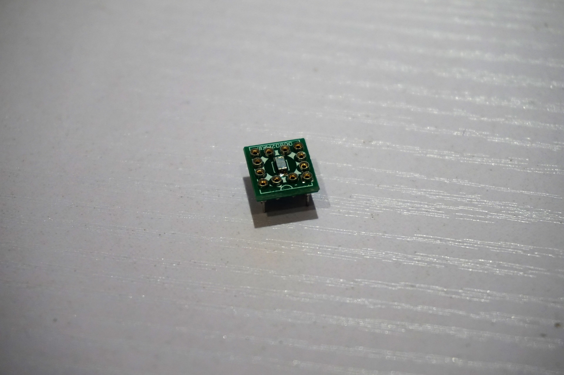

Upgraded my opamp to dual discrete OPA111VM on a high quality UFEEL adapter. UFEEL is based in Hong Kong and makes some good stuff. So I also ordered their UFEEL updater which is a small adapter that makes puts the opamps in Class A but not by the method of 2 simple resistors but a more sophisticated like described here I think: Biasing Op-Amps into Class A
attachment.php
attachment.php
Result:
The upgrade to 2 OPA111VM's was already groundbreaking. The sound openend up with about 30-40%. I suddenly felt I was in the room with the Nirvana MTV Unplugged album. Stereo image was WAY better and after a while of listening I forgot the headphones I was their sitting behind my laptop working. This was with both DT1770 and DT770 a huge improvement. With the new opamps the really stubborn DT770 250 ohm totally came alive almost to the level of the DT1770 before the opamp upgrade even the mids that were always on holiday came forward, ok highs are still to harsh for me but it became a really fun session. The DT1770 also improved a lot. It sounded a bit more open too and also more extended.
Then I tried the UFEEL updater and things even got a bit better. I pulled a veil of a bit. Lost a bit of warmth but got more control back for it. Everything is clear and tight now. Really nice addition in combination with the Aune T1 tube DAC with Amperex tube.
Whole opamp upgrade is probably the best upgrade I can do for a device like this.

and I am still deciding on Mundorf Caps. I can only find the 63V version for now which I've measured will just fit. I just wonder if they are not to big for the position and making my power supply slow or something.
Please comment on that.
Don't bother about it for now... first try other mods for which you already bought parts.
If and when you decide to buy them use the 40V version, they're more than enough.

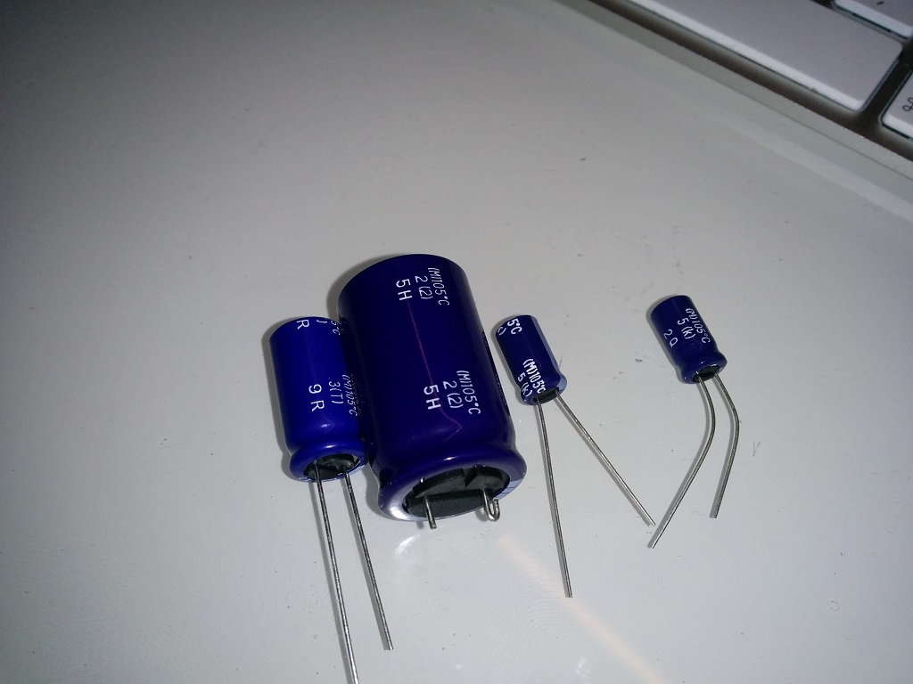

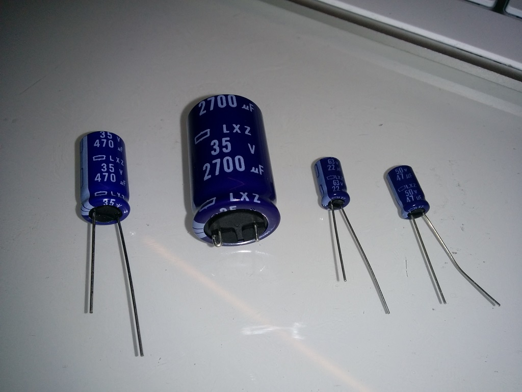

But I am quite confused about the LXZ caps. The ones that came with the machine are non-glossy. And the one that are on rs-components.com for example are glossy.. different types? or is it a fake after all? Can barely imagine why you would fake something like that in a machine but maybe they weren't aware.. I ordered new ones from 4 different shop with prices varying from 0.40 yuan to 2.5 yuan per piece. I also ordered 25v and 35v versions of the 470uf capacity.
Mine are all glossy (bought from Mouser and RS), see pictures to compare yours:
