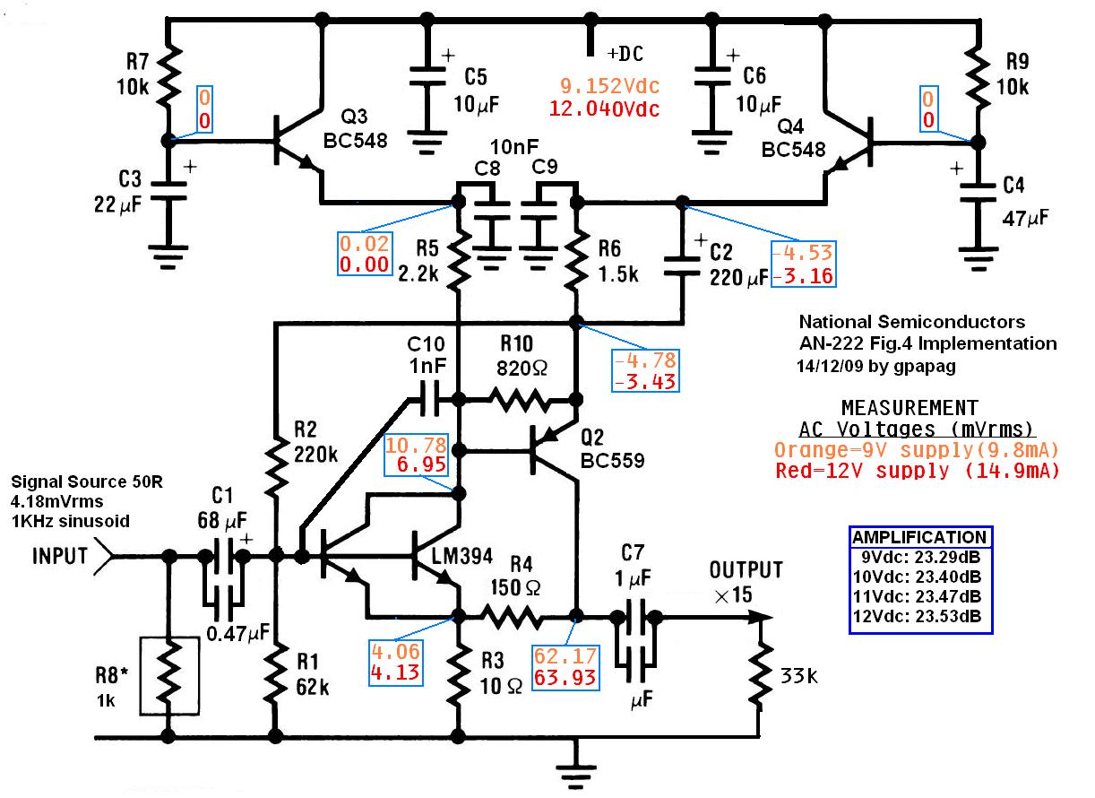

Hi all
Forgive me for not responding all these days, but I was really offset from the "normal" activities (i.e. diy is considered an "ab-normal" activity :headbash:).

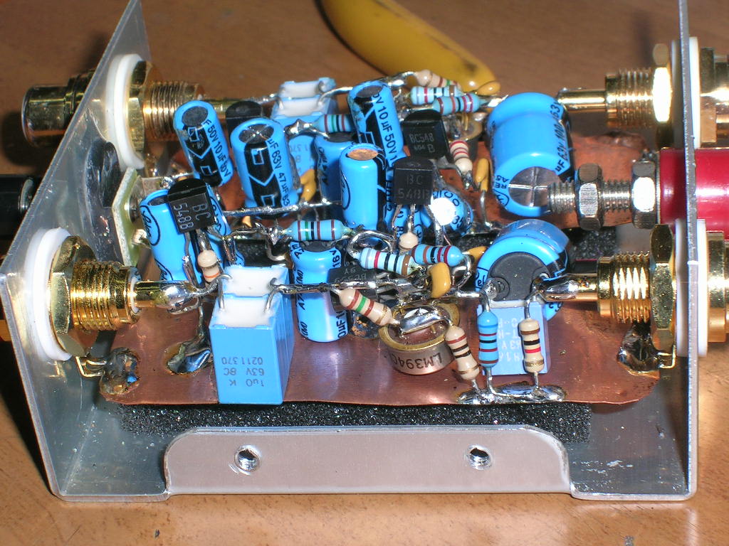

Thank you Salas and Joachim for your kind words about my "housed" circuit that I showed you at posts #80 and #83.:wave2:
I completed the DC and the AC measurements on the circuit (see 2 first attachments). As you can see, the circuit is a bit stuffed.
I couldn't get rid of the Cdom. It oscillated without it, regardless from the addition of C8, C9 and R10 (each of them made thinks better, but didn't eliminate the oscillation which on this implementation was at around 12MHz).
As Cdom I tried many small caps, but up to 470pF there was no effect. The next higher value that I had was the 1nF, which was adequate to kill the bloody pendulum.
As I understand, this circuit oscillates due to the fact that whatever is connected to it's output is in series with the feedback resistors R3 , R4.
A plain series small resistor at the output or a simple buffer might clear things up and make all the added components obsolete (unfortunatelly, I didn't try any of these two solutions, as I thought of them now, that I was editing the schematic:smash:)
As it is now, the circuit is unconditionally stable.
It doesnt ring, nor oscillates, whatever I do to it's inputs or outputs or to the PSU input.
That's good. It sounds good too😀
George

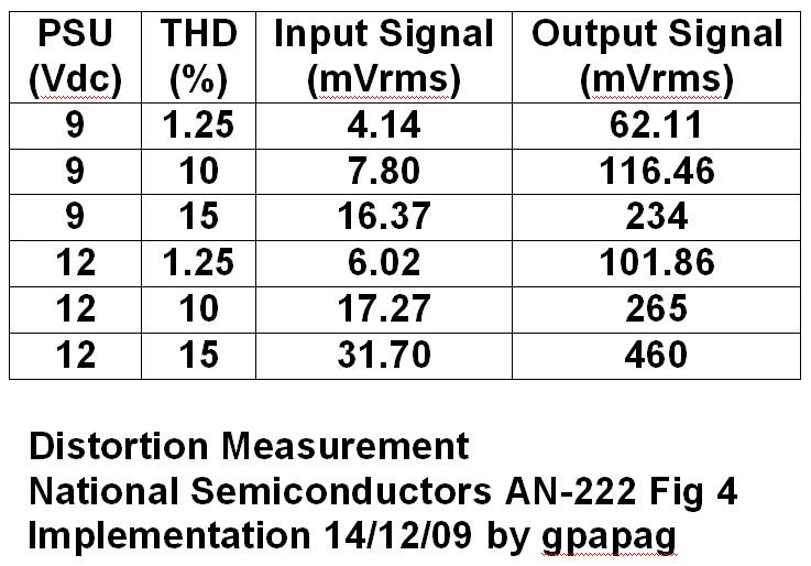

Therefore I made a set of distortion measurements for 9Vdc PSU and another one for 12Vdc PSU (see attachment). Each set has data for 1.25%THD (the lowest I can measure due to the high output of my signal source), 10% THD (quite high value, but not producing visibly distorted output waveform) and 15% THD (where lower corners of waveform are distorted).
At all three levels of distortion, the THD figure is almost 2nd harmonic (I could not see any 3rd or higher order waveform on the screen).
What is also encouraging is that with 9Vdc PSU, the 1.25%THD (anything between 1% and 1.5% actually) is occurring at signal input which is 13.8 times higher (22.8db headroom rel. 1KHz) than the DL-103 output.
I expect that at realistic signal levels of 0.3mV- 1mV the distortion will be sub 0.1%, really negligible (not that I bother with 1% 2nd :yes:).

Because of the very low ac voltage variation (compare to the dc value at the output) even at this a little too low value the results are good enough. By variation of this dc voltage in direction to higher value (as in my simulation) the second harmonic would be reduced, but it is not necessarily say, whether the sonic quality by playback is also perceived as better. Nevertheless an attachement to compare the dc values of both.
