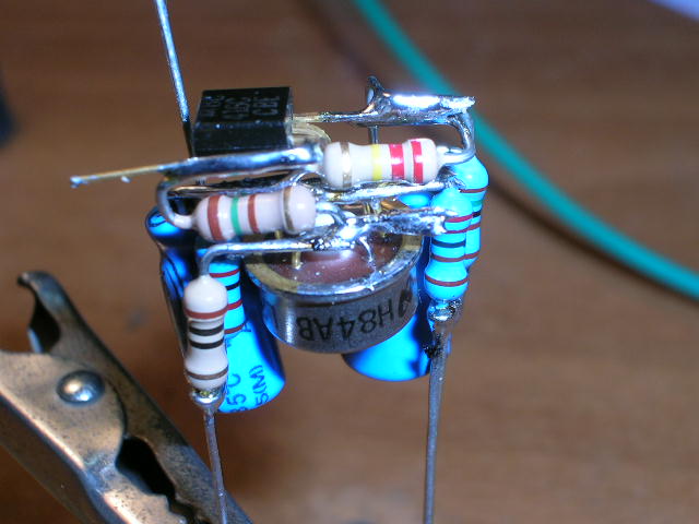

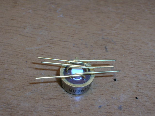

Yes, circuit of Fig. 4 (page 4, left column) of AN-222 pdf.
Today I spent 3 hours building one channel P2P in a miniaturized version .
18mmX13mmX20mm
Late tonight I will bench test it.
Does anyone knows the inductance of DL-103?
