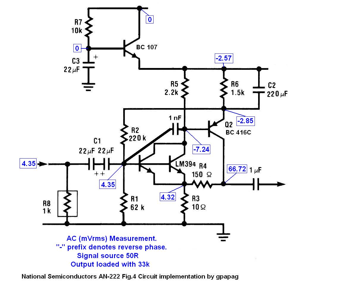

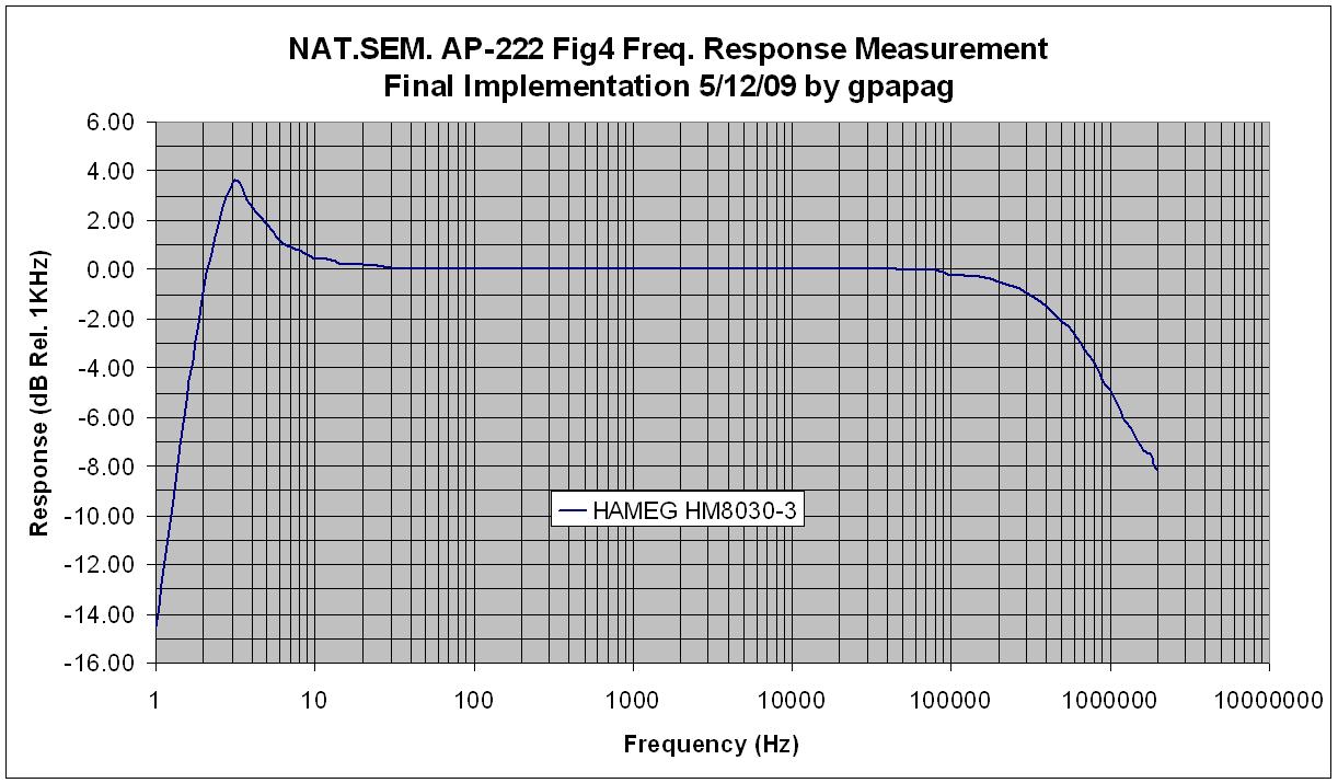

Hi all
This was another day devoted to the head amplifier.
Dear friends, finally I got rid of the oscillation by connecting a 1nF capacitor across the base and collector of LM 394. Now the HF –3dB point is at 700kHz.
I think this is a technically better solution compared to the capacitor across the feedback resistor (which cap I have now removed). The cap at the feedback path was suppressing an existing oscillation, while the cap at the LM 394 prohibits the oscillation.
Actually placing a cap across b-c of the first transistor is an old trick to kill RF interference, but I saw it suggested here as well http://www.diyaudio.com/forums/solid-state/25172-baxandall-super-pair.html#post293664
The head amp is now dead quiet. I could not measure anything else than 0.1 mVpp HF noise at the output with input shorted.

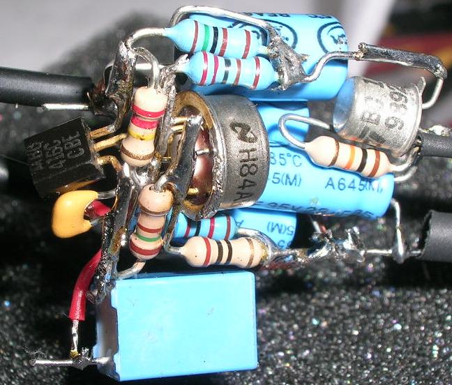

Congratulation!
Follow residual unwanted effects you can easy remove:
1) the peak between 2 and 10 Hz (enhance capacity value of C1 to 68 uF + bypaß MKP 1uF parallel for better behaivour at higher frequencies)
2) If you use your head amp together with screened enclosure, perhaps you can remove your Cdom of 1nF between base and collector of LM394 without oscillation effects (lower risk of TIM). This Cdom reduce the open loop bandwidth massive.
It's not a problem that you are not familiar with the p-spice simulation. But you now can compare both DC voltage values from simulation of me (you can find it inside of my schematic) and that one at your diy head amp device. This makes troubleshooting more easy and ensures at least a similarity of the voltages in theoretic and real world. If there are geat differences after adjust of R2, there must be an error.
I am also not a big fan of simulations, because I don't perform the verify of the P-Spice parameter and therefore I must hope to serious information of the transistor manufacturer. Additional some devices would be taken as ideal (resistors, capacitors, voltage sources). In real life this is never the case.
Nevertheless, I must say, that tool it is a great resource for me whether there are fundamental design errors and the risk of unwanted effects or not.
P.S. You haven't forget the 10 ohm resistor in series to the capacitor C2 (200 uf) in your head amp ?? Please let me also more about your power supply, that is in use.

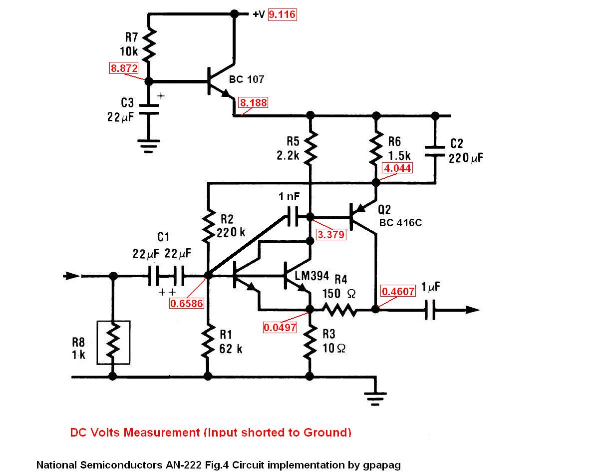

Hi all
As promised, here are DC and AC measurements of the circuit.
AC measurement refers to 1KHz input signal (I forgot to mention it on the drawing, sorry)

Right. But in much other sziklai schematic drawings, even by National Semiconductor applications this resistor is present.
The aim of this serial resistance is to reduce the open loop gain and enhance the open loop bandwidth. The risc of oscillation is lower and hfe spreads of the sziklai transistor (in your schematic the BC416C) contribute less critical.
An second thing I have see: you create your input cap as a unipolar (bipolar) version through two antiserial connected electrolytics. Why?
On base of LM 394 there is a positive voltage. At the hot end of your moving coil of DL103 (respective hot site of input load resistance) 0 volts. So I would clearly say, the pos. pole of capacitor must connected to the base of LM394.

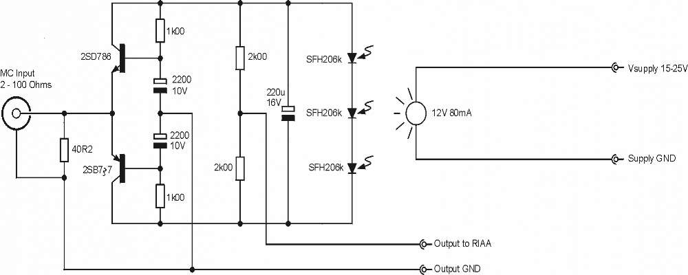

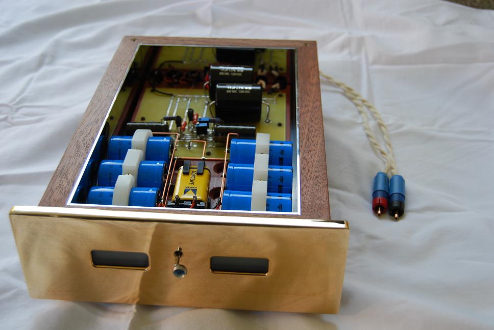

Hi all
I build a lot of different MC PrePre`s in the past.And swapped all low noise pnp`s in my hiraga prepre.
Best results with:
2SA1038 from Rohm sounds much better than the 2SB737 / BC560/ MAT Type
The biggest improvement was a pair of super e black gate nx from base to ground.
For resistors I use shinkho tantalum for couplers mundord silver
I build 5 units for my buddys and the TX-103 Billington stepup and Audio Note silver stepup (the big one for $10000) are sold on ebay
I build the pcb flat on spruce wood and it sounds much better than every preamp or stepup transformer I used in the past
regards Tony

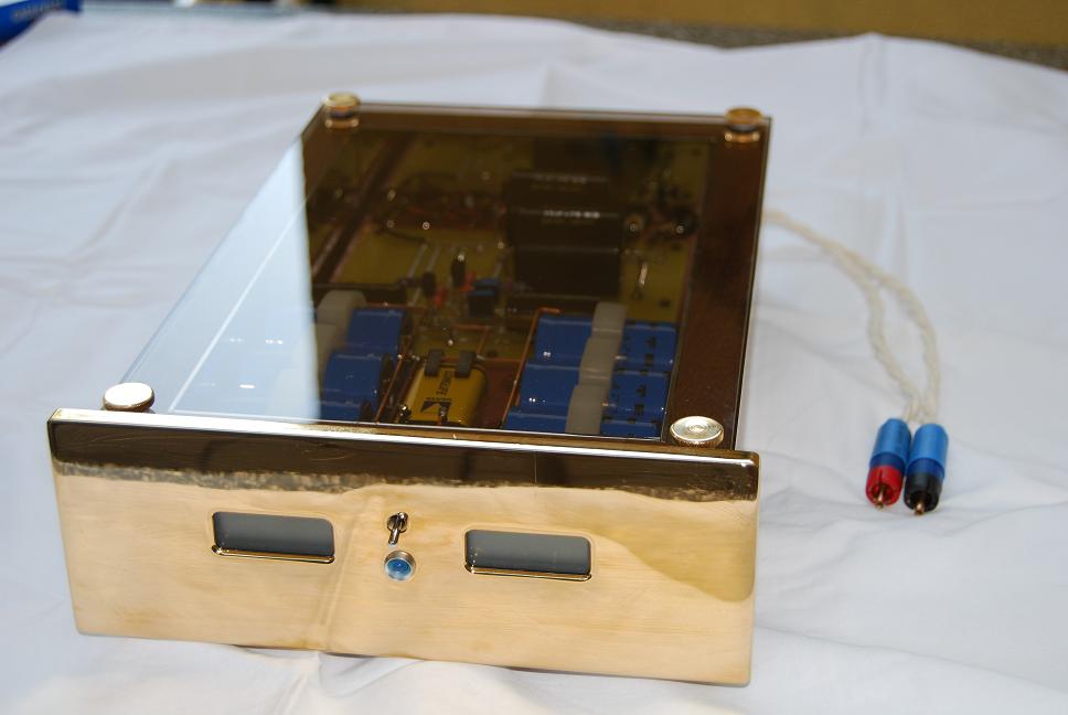

nice work Tony
I would be interested in some more pics.
The PrePre on the pics is made from Mahogany wood I think ( nix Fichtenholz). The inner tin, is it brass or copper? Very nice brass front.
What info are the two windows showing?
I have used 2SB737 Rohm and 2SA1316 and 2SC3329 before.
What seize have the base to ground caps? Can you describe the improvment of sound more detailed?
My actual prepre sound somtimes harsh with the "SS" at the end of the words. I am using Multicap RTX 1,5uF and 0,1 Russian Teflon cap in parallel.
I really don't know if it is the PrePre or the rest of my chain ( Kaneda RIAA and LINE + 8WAtt Hiraga + FE103 BR, all amps with Shinko.
Thanks for your answer, Tony
Regards
Sam
Hello Sam
The Mahagony painted block of wood (inside) is spruce wood
The inner thin is copper.
The caps from base to ground are Black Gate Nx 100uF 6.3V in antiparallel configuaration (2 per channel)
The sound is more powerfull and with better resolution and natural colours
I forgot a 100 ohm resistor between the 2 bases and the Black Gates are connected to the base of the signal transistor.(The Nlack Gates are not on the pics)
And I forgot the most important thing 2 pc of optima redtop batteries, sounds much better than Sonnenschein Dryfit or Panasonic.
For coupling is Mundorf silver or Vcap the best,but Vcap is too expensive for this aplication
The Instruments are for adjust the dc offset on the input, the 9V battery inside are the supply for the instruments.
I can give you my telephone number when you are interrested of further informations.
regards Tony
