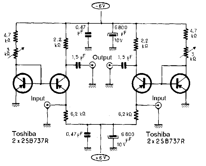

This diagram is from LC audio, but the one i am using came from a diy project
in a Danish HI FI magazine back in 92 but it is basically the same🙂
Yes. I am actually using it with my Dynavector 17 karat 2 with a fantastic result.
🙂By the way!
I think LC audio is still selling pairs of b737/d786 on their website, if anyone feel like trying the setup

hello george !
i do not intend to critisise you in any way. i am simply surprised that people think the Hiraga is a great sounding desing. it has 100 x more distortion then necessary and your design is much lower in distortion at the expense of an input capacitor that will unfortunately destroy some delicate sounds in the upper treble. why women critsise our hobby is a mystery to me. it keeps you home with the family.
here is a dc coupled version of your pre although it has elcaps in the feedback (could be used as subsonic filter). values are not dimensioned yet. it will reduce 2nd harmonic, the major source of distortion in your design although it is not a big problem because you use feedback. with 2N4403, 2N4401, BD139, BD140, selected for maximum and equal current gain and batteries it could be build for 20 Euros a pair. the fet could be BF245 and the gate resistors could be used for DC trimming. BD139,140 could be substituted with higher hfe types. if you can not find 2N4403 and 2N4401 take two BC550C, BC560C in parallel. four of them are surprisingly quite and they sound very good and are dirt cheep. i like simplicity too and can drive a hard bargain if that is the goal but i hate to compromise too much on topology.
the open loop gain of that circuit is quite high so you should use miller compensation somewhere to avoid oscillation.
Rossiter MC
Hello Joachim,
you built the Rossiter MC? Is it suitable for the DL103?
This is a very interesting design, but just for the ortofon cartridges I thought.
And the other thing was , there are still caps in the signal path.
Regards
Sam
Hello Joachim,
Regards
Sam
yes, the rositer has caps but it measures and sounds very well if you use good parts. the rositer can be bettered though and i posted a plethora of circuits here that are candidates. i do not know how it sounds with the denon. it has an input impedance of ca.25 Ohm and the denon has quite high impedance coils for an mc. i still do think it works. look at the phonoclone. it has zerro ohm impedance but i do not read reports with dificulties with any mc.

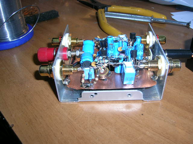

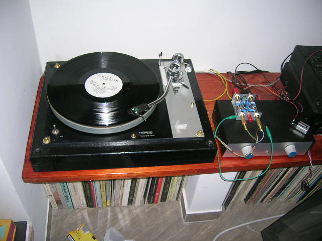

Hi all
Being in a quite difficult position to post anything readable (ich bin blau), I repot that the AN-222 Fig-4 circuit is being in it’s final (if ever) state of implementation.
It is now housed in a screened (to be ) enclosure.
It performs decently, and I would like to confess that using as an excuse the polishing out -working in- my DLie and burning in this much suffering Pre Amp circuit , I have spent several hours going through my soul and rock music album collection.
The whole thing is going quite right, though I have observed for one more time that the available power output is never enough!
Due to this burning in and due to the fact that this particular analogue front end is to be used for reproducing opera and chamber music in the future, I am more than sure that it is going to face an identity problem (exactly just like it’s owner).
