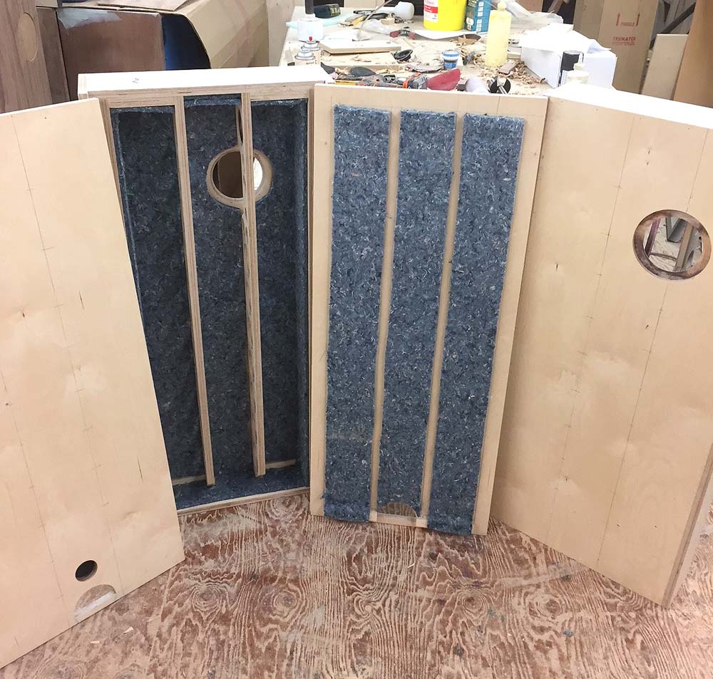

With 18mm BB plywood throughout, the two full length holey braces and three layers of material along each side, I’m thinking these will be plenty stiff. My back certainly is after wrestling with the boxes over this past weekend. Just awaiting some final clarification from Scott and Dave on damping scheme before auditioning prior to buttoning them up and skinning with the laminate- even with a removable bottom, it would be very awkward to access the full internal height should any tweaking be required.

With 18mm BB plywood throughout, the two full length holey braces and three layers of material along each side, I’m thinking these will be plenty stiff… Just awaiting some final clarification on damping...

We’ll let them break-in for the next week and listen seriously again. I won’t comment on the sound unless requested. One thing we will probably need to do is add some more acoustastuff (we only installed half of what Scott specified since we have had to remove stuffing in the past).
