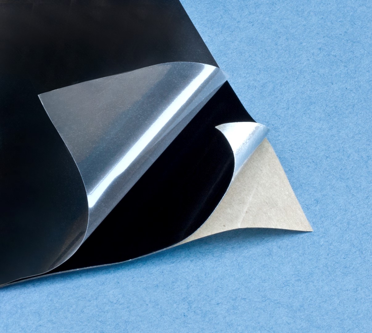

Actar.com...foils & films..Maxiblack---etc,
---------------------------------------------------------------------Rick..........
Add a “k” to the URL.
MAXiBLACK coating - Highest absorptance with small thickness - Acktar black coatings
maximum 20 cm wide… that would mean seams.
dave

The paint “Black 2.0” is of interest.

Vantablack paint is the commercial paintable version of this stuff.Google does not quickly scare up any links. You have some?
I wonder about the availability of the size needed (and the cost).
dave
There is quite a bit of controversy about the commercialization of it though. There are a few clones that are cheaper and more readily available. Vantablack - Wikipedia
Anyhow, it's blacker than black. True monolith, Disaster Area Hotblack Desiato Sundive Ship black.
Otherwise the best most practical solution from both an aesthetic and functional viewpoint would be to wrap the whole thing in two layers of fabric.
One layer of thin but dense black cloth, with a hole for the driver, and then on top a layer of standard black speaker grille cloth.
The bottom layer is to not have the cabinet cut and poke through the thin cover, and to keep it in place by friction.
Also it would provide a deeper black with none of the surface of the cab being directly visible through the thin cover.
And then the cover fabric, to give it that ultra matte, yet still sharply defined surface and edges, with no immediately apparent holes for drivers or ports
The fabric approach will also dispense with the need for, the concept and look spoiling, round over.
The two layers of fabric will have much the same effect on edge diffraction. In fact it will work better, from my experience with fabric clad speakers.
DCM Time Window approach with the two layers, as well as a tall wide and shallow configuration. I think my Philco (Matsu) 6.5's have found a new home in these freebies.
Vantablack needs a special treatment, this is why I recommended Black 2.0 which is a normal yet very black paint and it is more widely available.
