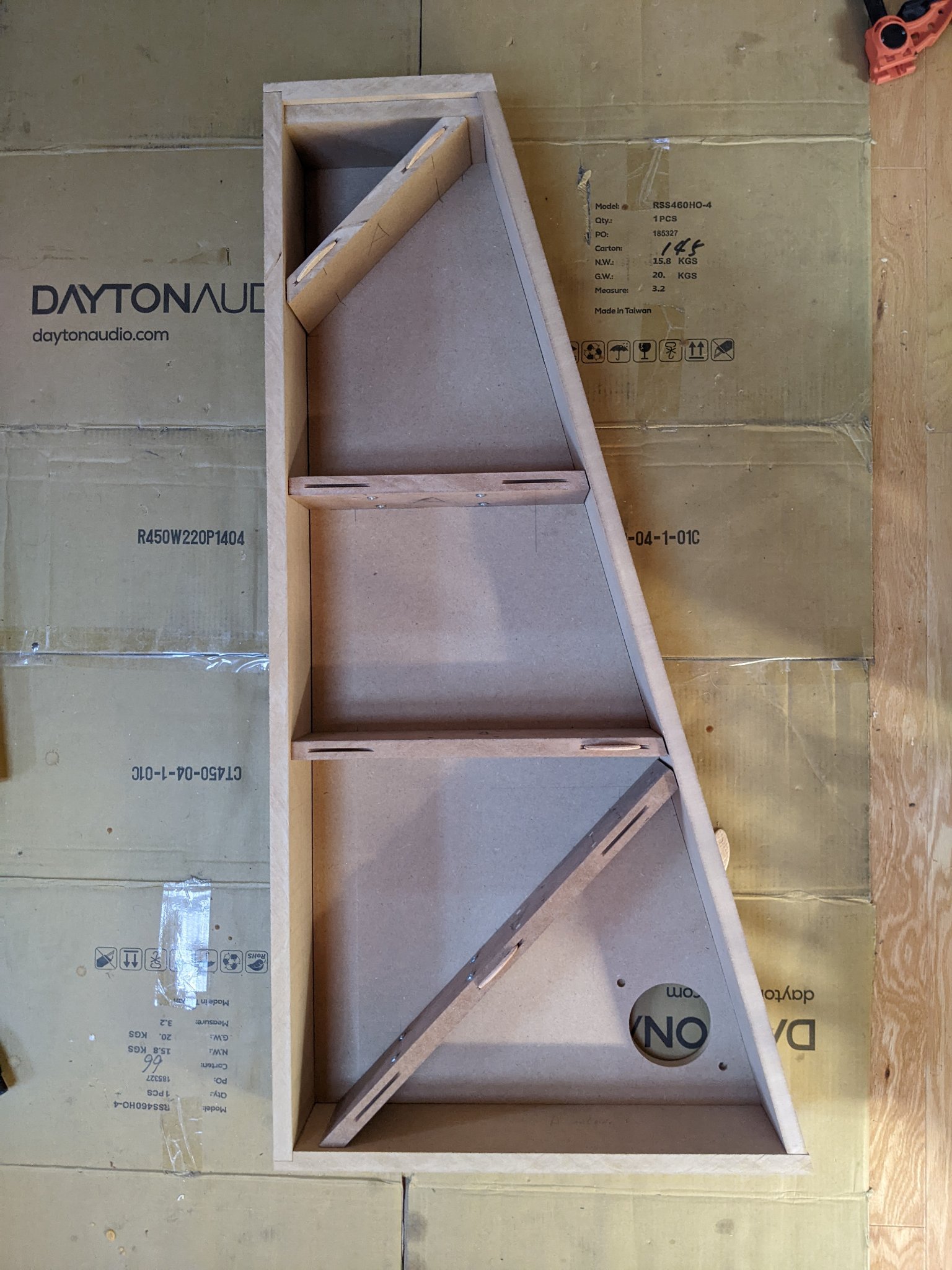

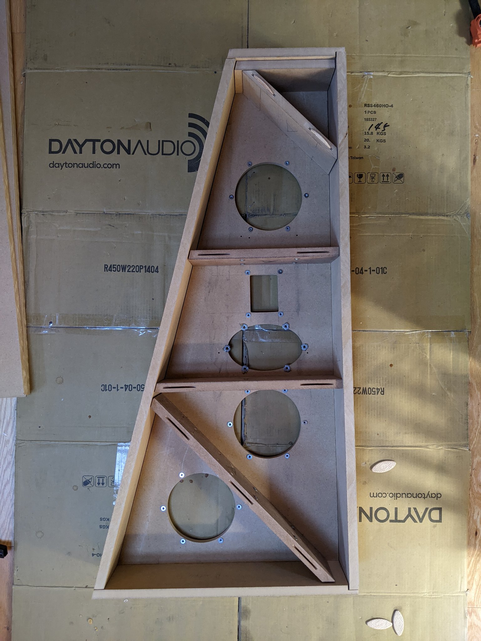

How are you constructing your cabinet? Are you building a box from a single layer and then applying another layer to the outside of the box, gluing it with the flexpaste?
Or are you gluing the 2 panels together first, and then creating the box from the assembled CLD panels?
Inside the front panel looks like Picture 1, so where it doesn't have braces speakers are there to take up the slack. The rear panel touches those braces as in Picture 2. Note those are the same braces, overlaid on the front and back panels to show where they go. The item is 5.5 inches (140 mm) deep on the outside, 4 inches (102 mm) on the inside to provide optimum volume for the mid drivers so the sides really don't need much damping apart from what the internal braces provide. The back, however, is a bit live so I'm simply slapping another 3/4 inch (19 mm) of MDF with 1/8 inch (3 mm) of FlexPaste between the box and the panel, moderately clamped until the stuff dries, then clamped hard with dowels around the periphery for edge stiffness and keeping pressure on the FlexPaste.

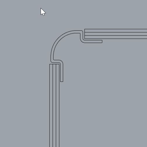

Here's a concept for light weight construction. Thin CLD panels bonded to molded composite corners? Leaving an open seam at the corner means the outer layer of the CLD is completely isolated from the cabinet.
I am already using a 1" corner radius, so essentially no external changes to the design, but it would increase the internal volume.
The idea is de-coupling the adjacent sides, eliminating the rigid corner. This molded corner would change the way energy is transmitted through the corners. Would it be beneficial? I'm not sure...

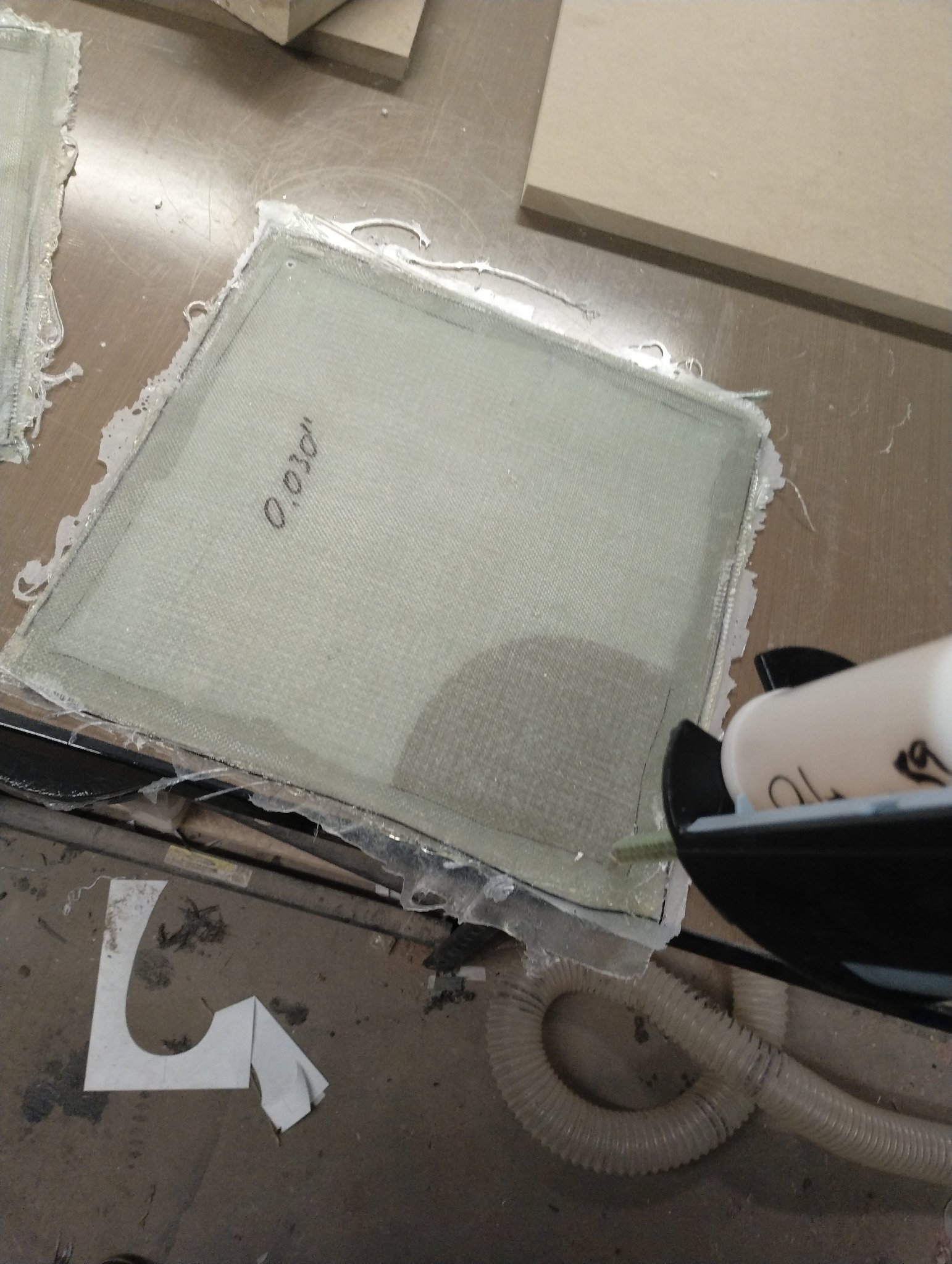

Molds. In the oven! They are machined MDF and coated with epoxy. Tomorrow I'll seal them with urethane clear coat, and maybe make a part or two!
The shallower one will give a 0.030" cavity when paired with a flat plate, and the other a 0.060" cavity. By mixing and matching they will give me panels with urethane thicknesses between 0.030" to 0.120".
I plan to inject the urethane into the cavity these create, and then trim the edges back so there is no direct contact between top and bottom panels. They will be the same dimensions as the first set of panels I tested.
The plan is to start by making a range of panels with different cavity depths, but using the same fiberglass laminate/ thickness on all of them. This will isolate just the affect of the urethane thickness.
Once I have data on which urethane thickness gives the best result, I will experiment with changing the panel construction, like making them thicker and adding carbon fiber. I may also need to test if a thicker/ stiffer panel requires a different urethane thickness than a thinner/ more flexible panel.
And then there is the question of urethane durometer. It's starting to feel like a complicated project!

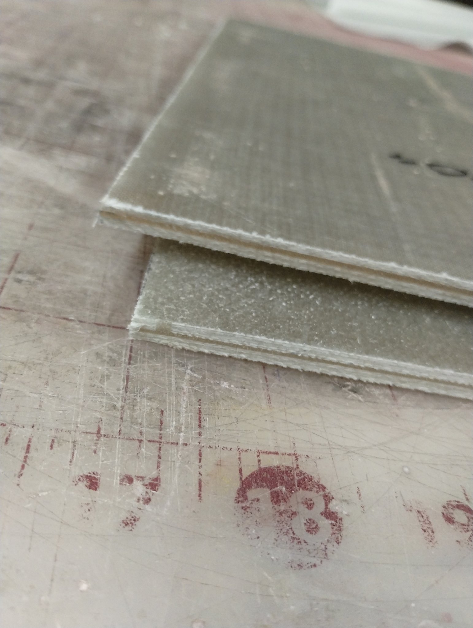

More measurements!
I made 2 thin fiberglas panels. The fiberglass is ~60oz woven fabric combined weight, and it is the same for both sides of both panels. One panel has a .030" layer of urethane, and the second has a .060" layer of urethane.
The 2 different thicknesses of urethane were quite similar, with a difference of ~1dB. But both fiberglass panels were ~-10dB down from the 3/4 MDF control.
I also re-tested the Plywood CLD panel. I tested it as I originally did, with the edges coupled by the wood spacer used to create the .060" cavity, and then I tested again after I trimmed the edges back so panel faces were no longer coupled. This decoupling resulted in approx 1dB improvement. The panel is now slightlly smaller, so it isn't a perfect comparison. But my conclusion is that coupling the edges does not make a significant difference.
Observations:
Fiberglass CLD panels performed better than the plywood CLD panels across the entire frequency range.
Fiberglass CLD panels out-performed MDF above 1khz, but performed worse below 1khz.
Increasing urethane thickness made was slightly worse, but difference was marginal.

If you have a box made from 30mm XPS. The box would first be assembled with the panels glued together like the usual MDF way. Epoxy and duct tape to hold it together while curing. The outside long edges get roundovered and internal long seams get filleted with the goo that I developed. A rebate is done around the driver cutout and a bamboo board ring gooed in as a hard point for fasteners. The biax or alloy skin is wrapped over the whole box inside and out. Any bracing is also filleted in and skinned over. The box would be getting pretty big before it needs bracing
If you want your CLD final skin to float. Apply the urethane over the whole box including the rounded corners and wrap alloy skin taping over itself at the seam

I hope you can understand that I am trying to be somewhat scientific/ systematic to test what parameters affect the performance of a CLD panel. The CLD part comes first.
Threads discussing CLD are usually very general, saying things like a thin viscous layer is more effective than a thick layer. But how thin is "thin"? And how critical is the thickness? My last test attempted to answer this question.
The next qestion I'm asking is about symetrical vs asymetrical panels. Discussions I've read suggest the panel needs to be symetrical, but the Dynamat seems to indicate that symetry doesn't matter.
I just got done laminating some carbon fiber to repeat the same test, but with stiffer materials. One panel will be 2 layers of carbon fiber on both sides, and the other will be the same 2 layers on one side, and the other side will have a .25" balsa core.
The all carbon panel is meant to be compared to the fiberglass panels I just tested, and it will show what affect the stiffness of the face panels has on the performance of the CLD panel. And the panel with the balsa core will show what happens if one side is dramatically stiffer than the other. We can guess what will happen, but I still want to test.
