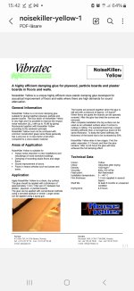

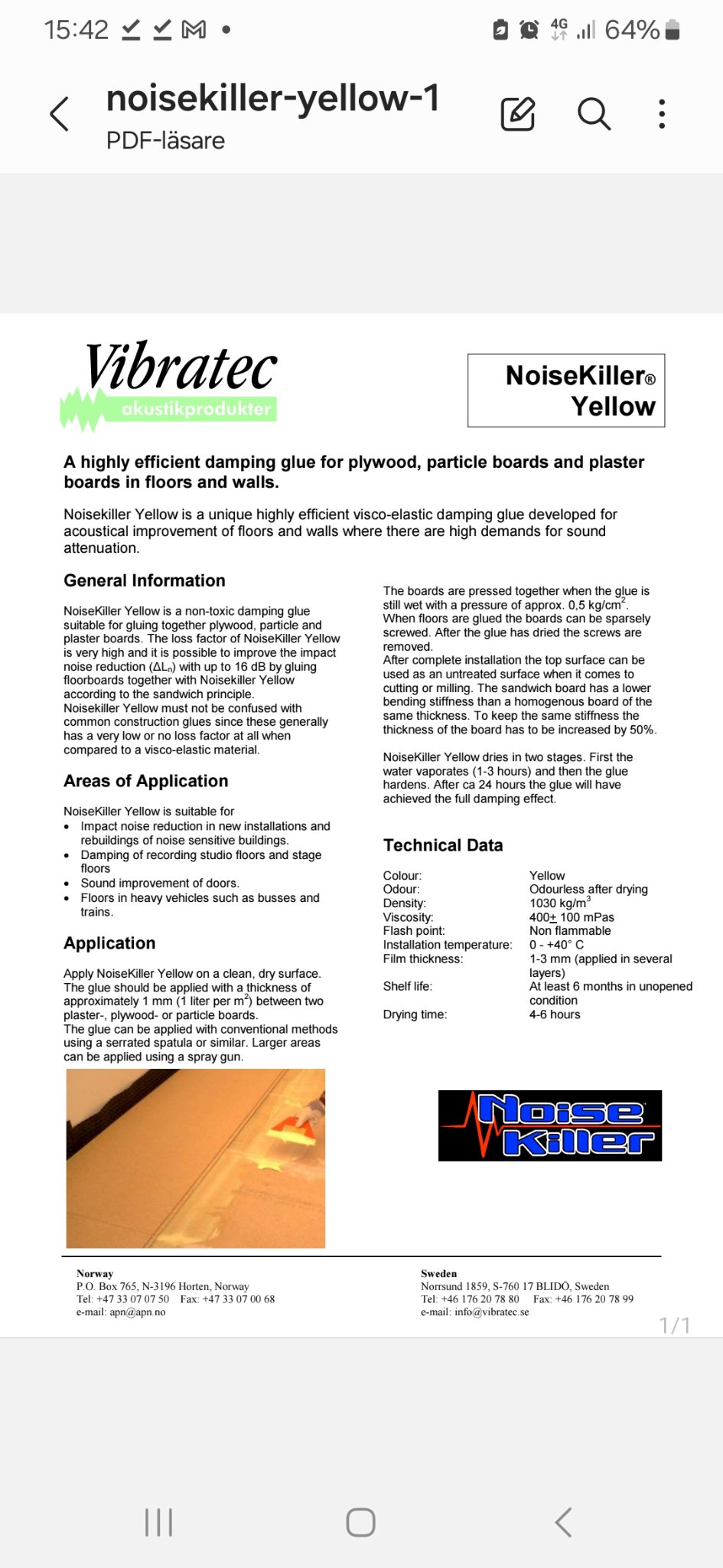

I actually tried this some years ago, using a swedish product which i could source locally, i glued 3 layers of plywood together with this noisekiller stuff but never finished the project.
The "knock-test" didn't convince me that it was worth the effort but at the same time they recommended a certain pressure when gluing it together that I had no way of achieving at home. If I had the necassary tools etc it might have been worth it just for the sake of it since you still have to glue the sheets together and you might aswell do it with the constrained layer technique.
