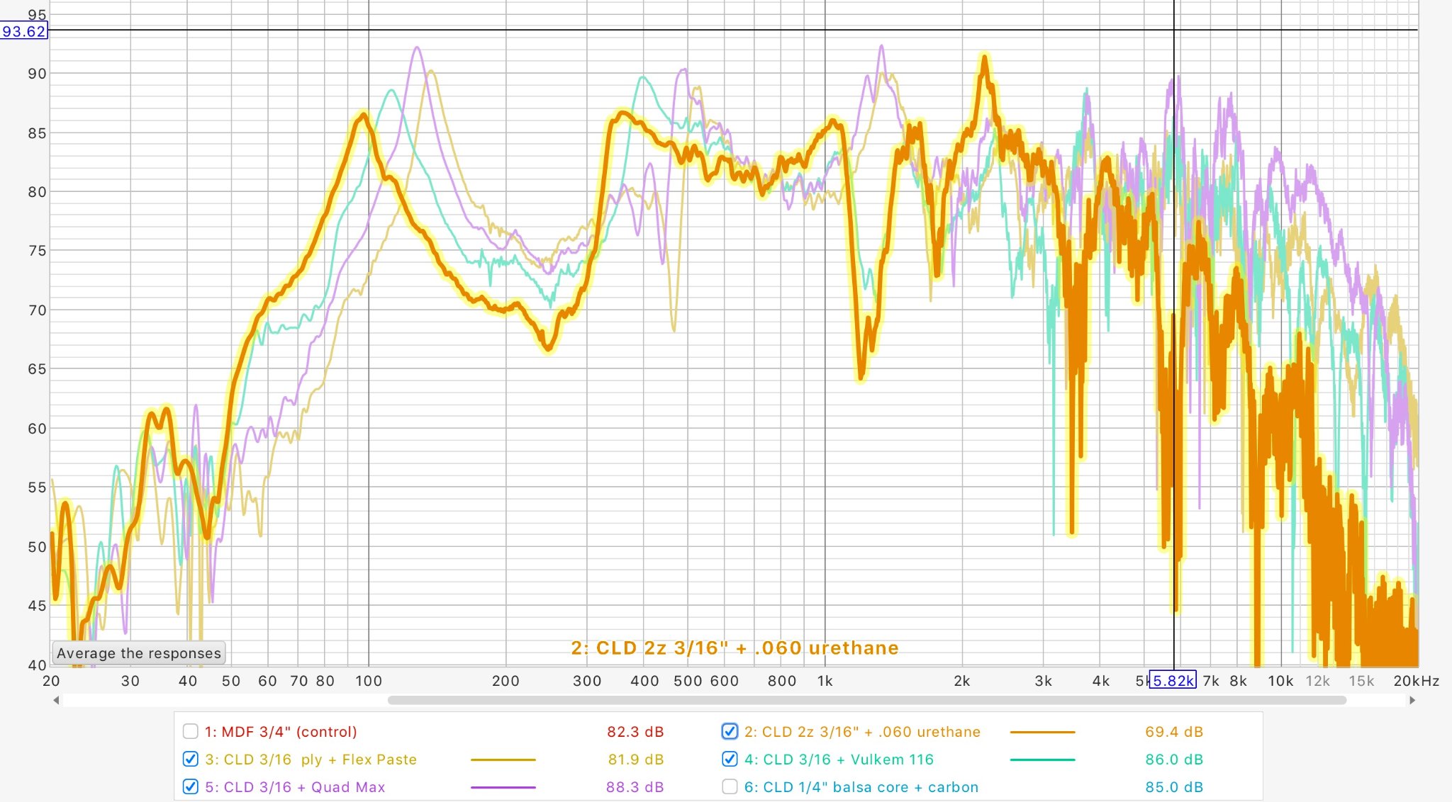

Again, a test with a non CLD plywood panel would give some insight. Is the plywood panel behaving worse due to being softened somewhat by the weight of the CLD schedule?
The first set of measurements I posted included a couple different plywood panels. There were 3 different thicknesses tested, and a composite panel made from thin ply over a balsa core.
I built a test stand and re-measured all the panels. The new test stand is still pretty low effort, but it has a lot of mass and it features toggle clamps to hold down the 4 corners of the panels (only contact is at the corners). This ensures that the panel can't bounce at low frequencies, so I should just be measuring the vibration of the panel, not any pistonic movement of the panel bouncing. I think the new measurements better capture what is happening at lower frequencies.

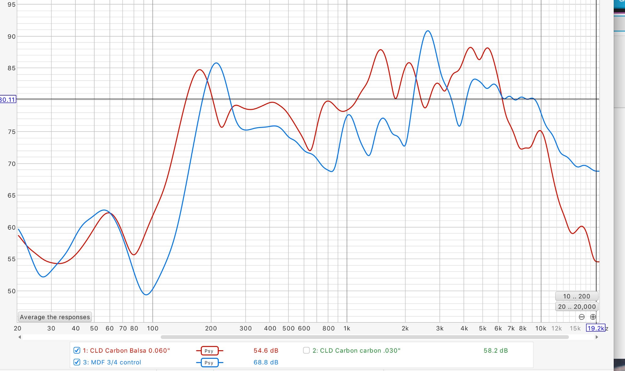

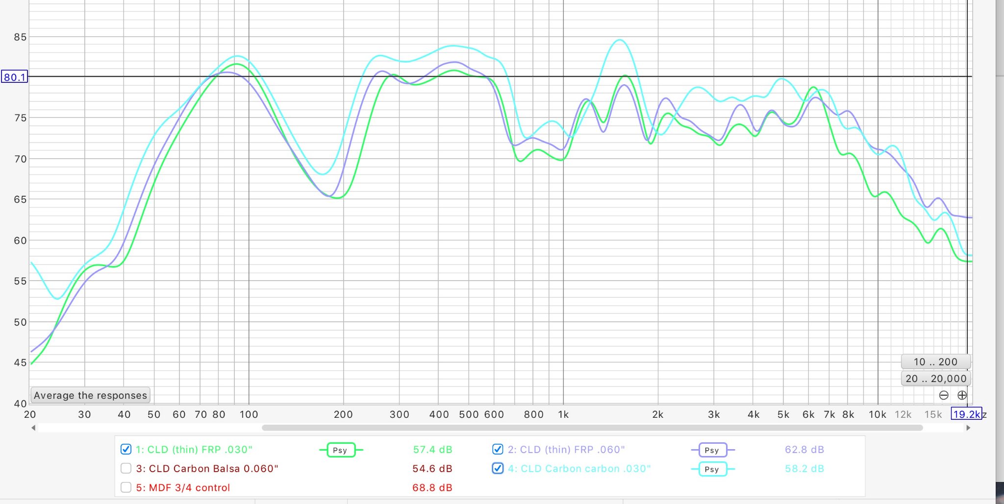

Carbon Panel test. One carbon panel is thin and symetrical, and the other is thin carbon on one side, and a carbon/ balsa sandwich on the other side.
Interestingly, the panel that is carbon/ urethane/ carbon&balsa is approx 0.4" thick, but performed similarly to the 0.75" MDF.
The thin carbon/ carbon panel compared similarly to the the fiberglass panels, but carbon was slightly higher (worse). I still need to see what happens with a different durometer or urethane.
Also, with the fiberglass (FRP) panels, the thicker urethane did slightly better at low frequencies, and the thinner urethane did better at high frequencies. So there may be more nuance to the advice that "thin is better". I think it will be worth testing thicker urethane layers after all. And a softer durometer also.
At this point I'm thinking I should go crazy and try combining carbon with fiberglass or flax. Use the carbon to make a thin but rigid panel on one side, with a thin layer of fiberglass or flax on the other side.

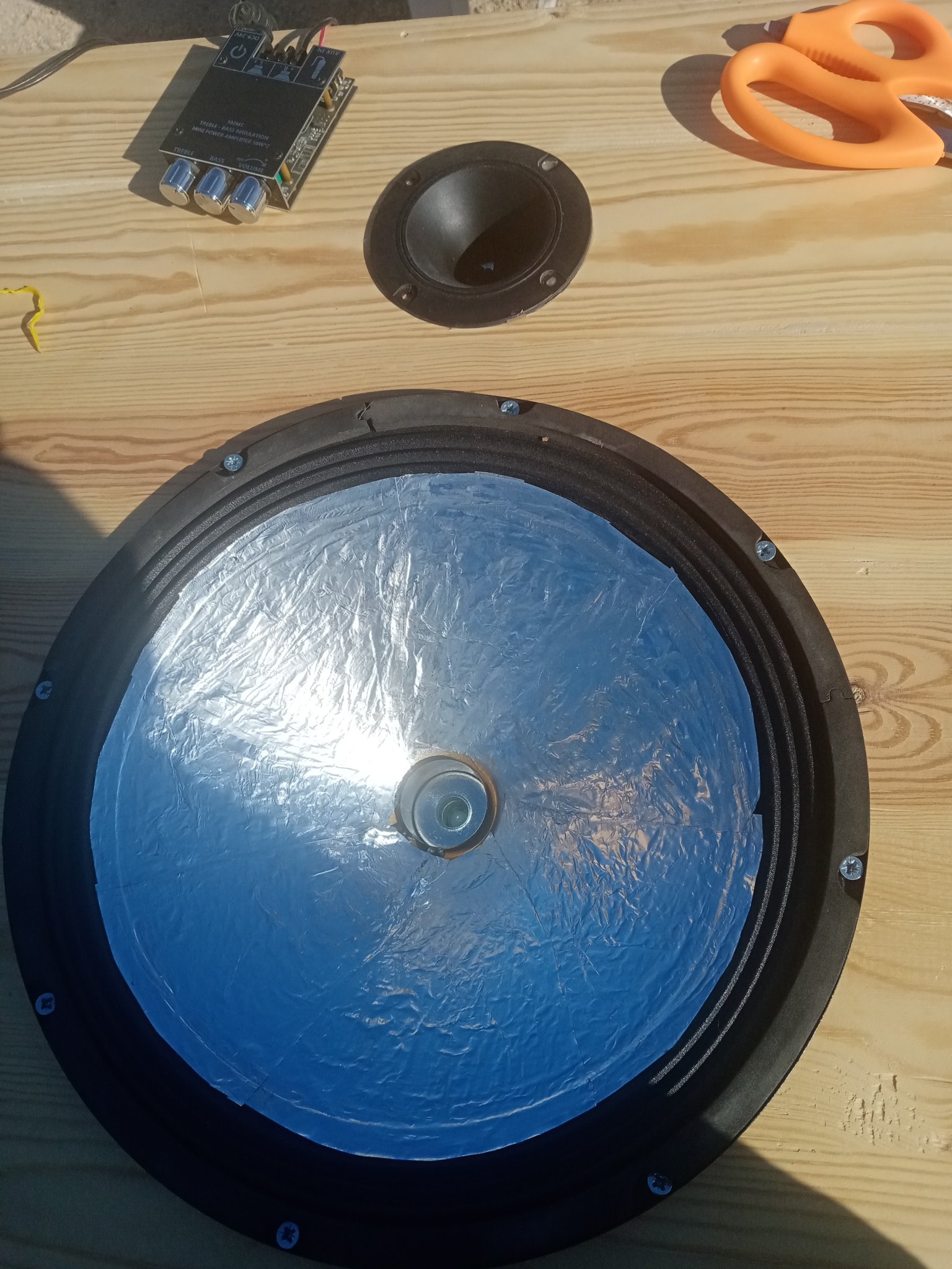

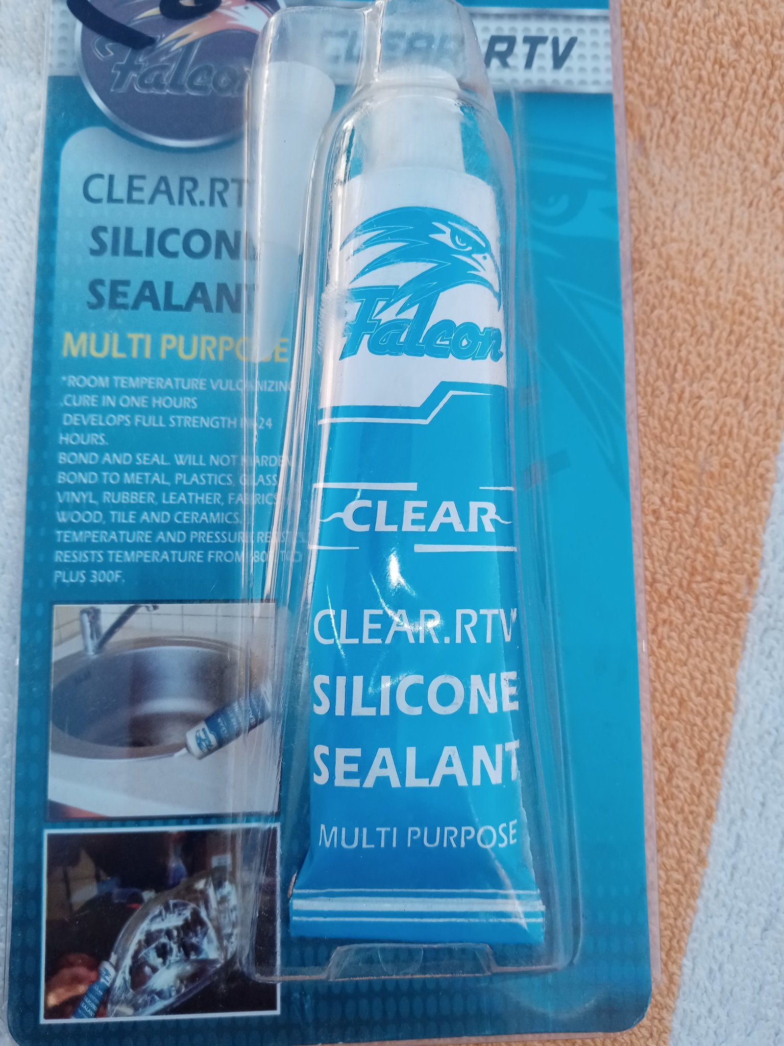

yes, tried it on a driver with paper cone and aluminium foil.
First time use of silicone glue instead of "normal" household glue.
Work with it is faster and finger snipping test on the cone shows better damping due to the properties of silicone.
Constrained Layer damping:
A hint I got here from the forum as a key to good sound from sandwich structure.
Now used silicone sealant for applying aluminium foil to the paper cone.
Finger snipping test shows enhanced damping due to the properties of the silicone.
Work goes faster than with the household glue I used usually.

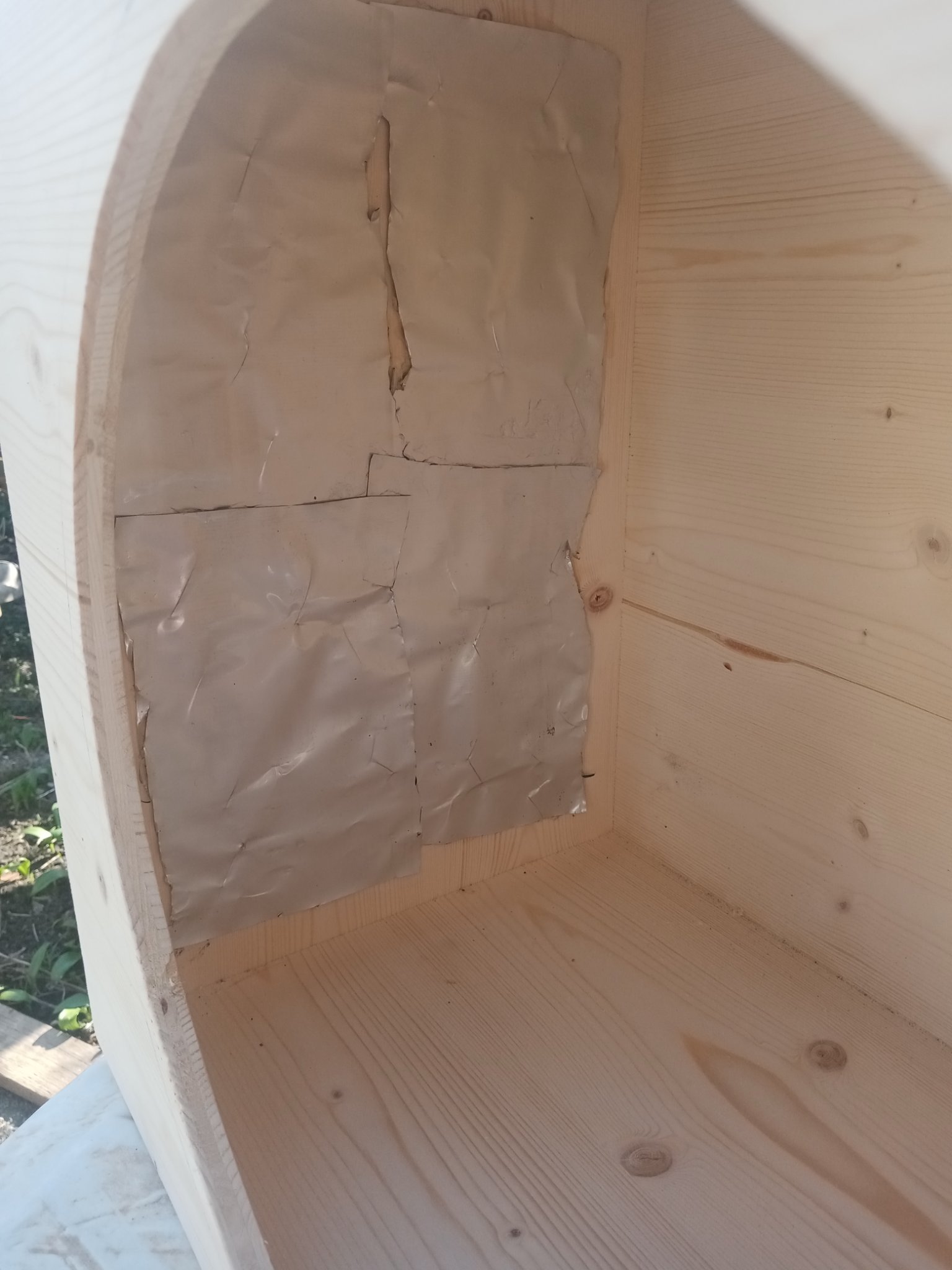

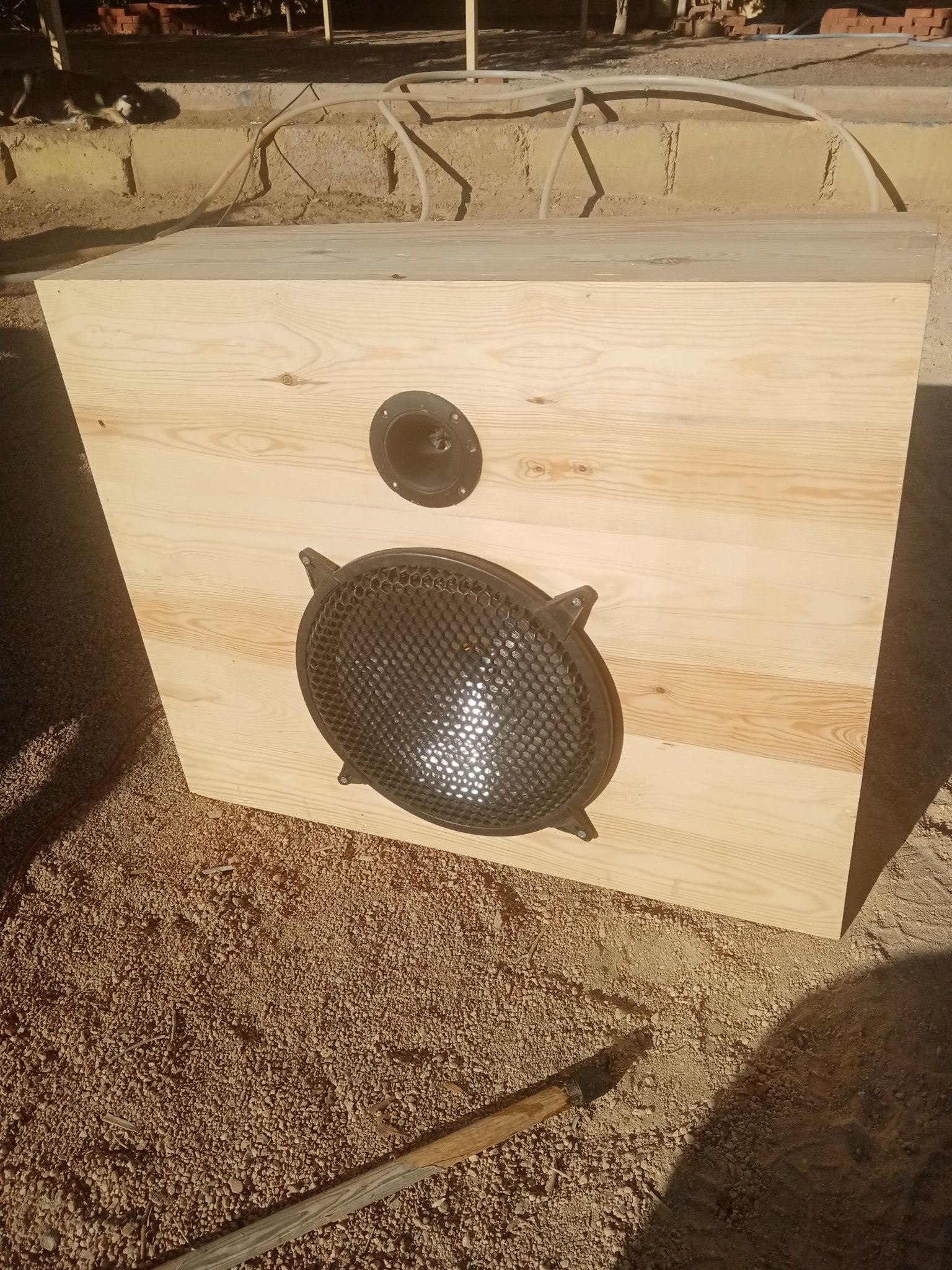

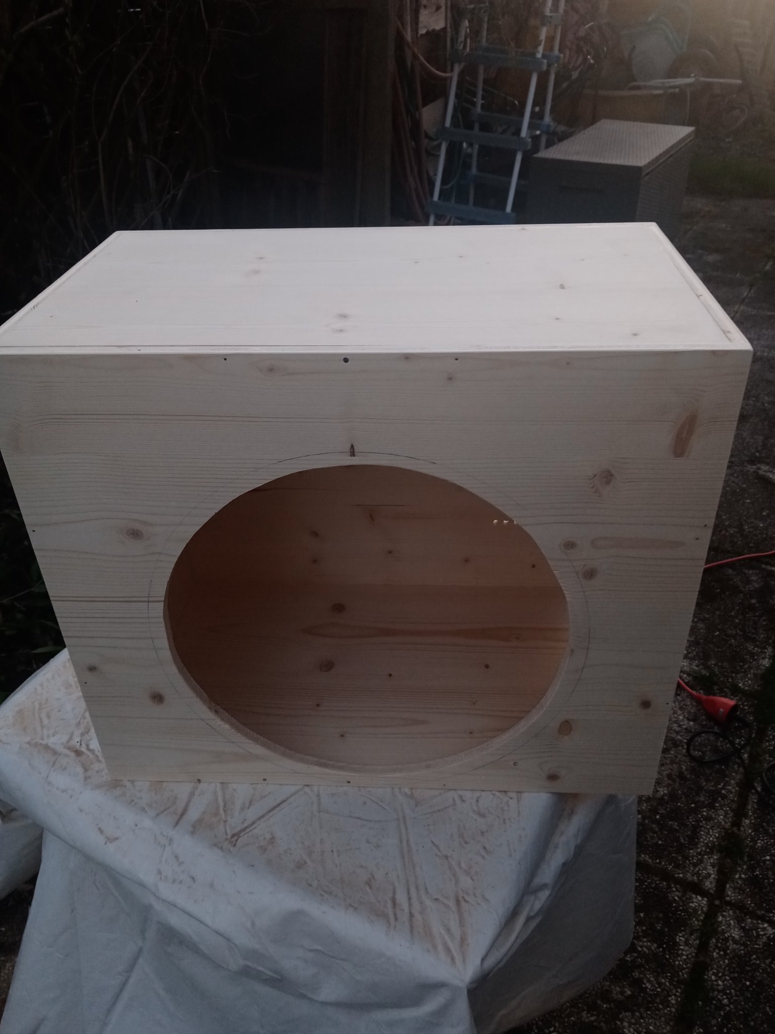

tried metal foil from beer cans (recycling) with a layer of silicone glue just to get it fixed. On 12mm three layer spruce wood.
Its a box for a 38cm fullrange.
Nice and easy idea but it does not do anything at all due to simple knocking test.
Maybe some more sophisticated measurenent would show something....
As I know the effect of alubutyl in car hifi - this works better due to the heavier butyl.
what works well is glueing in sheets of 1mm thick lead with a strong glue "Montagekleber". This deadens quite well.
If you mean construction adhesive similar to liquid nails or soft polyurethane then I agree those are good choices.

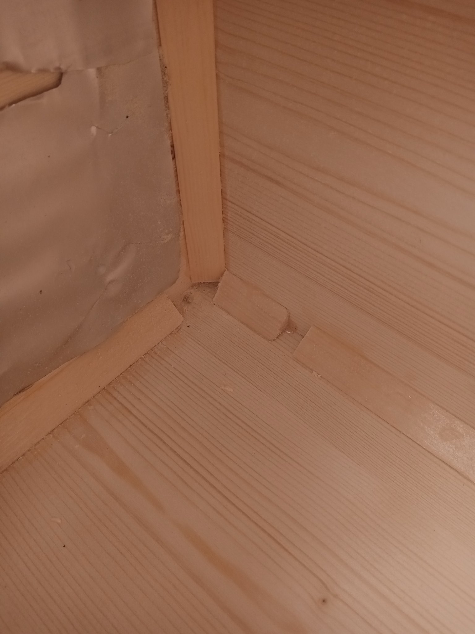

cld with silicone glue and metal foil raises a little bit the resonance frequency of a panel due to more stiffness.
For 12mm spruce wood a heavier damping works better, so not recommendable. The effect is too weak.
Could hear the effect in simple knocking test after doing some basic stiffening on all sides of the box.
Before that knocking on the surfaces made all the box resonate so difficult to hear any effect.

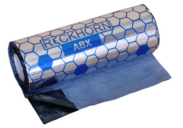

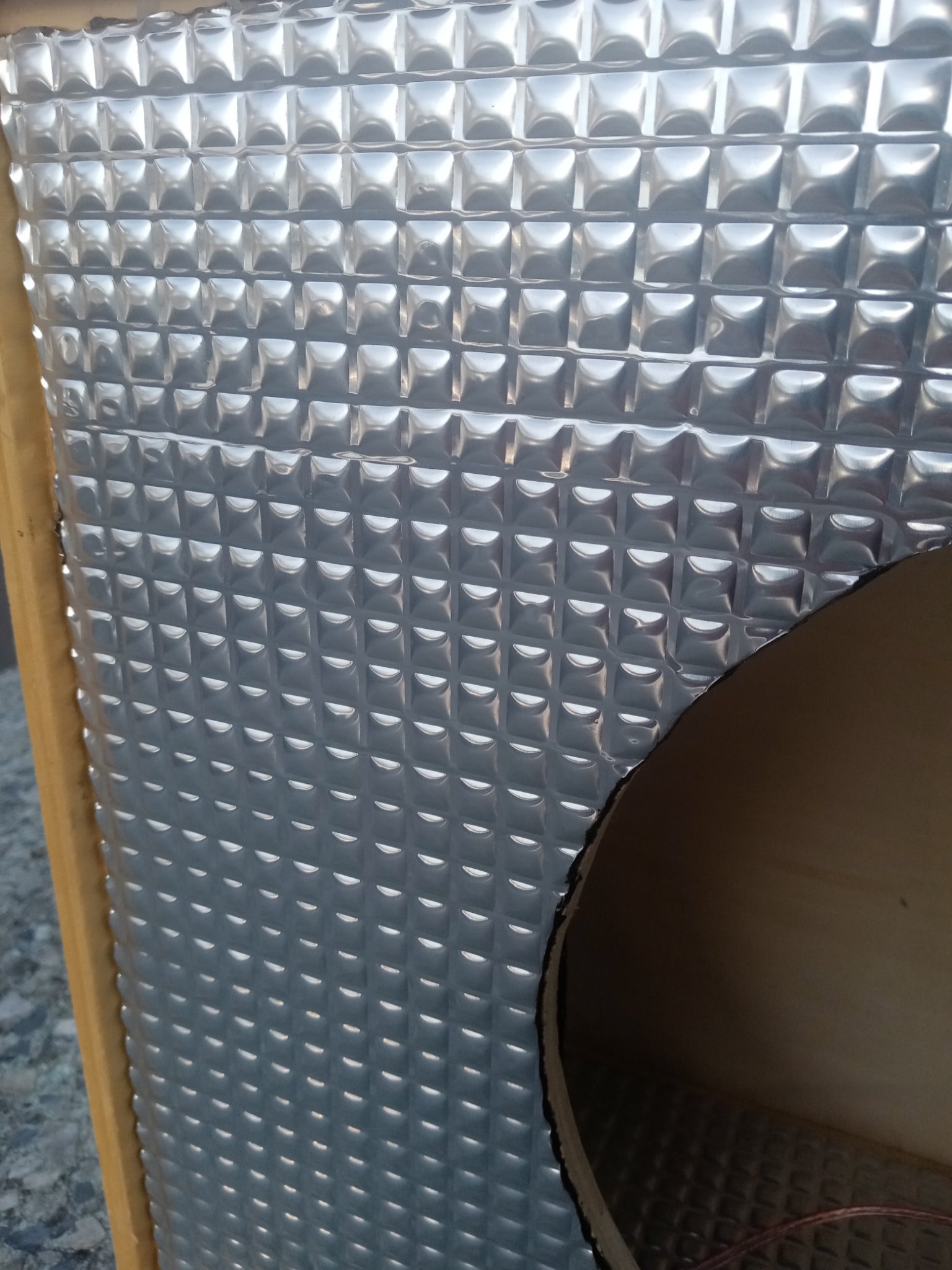

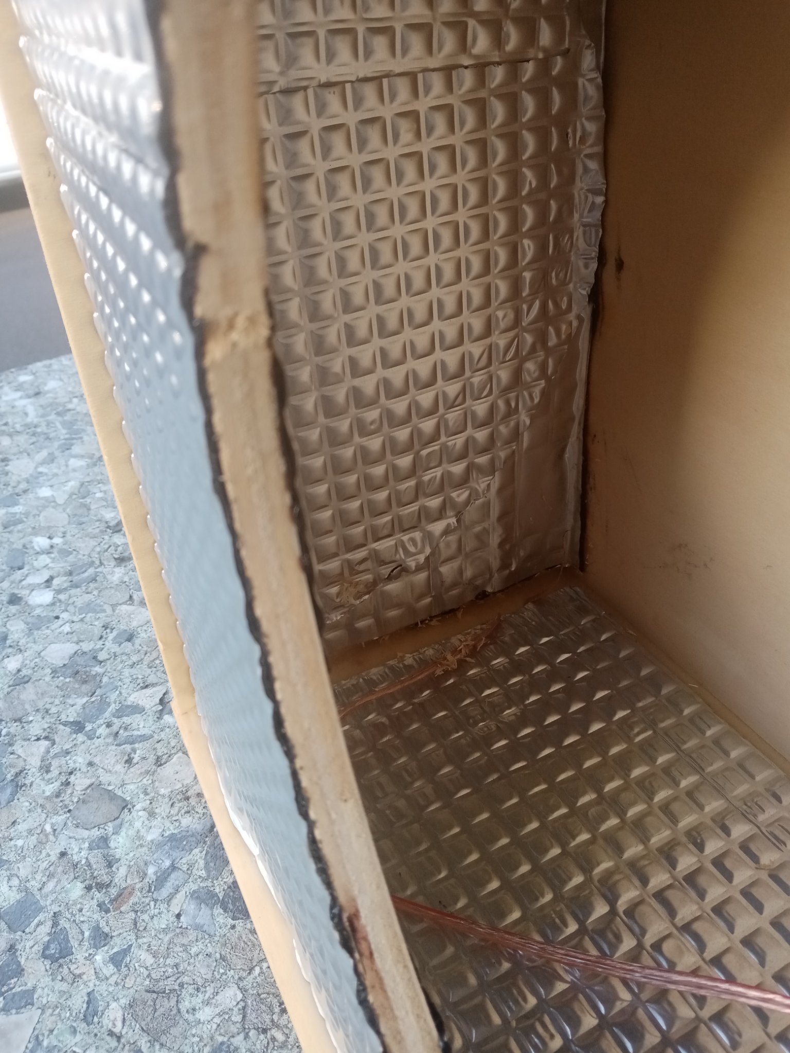

this works, alubutyl from car hifi domain for damping doors and metal surfaces
12mm plywood with both sided alubutyl, its 1mm butyul and a thicker layer of aluminium foil
knocking test shows good damping
