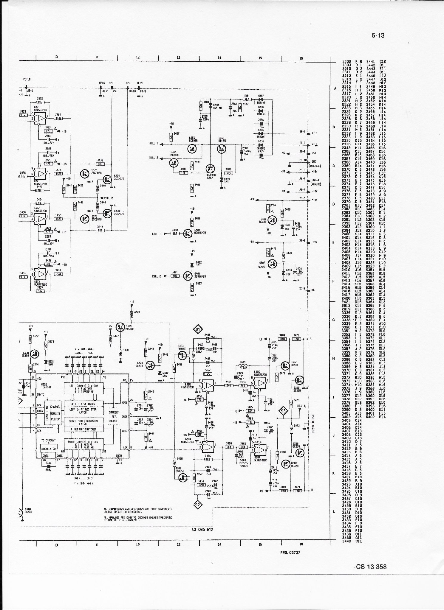

I am sure that I can tap into the DAC's analog output without cutting any traces. Others have done that when they do the Lampization mod. I will remove the op amp chips and put an empty 8 pin DIP socket in its place. I just need to figure out where the best place to solder a short piece of coax to send the current to the EQ board will be.Others have been so nice to warn you that this is technically not a very good solution. I agree with that, but I have seen people on this and other audio forums do stranger things and be happy with the result, so why not try it?
You will have to disconnect the DAC outputs from the op-amp current-to-voltage converters inside the CD player. Can you do that without causing unrepairable damage? Otherwise you can't revert the change if you don't like the results.
Here is the schematic that shows the DAC and op amp circuits.
I have ordered a couple each of solderless bread boards and prototyping PCBs. I think I will start with a solderless breadboard to test if the circuit works. If it does at at least sounds OK even if not great, I will buy better quality components and try get the values as exact as possible by making each resistor and capacitor value more accurate by using components in parallel / series (as needed) to equal the exact target values.

I am confused. Are you saying that 52.65 ohms is the ideal value that I would install for R4 or that it is a value that would be used to calculate the actual resistor taking the 47K ohms of the preamp input impedance into account? I hope my question makes some kind of sense. If it does, can you please tell me what value resistor I should install for R4?By the way, when you change R4 to 52.65 Ω including the parallel resistance across the MC amplifier input, C1 and C2 get within 1.4 % from an E6 standard capacitor value:
R1 = 10 Ω
R4 = 52.65 Ω including the MC amplifier input resistance that is in parallel
For example, the resistor on the board has to be 69.21422 Ω, or 69.8 Ω rounded to the nearest E96 value, when the MC amplifier input resistance is 220 Ω. It has to be 111.19324 Ω, or 110 Ω rounded to the nearest E96 value, when the MC amplifier input resistance is 100 Ω.
R3 = 759.646247223 Ω -> 750 Ω rounded to an E96 value
C2 = 98.730165882 nF -> 100 nF rounded to an E6 value
R2 = 9510.7946895155 Ω -> 9530 Ω rounded to an E96 value
C1 = 334.35691799 nF -> 330 nF rounded to an E6 value
The capacitors either have to be accurate film capacitors or accurate NP0 a.k.a. C0G ceramic multilayer capacitors, definitely not ceramic class 2 or 3 capacitors (such as X7R, X5R, Y5V, Z5U). The more accurate the better, but the best you can get with these values is probably +/- 5 % tolerance.

The Z foil resistor that I ordered for I/V conversion when I was planning to build a Lampizator output is actually 100 ohms not 10 ohms as I thought from memory. Does this mean that the values of the components for IRIAA will need to be change or that the output voltage of the IRAA circuit will be so high that it will overload my phono stage .
The first question is how much the DAC performance degrades with a 100 ohm load, and I don't know the answer to that. I only know you will violate the TDA1541A output voltage compliance specification by about a factor of 16 with such a high resistor value; the voltage compliance spec is likely to be a bit conservative, but a factor of 16 is a lot.
I would just buy a couple of 10 ohm run-of-the-mill metal film resistors and leave the Z foil resistors unused.

Here is the detailed data for the analog out current of the TDA1541:
The TDA1541 has a typical full-scale current output of 4mA peak-to-peak (4mA p-p). This translates to 1.41mA RMS. At digital zero, the output current is 2mA. The TDA1541 uses a unipolar output current.
Based on this data it seems that in the best case scenario even with a 33 ohm resistor for I/V, the output of the IRIAA circuit will overload my preamp output stage capabilities. Using ohms law to calculate the I/V converted voltage, I get about 66mv. The highest output phono cartridges have an output of about 6mv.

Repeating a part of post #95:
The resistor R1 of the circuit is supposed to be the current-to-voltage converting resistor. I've chosen 10 Ω because I thought I read in one of the posts of this thread that the DAC works well with 10 Ω. With a 4 mA peak-peak output current, the voltage across the 10 Ω would be 40 mV peak-peak or about 14 mV RMS.
At 1 kHz, the output voltage of the circuit is about twenty times less than the voltage across R1, so around 0.7 mV RMS. That's about 7 dB to 8 dB more than the 0.3 mV from your MC cartridge, but this is a maximum level, while cartridge levels are usually nominal levels. Chances are that the DAC will sound slightly softer than the cartridge.
