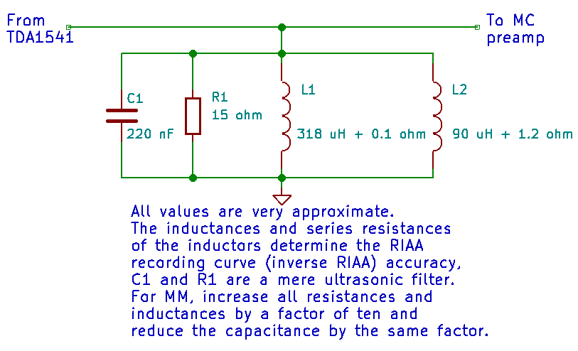

Getting back to Lampization tubes that I might use in phase 4 of my modding of my CD880. I just looked at My preamp's tubes. The 7308 can be used as input tube in the line and / or phono stages or more likely wasted as cathode followers for those stages. So, I probably have at least one strong pair I could use for a Lampizator project. What think y'all? I also have one pair of NOS 1975 2n23p so called "holy grail" tube.
You´ll need a higher gain tube, since the signal is quite weak.
A small correction.....
You write "2N2P and 2N23P"..... It´s actually 6N2P and 6N23P 😉
Why not (since you call it "Lampization") use, what Lukasz has described...... 6N2P for the TDA1541.?
This has a gain/µ around 100....... same as the ECC83/12AX7 .
On the output between the 2µF and the RCA-socket, put a 100K to ground.

High gain is ideal to reduce the i/r resistor for the TDA 1541...12ax7 is good for the purpose, put a 5687 as a buffer and you are done. You don t need 5Vpp output. Gain can be managed by the pre.
Your targett is a Mu between the 33 talked to 100 and high transimpedance, Just take care of oscillation.
