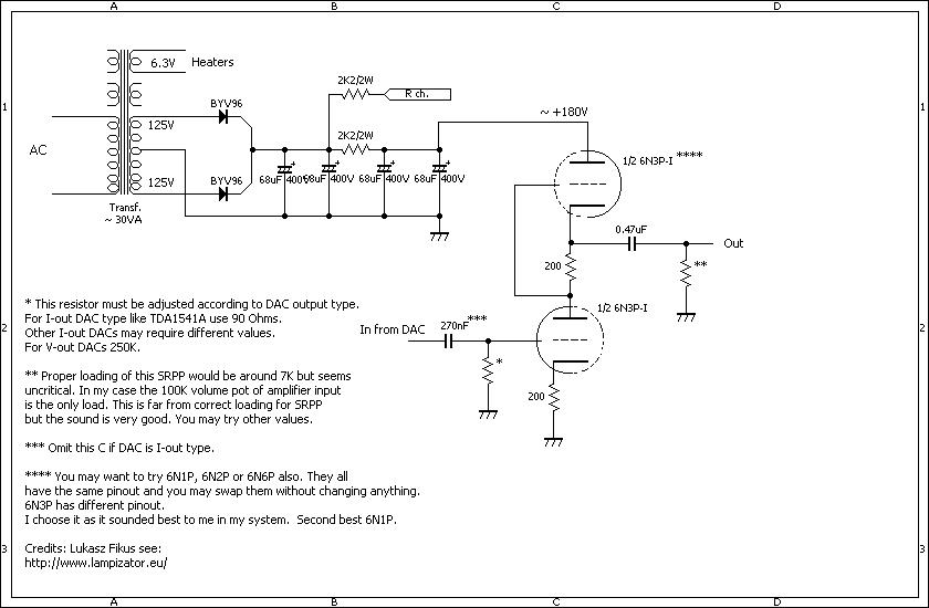

I should have asked in my previous post. Can you please make a schematic for an SRPP circuit using a 10 ohm I/V resistor and using the 6N23P tube?

I found this schematic. What do think about using this and using a 33ohm I/V resistor with 6N23P? I would need to change the PS because the only transformer is not center tapped.
I know for a fact (tried several times) that 91R works perfectly with 6N2P.... = gain matches for a decent output.
33 ohm = 1/3 of signal strength used with a tube with much less gain......... What does your math-teacher say??
Marcel, up to 50R is good enough for ears, no one has complained ever with that and the ECC88/6DJ8 and the TDA1541. The 6N23 non EV is too risky for the nouse and 10R too weak indeed with a 33 Mu. One can use the 12ax7 but irs transconductance is less goid than the ECC88/6DJ8 iirc.
Better if 27 to 36 R, ou are rigth indeed. but with a pre after only. My understanding is audioxcel's is hissing...(made from 6922? Ahaha... swap it for 7308 in the pre after having checking the heater voltage... hiss solved)
