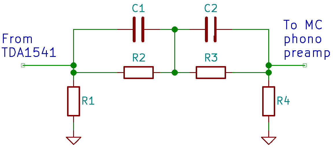

Given the constraints that the circuit needs to consist of resistors and capacitors only, so no inductors allowed, you could try something like this:
You can use the attached spreadsheet to calculate the values. In the first three rows, you have to fill in R1, R4 and the corner frequency above which the RIAA recording curve should not be approximated anymore. I suggest a value of about 35 kHz for that, because it results in about as much high-frequency loss in the audio band as the third-order Bessel filter with a -3 dB frequency of about 30 kHz that is usually used in Philips CD players. As far as I know, the digital interpolation filter corrects for that. (The suppression of ultrasonic images is of course worse than with the original Bessel filter, but still better than many audiophile DACs.)
Example:
R1 = 10 Ω
R4 = 49.9 Ω
Corner frequency 35 kHz
R3 = 726.3018389 Ω
C2 = 103.26 nF
R2 = 9093.321658 Ω
C1 = 349.71 nF
You have to include the MC input parallel resistance in R4, so please fill in the parallel value of the resistor you want to use and the MC input shunt resistance.

Thanks. After I went to bed last night, I thought about the definition problems we were having that were hindering progress on what circuit I was asking for help designing. I had decided to propose language that would hopefully get everyone on the same page.Actually audioxcel just uses a different definition of RIAA and reverse RIAA than most people here. I switched to calling it RIAA recording and playback equalization to solve ambiguities.
I hope everyone will agree to use your proposed language going forward. Henceforth, please use the terms "RIAA recording" (for the LF -20dB and HF +20dB EQ that is applied to LPs) and "RIAA playback" (for the LF +20dB and HF -20dB EQ that a typical phono preamp stage applies) in this discussion.
That said, what I am asking to help with is a schematic of an RC circuit for adding "RIAA recording" EQ to the signal that is output by a TDA1541A DAC (after that signal has been I/V converted from its typical 4ma PP to whatever voltage would result from a resistor I/V conversion).
Please do not get into the pros and cons of this kind of circuit at this point. I am willing to consider any alternative circuits except those that contain IC op amps at a later point. One of my goals if to definitely eliminate the IC op amp circuits in my CD880 player.
FYI: The CD880 player outputs a non-inverted signal but I think you are correct about how that happens,
