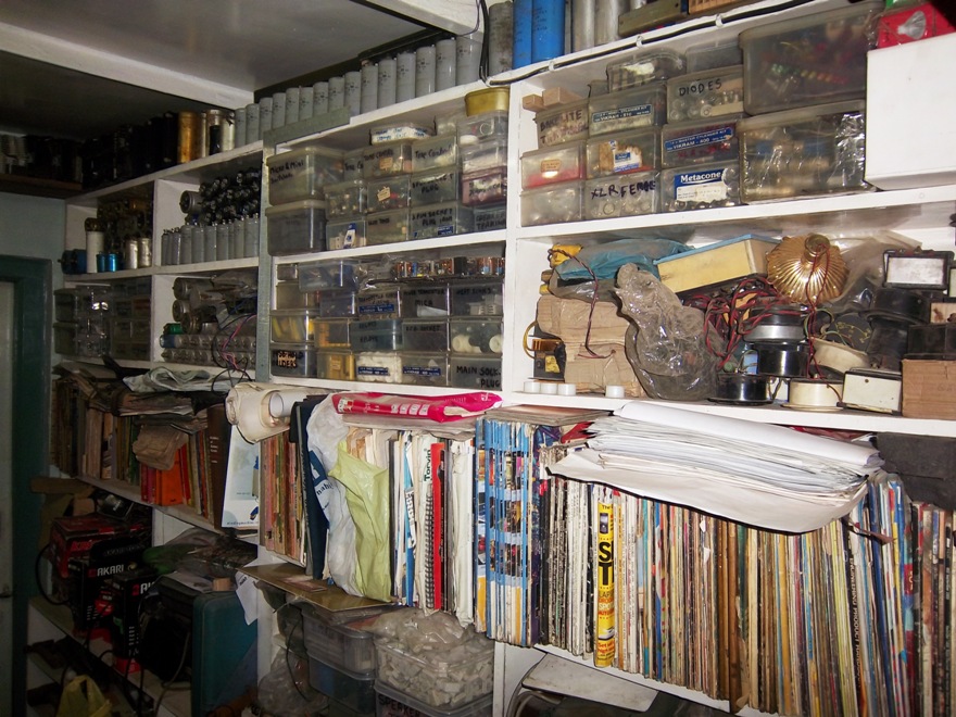

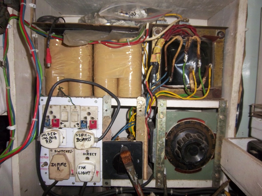

Is the circuit on page1 post6 of this thread complete. Kya yeh naachees can give this circuit a try with your guidance.Planning to pu 16 pairs 15024 - 25 that is toatl 32 in output. will a 2.5 kva transformer will be enough for this amp.Is nachhese ki choti si work shop ka photo saath hai.regards

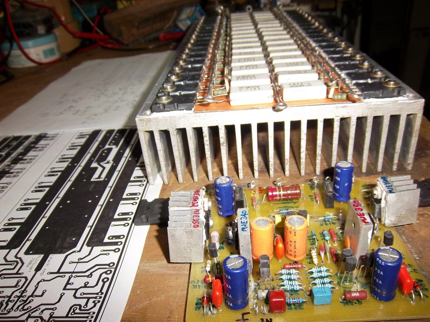

I have no more connection with Andrew Lebon. Wo aapki meharbanion es bahut unchi chees ban gaya hai success has got his mind.This is what I have done recently.Meter is showing Peak output voltage with 2 ohm load .Rail voltage 85-0-85.Continuos output voltage into 1 ohm load with .8 voltage music signal reached upto 43 volt. My aim is to achieve 60 voltage undistorted into .5 ohm load

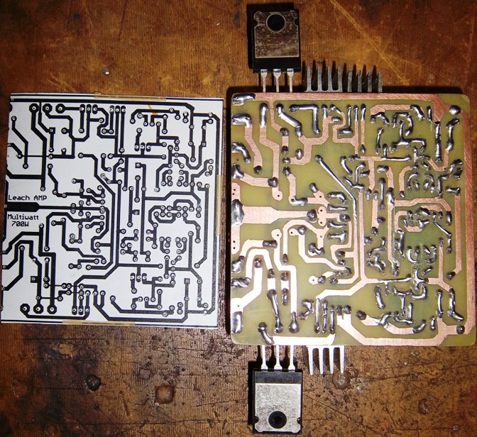

is that a leach lo-tim amp you have there?
Other than the lack of feedback from the driver stage, and the lack of diodes in the bias circuit, it sure looks like a Leach.

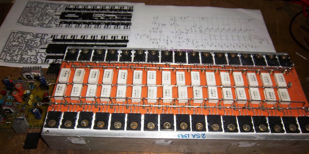

multiplying the number of outputs will not make a high power amplifier
amplifier of this range of power will need proper protection

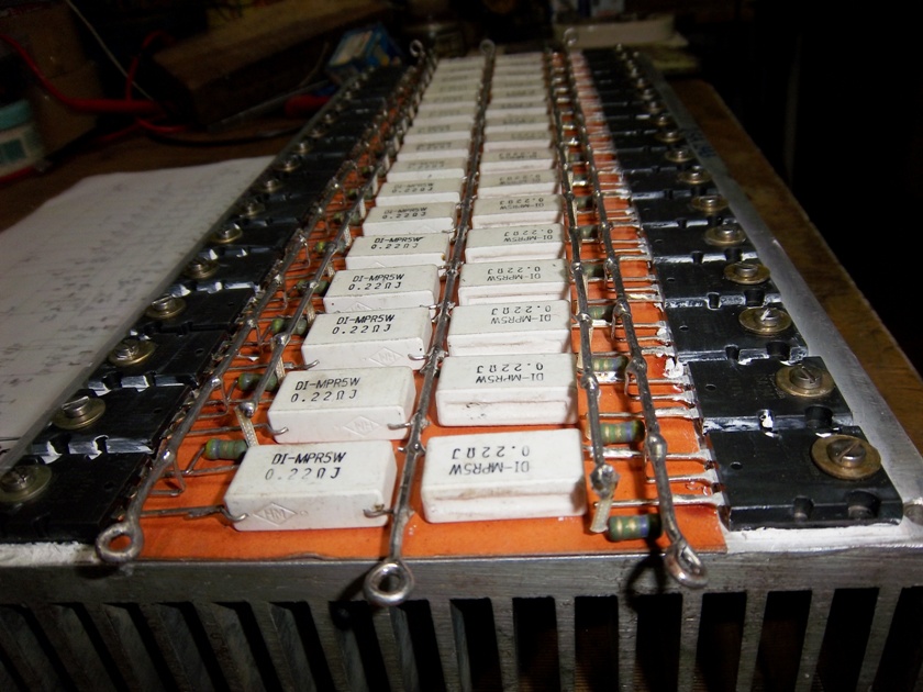

---one may calculate how much current will be drawn from this circuit per rail and then realize that a ""wire "" of 1.5mm cannot and will not deliver this amount of current
--Then again there is so many transistors placed in such a proximity in a relatively thin pcb that will actually warm each other up .... the result will be that even if a vent is used it will be not possible to cool down the amp ....fins are too small ...
---It should be plenty more ....

Yes, It is sure a leach amp alright..look at the background schematic. originally its a 700w 16TR design but he doubles it.
But D.Self shows us that doubling the output stage lowers the distortion, even into the same loading.
Look at his Blameless and compare to the Load Invariant.
But, using 1943/5200 at high voltage is a complete waste of semiconductor devices.
No matter how many one uses, there are far better devices available that can work well at the higher voltages. These higher SOAR devices can reduce the required numbers of output BJTs by a factor of at least 2 and often better than a factor of 3.

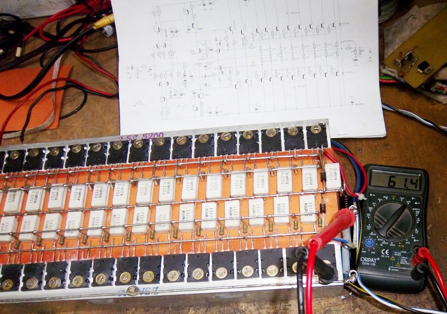

Yes Sir this is a leach amplifier modified.no P.c.b. is used in output section. Rail wires are 2.5 m.m. thick.Today I run this amp for 6 hours non stop with 8nos. 15' speakers+8 nos.12" speakers +8 nos. Tweaters Total d.c resistance .5 ohm upto 52 volt and 33 amps on output. Crispy crystal clear highs lively mid and deep low was what I got . I am happy with result.Sugestion to make this was by Capsighter Chinoko .sending some more photos.Paa ji Aap ko main aap ki id par message bhejunga.

can you snap a photo of the heatsink profile you used? is that a local job and how much does it cost? thanks
.... did you try to overdrive the amp by ""accident "" ?..... if you construct such an amplifier a situation like that will happen in the feature ....this is a simple fact
Hello Mr. Sakis,
no I did not overdrive amp by accident.I did it purposely.Because i had a challenge from some local guy who made an amplifier and drive 40 12" speakers parallel on one channel.I have a challenge to drive 8 18" speakers parallel on one channel for 12 hours.Still I have not reached my goal because for that kind of amp i need minimum 70 volts and 35 amps at output on given load condition that is 8/8=1 ohm and around 2400 watts .and I am up to that .maybe with 16 pairs of 15024-25 I will achieve that. Need a good Driver circuit for this purpose.Supply is no problem for me as I wind my own transformers.E I and Torrid both.At present I am using 2750 watts transformer on my bench.About the cost of heat sinks I don't remember because I was planning all this since a long time. As you can see i have ample collection of components cores heatsinks in my work shop. I have already made dx turbo with 18 transistors in one channel.E T i 320 watts with 12 mj3773 in one channel .Dirty harry by Fotios 20 24-25 one channel.Quasar legend stage master with triple drive and many more My first 4 channel amp I made in 1982.E.T.I master mixer with equaliser modified to 10 channels in 1983 and so on.Audio is my hobby and profession both.Now at the age of 56 I want to shift from field work to table work.Since 5 years I was learning quietely from All Learned people from difrrent forums.Now only I am showing What a little I have learned. My motto.The day you stop learning you are no more.Thanks to all learned ones. attached some more photos.

i am interested in your heatsink profile, is that a local extrusion or did you import? do you have profile drawings with dimensions that you can send me?

Heat sinks, cores,power resistances, capacitors and many other components I buy from Agra disposal market where they sell most of military disposal goods. My oscilloscopes , Signal generator,Philips analogue multi meter and many more I buy from this market on down to earth prices.Heat sink I buy lot in Kg. rates of scrap and these parts are better than market new parts.In cabinet i will be using 2 heatsinks to create tunnel and fan from both side suction and throw.
