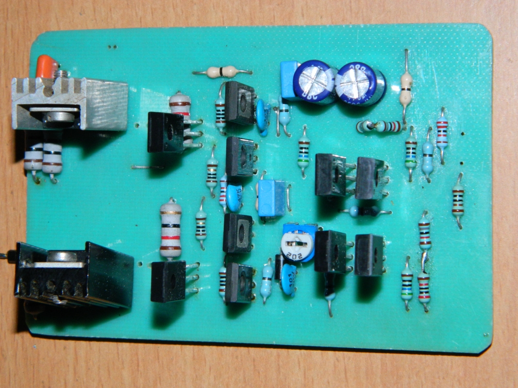

Hello Andrew, clean nice job you have there!😀😀😀
Hi Kimberlator
greetings please can you tell which schematic you made this is the one with 560 ohms and 38k in input section this pcb is for trial run only
so only one pair mje15032 33
warm regards
andrew
Well, i've made the High-Power Version, the one with 12 TO-3 MJ21194 devices per rail, and, as stated before, i've made it salvaging other amps, just to verify if it's actually work or not, since seems to be some temp issues with the design, as well as some resistor values that need to be changed in order to get it work, please note that you certainly will need to stick pre-drivers on a heat sink, as well as the ones on the VAS, they actually reach unsafe temps if not attached to a heat sink, and remember that the "Diode-Connected" transistors to be placed on main heat sink, as they are the "Heat Tracking Devices".

Thats very old design of mine.
As Paul already said, the diode connected trannies must be attached to heatsink in order to get proper heat tracking. To enhance the low level signal clarity, put one more diode connected transistor in series with other two already in the schematic and set the trimmer accordingly to get 20mA idle current in output devices.

Hello.,andrewlebon
May i have to see the PCB of your design.
I would like to make this Amp.
Thanks.

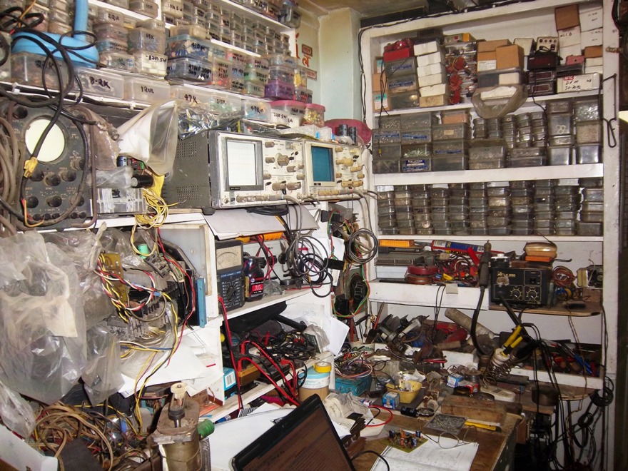

Is the circuit on page1 post6 of this thread complete. Kya yeh naachees can give this circuit a try with your guidance.Planning to pu 16 pairs 15024 - 25 that is toatl 32 in output. will a 2.5 kva transformer will be enough for this amp.Is nachhese ki choti si work shop ka photo saath hai.regards
