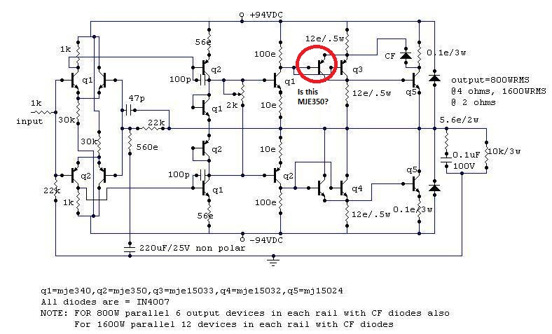

Looks like the Altec 9440 output stage (post #5).
The MJ21196 has 50% more SOA than the ML15024.

"tell no of transistor circled in red"
I would use three MJE15033/34 for drivers (as per the Altec diagram) and use at least 8 pair of MJ15024 for outputs on the ±94V listed, or use one pair of the MJ15024/25 for the drivers.

Amp was made by myself, with 1k at the input sound distorted and unclear at low volumes, here are the psu specs:125VAC Pri, 66-0-66VAC Sec, 1.5kva toroidal transformer from Plitron, 6-10,000mfd 125vdc Cornell Dubilier, i'm getting +-106vdc with no load, no input signal, Output BJT's are MJ21194, 12 per rail, drivers are MJE15034-35 HV rated as you know, and the rest of BJT' are MJE340-350, half of the outputs have been placed on a BIG heatsink, same for the other half(12 in one heatsink and the other 12 on other exactly same sized both of them) so heat is no a big deal here, a stated before, at low volumes sounds unclear and distorted, but when pushed sounds very well indeed, has large amounts of power, but i'm a little concerned about such distorted sound when it's running low,![]()
Here is a Schematic for u
what should i check? Thanks in advance, Paul...
Nop, they actually are MJE15033 (PNP), Both of them.Hi Workhorse
Greetings. can you please tell no of transistor circled in red
