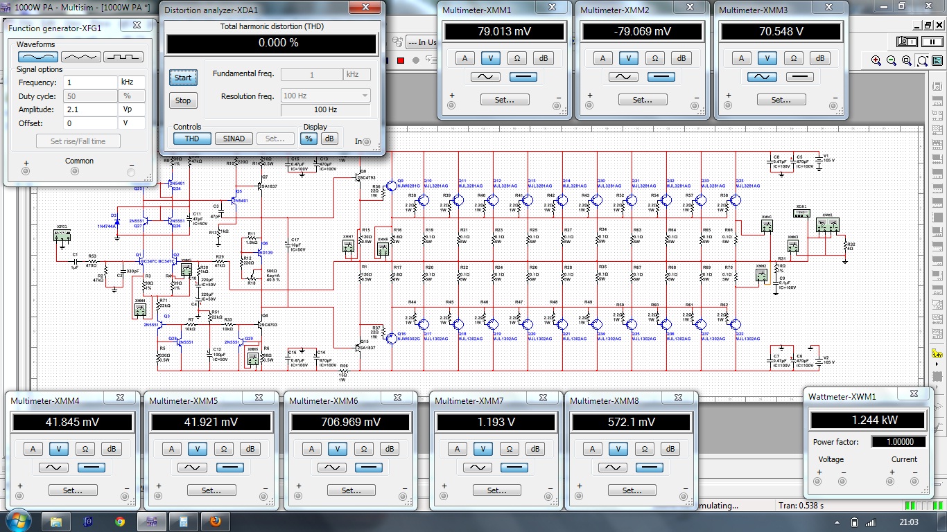

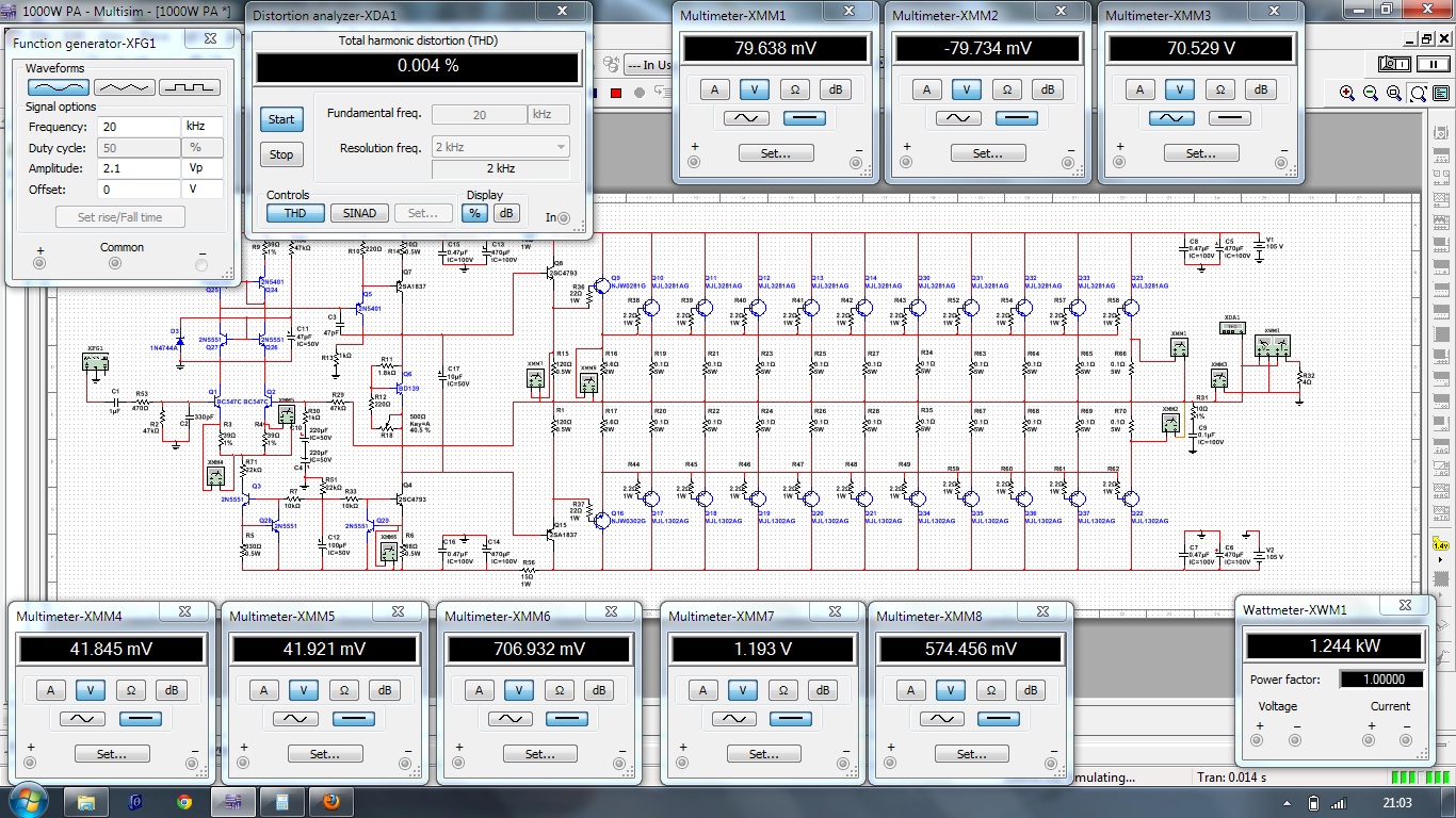

2400 Watts @ 2ohms 0.000%THD1
1200W @ 4ohms 0.000% THD 1kHz, 0.004% THD 20kHz
2400W @ 2ohms 0.000% THD 1kHz.
All you need is at least 2.5KVA transformer, at least 50000uF of capacitance per rail per channel. hefty wiring, mammoth size heat sinks with fan cooling and a 4U chassis.
Just a simulation in multisim.
Aniket
Aniket

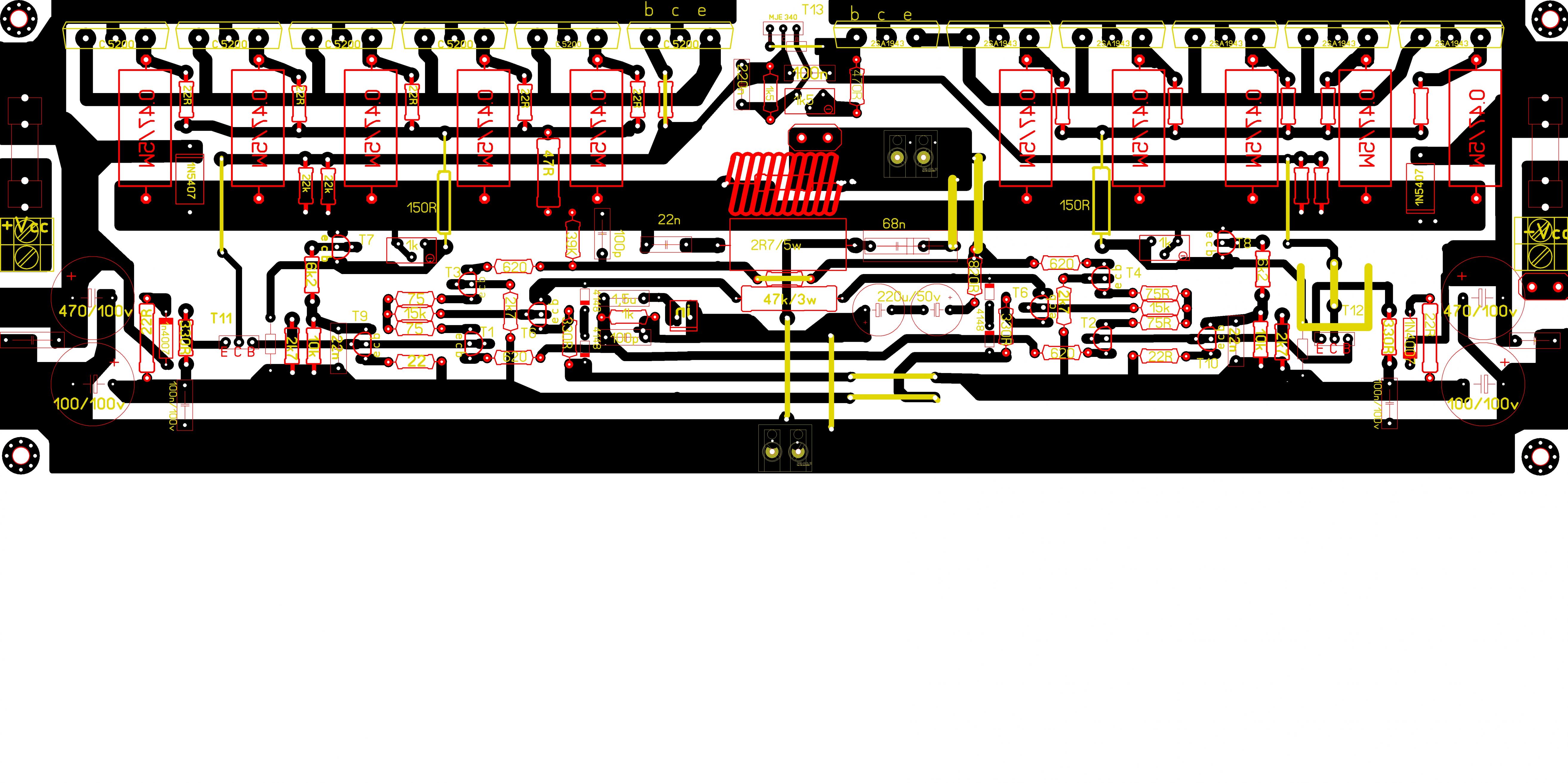

The front end looks like the Honey Badger design, do you have just a schematic?

How are you going to get 2400watts@2ohm from a 2.5kva transformer....?
Serious simulation cowboys ...:)
It's just a modification of my working amp, a humble 250W@4ohms.
http://www.diyaudio.com/forums/solid-state/211635-simple-100w-power-amp-27.html#post3541129
it's pretty obvious, the transformer size is mentioned for 4 ohms load.
