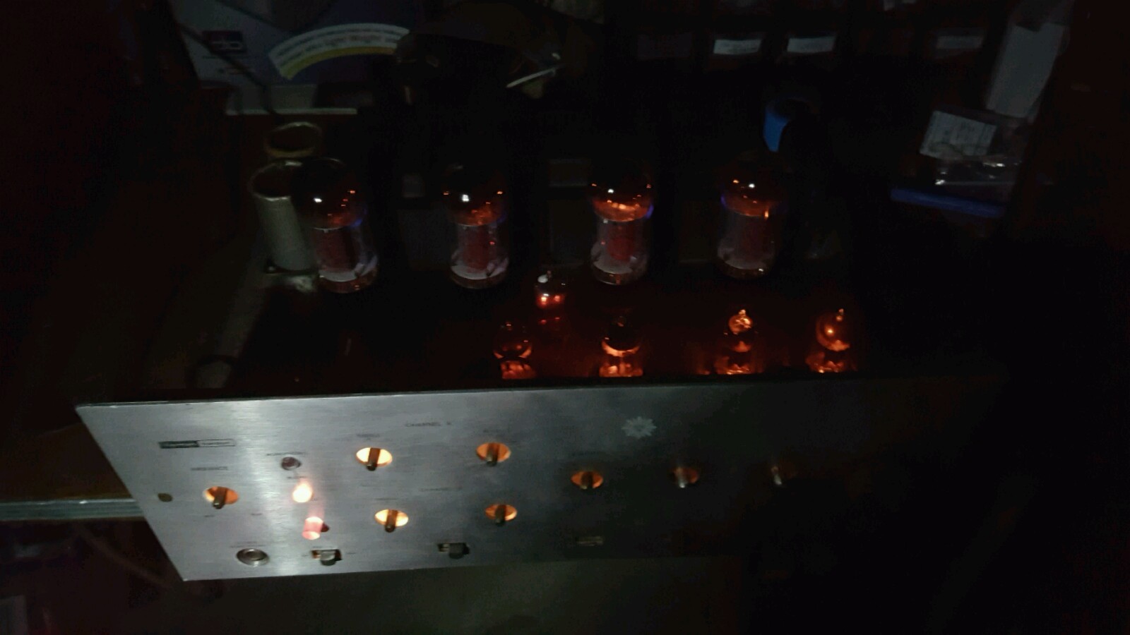

On initial test with music signal on both inputs there was some crackling sounds from channel A, they came and went several times and when the volume was turned all the way up, could barely hear the music. At this time only one speaker was hooked up on channel A. After hooking up a speaker on channel B, now speakers on A and B. Several power ups afterwards the crackling sounds did not occur and no low volume music comes from B channel.

Yes. You have probably already swapped them.I can also swap B tubes to A sockets?
Normally, no. The "mode" switch is located between the preamplifier section and the output amplifier. So that means the signal is passed through the preamplifier just fine, and it is the output stage that isn't working properly.if I have this straight...the stereo rev/nor switch, switches the input signals going into the preamp stage.
You should never run a tube amplifier without a speaker or resistive load. Without any load, it's easy to cause high voltage breakdown of the insulation inside the transformer. For future reference, never even turn a tube amplifier on without the channel outputs having a load securely connected. The use of speakers during initial power up can give you early warning that something is amiss before all the smoke and sparks begin. Even table radio speakers will work for that.At this time only one speaker was hooked up on channel A. After hooking up a speaker on channel B, now speakers on A and B.

Had a few minutes this morning swapped output tubes so I know all the outputs are good. Made measurements of the output sockets only noticeable difference is the cathode voltage on the working channel is 33V while the cathode voltage of the non working channel is 35V. Schematic shows 35V.
Also measured the secondary and primary windings on the output transformer on the non working channel. No opens and the ohm measurements were reasonable.

#1 signal killer is the tape monitor switch. Try jumping with clip on jumper....
Try that, along with de-soldering the line going back to the "tape out" and "tape in" just in case something's amiss back there. Additionally Check your coupling cap after the nor/rev switch.
Also another way to help check this is with your blend knob. If you blend over to mono and you get a pretty equal sound out of both speakers chances are the issue is between the nor/rev switch and the blend control. If you STILL don't get anything out of the A chan, I'd start looking in the tonstack onwards.
If its in the tonestack look at the packaged resistor/capacitor components, they'll go out potentially. I've had all these issues with the HK I'm currently dug into.
Just ohming out the tape monitor switch tests ok. Have discovered what seems to be an open area on the A channel volume pot. It tests good at low volume and high volume with an open area inbetween. Just using an ohm meter with the pot in circuit. Testing one channel against the other the other channel doesn't have this open area.
