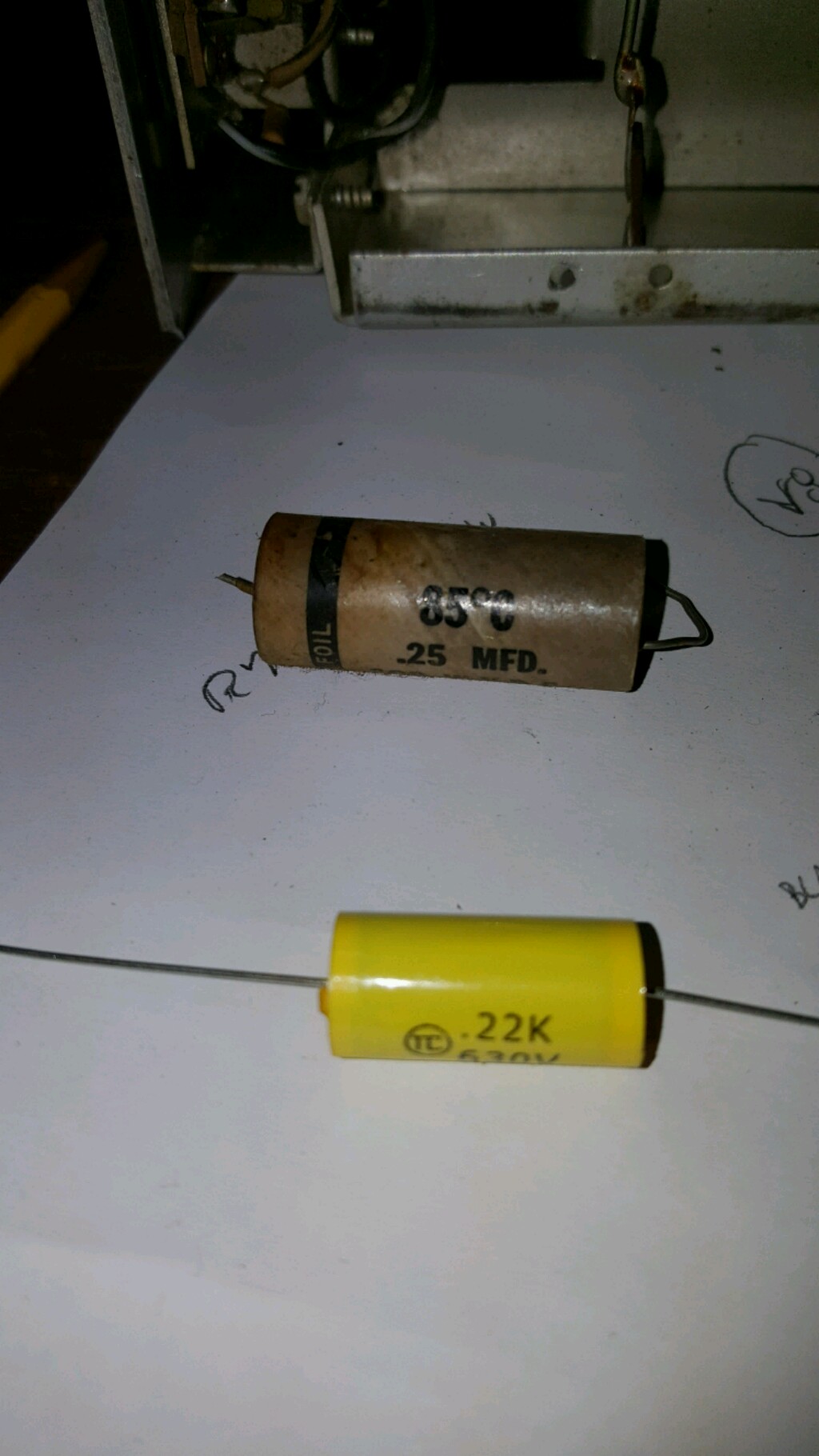

Chris, so the new coupling capacitors do not require any specific orientation (plus..... minus)? Bob
Hi Bob,
Correct. There used to be an indication as to which lead went to the outer foil. That would go to ground if it was a decoupling capacitor, or to the source of a signal if it was a coupling capacitor.
-Chris

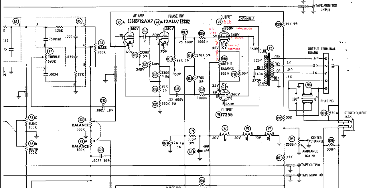

Marked up A500 schematic for 6L6 tube
so I correct my comment made in an earlier thread concerning the bias voltage being 35V that was the cathode voltage. The bias voltage is 5V. Now that I am getting close to being able to ruin the new 6L6 tubes thought I would try to understand how the tube works.
