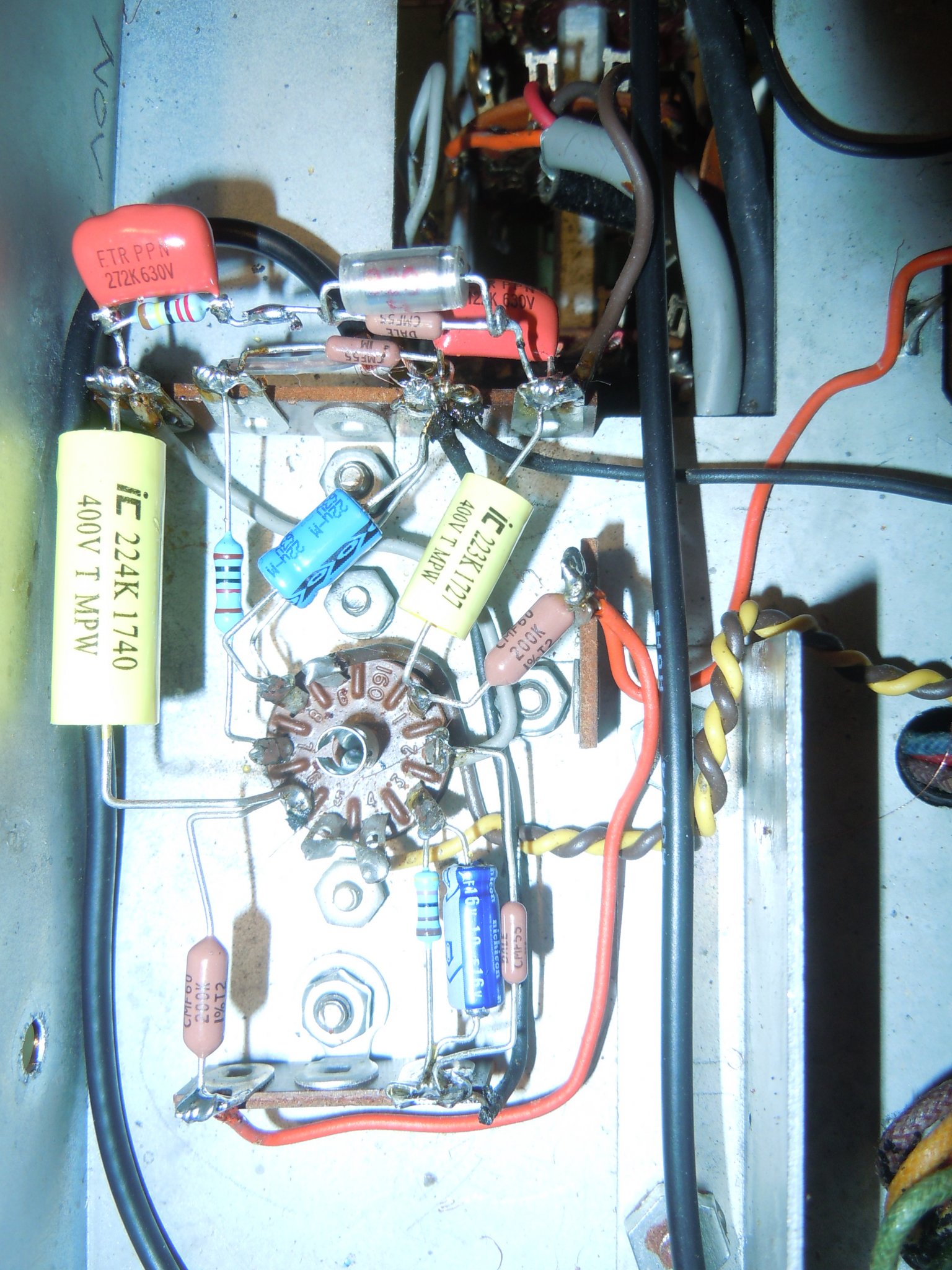

Okay, for coupling caps, use axial polypropylene types of any decent brand. There is no sound difference between them, but there are for different dielectric material like polyester. Above all, they must fit properly, hopefully smaller size these days, and the rated voltage must be equal or greater than the full supply voltage before the tubes warm up. The exception are any coupling capacitors coming off the cathode of the tubes. Beyond that it is pretty simple. Beware if someone is totally sold on any one brand of capacitor, especially if it is an expensive "audio brand".
You should measure the plate resistors and replace any out of tolerance. There are many other things I do to improve performance, but I'm not going to go through all of that.
I am not familiar with this person, which is neither good or bad. If his work is neat and looks like how they built it originally you should be fine. If he leaves the original can filter caps in and wires other capacitors in parallel the work was done improperly and you need to have someone else redo the job. Some of the worst techs have glowing referrals, so you can't go by that. His work should look original and neat. Use your eyes on previous work, he should have pictures. If it doesn't look right, it probably isn't.
This is a shot of something I recently did. It wasn't intended to be perfect or super neat, but is an example of what you should expect. This is the phono section in an Eico HF81 preamp.
