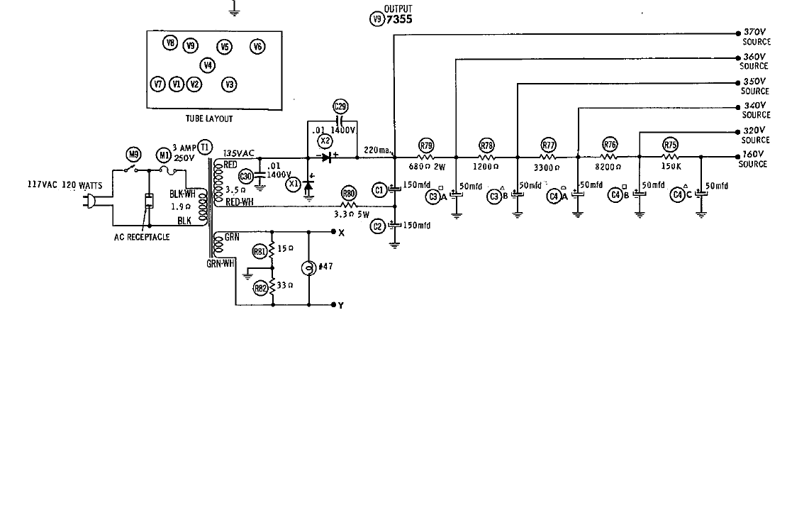

Since the phenolic twist lock bases on both C3 and C4 (50mF 450V) are broken. Thought replacing these caps with JJ style capacitors. Any thoughts on best value for a pair of capacitors and mounts?
Concerning the power supply capacitors C3 and C4(50uF/450V). I am thinking of securing the caps temporarily to ensure that none of the connections come in contact with the chassis and try to power it up with these capacitors?

Measured 140VAC on psu transformer secondary but no B+ voltages were present at caps.
With the amp on the light bulb would the psu filter caps charge?
Purchased new psu filter caps and will install before powering up without light bulb. Will power up on variac?
Okay just thinking the psu filter cap scenario over. I purchased two ARS 50uF/50uF 500V capacitors.
The ARS has the two 50uF taps required of C3.
C4 requires 3 50uF taps so I will still have to purchase an additional 50uF cap and solder in at bottom of C4?

Yes, check for shorts with your meter. Also, replace all B+ caps with total removal of the originals (don't use the original capacitor terminals as tie points). The multi-section capacitors you bought are fine. They are attached with clamps that screw into the chassis and have a band to tighten them with. Most suppliers also have these clamps for sale. If in doubt, call them and ask.
Replace all the grid coupling capacitors before trying anything. Certainly before installing tubes! Use the proper axial capacitors, not the "orange drop" types that are radial capacitors. They will not fit in the same spot as the originals. Make sure all your new components fit and leads run exactly like the original ones did. Lead dress is important with tube amplifiers, and you can change the sound, hum levels and even oscillation some times if the parts don't sit the way they ought to.
You should be seeing B+ voltages, but they will all be too high without a load. Before powering up again, replace the existing rectifiers with silicon diodes. 1N4007 would work great, but you need to add some series resistance to drop the loaded voltage to its proper level as stated on the schematics. Just worry about the first voltage reading as the others depend on the loads that are on them. Set your variac to 120 VAC or to whatever the voltage in your area normally is.

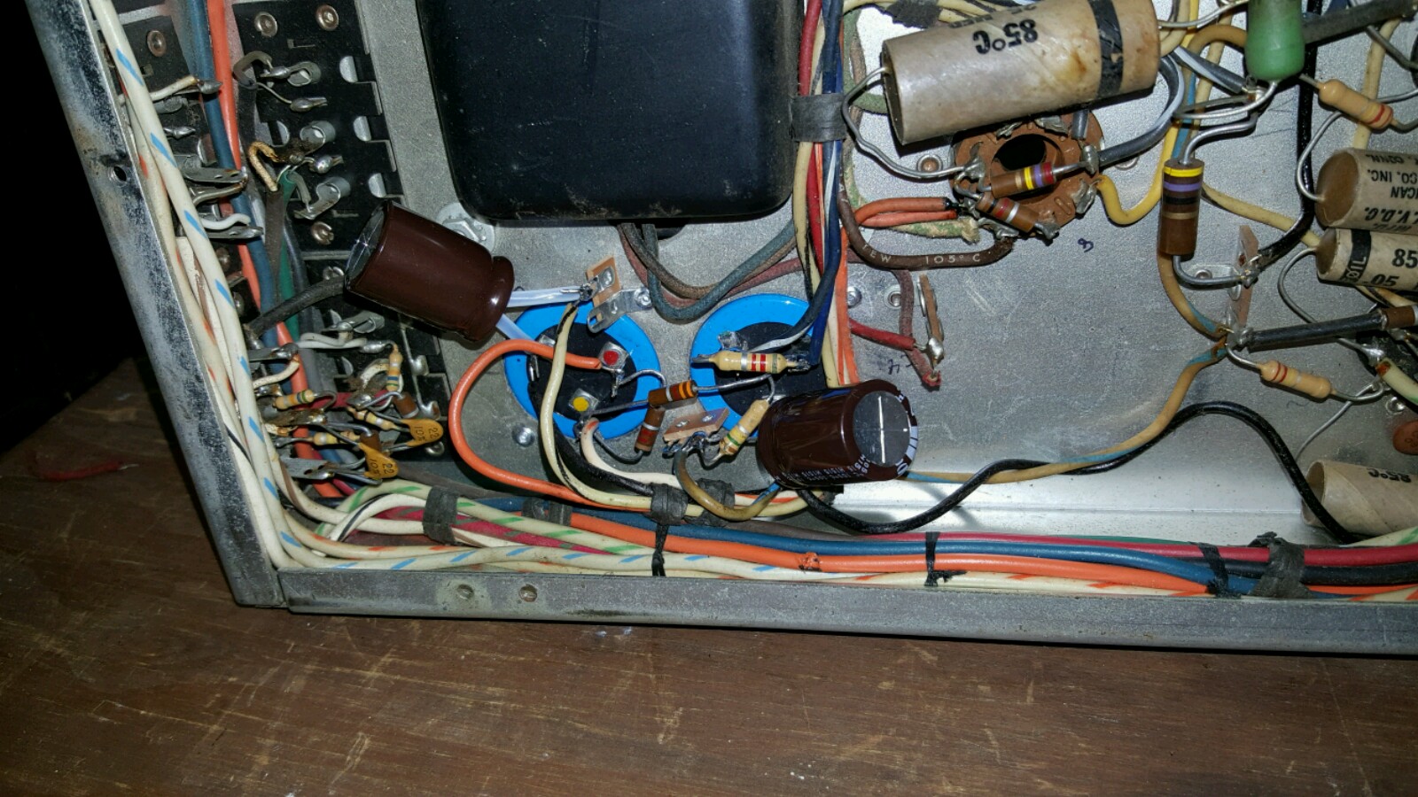

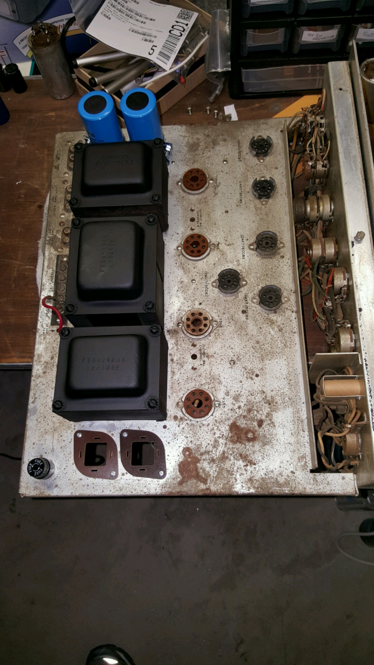

Making headway on the power supply filtering caps. The 50uF/50uF/50uF 450V multi section caps replaced with 50uF/50uF 450V ARS caps with a 50uF 450V under chassis mounted underneath. The hard wiring is a pain in the behind compared to pulling and replacing a board mounted component.
Finishing up the work on the 150uF 250V filtering caps. The paper insulated caps will be left in place while the new caps will be mounted under the chassis. Had to replace the insulated 4 tab twist can mounts....they were broken.

Hi Bob,
As long as the original capacitors are electrically disconnected, you shouldn't have any problems. I've stuck the new parts inside the old cans when there wasn't room for anything else under the chassis.

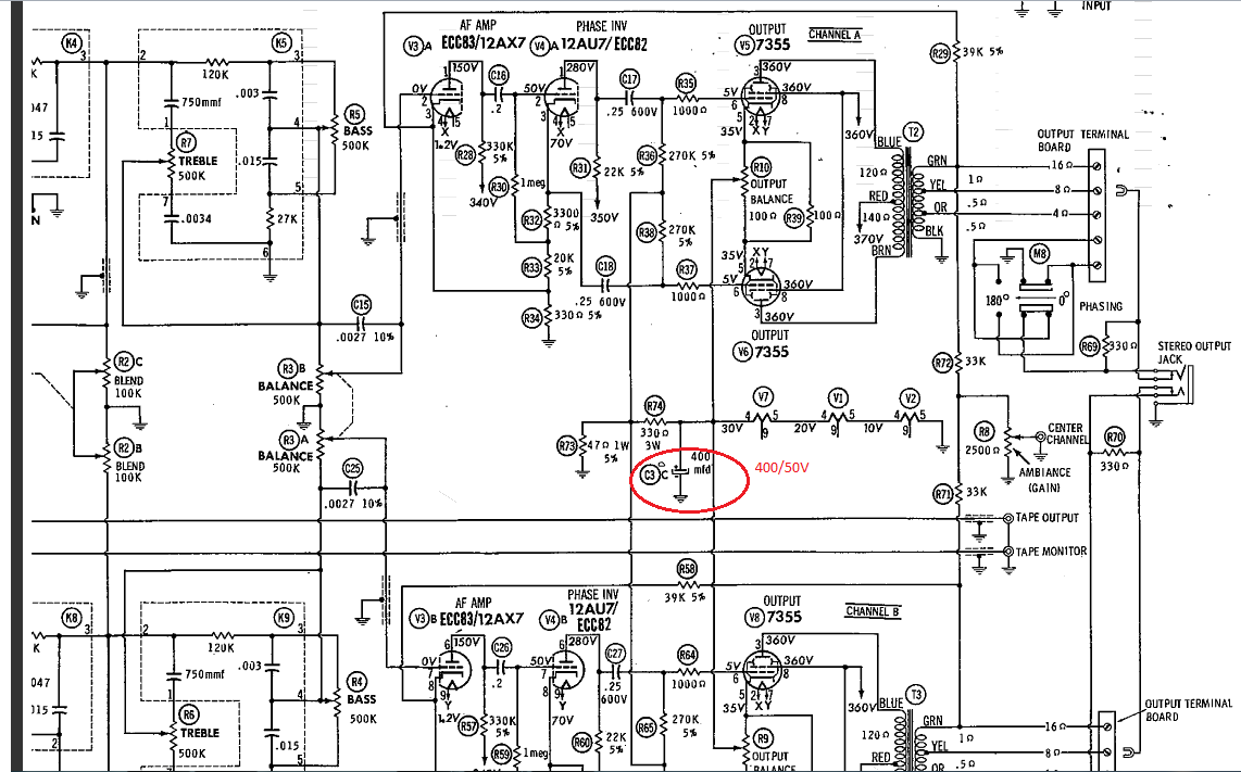

difficult sourcing a 400uF/50V. Any concerns with putting a 470uF/50V where marked?
That cap will be just fine in the spot you indicated. You can go twice as much capacitance even more with no problem. Caps of that era were much larger which was the deciding factor back then. Since that cap is part of the 7355 power tube cathodes you should use a high quality electrolytic like Elna Cerafine, Nichicon Muse, etc. I don't know what values are available in those brands, but you should be able to get 470 x 50v. Check Handmade audio, Michael Percy, etc..
I'd think the extra 70u isn't going to hurt you any. I ended up having to play with some values as well as some of the originals were not what we would call "standard values".
