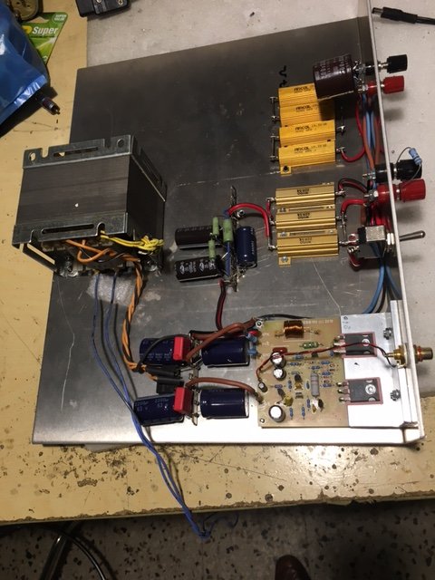

Hi
in attach the test set to drive dc current on secondary of a s.e. OT ; it is a proto working. It is missing a external DC poer supply to put current on secondary as current generator. There is a power amplifier that can deliveri aroud 25 Vrms on 8 ohms with a good perfromances, it drives the secondary with ptoper signal.
Done two years ago just only to check the validity of the reverse test. Done few test, I am taking long time to do the things!

Instead to write a lot of words why you don't show someting better than two screenshot of a trafo with a swing of +/- 80 mV?
And if you are sure that the reverse method is not so good, why you dn't show a real report to explain the issues of the method?
Very simple.
If you are interested, of course otherwise are only words.
Then in post 39 there are the test for three OT with same circuit; as you see the FIAT trafo is the better compared the others.
And I have paid to get the Hammond and Sowter just to have a standard reference to compare with the proto.
About post 39, please show us the real circuit you mentioned and how is working; otherwise are only words.
The solution I have adopted is simply end efficent and built in a proto. The only thing is the proper setting of the resistors.

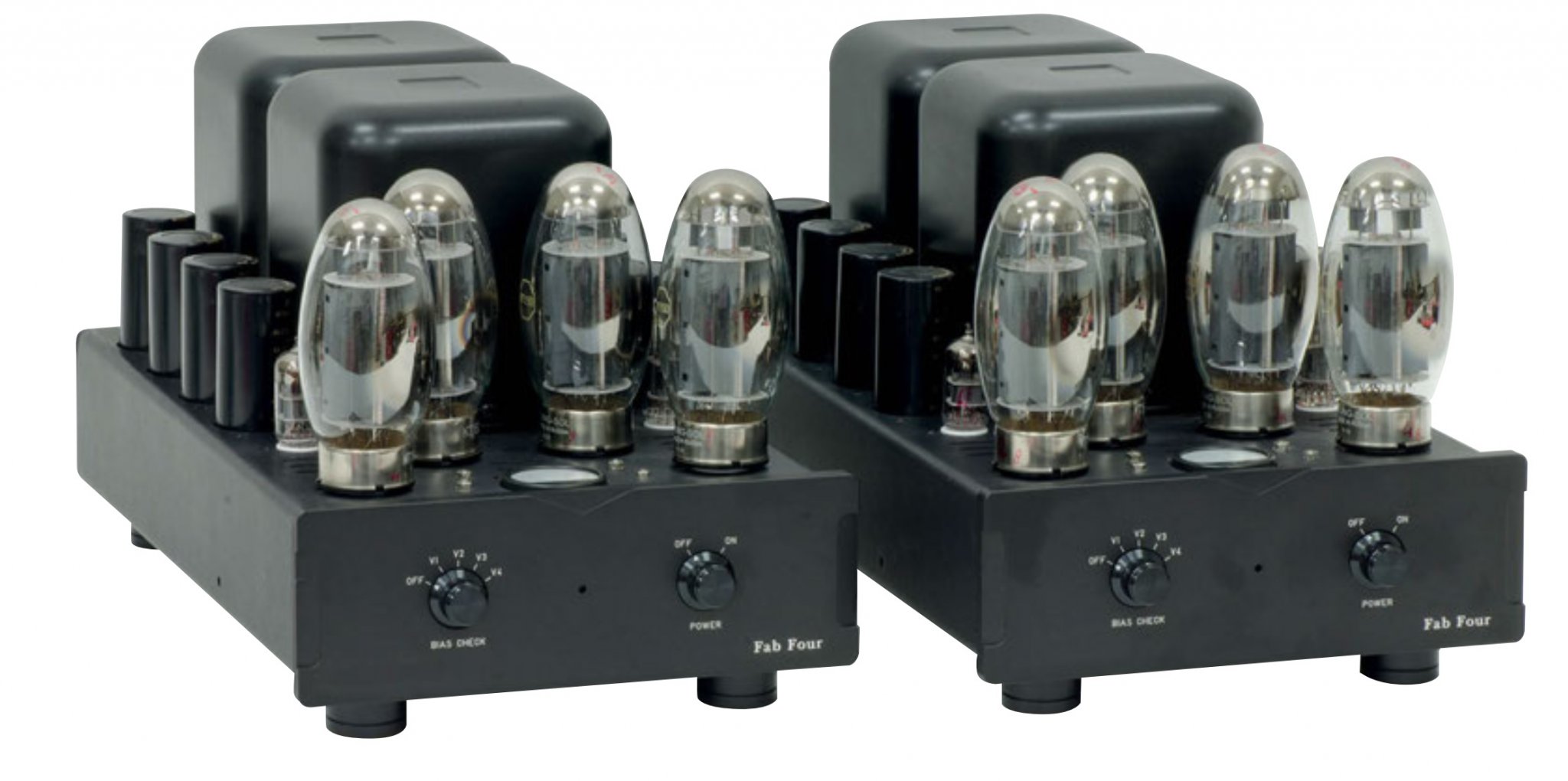

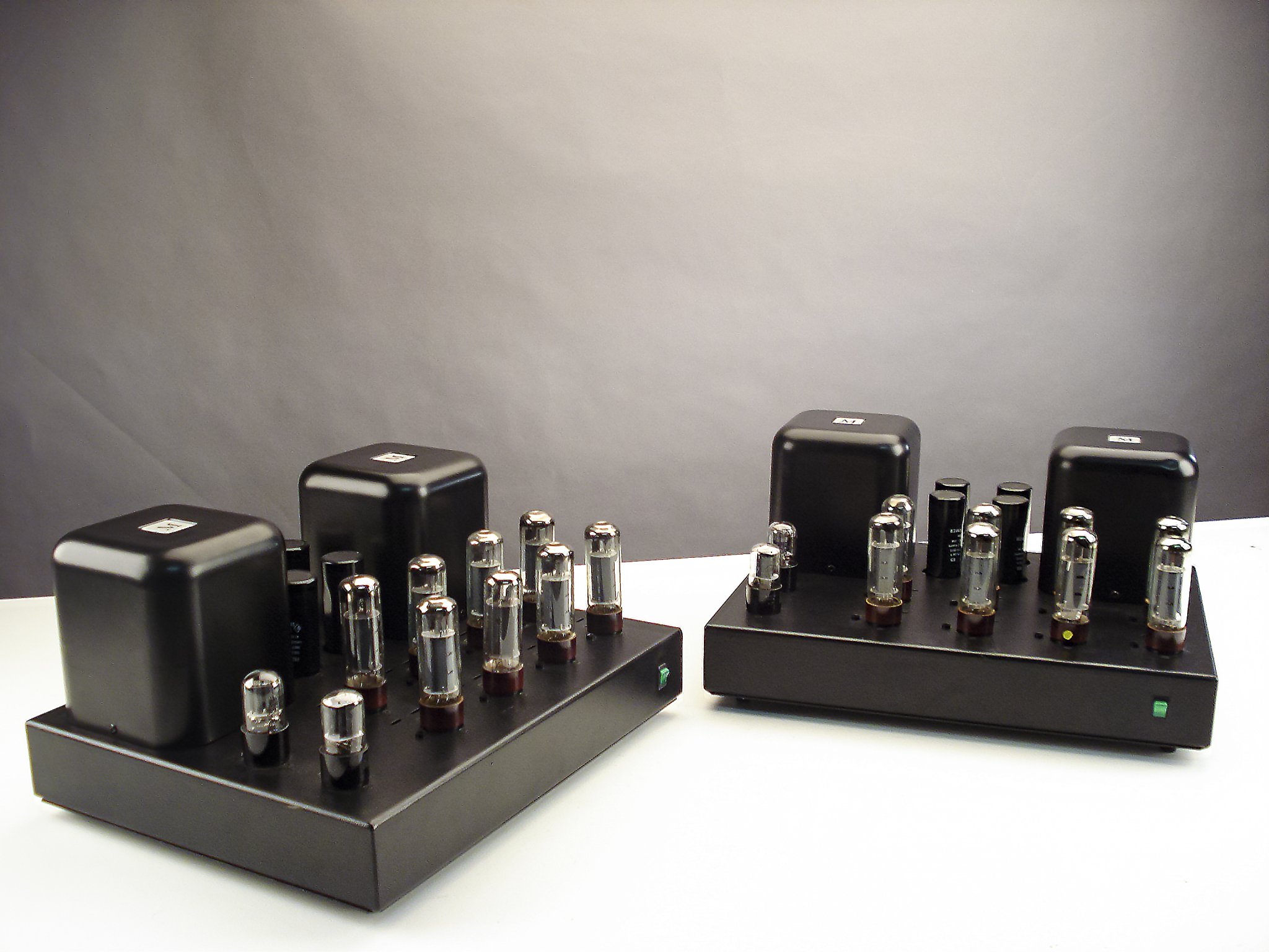

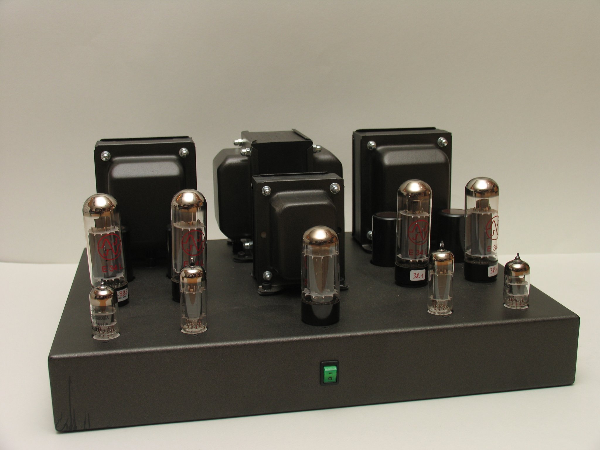

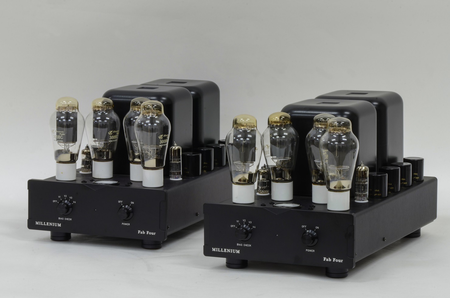

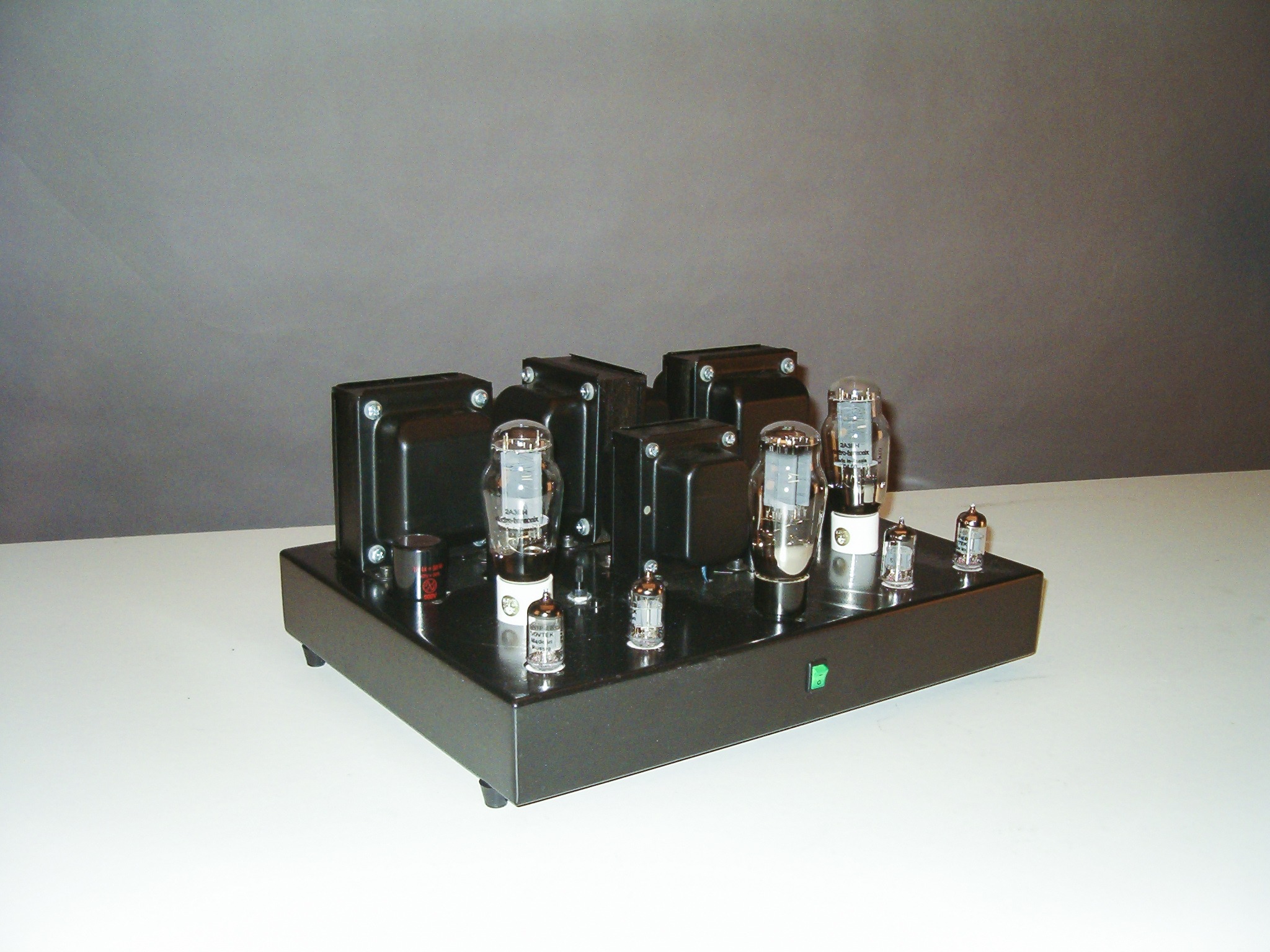

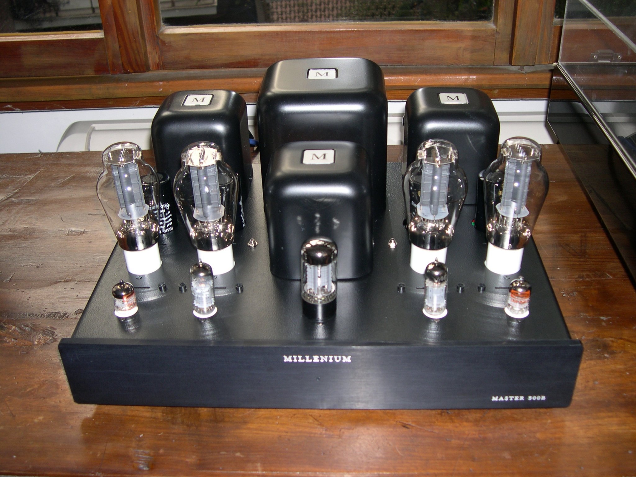

Hi
in attach some photo of the amps I made ( not all) with a good aesthetic.
I put htis photo to specify that each of them has a OT trafo non commercial and buil from two company ( one, the old brand Ripley, is missing, I can't find the photo) and all are tested at the best, in my opinion.
The installation on amps are done after some tests; then verified the functions on test set ( I have two Audio Precision, 5 tube tester, included Sofia, then generator, etc, etc)
Forgot, around 10.000 pcs of Resista WK series and around 4.000 pcs of Holco resistor (H2,H4,H8) plus hundreds of capacitors. And a non verified number of tubes.
I sent the protos to a good number of friend and ex customer to test the music results. I have this fortune to know a lot of people who have HiFi setup from 1.000 euros to dozen of euros. Then if the feedback is common ( I mean as pleasure in listening sessions) this give an idea that the project is good.
This is the last act to close the project.
There are amps that are running from year 2000 ( few last years of century) with a very low number of fails ( of course mainly tubes) wtih a happy listener.
Bye for the moment 🙂

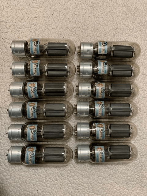

Ps= I have 10 pcs of 845 Fivre (RCA) year 1942, new and tested, if you want them they cost 1.000 euros each.
