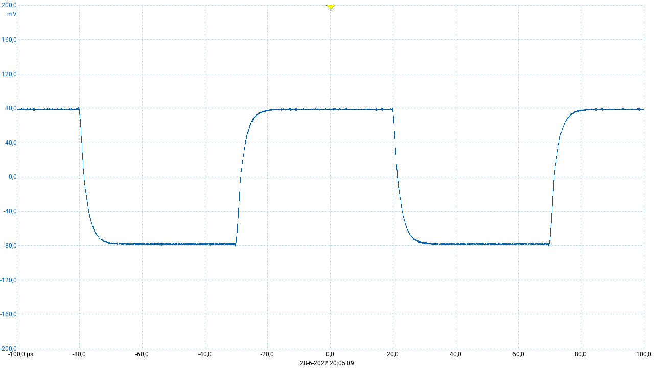

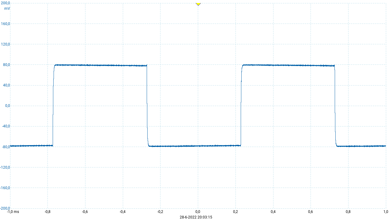

I can't understand wich are the voltages you are using in these test.
On the second plot I read +/- 80 mV, it is right?

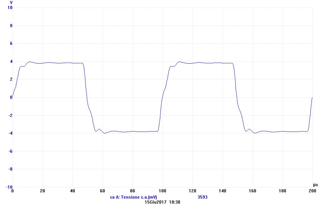

The signal of +/- 80 mV of square wave is not esplicative of the trafo.
In attach the test on 10 Khz with Litz trafo and a swing of +/-3 volt (around) on scale exactly 40 times your test.
The results is not so bad but we can do it better.
The secondd is the standard trafo at 10 kHz at +/- 4V p-p
In my opinion these type of tests are esplicative

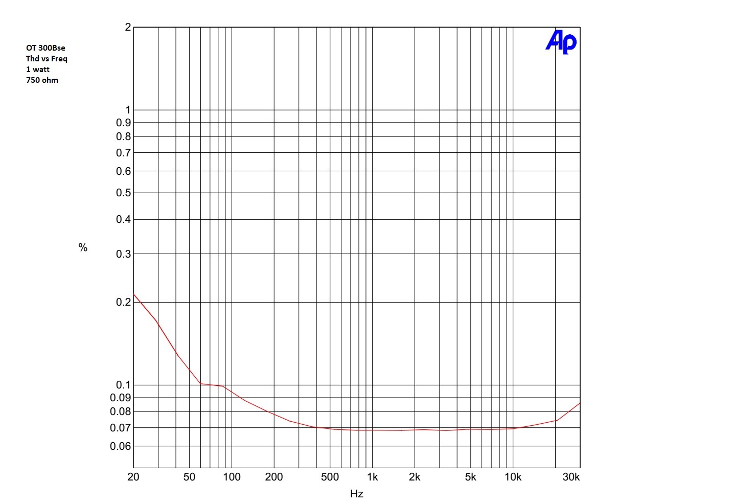

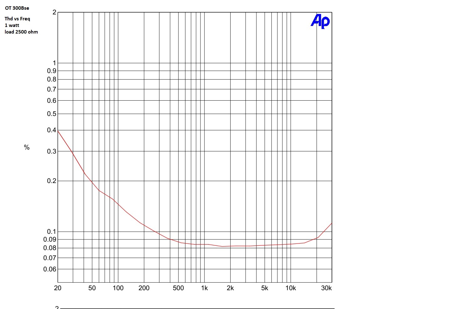

Then two test on THd vs Freq, another intersting test ; 1 watt as power test
The first one is with the primary ( on my set uo now secondary) at 2500 ohm load, as following the tech. spec of the rafo; I think a fgood results, the iron can be better.
The second is with a load of 750 ohm close to the real Rp of one 300B; same setuo. Also a good results.
Both is done with a standard trafo ( proto)
I did another test: limited frequency respons from my tonegenerator. Now it is max 200kHz (instead of 20MHz)Maybe my digitalscoop and tonegenerator?
1kHz squarewave
This is at 10kHz.
As you can see is that filtering dos a great job. The Audioprecision system for instance is also a limited system (200kHz) so you don't see all the high frequncy **** what could be in your transformer signal. Luckely most people use gridstoppers and amplifier stages with a natural limit (Miller capacity mostly).

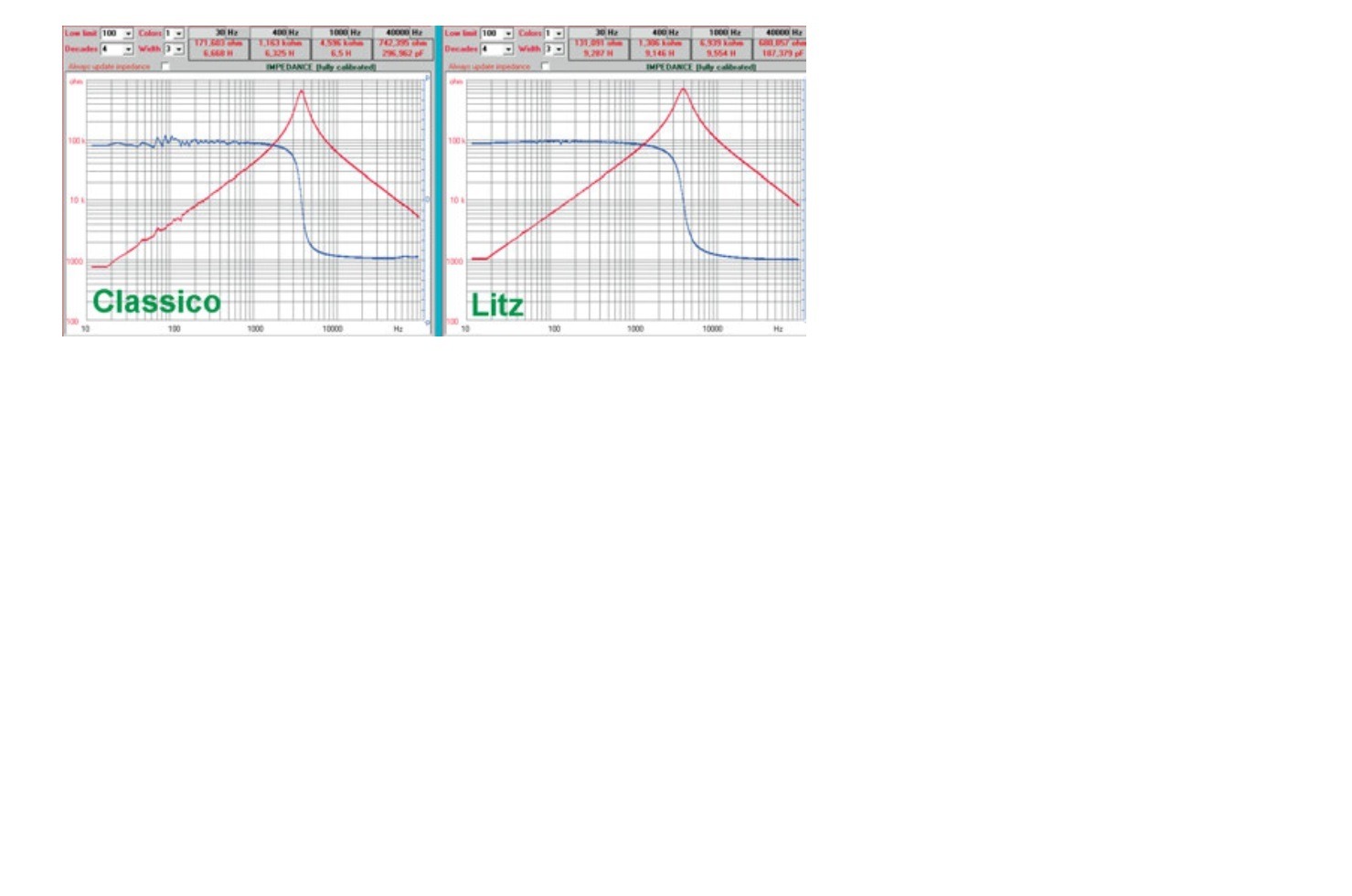

In attach a screenshot of a test on three OT done from my collegue Fabrizio.
It is possible to see the shape of a impedance of primary winding ( secondary open) .
Until the resonance the module curve is inductive, after that it is capacitive
The numbers on screenshot aren't not so clear to read.

Regarding the Litz version the resonance frequency is a bit higher than normal ( as expected) and you can read that a high frequency the value of capacitance is 100 pF less respect to the normal and the frequency answer is better.
In the thread you mentioned I put two diagrams with a standard mode and reverse mode and the curve are similar. The amplitude was different of course.
But the THD vs frequency, as shown in other diagrams are different related to the level, mainly on low end and high end.
That's all.
Your considerations around the OT and the resistor put in series are wrong . If you are sure about it you can show with test your point of view, I suppose.
No Walter, it is only you who says that is the best test, others disagree.I confirm you that the reverse test system is the best way to understand the OT itself, no other way are available until you find a generator with variable Zout and a wide range of Vout at different frequencies.
That's all.
It is not a problem to make a generator with high output voltages and low distortion. Ever heard of tube circuits? Srpp, Mu stage, Mu followers? They don't have 0.0000001% distortion and the output voltages are not 400Vrms either, but they are capable of excellent work,. You can even combine tube circuits with gyrators, ccs, fets and other things to make it even better.
In that thread I didn't mean your measurements but Timpert's measurement (I think he was the guy who did it) .
If you understand the physics behind transformers then you know that you need a device that can deliver enough current to keep the distortion low. The moment you put a series resistor in the circuit things go wrong. But I'm afraid you missed the brieving ....(or don't understand that a resistor limits the current).
I won't do any measurements to prove that because it's just transformer theory, you either understand the theory or you don't.
"As for the Litz version, the resonant frequency is slightly higher than normal (as expected)" Ohhh, you found a new theory?
Why is the capacitance 100pF less, is that the winding capacitance or the capacitance between primary and secondary? So they are not wound the same way.
In addition, resonances are the result of poor/limited winding technique.
Regarding the high frequency rolloff of transformers such as the 1628SE . . .
Most likely cause: a Very high leakage reactance between the primary and secondary (poor high frequency coupling).
Next level factor: High distributed capacitance across the primary.
Lowest level factor: The absence of Litz wire.
At the other end of the spectra:
The 1628SE had the best low frequency rolloff of any single ended transformer I ever bench tested using the
$50,000 Rhode & Schwarz Vector Network Analyzer.
Driving the 5k primary with a 1k impedance, It was not yet rolled off by 1dB at 10Hz.
(or to say it this way: not yet rolled off by 3dB at 5 Hz). Sub 5 Hz response indeed!
If you have a pair, you might build subwoofer tube amplifiers out of them.
Just my $50,000 opinion
I see also 25% differance in induction.I confirm you that the reverse test system is the best way to understand the OT itself, no other way are available until you find a generator with variable Zout and a wide range of Vout at different frequencies.
That's all.
