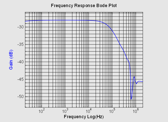

The vertical scale is impedance in Kohms, showing the impedance seen by the output tube driving the Hammond's primary winding. The 8 Kohms peak around 13 kHz is where I recall the output frequency response jogged severely.That curve is very different

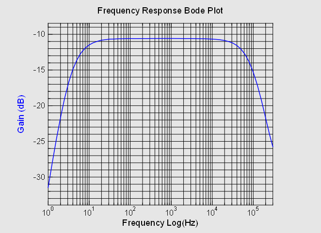

Thanks. That curve is very different from the Hammond 1628SEA, which rolls off smoothly at the top. Tubelab says the SEA is curtailed at the top compared to the Edcor and that the size of its core means a magnetic inertia that can destroy low level information......
Most of the comments and measurements that these comments are based on were made over 15 years ago. I have learned a lot more about tube amps and OPT's in those years. Two pieces of information from the 2006-2007 experiences remain true however.My misgivings about the SEA have been sown by Tubelab. Unfortunately the Edcor has only one output tap and would cost me over £100 more than the Hammond.
1) The original Hammond 1628SE (not the 1628SEA) was pretty useless in most applications. I tried them in several amp designs including a few guitar amps and never found a suitable application, so I sold them real cheap. Most of the amps used a typical audio tube in SE. All were either triode wired pentodes (usually a KT88), or true DHT's.

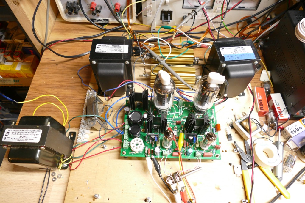

I have been listening to this test amp off and on for a couple years now. I even dragged out my old Yamaha NS-10M Studio test speakers from the days of my peak amp building. I ran every OPT I own through this amp, and even bought two pairs of something new, which may be a better option for someone in the UK. I have two pair of SE OPT's from Toroidy in Poland. Their largest SE OPT would do quite well in a KT88 or 807 based amp and they are less $$$ than Hammond or Edcor, but that's not what this thread is about. My Toroidy's will be used in a few test amp builds for something even newer than UNSET, so I must choose from what I already have when I build a box for this test amp. The test data does not show enough conflicting information to make a decision, and my nearly 70 year old ears aren't what they used to be, so I just kept swapping transformers until I got tired of changing them. These are what I'm going with. It's the multiple output taps that sealed the deal since I could not make a choice based on measurements or sound quality.

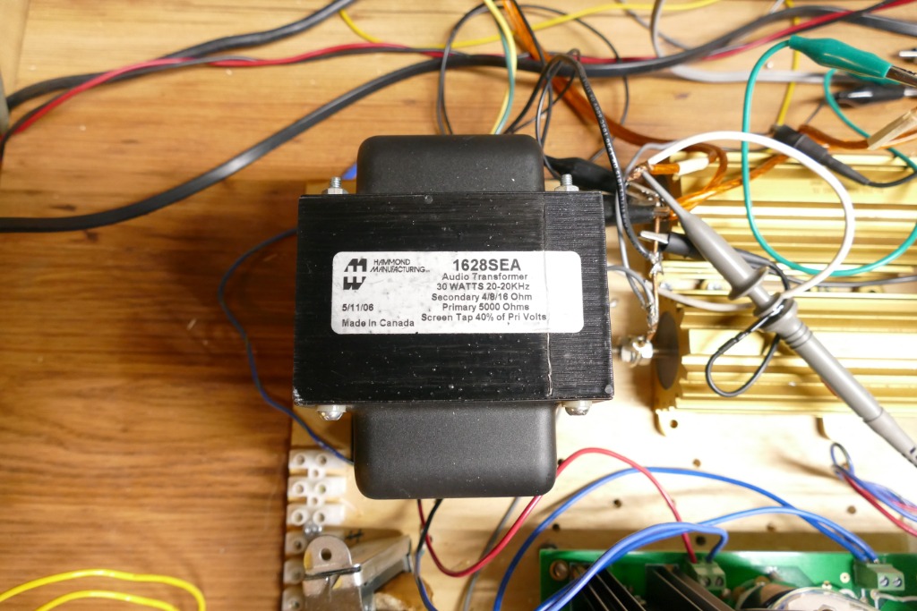

The test amp on my bench is currently using the 1628SEA's as 2500 ohm OPT's by using the 16 ohm tap for my 8 ohm speakers. It does this well, but losses increase a bit. Many OPT's do not work well when miswired for other than the specified impedance, so testing is required. The Edcor only has a single 8 ohm secondary making it a 5K ohm only OPT. I would need well over 550 volts of B+ to get 20 watts from a 5K OPT. I get 20 watts on 400 volts using a power transformer that I already have with a 2500 ohm load. I could use the miswired Toroidys for 20+ watts on 450 volts, but I need them for science experiments and I do not have a suitable power transformer handy.

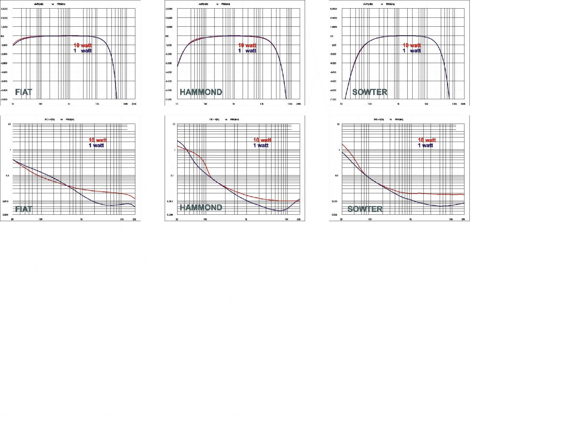

Here a copy from an article dedicated to the measure on Audioreview magazine in Italy
There are diagram form two types of proto, one with C nucleus and standard wire the other with Litz; also with different Ibias and the last without .
Frequency answer and THD vs Frequencies

Years ago SAC-Thailand tested various OPTs,
The Hammond 1628SE was not good:
http://www.sacthailand.com/transformer_testoutput.html
http://www.sacthailand.com/Transformer_OutputTestGraph.html

I agree that only a frequency response isn't enough.
If i look at your publish graphs in post 34 i can clearly see that there are resonance problems in both transformers. I bet a lot of ringing.
And if i look at the link for the article is see also that the transformer has high distortion at low frequencies.
Probably nothing to worry about in an average amplifier if there is no overall feedback.
The two trafos are protos to test two different coils, standard and Litz.
About resonance they are at 100 kHz and more and the ringing with complete stage is not present (or in minumm quantity)
But the power test are 1 watt, that means 52 volts rms on primary ( as secondary), 110 volts rms for 5 watt and around 155 Vrms for 10 watt; all voltage on a load of nominal 2500 ohm. The Zs is 6 ohm.
You can understand that is completely different from the standard test we normally see.
About the thd at low frequency the value is not so high, the core is double C laminated 0,1 mm; probably a better iron give me better results but this is not the main problem.

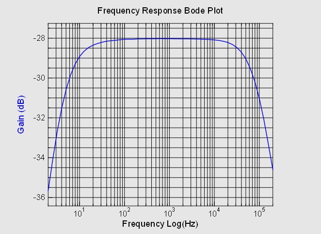

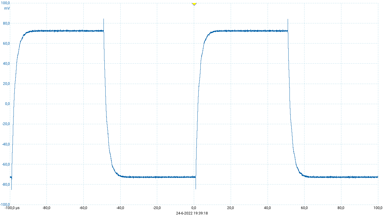

Walter, If the resonance is at 100kHz-200kHz you would see for sure* a clear ringing on squarewaves (10kHz but probably also on 1kHz) . Only if your test equipment is frequency limited (<200kHz) you would noticed it much less.
* for sure if you test only the transformer and not with a frequency limited amp or frequency generator
btw my test equipment is limited at 20MHz
Here you see the frequency respons from the transformer i have used (test with a serie resistor totall imp 716 OhM). As you can see resonance frequency is at a lot higher and also a lot less then your proto types, it's better damped)
And here the 10kHz squarewave test (but measured with a source imp of 1050 Ohm)
