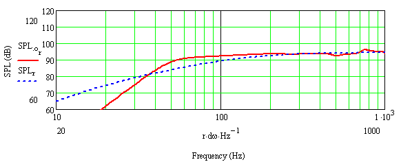

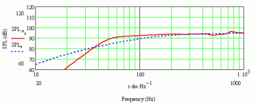

Nearly forgot: a single vent version of the Chilli-Chang is possible -just double the front-rear depth of the lower slot-vent. Compared to a normal MLTL it's not going to go as low, as we're limited in the line-length of the main enclosure, but it should cater for 167 owners who want a slightly different presentation. 🙂
Could this "line length" be increased for this single vent version? How much larger would it need to be?
Compared to a MLTL, what would some of the sonic differences be?
Yes, it can be increased. As for how long it would need to be, we're in the 'how long is a piece of string' zone, as it depends on the tuning frequency, and also how tall a box you can stomach. If you make a considerable addition for example, you'll be getting near to the height of the doubled box. Not that there's anything wrong with that of course.
Martin made some remarks about that above as compared to his Lowther based MLTLs. The only additions I would add are I'd expect a larger LF soundstage & improved directionality (similar to a BLH in this respect).
